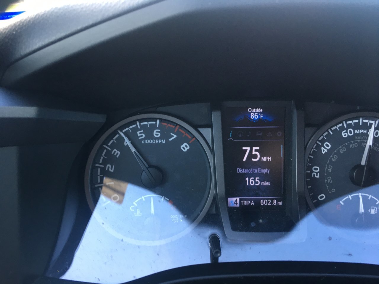

    In 4th gear 75mph @ 4000 RPM. About 78mph if you factor 33’s.
    RyanDCLB and Wixo like this.
