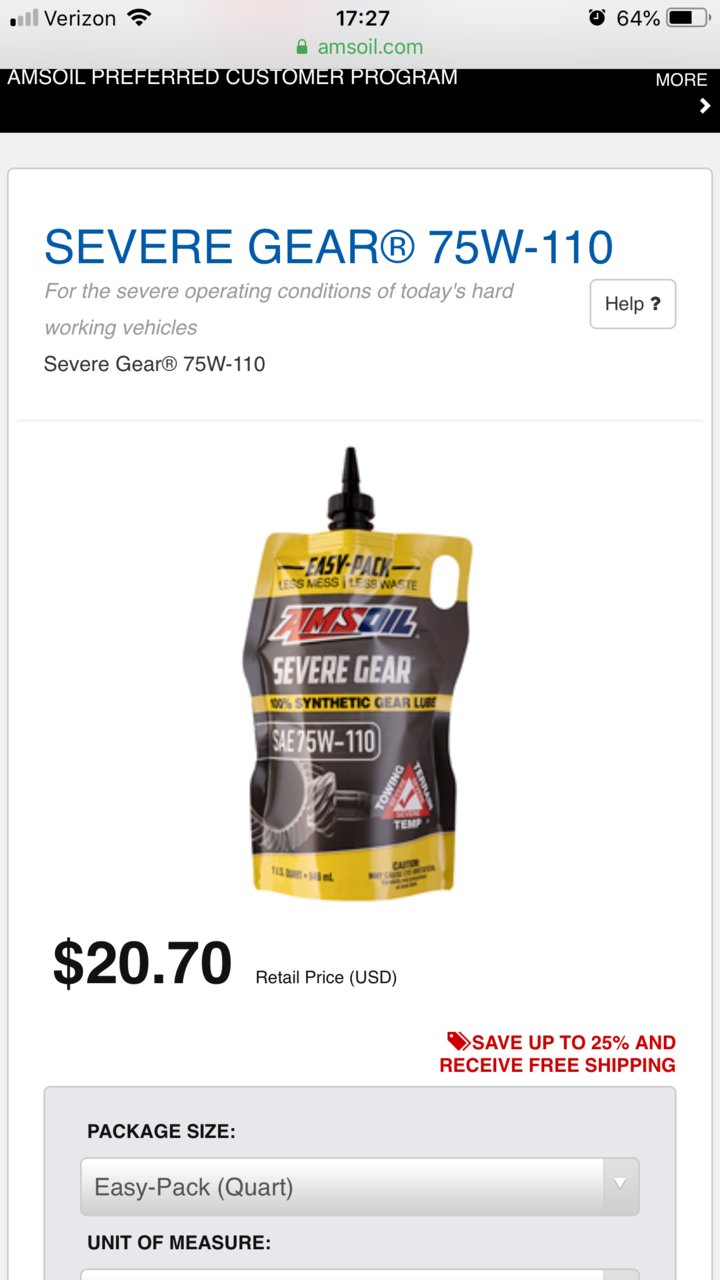

    Hey guys,
    On my next drain and fill of the diffs. Would there be any negatives going from the 85W-140 to the stock syn 75W-90? Not necessarily Mobil 1, but perhaps amsoil severe gear or Lucas if I can find it? Just wondering if I have to stay with 85w-140 for the life of the gears. I live in Idaho and it gets cold in the winter and hot in the summer

    No need for 85W-140 in the front for sure.
    75W-110 in the rear and 75W-90 in the front.

    Interesting. That stuff is expensive and harder to find. What would you recommend for brand and getting the 4.1 quarts for the best price?

    https://www.amsoil.com/shop/by-product/gear-lube/?zo=515729
    I can get the 75W-90 for ~$13 and the 110 for about ~$15 in the squeeze pouches.
