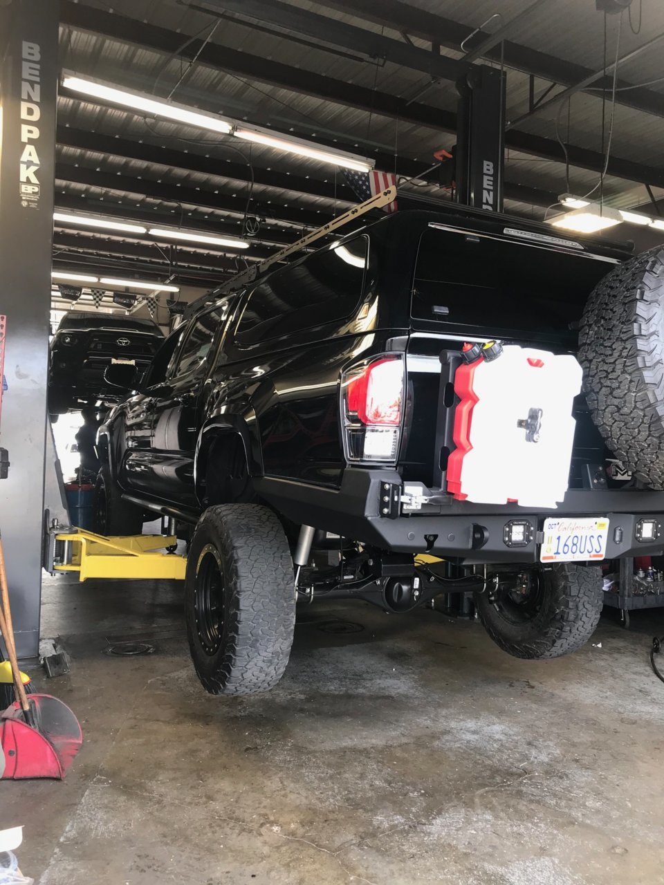

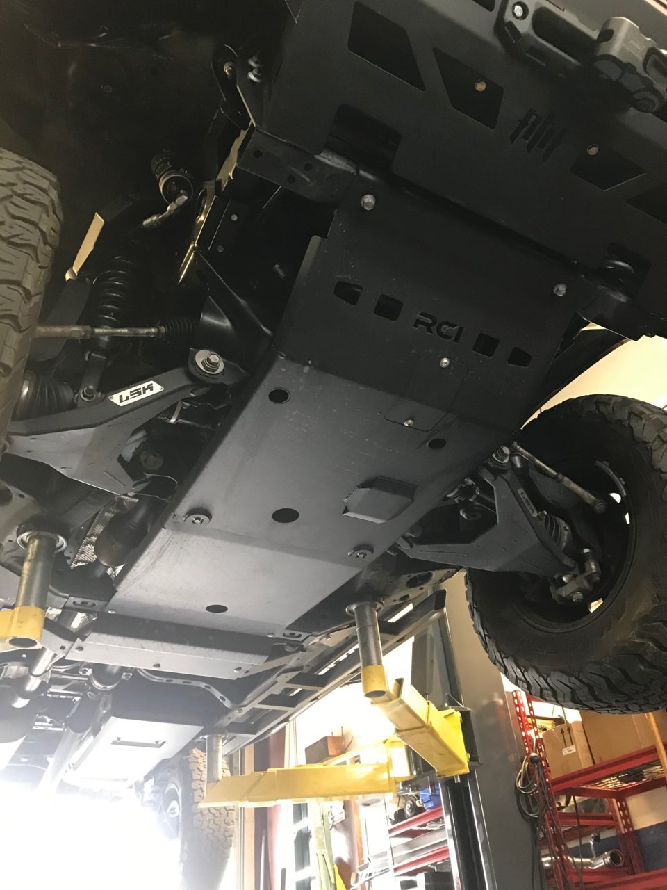

    Suspension -LSK Uniball Uper Control Arms -LSK Uniball Lower Control Arms -Camburg Performance Spindles -ECGS Needle Bearing Installed -Archive Garage Hammer Hangers -Archive Garage 3.6” Shackles -Archive Garage Hanger Cross Tube -Icon 2.5 CDC Extended Travel Coilovers -Icon 14" 700 pound coils -Icon 2.5 CDC RXT Shocks -Icon 2.0 Hydraulic Bump Stops *Bolt On Bump Stop Mount -Wheelers Front Super Bumps Armor -At The Helm Front Bumper -At The Helm Rear Bumper -At The Helm Rear Swing Out -RCI Sliders -RCI Engine Skid Plate -RCI Transfer Case Skid Plate -RCI Transmission Skid Plate -RCI Fuel Tank Skid Plate -Prinsu Designs Top Rack -Prinsu Designs Cab Rack Lights -Black Head Light Mod -OEM TRD Pro Tail Lights -MESO LED Turn Signals -Morimoto HID Headlight Kit -Caliraised LED 40” Slimline -Caliraised LED 20” Slimline -Caliraised LED Amber Pods -Caliraised LED Wide Ditch Lights -Caliraised LED Flush Mount Pods -LED High Beams -LED Dome Lights -LED Back-Up Lights -LED License Plate Lights Miscellaneous -OVtuned2.0 -4.88 gears -ARB twin comp -ARB rear locker -Leer 100XQ Camper Shell -Smitty Built X20 Winch -Warn Fairlead -Warn Sidewinder -Roto Pax 4.5 Gallon Gasoline -Roto Pax 2 Gallon Water -Roto Pax 2 Gallon Gasoline -Weathertech Floor Liners -Double limo tinted -50% tinted windshield -Leather Seats - Installed At Dealer Wheels and Tires -Matte Black Stealth Custom Series Ray 10's (X5) -BFG KO2 285x70r17 // Load Range C (X5)
    Pulled the trigger and got 4.88's installed today. Have to say that the OVtune plus gearing has made this thing a pleasure to drive.
    Got front and rear gearing done plus added an ARB locker to the rear. Used https://mobilegearinstallers.com/ in the SOCAL area. Cant recommend them enough. Getting about 1-2 MPGs better than i was before. I had never seen my truck getting into the 17.x MPGs before going to 4.88s
    • Had me in and out in less than 3 hours
    • price OTD was great
    • 300 miles into the break in with about 100 in 4x4 no noises at all
    • noise wise, its stock to me
    • Felt really comfortable with Martin after learning his background experience
    • 3 month warranty on workmanship. 2 years on parts
    Couple of photos I snapped before they got into it.
