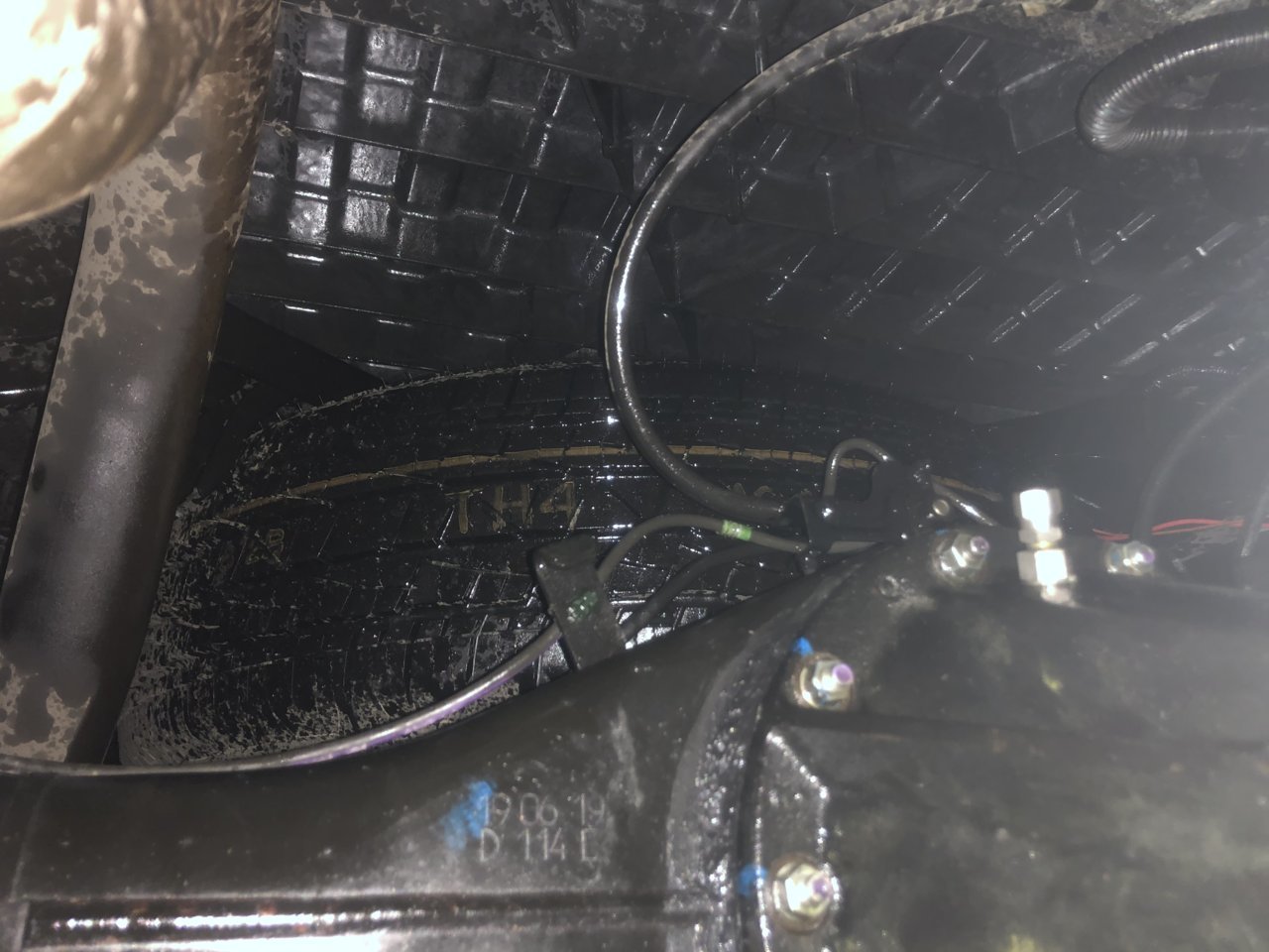

    Well. Gears are fantastic but the installer forgot to put the little O-Ring on the bulkhead fitting of my ARB locker. After doing the 5 heat cycles I took the truck on the freeway back to my house. Stopped at the 50 mile mark as instructed by Nitro to let it cool. Looked under my truck and it wasn’t a pretty sight:
    5FE4BB8C-E816-489C-9771-E398C01B25AB.jpg Not knowing how much fluid I lost I didn’t chance it and had it towed (tow truck got to me at 1:30 AM) all the way back to the shop. It’s up there now and the installer knows what they did and are taking care of it. They called ARB to educate themselves on how to install the newer bulkhead fitting (ARB updated it last year), and are taking the diff out to make sure none of the gears are fried. Should be a simple fix but damn was it a long night/morning. The truck didn’t get to the shop til 3:30 AM.

    Thanks for the update. That sucks for you! Bummer... I had almost the same thing happen at the ECGS front differential tap for the ARB fitting, the Allen plug was "hand tight" and could have backed out. I noticed it when installing my air line. On a side note, my front diff sweated out fluid after replacing the gear oil. My shop said it should be checked, but ECGS said it was common because of overfilling, and not a locker failure as long as the locker was still performing as designed. But, I do have gear oil all over my skids and rear diff. I'll most likely check the level during quarantine, but the skids were a bitch to install (MORE Offroad) and the gear oil drip has stopped. :notsure:
    These shops need to pay special attention to the ARB fittings, IMO...

    Did your kit come with two different bulk heads? I guess there’s one that fits the old blue airline tubing and the one you’re “supposed” to use which fits the new black airline. Oddly, the newer bulkhead requires two O-Rings to install and the older one requires just one. ARB gave me both bulkheads but only the black airline... wasn’t explained in instructions so my installer just did the old one and ultimately missed the O-Ring which caused this fiasco. So even if he did use an O-Ring I would’ve had to have swapped it out to use my black airline. Super weird.
    In other news we drove the truck about 30 miles and no leak. They cleaned all the oil out and did a bunch of leak tests. I guess I didn’t lose a lot of oil (just 1 pump to get it full again), so there wasn’t a need to check the gears. She’s in Portland at my parents house waiting for me to try the 100 mile journey home again to Eugene.
