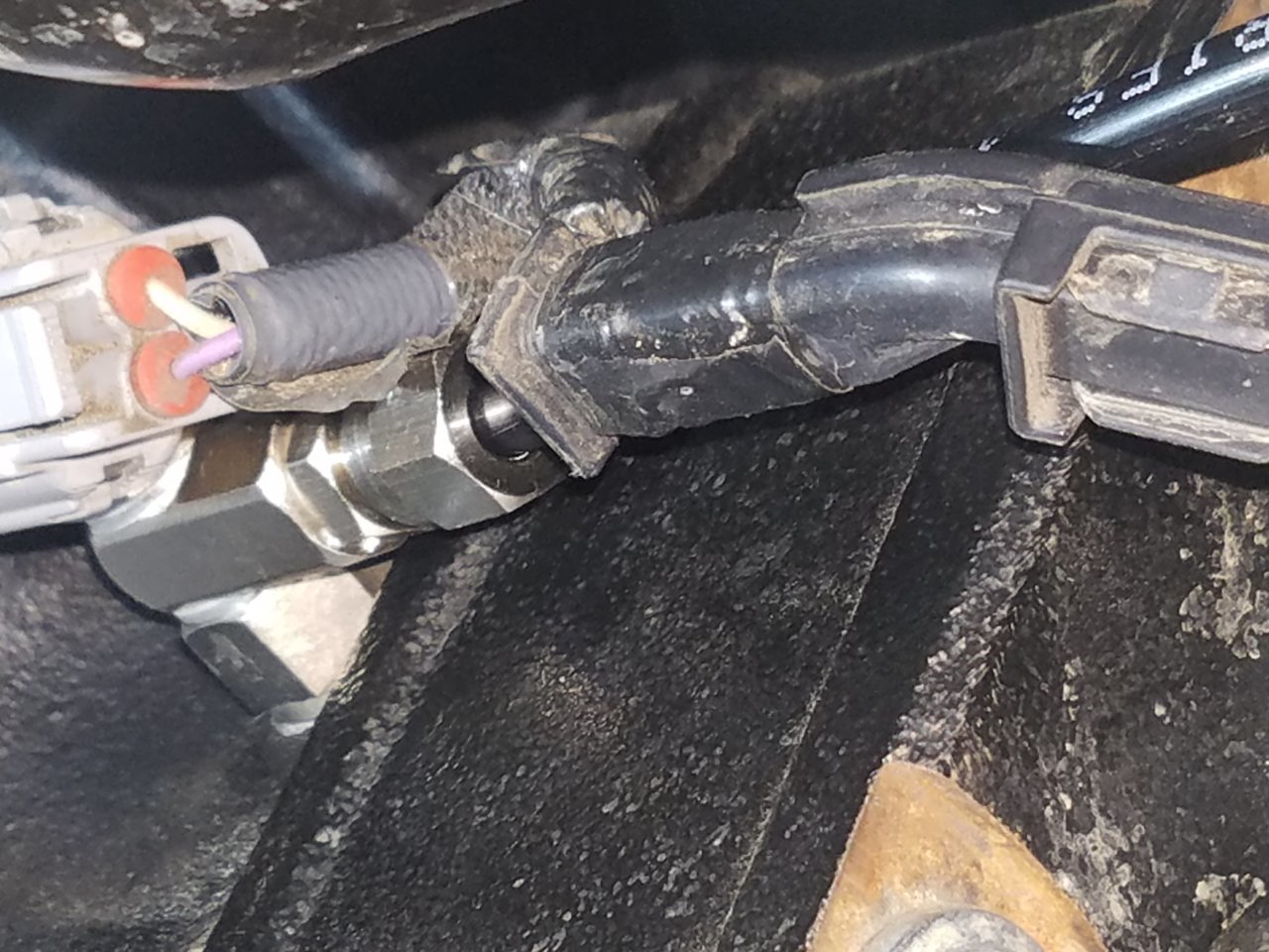

    Only the front differential was done up with an ARB. Here is the fitting, and they sent black lines with a crush sleeve:

    Yep that’s the new one. The crush sleeve keeps all that stuff tight in there so it doesn’t leak fluid :tinfoilhat: Looks good dude!
