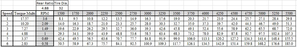

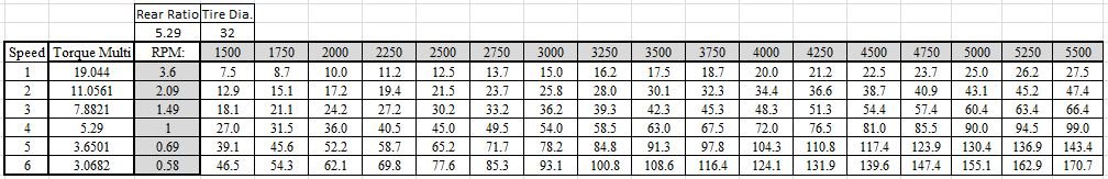

    I had 4.88's installed in my DCLB (thus Automatic) about three weeks ago and I've got about 1000 miles on them so far. My truck is stock except for 235/85r16 and a set of sliders on it, so it's not loaded down. I've been taking it easy up until this week, but I am so glad I finally had it done. Probably the best thing I could have done for my truck. I'm currently living in the Denver area for grad school, but I normally live in the CA Bay Area. Since I moved here, it seemed my truck was always struggling to get going or climb hills without stomping on it. 4.88's have definitely fixed the struggling, and really makes the truck enjoyable to drive. I actually find myself speeding because of the extra power it has. I'm on stock tune and don't plan to do OVTune. I'll try and see if they'll put the 2020 transmission update on it when I get back through the dealership, as it does still hunt and I just hold gears when I need to in S mode with ECT on. I've been driving it this way since I put the 235/85r16s on it, so I don't mind it. I'd say 4.88's is how the Auto 3rd gen Tacoma's should have been stock.
    Like many reading this and the 5.29 thread, I did a ton of research trying to determine if I wanted 5.29's or 4.88's, came up with a bunch of excel spreadsheets comparing stock to 4.88's and 5.29's, looking at RPM vs Speed in every gear, and generally had to be honest with myself about how I use my truck now and in the future. I'll never run anything bigger than skinny 33's, get a 1-2" lift at most (if I ever do) or put more than some lightweight armor at most. One of the biggest targets I looked at was towing, and that's looking at turning ~3000rpm at 60mph in 4th gear with the 32" tires I have. And the other metric was highway, and now at 70mph it's turning around 2100rpm in 6th gear. The truck has a hell of a deep overdrive and an engine that loves revs with limited bottom end torque, so the gears definitely help overcome that limited bottom end torque hole that it always seemed to get stuck in.
    The most remarkable is simply pulling away from a stop and how easily it accelerates. Going up decently steep country roads here around 20-45mph are perfect between 3rd and 4th with plenty of easy pulling away power. It cruises down the freeway and finally shifts into 6th gear, and even pulls a bit harder than I expected before it shifts down to 5th and that typically is all that's needed unless its a pretty good grade. And even at 70mph, 4th is only turning about 3700rpm and pulls well. At 45mph in city streets it shifts into 5th and cruises (which is amazing) and can even accelerate without downshifting. I can definitely see why many, especially those putting big rubber and loading it up with gear would want 5.29's, and I'd definitely suggest that if that's your course.
    For me, 4.88's are perfect for how I use my truck, and I cannot wait to see how they perform at sea level back in CA. I've attached the spread sheets I used for my decisions based on a 32" tire size fofr both 4.88's and 5.29's. Hopefully this information will help others, and I want to thank everyone else who has contributed to this thread helping me make my decisions.

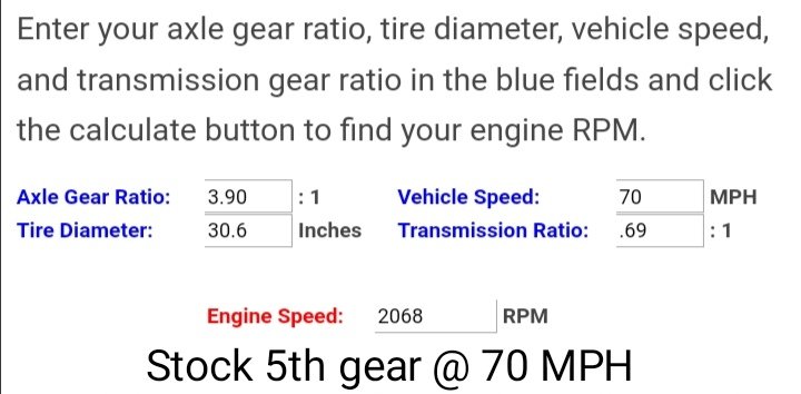

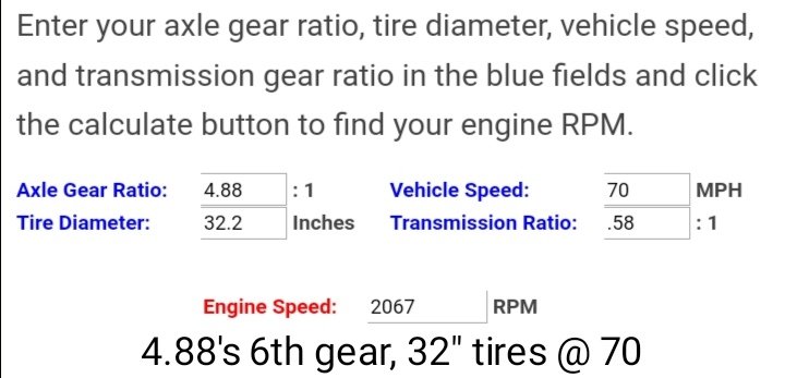

    Hey man don't sweat it, keep your 4.88's and don't look back. (It totally depends on your tire size though).
    With 4.88's AND with 32.2" tires, your 6th gear RPM's would be the same as stock gear, stock tires at 5th gear.
    Stock 3.90 gears, 30.6" tires, 5th gear
    4.88, 32.2" tires, 6th gear

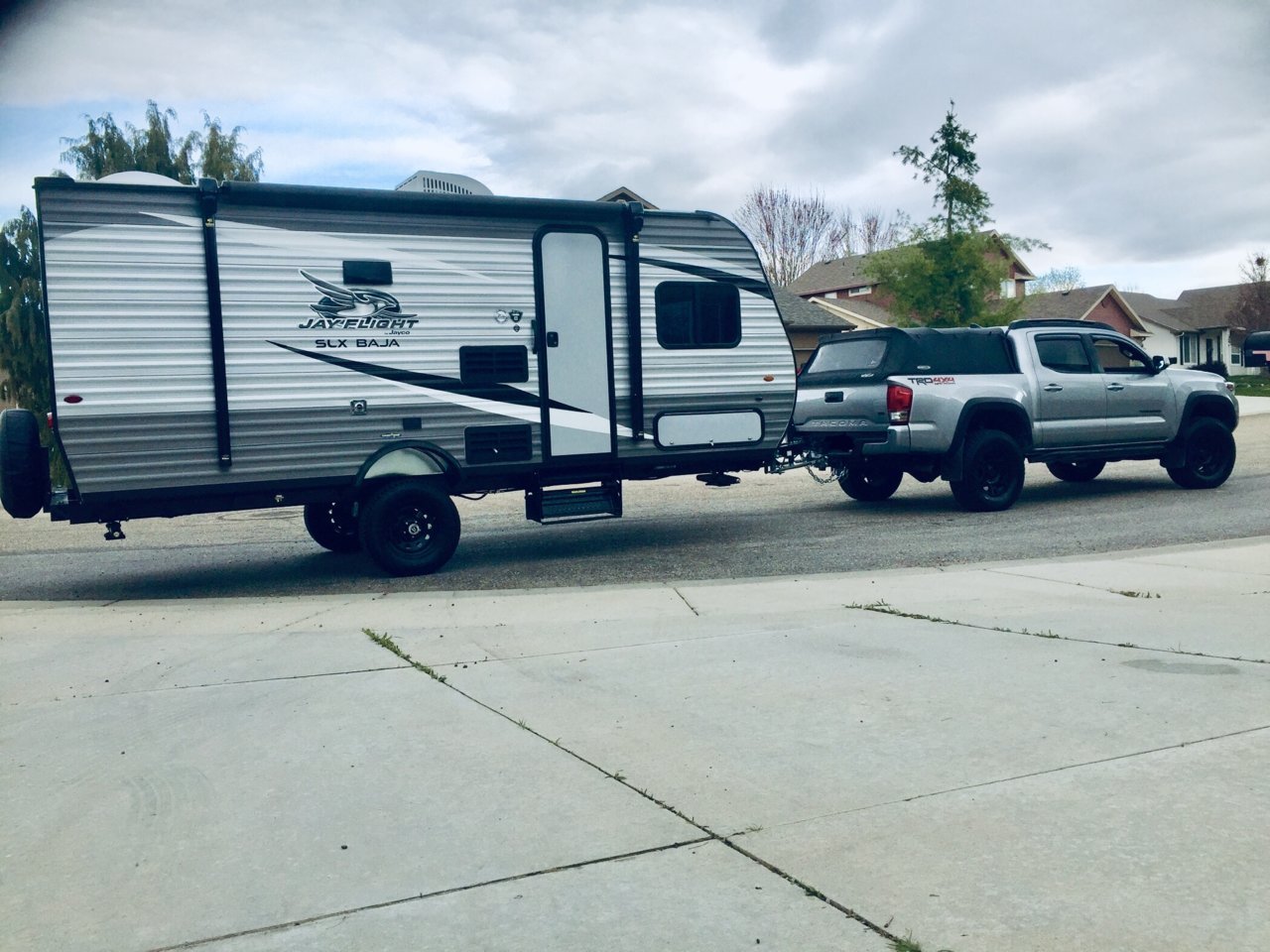

    C4Fab LoPro, BAMF Sliders, Ext ADS 2.5’s, 4.88's, OVTune (OG to KDMax)
    i'll say. 14mpg is what I get pulling my trailer on the highway
