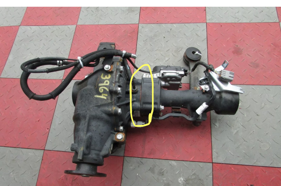

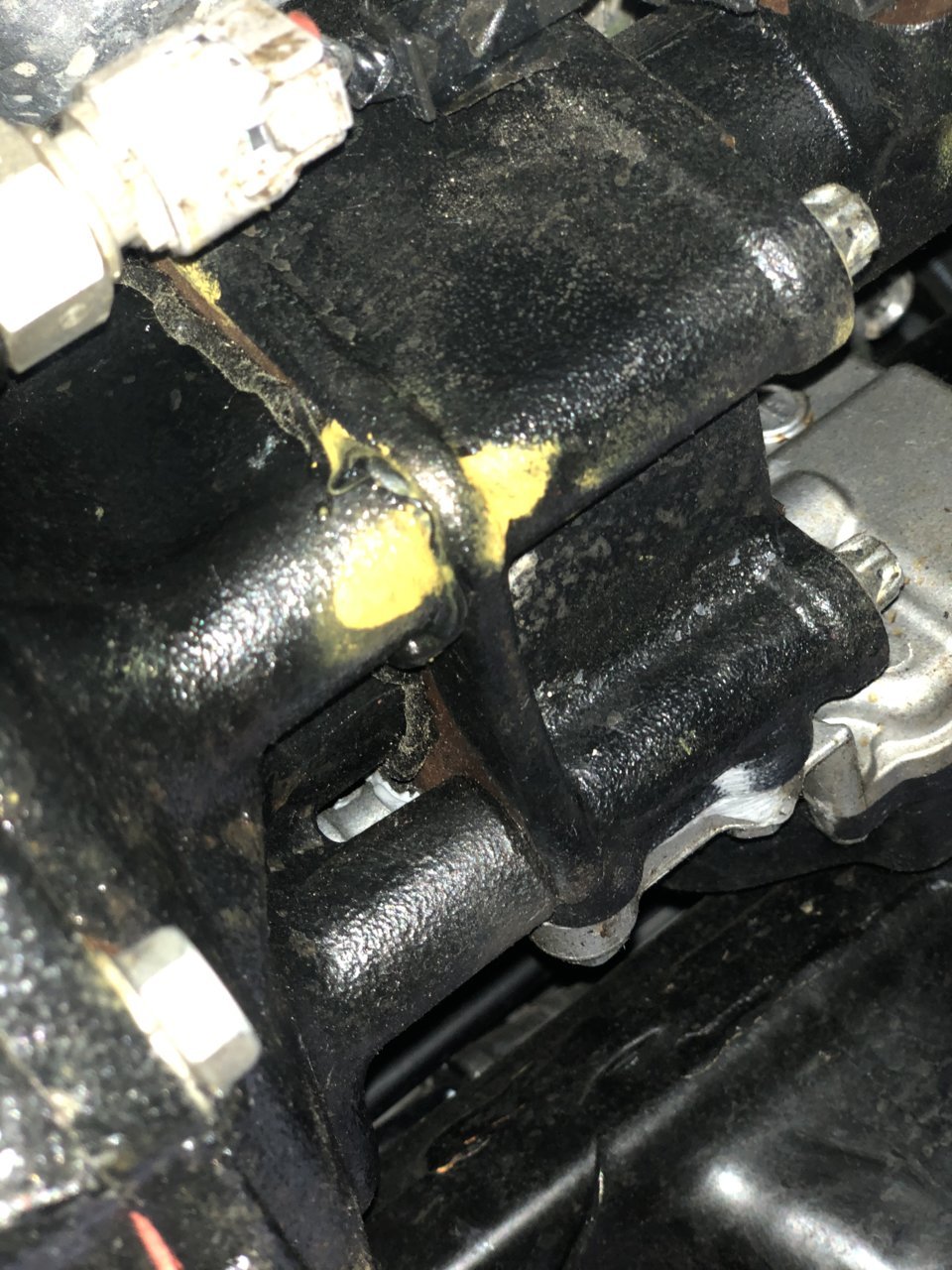

    Hey guys so I got gears about a month ago and just noticed a small leak in the front differential area. I’m not too good with terminology, but can anyone identify if there’s a gasket or something that would need to be replaced if oil is leaking from the circled location below? It doesn’t look like it’s the actual differential housing itself (this is not my truck - just a stock photo for orientation):
    There was oil kind of pooled at the bottom of it. It looks like the spot where the differential meets the passenger axle. You can see some of the sheen after I wiped it up (this is my actual truck):

    This could be one of two things.
    1. During break in, the oil heated up enough where it started to travel up the breather tube and came out the breather in that area.
    2. When the person who installed the diff was reassembling the ADD tube, they either didn't put enough RTV, didn’t put RTV in the right spot, or during assembly rubbed away RTV.
    Clean the area well, make sure the diff is topped off with oil, but not over full, and drive in 4wd. If it continues to leak, then yes, the seal (RTV) between the diff and ADD tube needs to be re done. Very easy job if you know what you need to do.
