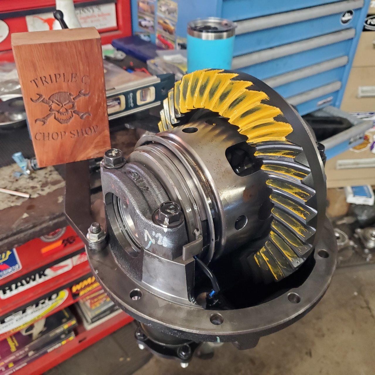

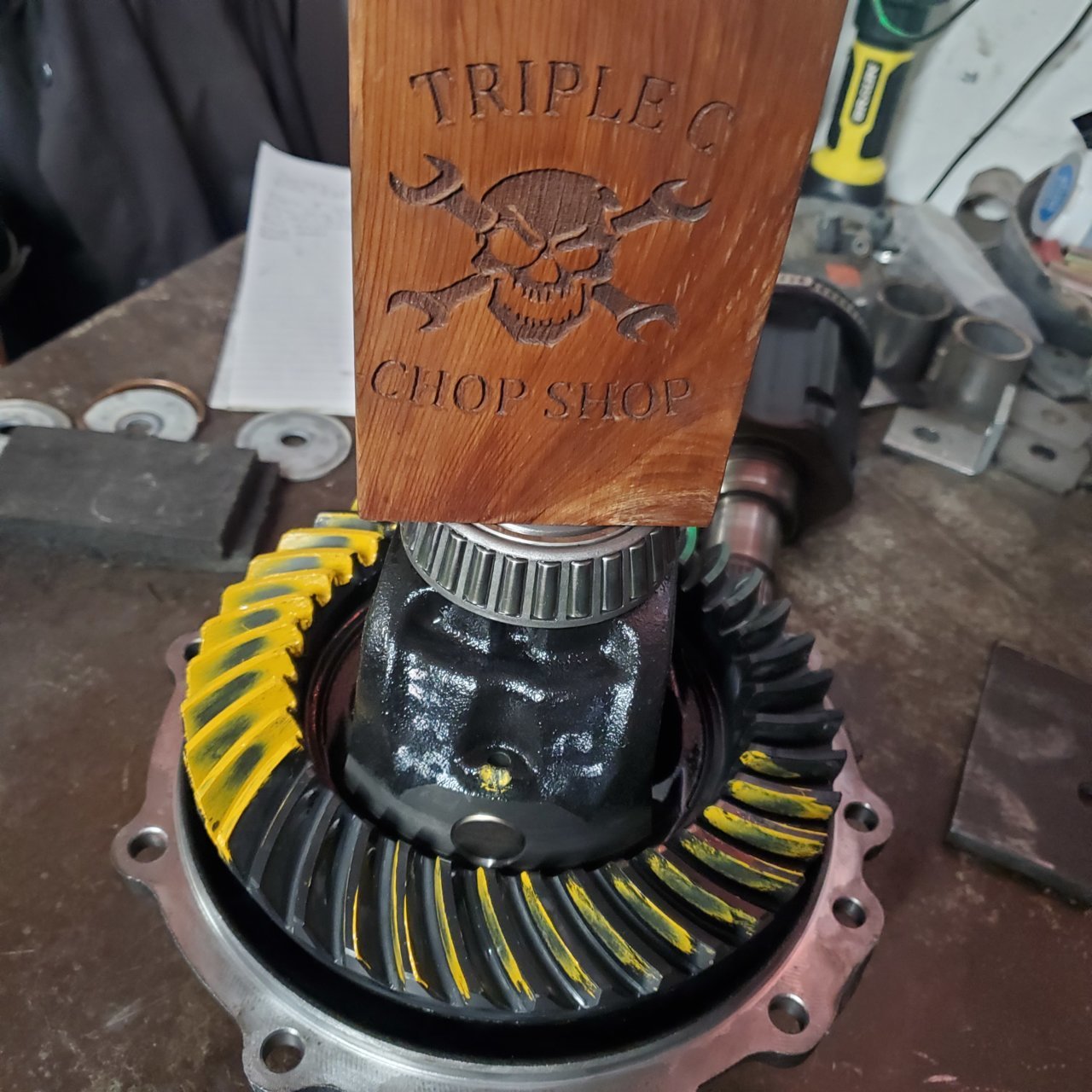

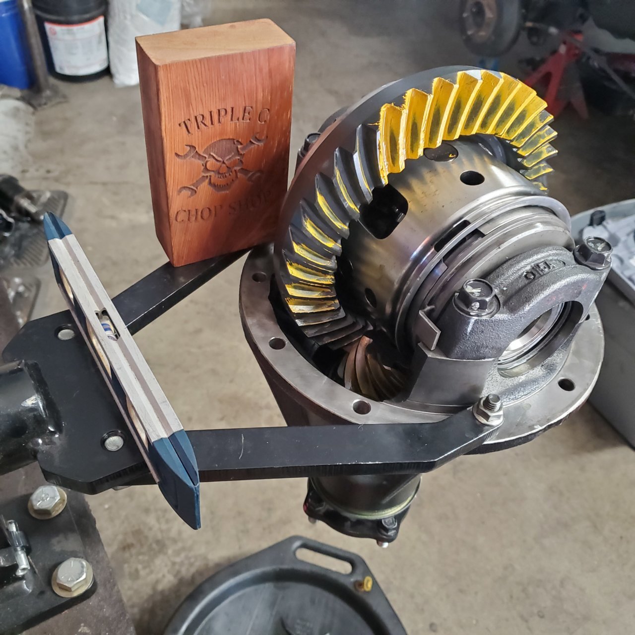

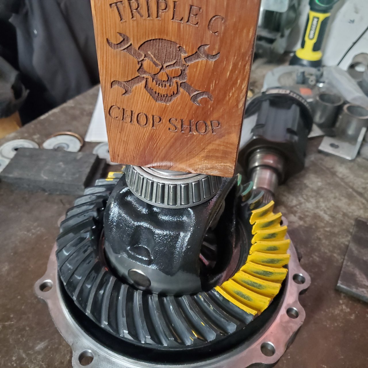

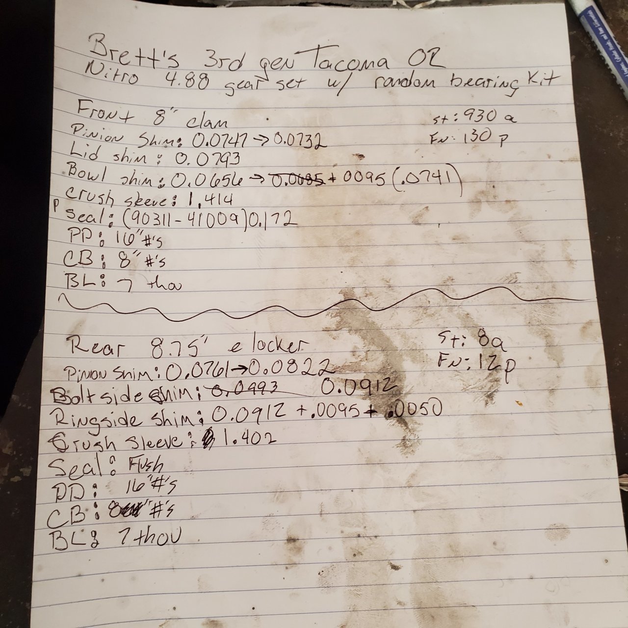

    Just had 4:88’s installed by @Texoma Saturday and Sunday ....
    I also had 04b33 flashed last Thursday.
    Huge difference for the better! I have about 280 miles on it since the 4:88’s went in and so far, love it!!!! No more gear hunt! Can actually accelerate in 6th gear. Holds 6th gear on overpasses. No lugging and the “dead pedal” feeling seems gone. This enhances city and highway drivability big time! So far, feels like the 4:88’s work well with 04b33 but need to get some more miles on it. Will share more after more miles and I get the gears broken in and can tow.
    This is a 2019 a/t long bed Offroad on 2” lift and general grabber atx P 265/70 17’s on 8.5” (24lb) wheels and no added armor. To me, 4:88’s seem perfect for this (32”) tire size and bet it’d be fine for lighter 33’s as well. I’m at ~2250rpm at 75mph in 6th gear.

    Hope the drive home went well for you. Let me know if there's any change in feel or sound, and def take some pics of the drain plugs when you change the oil.

    Will do, Chris.....long drive home (5 cooling cycles) had me smiling the whole way!
