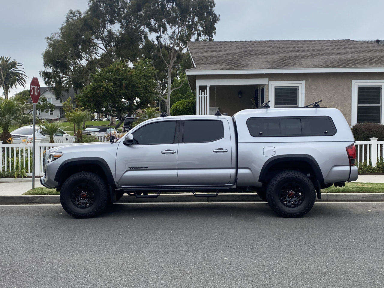

    2019 TRD OR - Looking for advice on what gears to Run 5:29 or 4:88? Mostly a daily driver but do a few big trips a year fully loaded stacked with surfboards and a RTT, Also do some road tripping open highway driving unloaded and would still like be able to cruise 80MPH + and not loose too much top end. I have a 3' lift w/ 285/75/16 KO2 , gas Mileage around 13 MPG unless I drive conservative. Feedback appreciated

    The elevation piece is definitely a good consideration. When I drove my truck from Colorado down to Tennessee there was a significant performance gain.
    That said, with a 3 inch lift and 33s you should go 5.29. I went with 4.88s because I was on 31s. Now I'm on 33s and wished like hell I'd done 5.29. The difference between the two is only about 10% in power gain, but in the right circumstances you'll need it.

    Occasional elevation driving , just concerned about how much 5:29's will affect the top speed? Seems like most people are going with 5:29s but I don't wont to loose the ability to make up some ground in the open desert.

    With 33s, you'll still have plenty of top speed. The difference between 4.88s and 5.29s isn't huge. Your setup is better for 5.29.

    Being able to drive comfortably 85-90 MPH is important for long trips in the open spaces out here (or even daily freeway commutes during the right times) . Would 5.29s RPM be too high for extended periods of time at that speed? Thanks for everyone's feedback

    General feedback that I have seen is folks prefer 4.88 for high speed driving. I have 5.29 and drive 75 when my tires permit without complaints but im not really an 80-90 kind of guy
