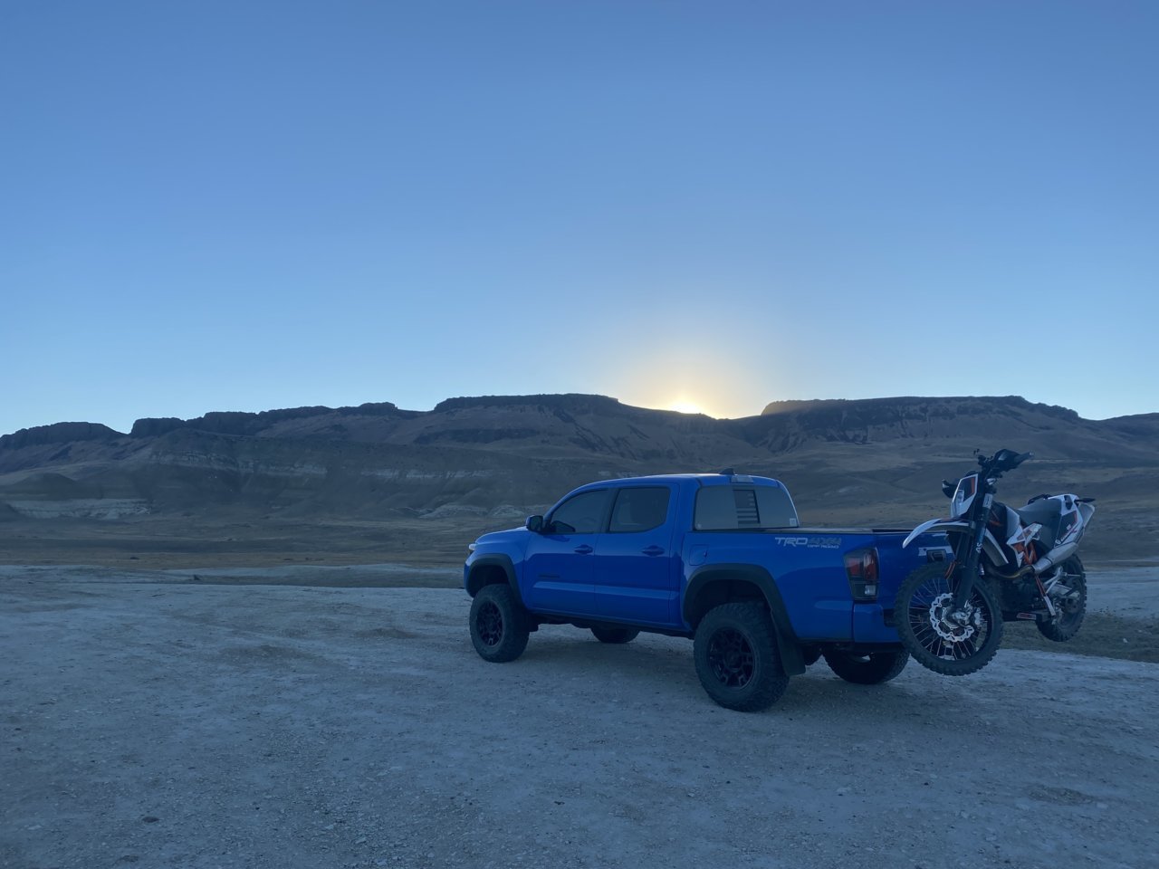

    Recent road trip. 70mph cruise loaded up as shown, roughly 650-700lb of gear and bike.

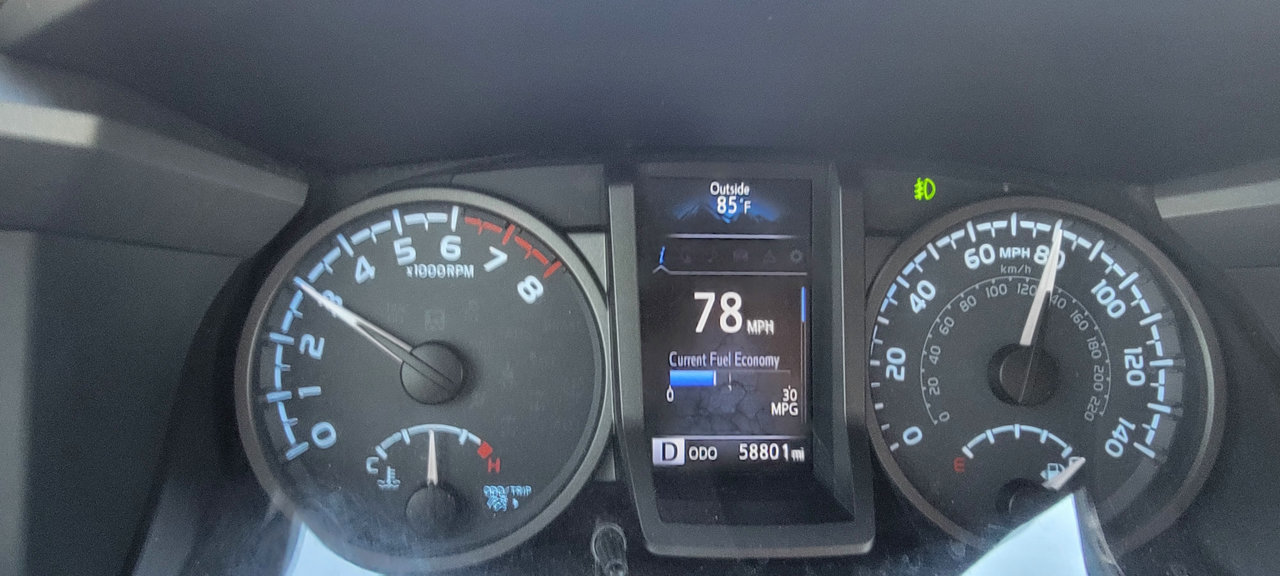

    80 mph at 3000 rpm slight incline in 6th gear. THIS TRUCK HAS NEVER DONE THIS THE ENTIRE 58K MILES BEFORE 4.88s. I am so happy making the change. Just so everyone knows, I never will need 5.29s because I am too cheap to spend all my hard earned money on 35's and hate the fact i would have to cut my truck up to fit them. This truck is more then capable pulling a 5k trailer and weekend warrior offroading with my steel skids and rocksliders. Best setup for me here in southern NM. The gears are too new to give an update on towing.
