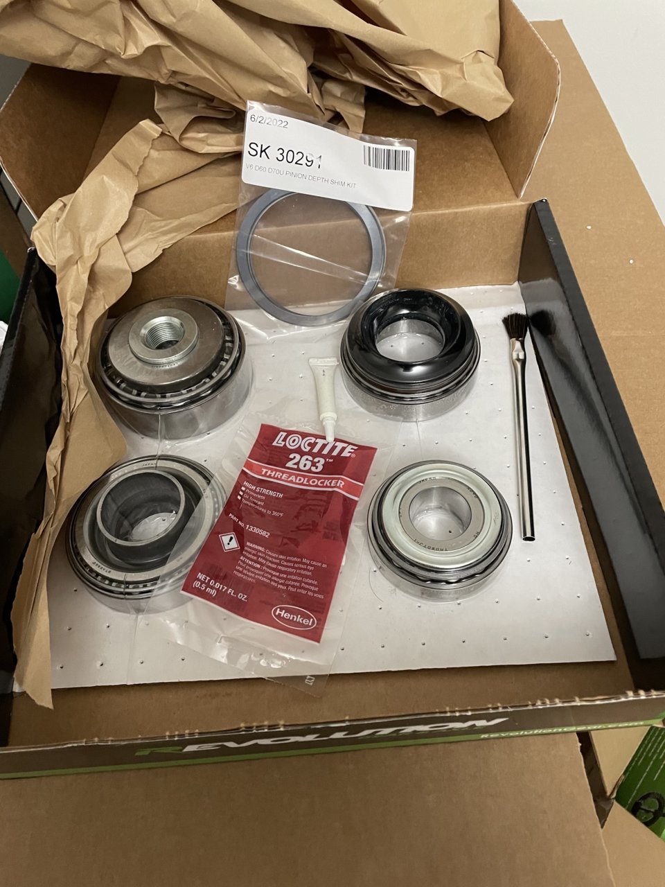

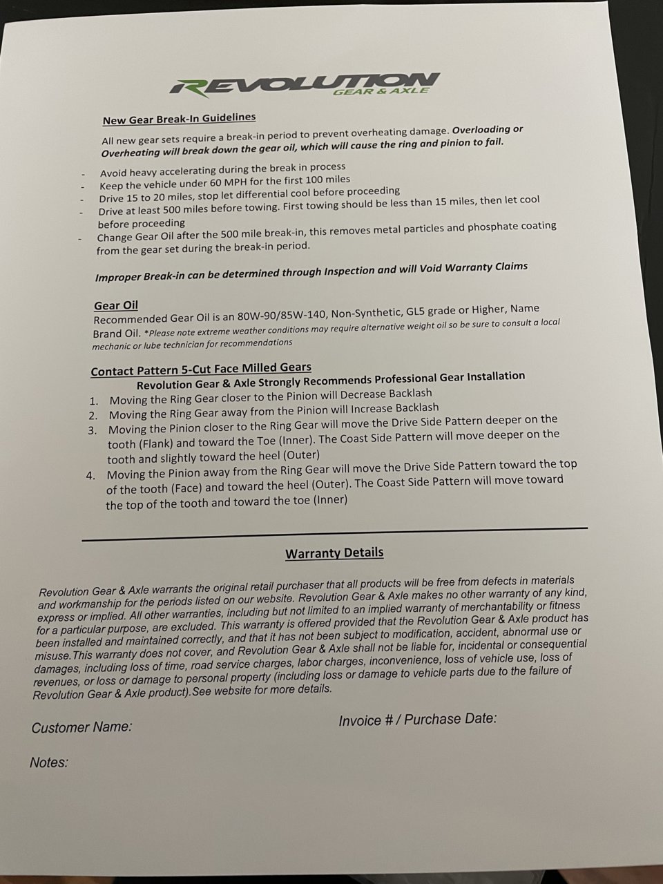

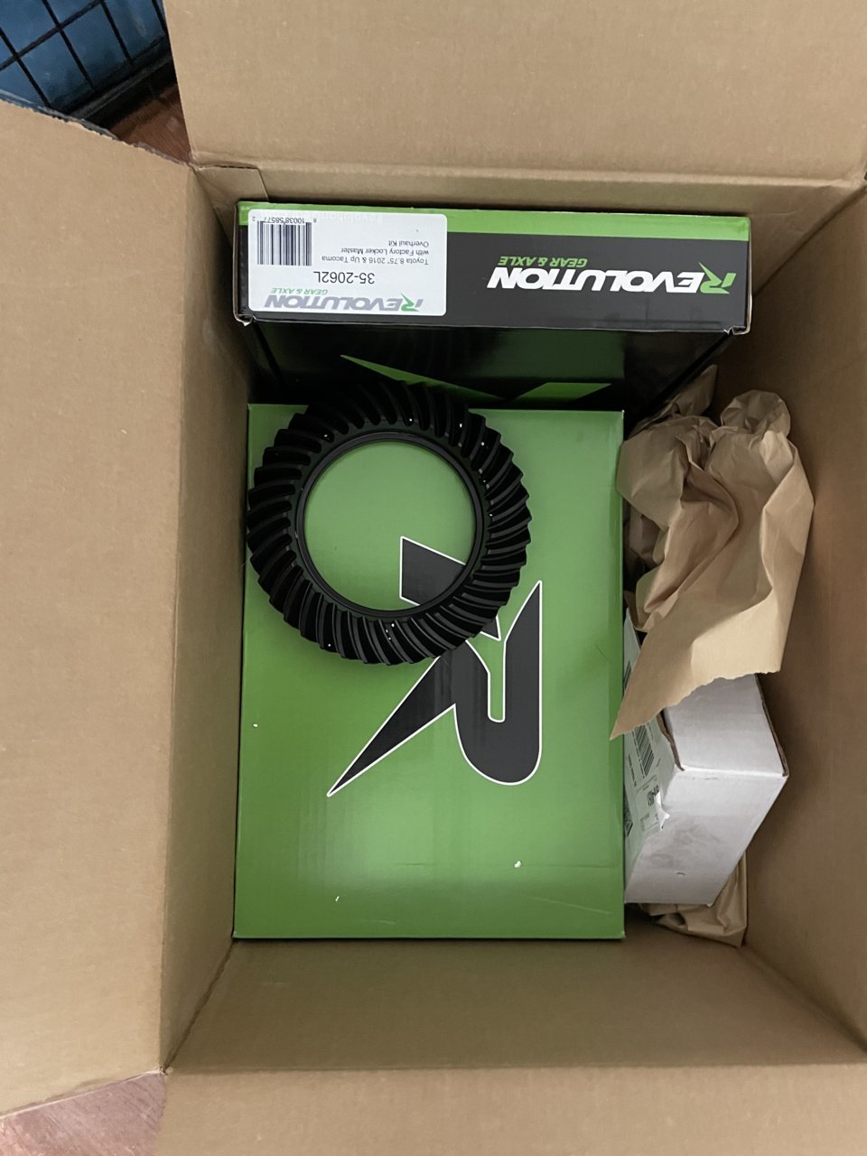

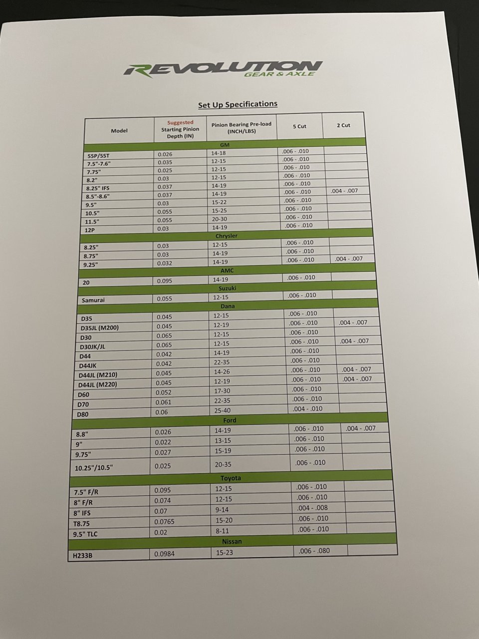

    ACA05347-38C5-4EDF-989C-BD01FD05445F.jpg A427B11E-759D-444E-A635-47611AB94388.jpg A271E757-5F61-48D7-8A92-D09A2B3D8F1E.jpg C84AD044-CEE9-468D-A201-7FEC0512EB45.jpg AD2FF88B-20E1-4280-8332-DA66D16EAD18.jpg Get the gears installed tomorrow!!

    Did the bearing kits not come with shims?

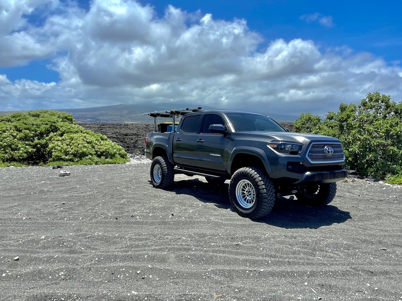

    me. But they didn’t offer 5.29 at the time I did it.
    Truck still drives great with the OV tune. But had the 5.29 been available, I would’ve done that
    I’m on 35s. Empty bed = piece of cake.
    when loaded with spare carrier/35, and fishing camping shirt (roughly 400 additional lbs), it’s doable. Even 11,000 elevation climbs (although at this point I really can feel the load from atmospheric differences - this is when I wish I had the 5.29). But it’ll still hold 60-65 in S4 without kicking to 3rd

    I should add, at that 60-65mph pace in s4, rpms just at 3500 I believe. It’s been like a month since I made that trek so I hope I’m remembering correctly
    and that mountain in the back was the drive lol

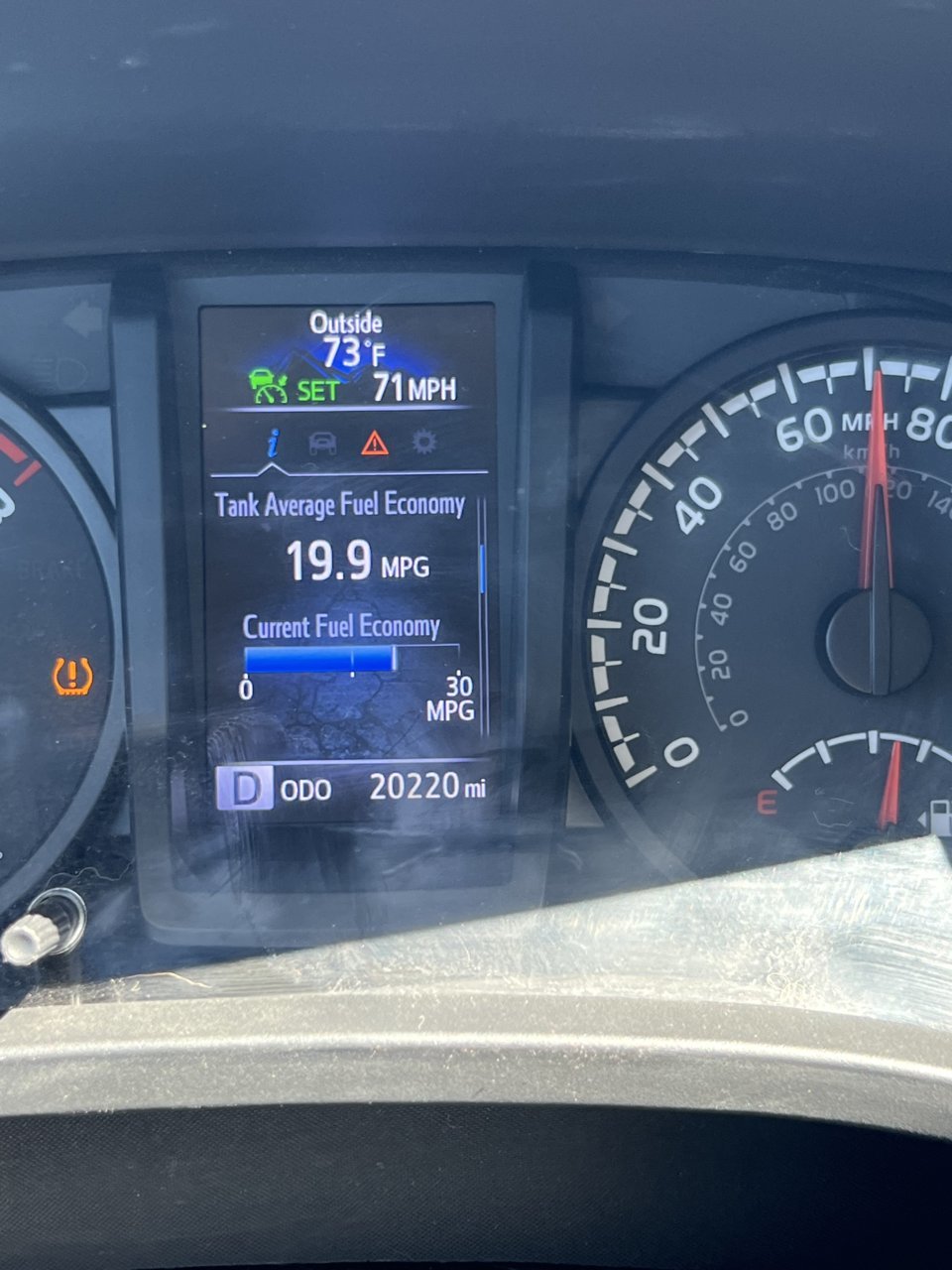

    Still averaging close to 20mpg on long freeway trips, turning 2000 rpm at 65mph. 4.88s, heavy E-load 33s, empty bed, rock sliders, aluminum engine/trans/tx skids, steel gas tank skid.

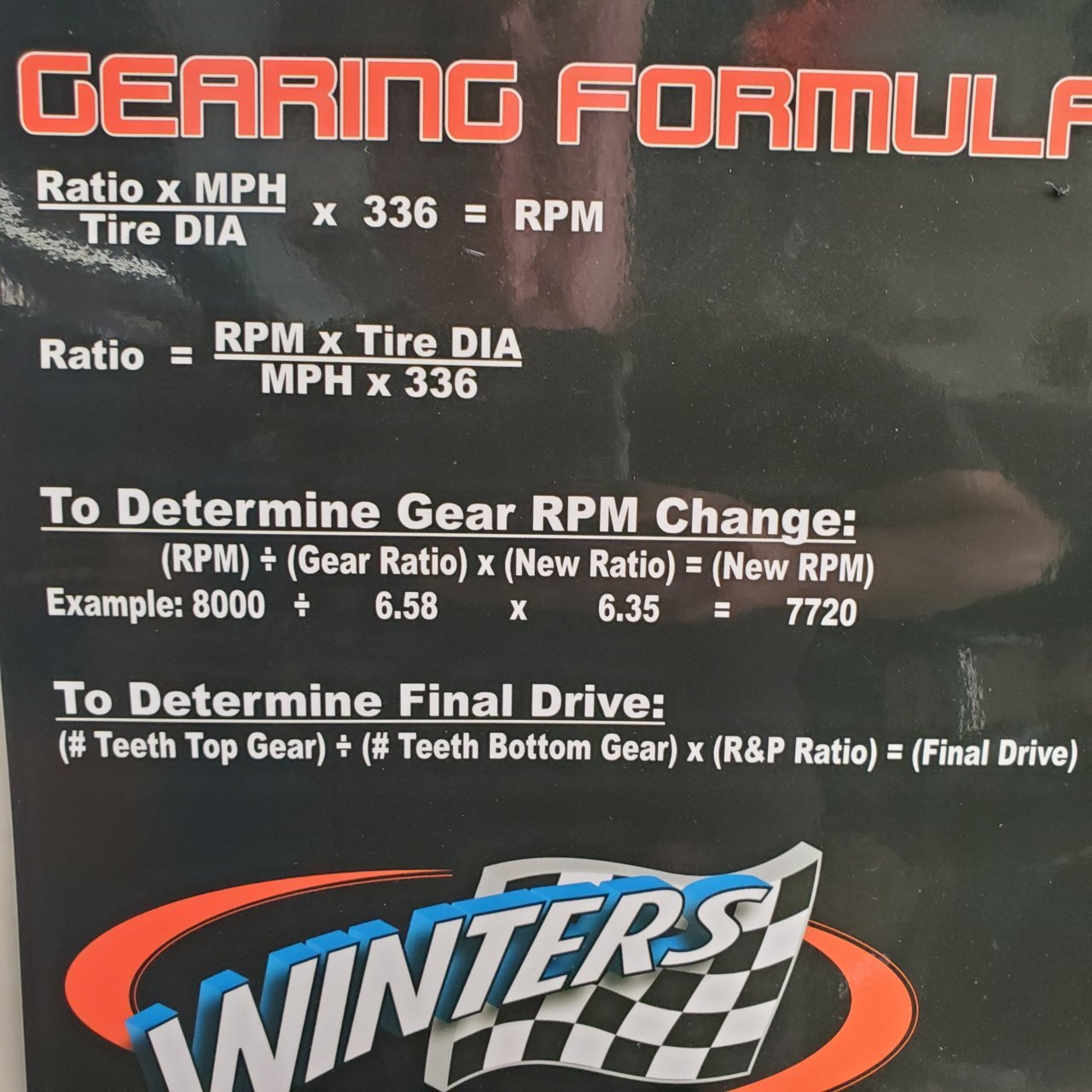

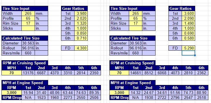

    Where can I get this calculator? I'm wanting to stay stock 265/70 16" & 4.88's and want to research the RPM differences.

    Any engine rpm calculator found from a simple google search can do this. Crawlpedia as an example
