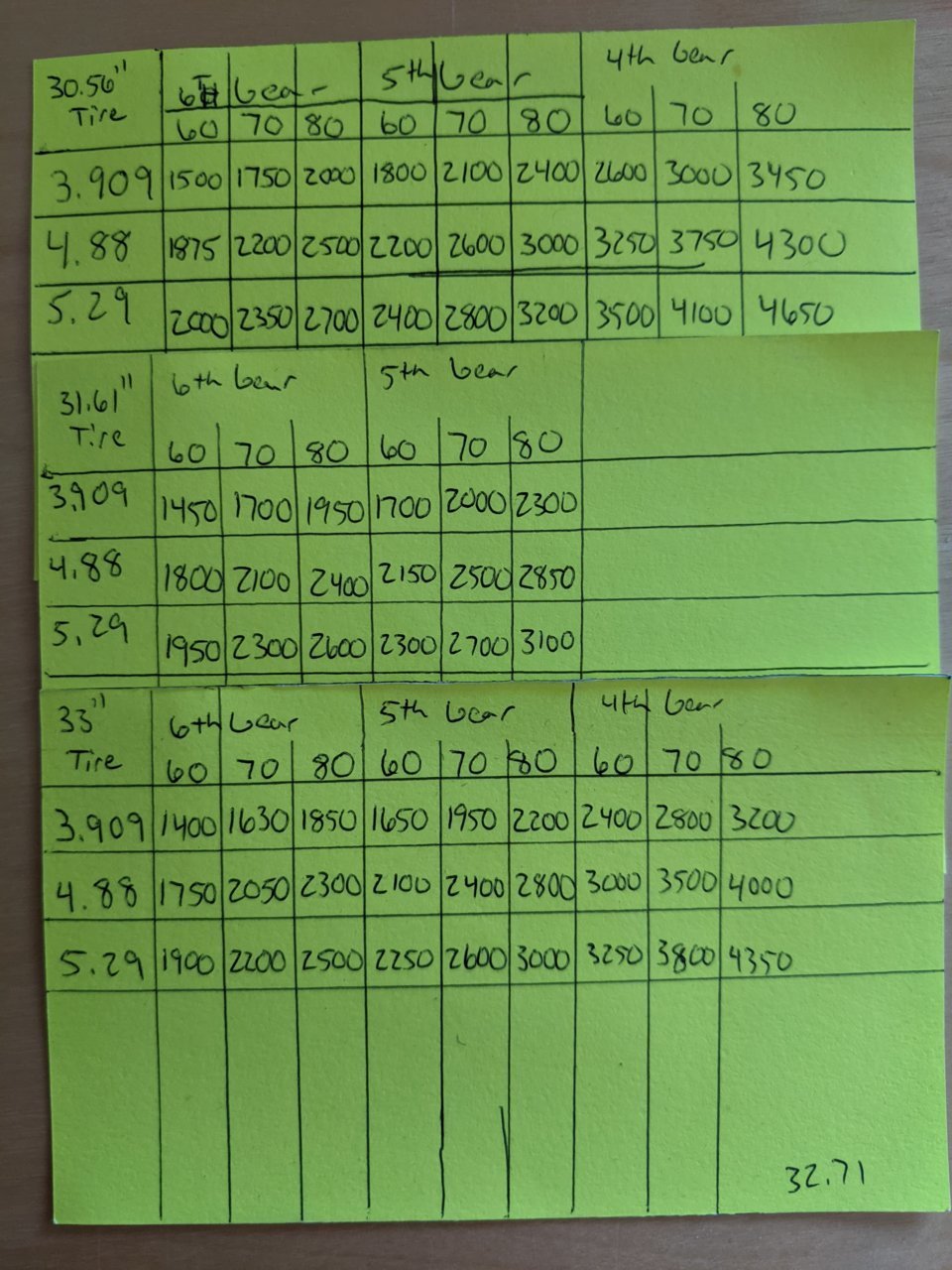

    Agreed but I wish I could have, like, 4.50s. A little lower rpm at 75mph would be nice.

    Get bigger tires!

    I've run everything from 255/85r16s to 285s to 265s and 275s. It doesn't make that much of a difference. Maybe 100 rpms.
    Edit: Confirmed, it's just 100 rpm difference between a 32 and 33. And that means even less between a 32.2 (275) and 32.8 (285). If the math is as easy as I think it is, that's just 60 rpm difference.
