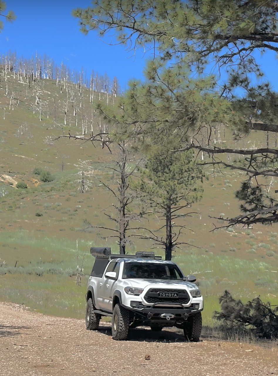

    IMG_0433.jpg 4.88’s here no complaints
    Road_Warrior and GRN305L like this.
