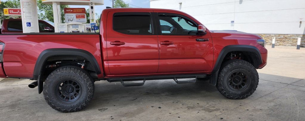

    STL
    2019 Quicksand DCSB Sport
    SCS 17x8.5 -10 offset. 285/70/17. Iron Man Foamcell Pro stage 2 set at 2.5". 4.88 gears. Rear E-locker. KDMax Tuned
    I have skinny 34"s and about 200-250lbs extra weight at all times. I accelerate just fine. I tow a 2500lb trailer and accelerate just fine with that. The only time I ever thought it would even be helpful to have 5.29 was in Colorado towing, but even then I just put it in sport and pick a gear. I have no idea how that would work with big heavy, wide, tires but with my skinny tires I have been getting 17+ mpg at 70mph on the way to work. I have a build thread of you want all the details
