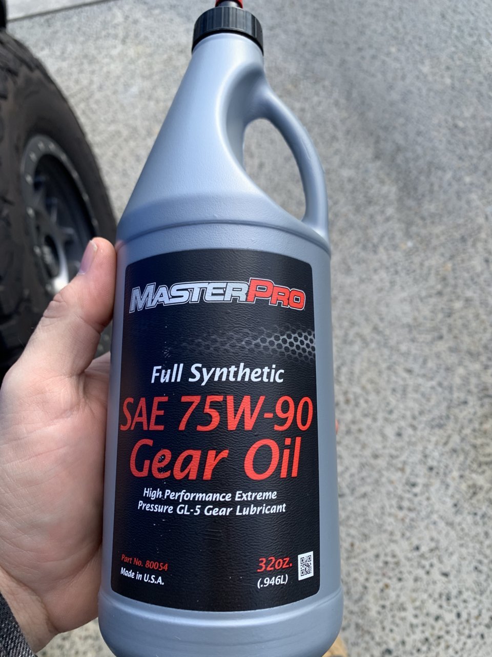

    when I ran 85w-140 no howl. When I switched over to 75w-90 after 3 oil changes I got the howl immediately - very faint but it is there. Viscosity makes a difference in harmonics with metal. This Spring I will be doing 75w-110 amsoil to see if it is still there...they are 4.88’s (wrong thread I know)

    I was told by the ARB folks and Nitro folks to run this to prevent seal damage on the air lockers.
    thoughts?
    Is there an Ansoil that is safe for the air lockers?

    Both the Amsoil 75W-90 and Amsoil 75W-110 will work fine with air lockers. I run 75W-110 in the rear and 75W-90 in the front. I have air lockers front and rear. One slight warning on gear oil choice, contrary to popular belief, a higher viscosity lubricant will cause increased differential temperatures from frictional heat. I don't think an XXW-140 is necessary.
    75W-110 is a good balance of not being overly viscous yet providing superior gear and bearing protection.

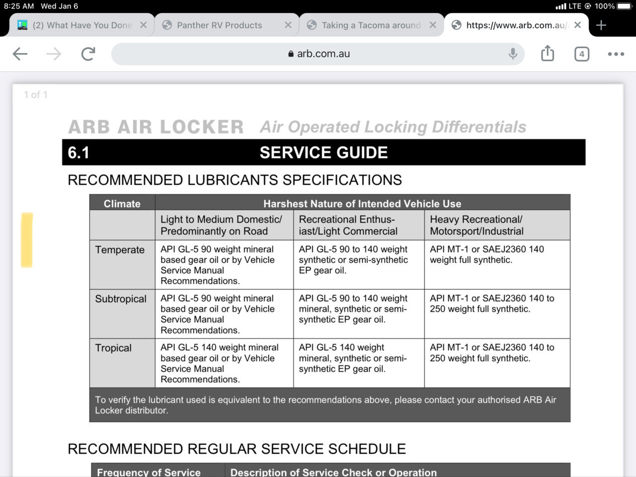

    Here’s what ARB recommends for oil, directly from their site:

    Which is why we’re running 90 to 140 weight, at least until we hit the tropics

    Honestly, I marginally trust ARB as a company. I have their lockers and compressor, don't trust some of their products, many of which are not up to par, just MY opinion. I absolutely don't trust their lubrication knowledge. You run straight SAE 140 petroleum gear oil in your differential here in WA in the winter and at the very least you will kill your pinion bearings. I cannot even fathom SAE 140 in the front diff.
    Maybe I am missing something but the MT-1 doesn't make sense either.
