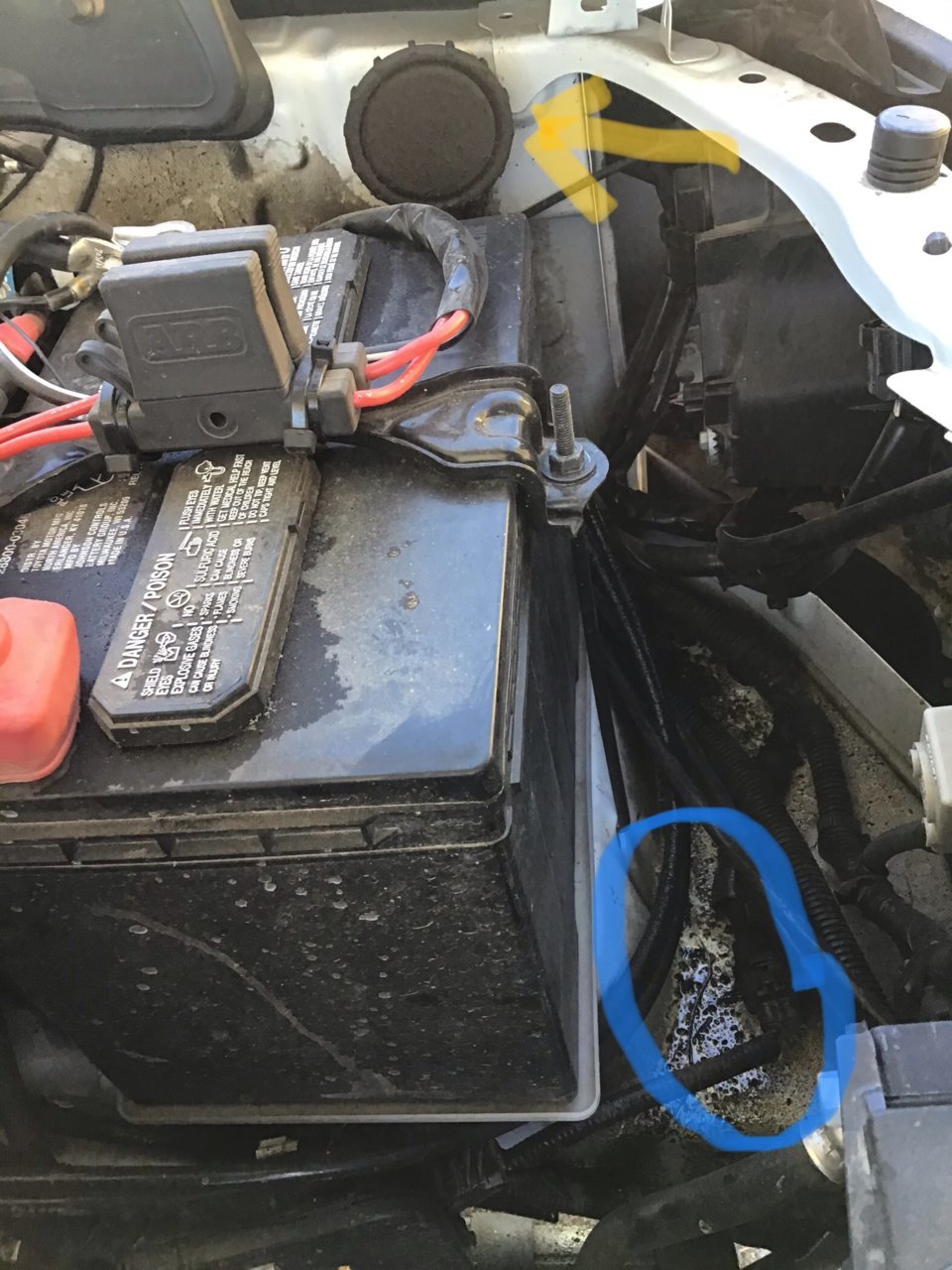

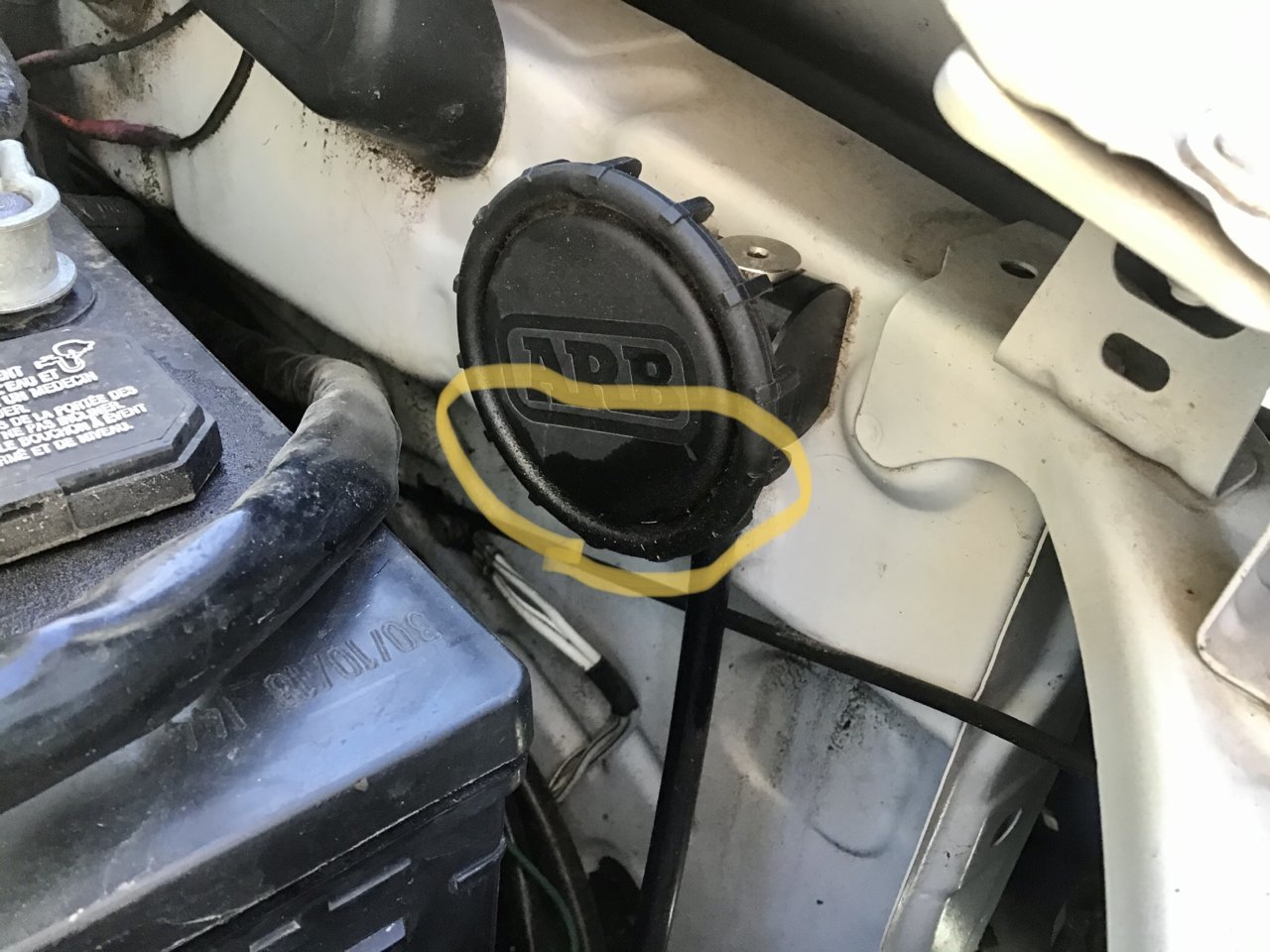

    Good to know, Ryan. I’ll check and see if oils seeping down the breather.

    yes, I’ve separated the breathers so I can see which one is the offender. I’ll try for a week or so w/o running the locker then activate it and see if it leaks then.
    good to know about ARB, that’s a sign of a reputable company trying to make it right.
    No, gave up last summer due to calls not being returned. I had heard from employees that they were very busy with new orders

    Busy and moving. Good luck. They have been so great to me. It does strike me as odd, they seem so.........proud, not a good word, but forthright maybe, about doing everything correctly. This was December 2019. Maybe they had just done a lot of leaker battles.
    BTW the battery thing seem rather elementary, frankly.

    This whole breather thing is a bit wierd. Would it be possible to put the OEM breathers back on?

    Unfortunately no, the builder tossed them.

    The tough part is done, just get a couple of the OEM (Amazon) or heck AM breathers (One way "valve", like a PCV valve) plug em in. Done.

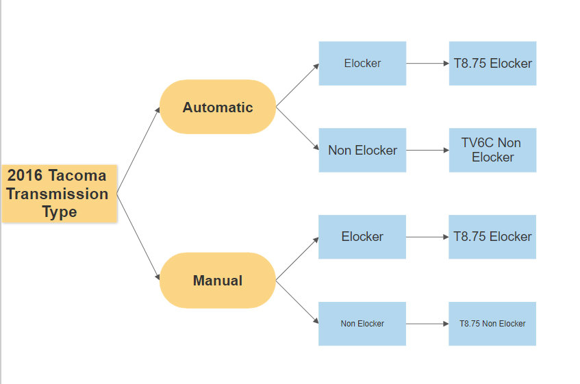

    Gear dummy here, I'm about to buy a Nitro 5.29 package.... here's the dummy part: what's the difference between the 5.29 package and the 5.29 - 8.75?

    5.29 is the gear ratio. 8.75 is the diff size. Here's a chart to help you tell which rear diff you have.

    DUDE. This chart is perfect! This is my first time dabbling with gearing in any vehicle. I've watched enough episodes of Roadkill and Hot Rod Garage to bite the bullet, but they don't feature Tacos, obviously. Last thing I want is to gut everything to realize I ordered the wrong part.

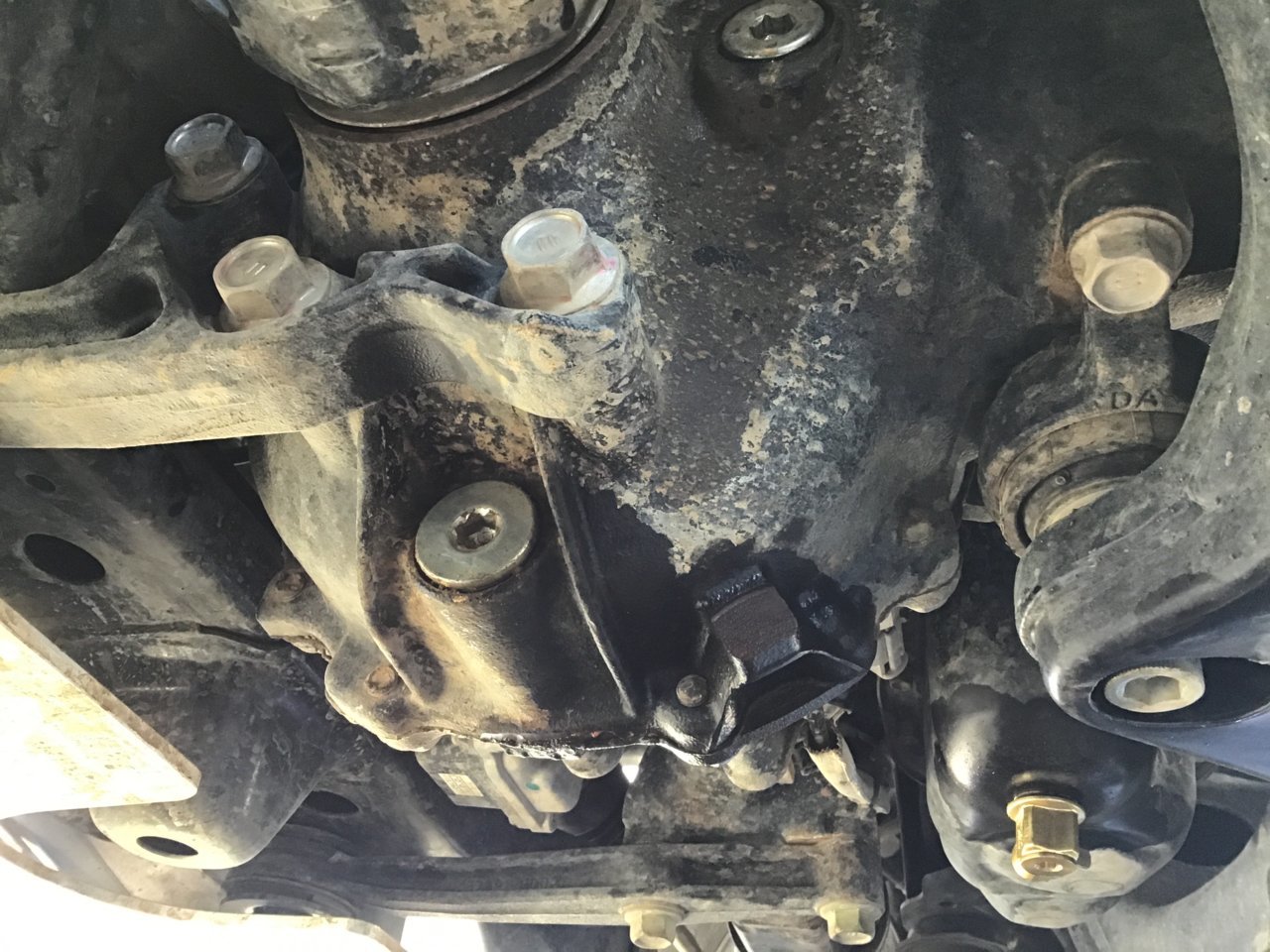

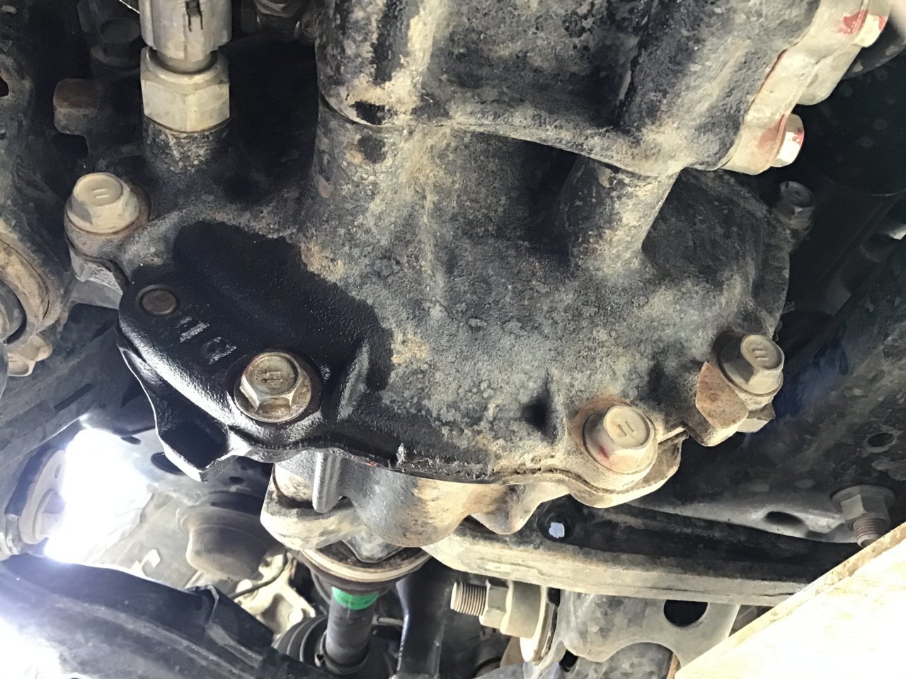

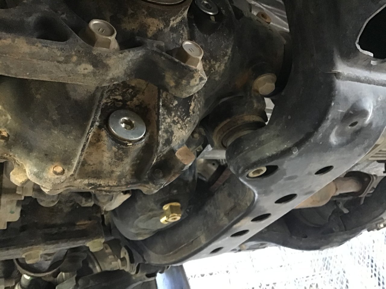

    Chris,
    1) I checked the front Diff fluid and it was just below the top of the filler plug, although it was warm, not cold. I think that means when cold the fluid level would be a bit lower. I also noticed that only the lower area of the diff was damp with oil, it’s dry everywhere else
    2) I followed the breather tube down from the top until it enters the top of the diff. Seemed to all be connected.
    3) what is the ADD tube?
    Thought I’d include a pic showing the filler and drain plugs both of which are dry
    Here’s a pic of the backside,notice weeping around the two bolts
    RyanDCLB and Bigdaddy4760 like this.

    10 Taco 4x4
    A bunch a cool stickers, a bada ass MetalMiller Tx Longhorns grill emblem painted Hemi Orange, JBA long tube headers with o2 sims, Diff breather mod, Red LED interior lights, Fancy head unit that plays ipod n movies, Also DIY install factory stuff like, factory cruise control, factory intermittent wipers, OME nitro struts with 886x springs and toy tec top plate, JBA high caster UCA's for better alignmnet and dey beefier too, Old Man Emu Dakar leaf springs in da rear with the gear, U bolt flipper, Ivan Stewart TRD rims with 33" K Bro 2's, some bad ass weather tech floor liners so I don't muck up my interior, an ATO shackle flipper for mo travel in da rear wit the gear, also super shiny Fox 2.0 shocks back there too, all sorts of steal armor for bouncing off of the rocks like demello sliders, AP front skid, trans skid, n transfer skid, demello gas tank skid, and a tough as nails ARB bumper with warn 8k winch, I'm sure there's more
    Ok, looks like either the drain plug is leaking. Maybe needs a new crush washer and torqued to 30ft#'s. Or the housing isn't sealed good in the area it's leaking at. Since the back side is wet, I'd lean more toward the housing. That temp sensor doesn't appear wet, but sometimes that isn't sealed all the way.
    The ADD tube is the extension that goes from the main body of the diff to the passenger side CV axle. You'll see 4 external torx bolts (e14) connecting it to the diff with the ADD actuator attached to it.
    I'd spray all the fluid down with brake clean and wipe thoroughly to pinpoint where the leak is coming from.

    Home's our Tacoma
    2019 Tacoma AC LB TRD Sport MT
    flatbed with 4WC Fleet with extensive mods

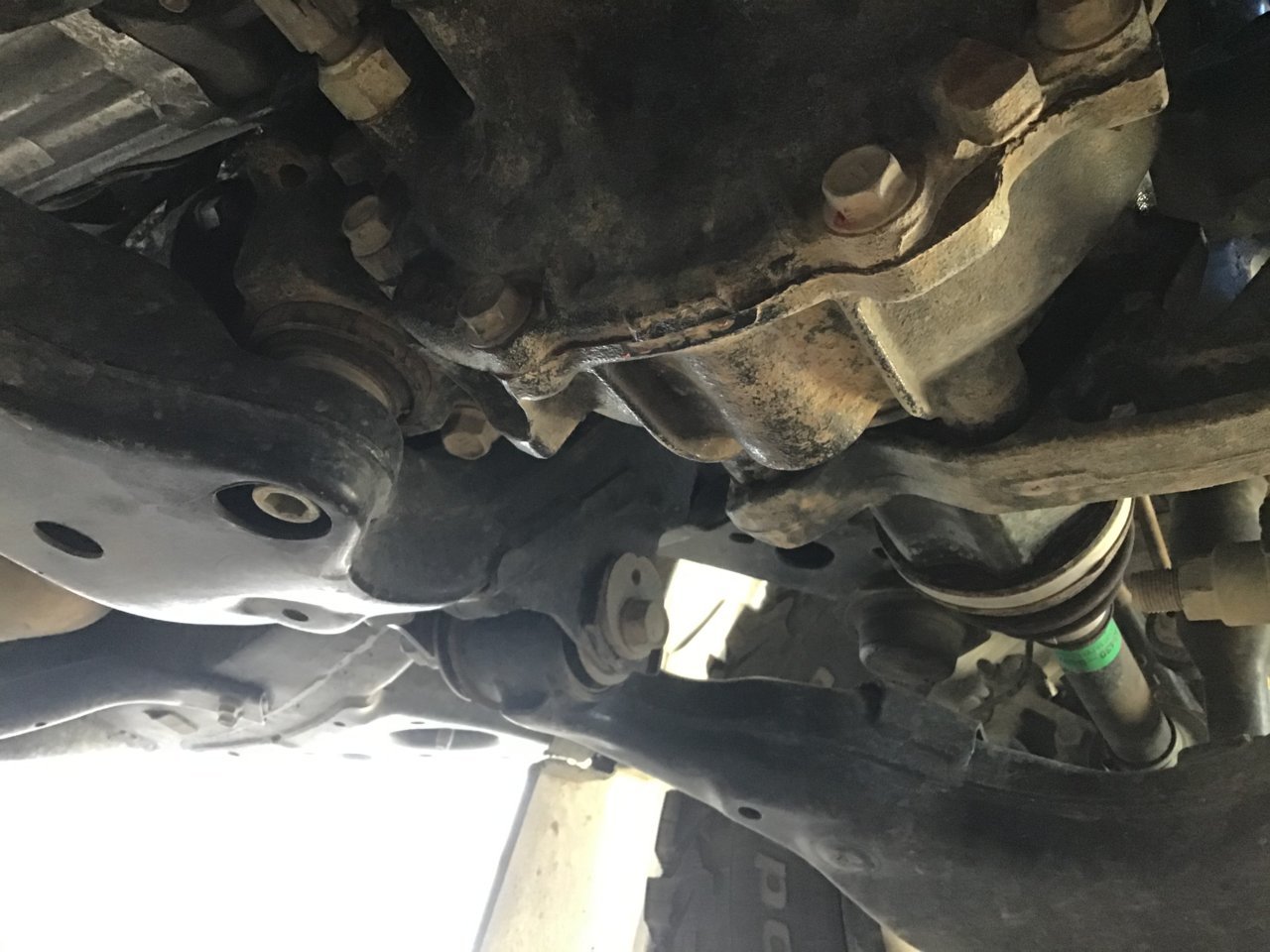

    Sure thing! I separated the diff breathers. With @Texoma suggestions I used brake cleaner to clean up the diff and the breather area and then waited few days and saw that there had been no fluid leaking anywhere - so far so good.
    I then ran it in 4wd with both lockers engaged climbing a minor hill and checked again - again no leaks.
    a week later I checked and the diff is dry
    Here’s the same view from the drivers side:
    All dry around the diff!
    now for the bad news:
    The front diff is now leaking a bit...
    xxTacocaTxx and Pablo8 like this.
    That "leak" on the breather could just be vapor/mist. Those lines are so small ID that a bubble of oil can get trapped and push its way up too.
