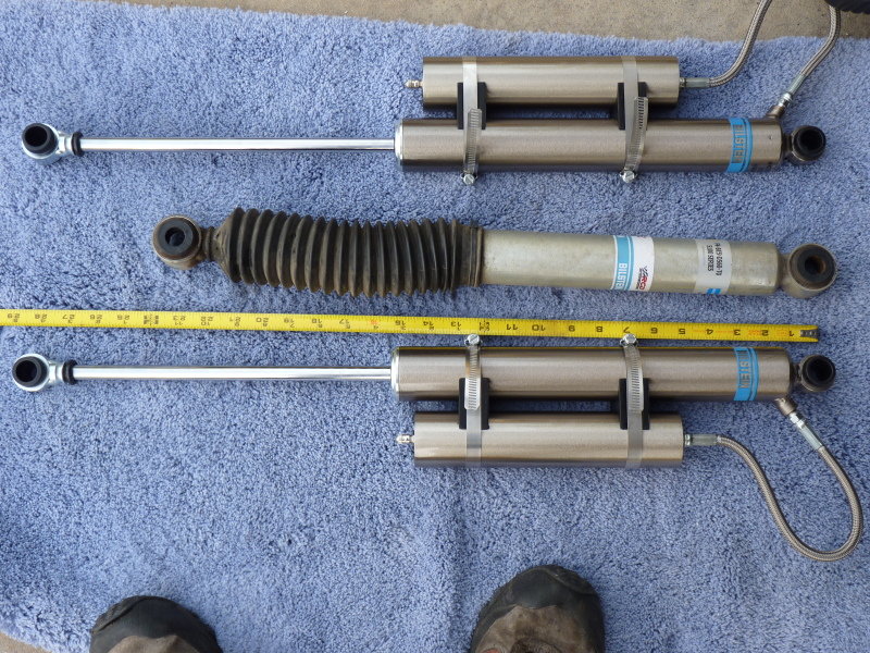

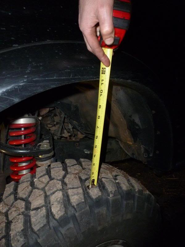

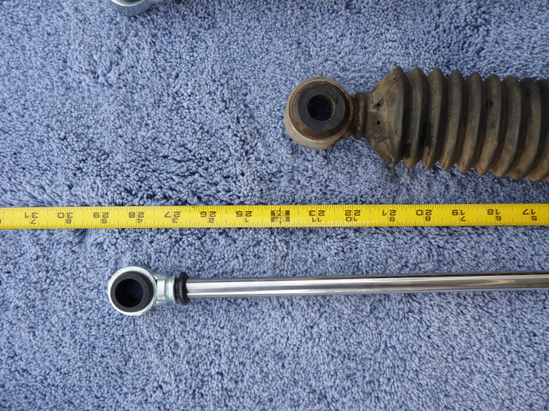

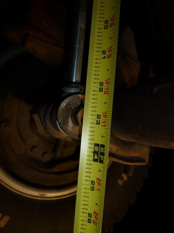

    So, I did some measurements last night and had some interesting results. It looks like my shocks have 5 more inches of extension left in them. (extended length of the shock is 28" and full extension on the truck is only 23")

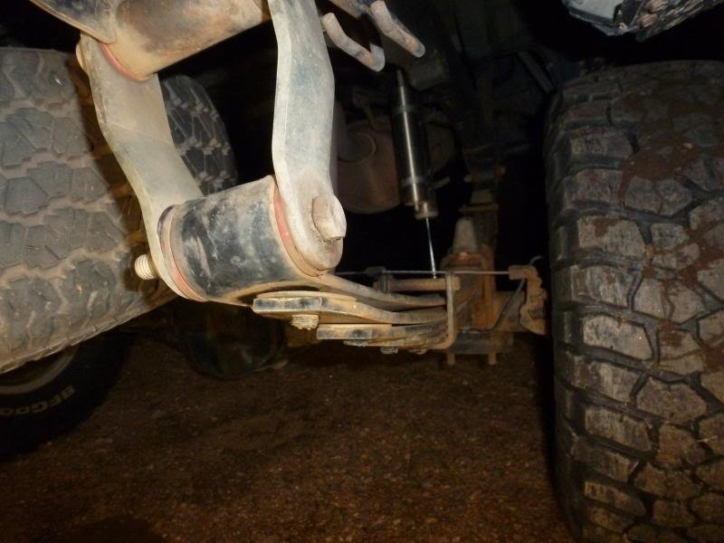

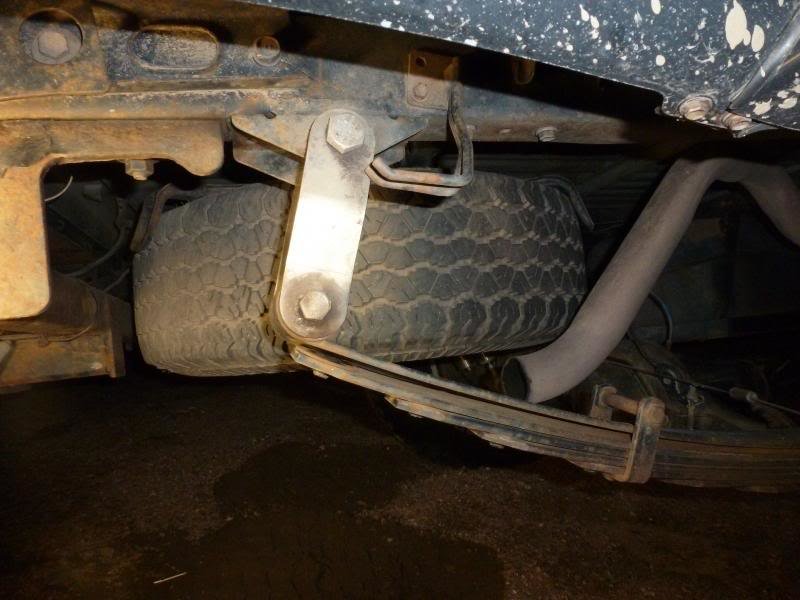

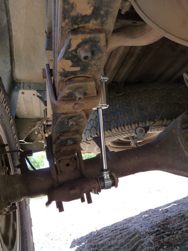

    The reason seems to be the binding in the leafs at extension:

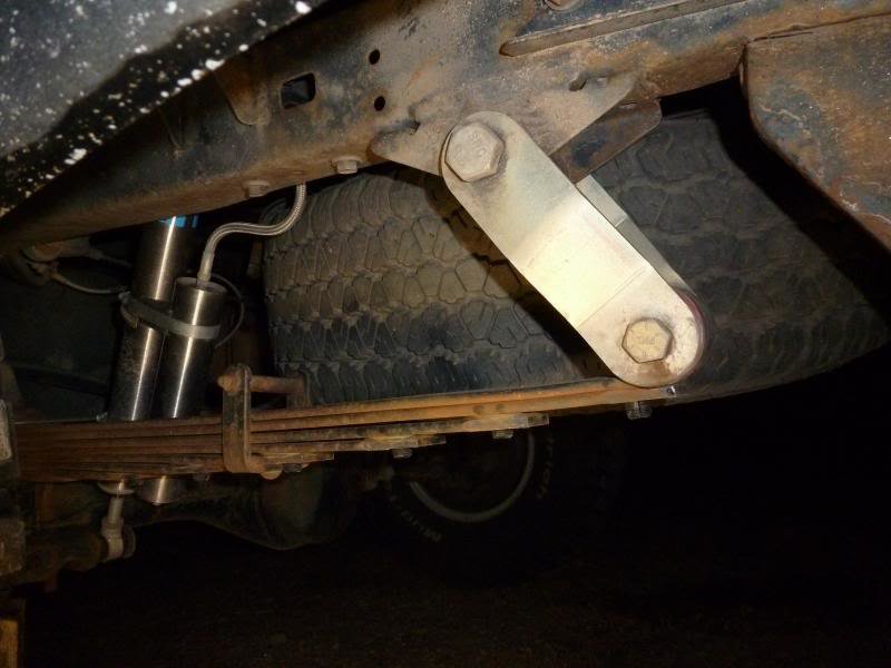

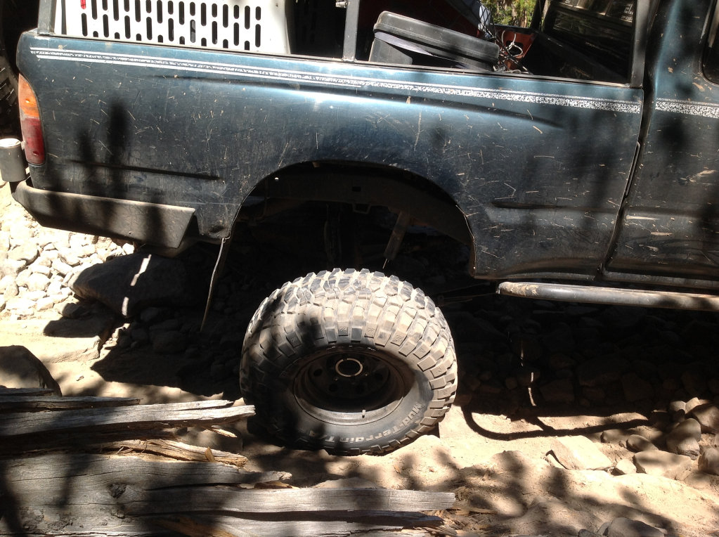

    The shackle angles show me that I need a longer main leaf. Here are a couple pics at full compression and full extension. (I've done the calculations and figured out that, if I go with a one inch longer shackle, I need a two inch longer main leaf giving me a 47 degree shackle angle. I'll post a thread about how I figured that out sometime.)
    Full Extension:
    Full Compression:
    Does anyone else have bad binding problems in their leafs?

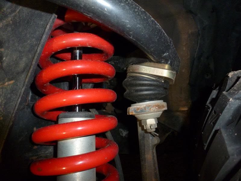

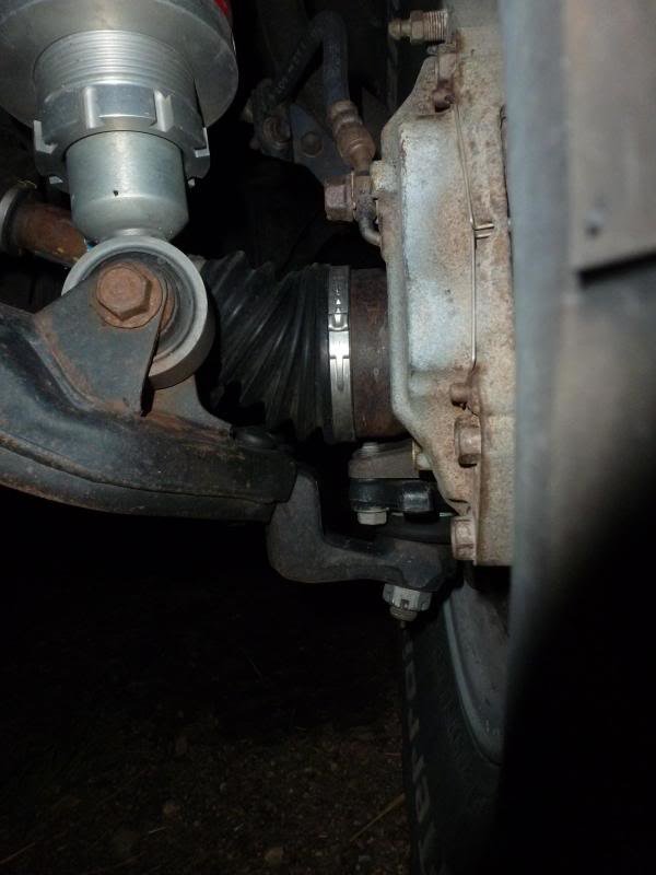

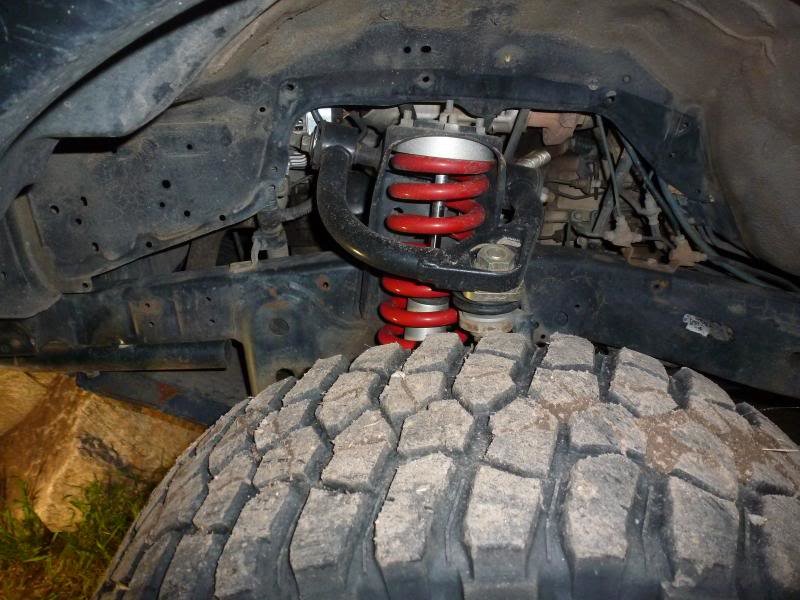

    The front suspension, on the other hand is looking good. Almost exactly 11" of wheel travel, and my Light Racing UCAs have plenty of motion left in them:
    I don't think I want to go any longer on the shocks because the axle is already at a severe angle:
    So, overall, I think I might order up an Alcan main leaf, 2" longer than I have now. And I'll get a 6.5" Orbit eye Shackle setup. My hope: around 4" additional down travel. What do you all think?

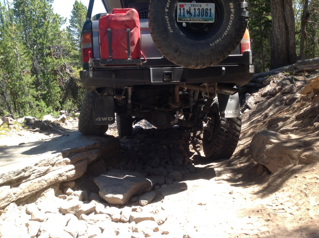

    I don't seem to have leaf binding...My main leaf is a Alcan from a Wheelers 5 pack. 1'' lift shackles..
    ive never really measured my wheel travel tho..droop a 33'' tire past my sliders tho..
    not surprised you have a lot of shock left. 12'' shocks are huge on our trucks. Really you should relocate them like /\. Your shocks are probably binding as well. I almost went with orbit eyes too. But was told by Alcan they don't handle weight great. So i didn't .

    Man, your shackle angles tell the story. It looks like they are moving waaay more freely than mine. Also, it looks like you are running 3 or 4 leafs in your pack. I wonder if the fact that I've got 8 in mine is part of the difference. It seems like each leaf is helping the others resist the torsion. Whatever it is, I want my suspension to flex more like yours....
    It's interesting that Alcan told you that the orbit eyes didn't handle weight well. I'll have to ask them more about that. I mentioned that I am going to build a rear bumper with a tire carrier for expo trips and they said the eyes should be fine, but I never asked explicitly about weight. I'll call them on Monday and check on it.
    Out of curiosity, which shocks are you running and are you still in the stock mounts? I'm just wondering what lengths you are getting and if you see any binding in your rear...
    Thanks, as usual, for the info Blackdawg.

    Interesting, I've never seen leafs bind like that. I stand corrected on the shocks, yours appear to be plenty long enough.
    The first thing I see is that the bolt on the rear of your leafs looks way to tight. That could be your binding problem right there? Secondly, what kind of bushings are you running? The bushings themselves should be flexing much better then that. Third, the clamp thingies that keep the leafy even, do they appear to have any wiggle room when flexing? And lastly, what does the front of your leafs look like at full flex?

    actually i have 7 leafs..so not that far off from you..
    Maybe your shackles are too tight?? I know i tightened mine too much the first go around and was like..WTF?!..then loosened then a bit..flex great now.
    And well it was a year ago :notsure: I honestly don't think just one makes that big a difference..nets you MAYBE .5''..and they are sooooo expensive. Plus you have to get custom shackles made by Alcan too as the Ordbits are much wider or something so normal sized ones don't fit.
    I have just billy 5150s :eek: 10'' travel. Im sure im maxed something out tho..they leak pretty bad now..
    Honestly i haven't seen much binding..im pretty happy with my rear setup. Id like to relocate my shocks like /\ and get some 11'' ones or 12'' and better shocks then my current ones. Something rebuildable at least..

    I think you're onto something with my lower shackle bolt. I'll try loosening that up and see if that nets me more flex.
    I'm running prothane bushings, which are pretty stiff. My hope was that they would break in, but they are holding up almost too well...
    As for the clamp thingies, I think there is enough room to move in there. It looks like they let the top leave bend. What do you think?
    Also, the front side of the leafs were just going into negative arch when I took the pic. This picture is from a different day... it's just a little more extreme than the negative arch the other night.

    i actually don't have one of those retainer clips blot in either. The leaf that has the clip is too low so i can't fit a bolt on them. I bet that is one of the reasons i droop so well too.

    Well crap... Maybe I'll head out to the garage right now and loosen those bolts a half turn or so. I didn't realize you had 7 leafs in there.

    Also, your 10" 5150s and my 12" 7100 Short bodies have basically the same compressed length. If you're looking for something to swap in with just a little more travel, I've been impressed with mine. Plus they're rebuildable and I like the bling!:headbang:

    Yea try loosening the shackles. And take out that retainer clip top bolt.
