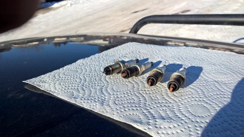

    10,920
    Wyoming
    2011 RC Tacoma
  17. Jan 2, 2016 at 1:13 PM
    #717
    Blackdawg
    Blackdawg Dr. Frankenstein
    Dec 31, 2010
    #48500
    81,621
    Monte
    Wyoming/St. Louis
    The Trifecta of Taco's
    Wow that plug is fucked. Hope the rings on the piston aren't bad
  18. Jan 2, 2016 at 1:15 PM
    #718
    BabyTaco
    BabyTaco [OP] Well-Known Member
    Jan 10, 2012
    #70380
    10,920
    Wyoming
    2011 RC Tacoma
    That one is the one closest to the cab. Looked at the intake really well and it looks like it has a nice coating of very fine dust. No huge chunks but still something :pout:
  19. Jan 2, 2016 at 1:15 PM
    #719
    Sacrifice
    Sacrifice Motorcycle Goon
    Oct 8, 2013
    #114093
    15,978
    KS
    DCSB OR 4X4 LT
    Pelfreybilt Front Bumper,BAMF sliders, Airflow Snorkel,Mini D2S Retrofits, ADS Rear Shocks, Deaver U402 Leafsprings, 35s, AllPro +2LT
    If its that bad something is wrong with that cylinder. Either a valve seal or rings.
