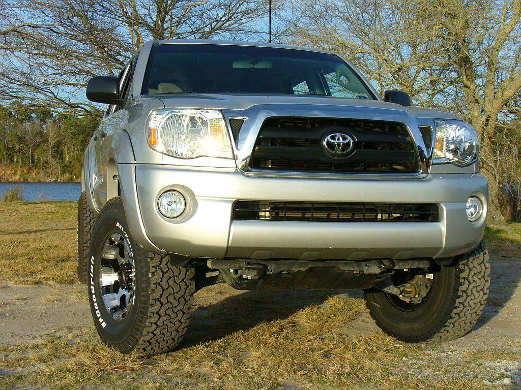

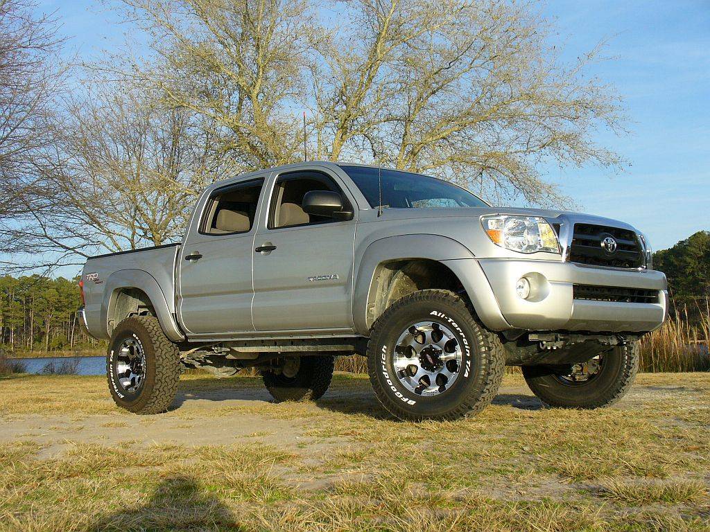

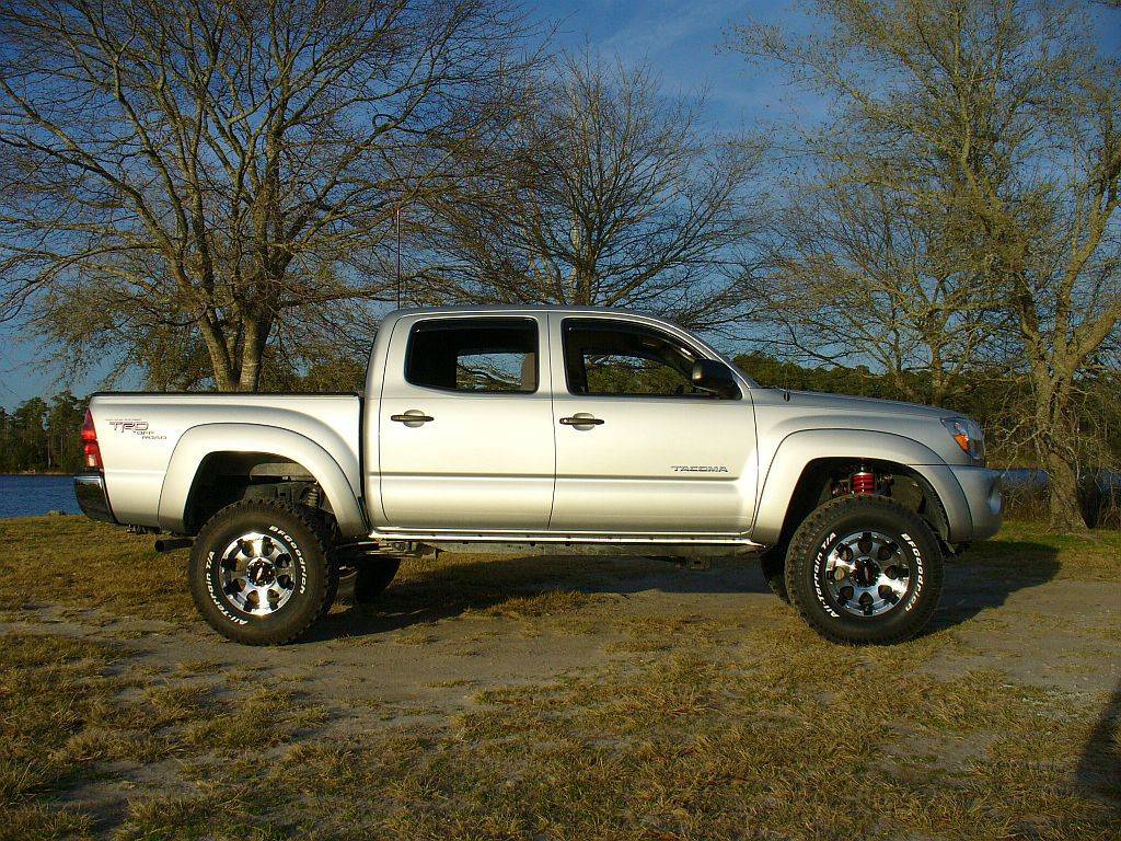

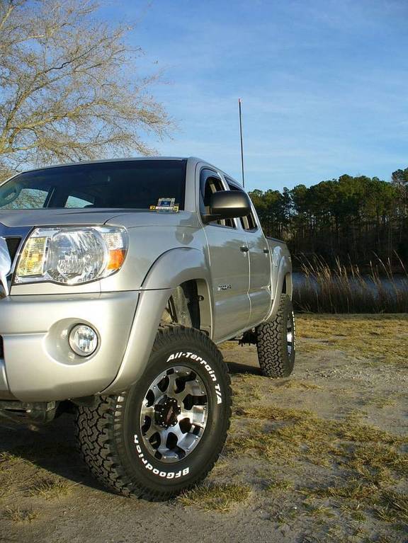

    After the Toytec Coilovers, AAL, new tires and rims!
    Edit
    My setup:
    Toytec CO's set to give 3" of lift up front.
    Toytec AAL (TSB version) gave 1.5" of lift on top of the 1" I got from the TSB
    ProComp rear shocks
    Differential drop
    Sway bar drop
    Rear shims 3*
    Total Chaos UCA's
    Moto Metal 0955 16x8
    BFG All Terrains 285/75-16
    I had to do a little trimming in the front fender well to keep from rubbing.
    I do not have any fitment issues with the rims and they accept the TPMS from the stock wheels.
    As far as the cost goes you can add the #'s up and subtract 10% from most for my Military discount.

    Looks awesome.
    Is that the Ultimate lift kit? how does it ride? I'm debating if I should go for that lift or bilstein 5100.

    Thanks guys for the comments.
    Yeah, it's the Ultimate kit. The ride is firmer than stock, but not too firm.
    More than I imagined I would be spending on the truck.
