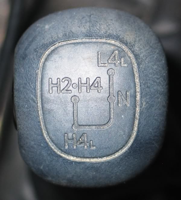

    Wow, that's cool. So your Multimode is the one that is completely manual? Meaning your shifter is like this?

    Yes, that’s the shifter I have, however, it’s not manual like you are thinking. The 2-4 shift only activates a switch on the side of the tcase. The ECU detects the switch state change and commands the shift motor to turn to the proper position. This is needed because the ECU strategy is to lock the tcase first. Then once the components are up to speed the center diff is unlocked. Make since?
