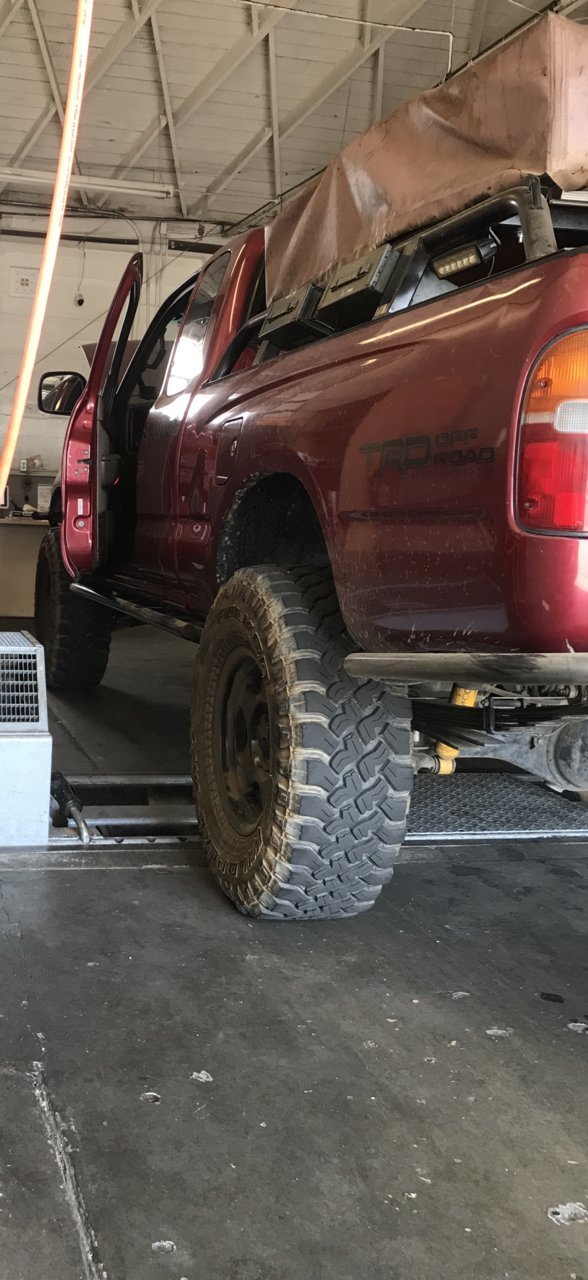

    Smog check.... pass:thumbsup:

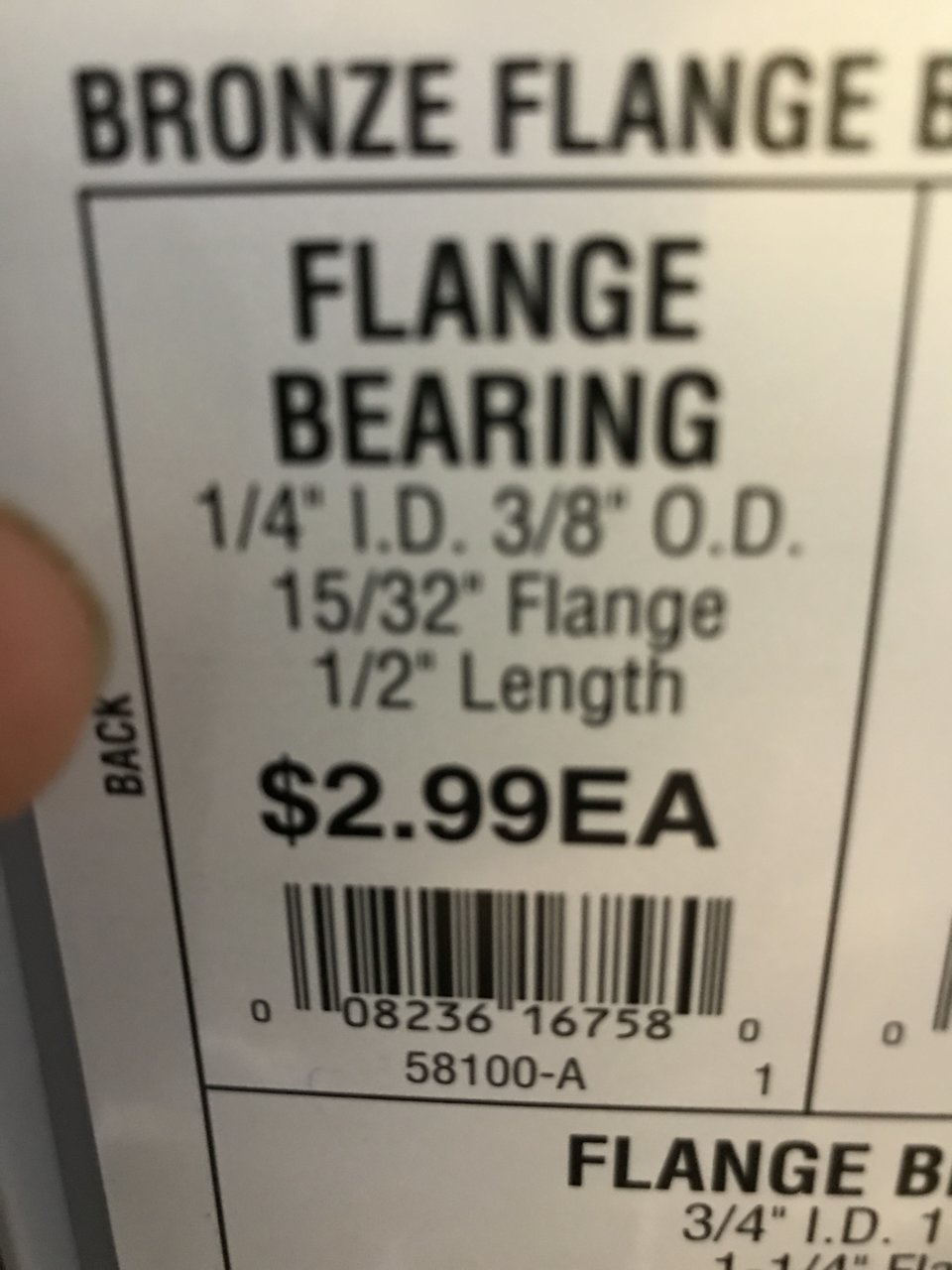

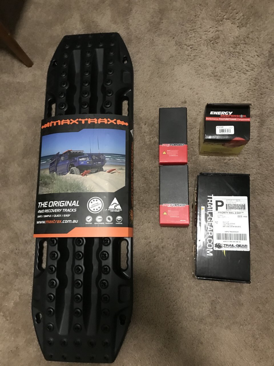

    Been collecting a few things to refresh steering components and my wife bought me some max trax for my b day!
    Also picked up some bronze bushings the mod the clutch torsion spring

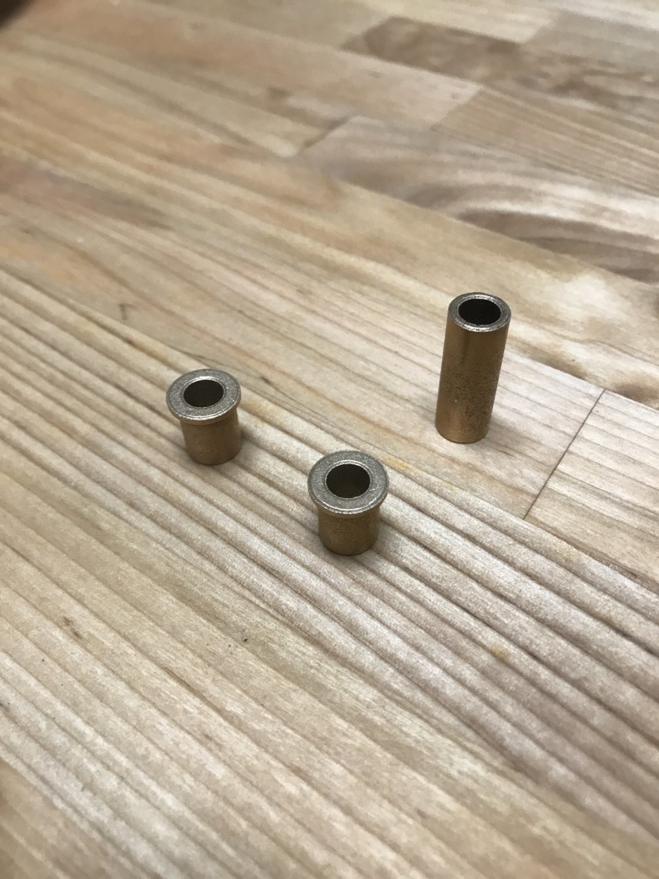

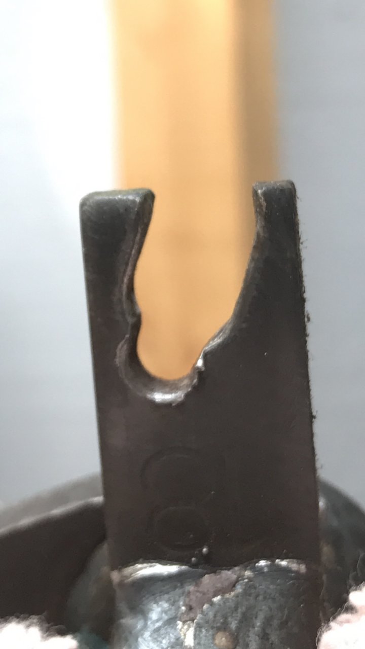

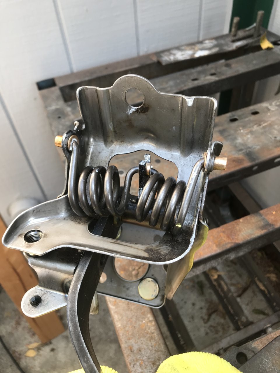

    The BEST MOD(an most annoying) The Infamous Noisy Clutch Pedal
    My clutch as always had the squeak us MT owners are used too. Finally after 4 years of ownership I came across this https://www.tacomaworld.com/threads/clutch-pedal-squeak-new-bushing-design.76599/
    Ive seen the linear spring method but felt it deviated from the original design. So bronze bearing replacement was better (IMO).
    so goal is to replace all connections of the torsion spring with bronze bearings.
    960D129E-E006-4183-8024-5564322BB781.jpg 5D13EE1B-4F5F-41C5-848C-6F9632B17F8C.jpg DEB4C210-F9B6-4F09-A1CD-99F68E9940D5.jpg
    After I removed the clutch assembly, it was worse than expected.
    So it’s been metal on metal for a while now. Oh and both thru holes for the spring ends (Where the flange bearings will be seated are seeing the same issue).ALSO dam spring had a grove in it in the center mount location. So disassembled the whole assembly and got the welder out and did some weld build up to restore the bearing surfaces, even the spring. Grind and redrilled holes and painted. Reassembled and modified the bearings and final result....
    Note: the C bearing in the center needs the be small in width, anything to wide will force the bearing to rotate and fail as the radius of the spring will catch The side of the bronze and slowly initiate a crack and split the bearing in half.
    Overall it took about 6 hours total from beginning to test drive.
    The state of the clutch assembly was a surprise and most of my time was spent fixing it, im not a fan of welding on such thin walled material or welding on a spring.
    But, was it worth it?
    YES! So far the clutch is butter smooth and no noise it’s amazing!!!!!!
    it will be interesting to see how long these last as there is a decent amount of force applied to the bushings and it will see a high number of cycles

    Pretty stoked with the tube mounted bag, so I pick another up for the drivers side, and a tow strap.

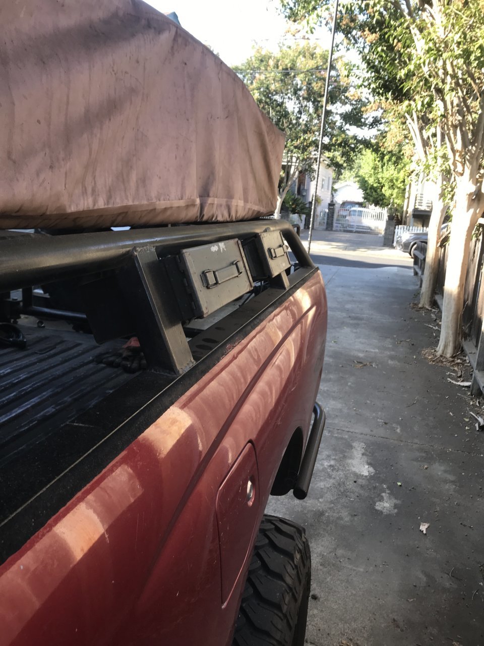

    Ammo box got swapped out, so I could have a permanent home for the water port.

    29,298
    J A Y
    what's the mileage on your clutch?
    i've had that interior assembly pedal squeak off and on for over 20 years! and it usually gets very noticeable when the seasons change to very cold (below freezing) and maybe added moisture in the air in the spring activates it again
    did you spray the new parts with any lubricant?
    i found this magical concoction from Canada called Nut-Z lube and sprayed what i could reach close to a year ago now and it eliminated the squeak but introduced another odd noise that might be a plastic part idk yet
  10. Sep 27, 2020 at 9:15 AM
    #470
    Fuergrissa
    Fuergrissa [OP] If you build it, trails will come.
    Jan 9, 2013
    #94858
    2,063
    Devin
    San Jose
    2000 T4R Limited
    The clutch is the original, so it’s at 137k. It’s not terrible yet, but not fun when trying to accelerate on a freeway on ramp and watching the rpms run away from you when you shift to 3rd gear hahah.
    For the pedal assembly I used white lithium for every rotating bearing surface. I have tried spraying in the past, but it never lasted And there’s so much wiring and crap under there I never knew if I was hitting the right spot.
    This the stuff your referring to?
    https://corrosionfree.com/store/nut-z-lube-corrosion-fighting-lubricant-2-pack/
    GQ7227[QUOTED] likes this.
  11. Sep 27, 2020 at 10:23 AM
    #471
    GQ7227
    GQ7227 mw survivor
    Dec 6, 2018
    #275019
    29,298
    J A Y
    yes, that's the spray I used, but i definitely did not pay $10 per can!, it was ~$3 per with a 70% discount after buying some product of theirs to spray in the door and tailgate inner seams to try and keep that salt water out of those areas.
    I will suppose the Nut-Z lube is good at fighting any humidity corrosion too
    so far i have not yet had that slipping in 3rd or other gears at 165k (mostly highway cruising for that mileage) but lately have been noticing some funky stop and go stuff in 1st, might be the throwout bearing idk, also a severe cold weather startup lurching when the pedal is released in neutral
    but am going to try and get it past 200k so i shall see hahah

    nice man! well hope you make it to 200k. I do get occasional squeakiness from the clutch fork but little grease here and there fixes that.
    Ive owned the truck for 37k and very conservative with my clutch use, I just don’t know how the PO drove the 100k. It doesn’t really surprise me though. Again, it just the initial signs of of wear/warning for replacement, so I’ll just knock out the maintenance, as my wife and I are headed to Utah in 2weeks and I dont want to Be driving around with constant reminder.

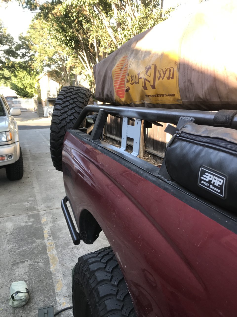

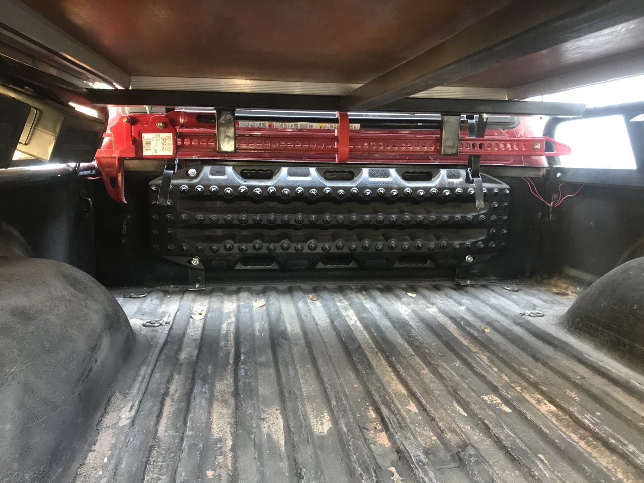

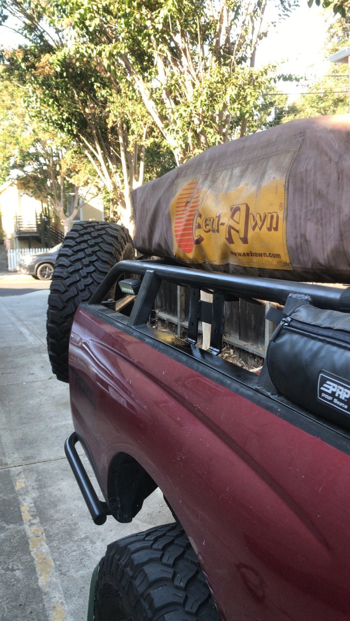

    Modified the bed rack to reposition hi lift on the cab side, added a crossmember max trax mounts and added some quick fists for the awning pole
