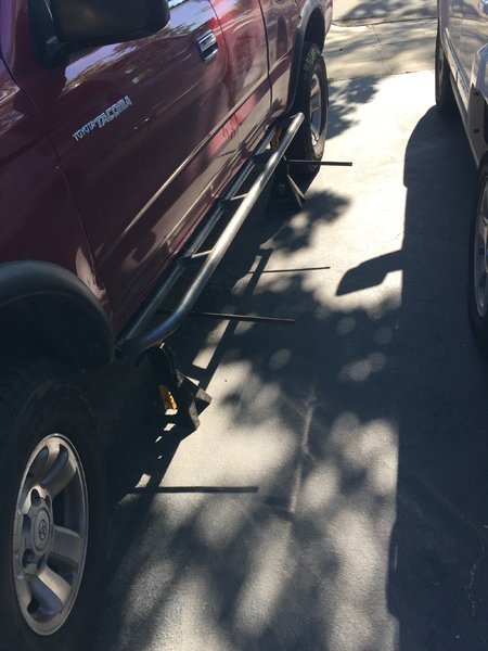

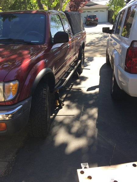

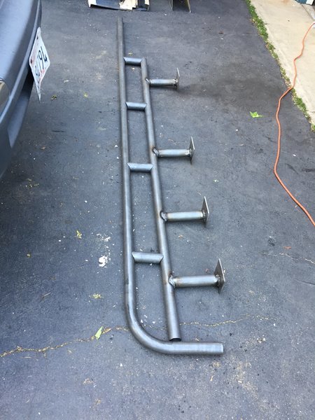

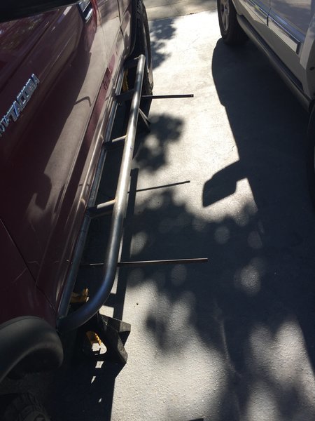

    Pretty much all I got done was notching, but its one step closer.
    Mounted the base of the sliders to the frame for visual fit (not welded to frame)
    Glad I decided to go shorter, I'm really liking the fit.
    Choose to go with 4 inch spacing on the kick outs, if the notches look gappy, it's cuz this laying on the ground. Everything is actually flush!:yes:
    I can't remember where, but a video on YouTube said the use a 1 7/8 hole saw on 1 3/4 tubing and you'll get a flush fit every time.
    And some test fits for the kick outs with just two supports at few different angles to see what it would look like

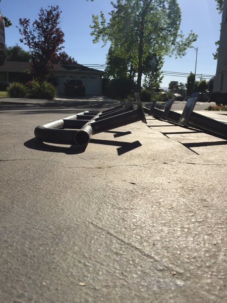

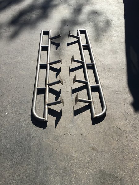

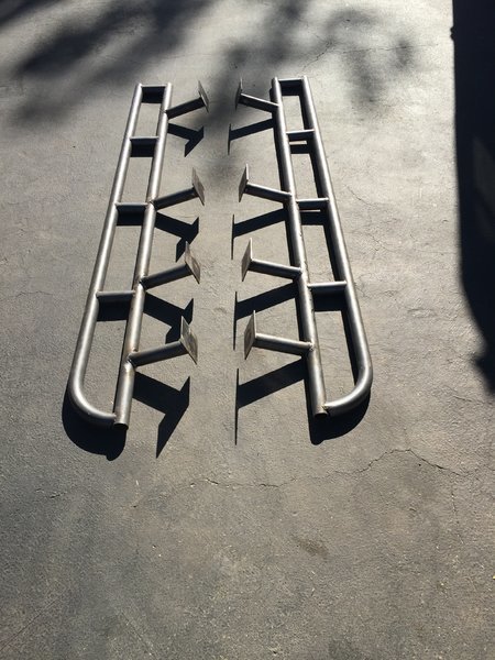

    Got a little done today, was able to notch both of the bent ends, and cut the extra tubing off the straight ends. Here's a quick look
    No welding today, planning on having the kick outs around 15-20 degrees.
    Still need gussets and kick ups. I plan on adding the kick ups after the sliders have been welded to the truck.

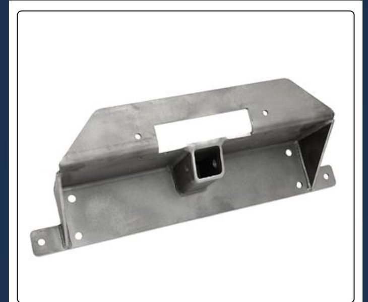

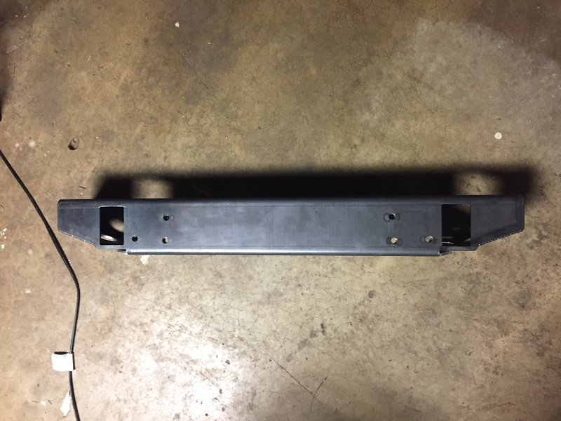

    So school, is eating up all my time... so all I can really do is plan.
    With the Sliders are almost done
    I've been thinking about the bumper currently, I have the mounting plate and hardware from trail gear thanks to @roosterburm
    I plan on picking up the winch mount as well, And building off that
    no designs currently but playing with the idea of a plated/tube hybrid bumper
    I wish I had the time to fully fab everything this summer but with a full time internship and another part time job on top of that my time is limited

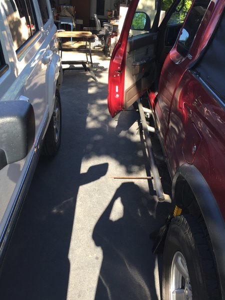

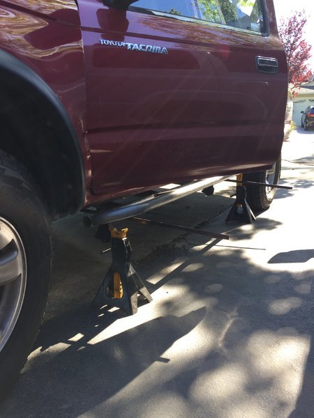

    Update, found my angle and tacked up both sides and did a test fit
    IMG_3378.jpg IMG_3379.jpg IMG_3370.jpg IMG_3371.jpg IMG_3369.jpg IMG_3366.jpg
