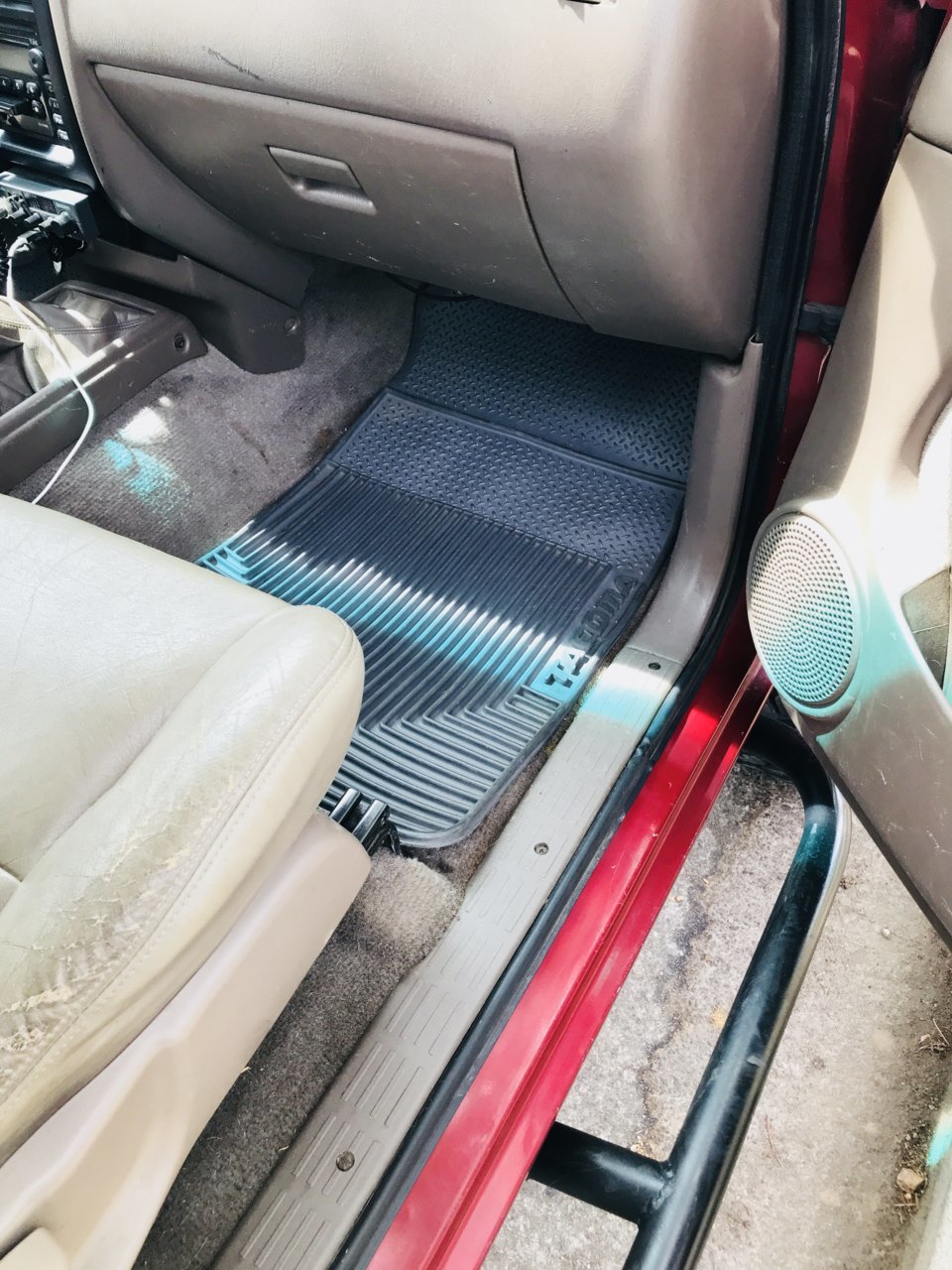

  1. Jul 25, 2018 at 10:12 PM
    #161
    Fuergrissa
    Fuergrissa [OP] If you build it, trails will come.
    Jan 9, 2013
    #94858
    2,063
    Devin
    San Jose
    2000 T4R Limited
    It’s wasnt to difficult, had to remove the rear door side feet and reposition them.
    I guess it depends on year of the donor seats and the year of your truck, In some cases people claim no fabrication is needed.
    But worthy upgrade the lumbar support is Gouda
    Speedytech7 likes this.

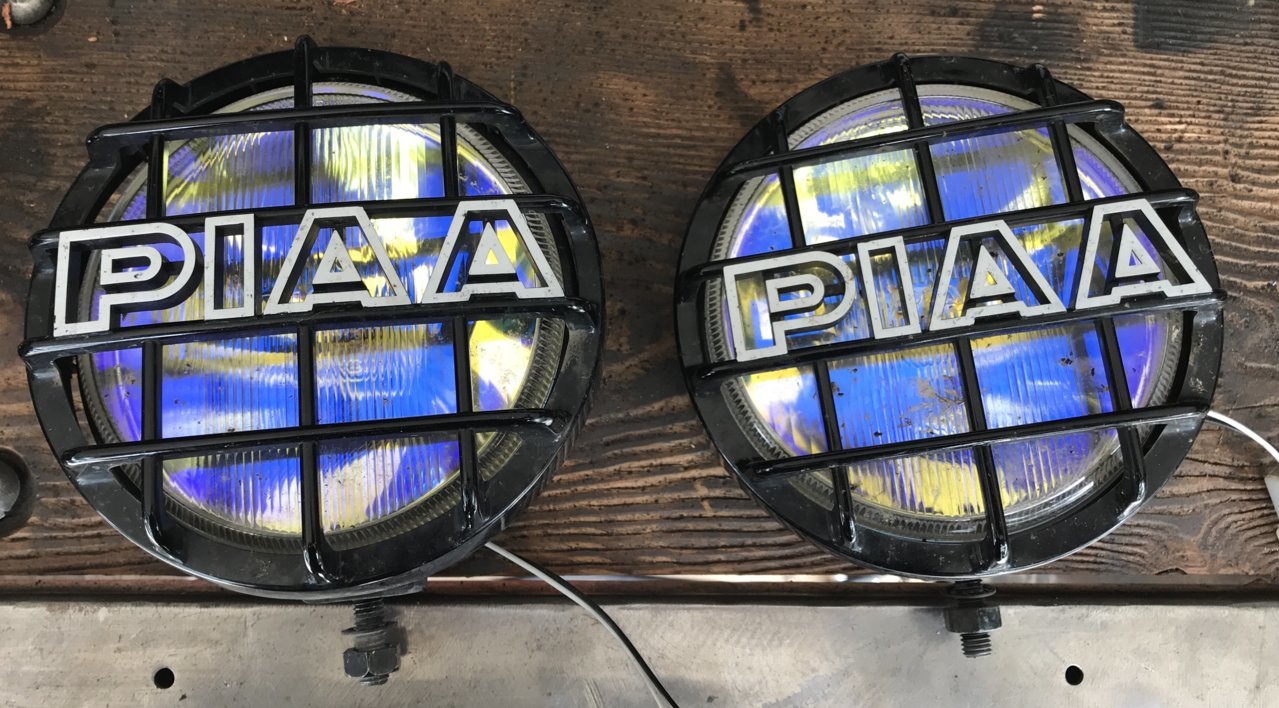

  11. Aug 5, 2018 at 10:45 PM
    #171
    Fuergrissa
    Jan 9, 2013
    #94858
    2,063
    Devin
    San Jose
    2000 T4R Limited
    rngr, jjsul, otis24 and 2 others like this.

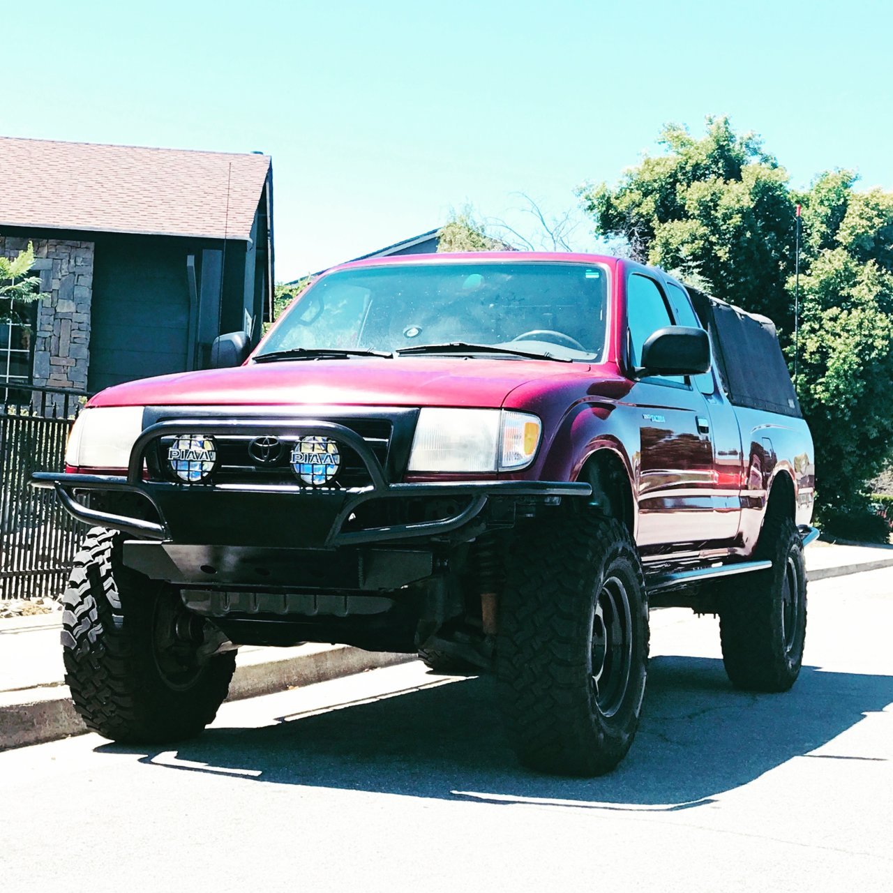

  12. Aug 9, 2018 at 10:27 PM
    #172
    Fuergrissa
    Jan 9, 2013
    #94858
    2,063
    Devin
    San Jose
    2000 T4R Limited
    Been fighting a p0171 lately
    Cleaned the MAF last week code cleared and came back, next step vacuum leaks

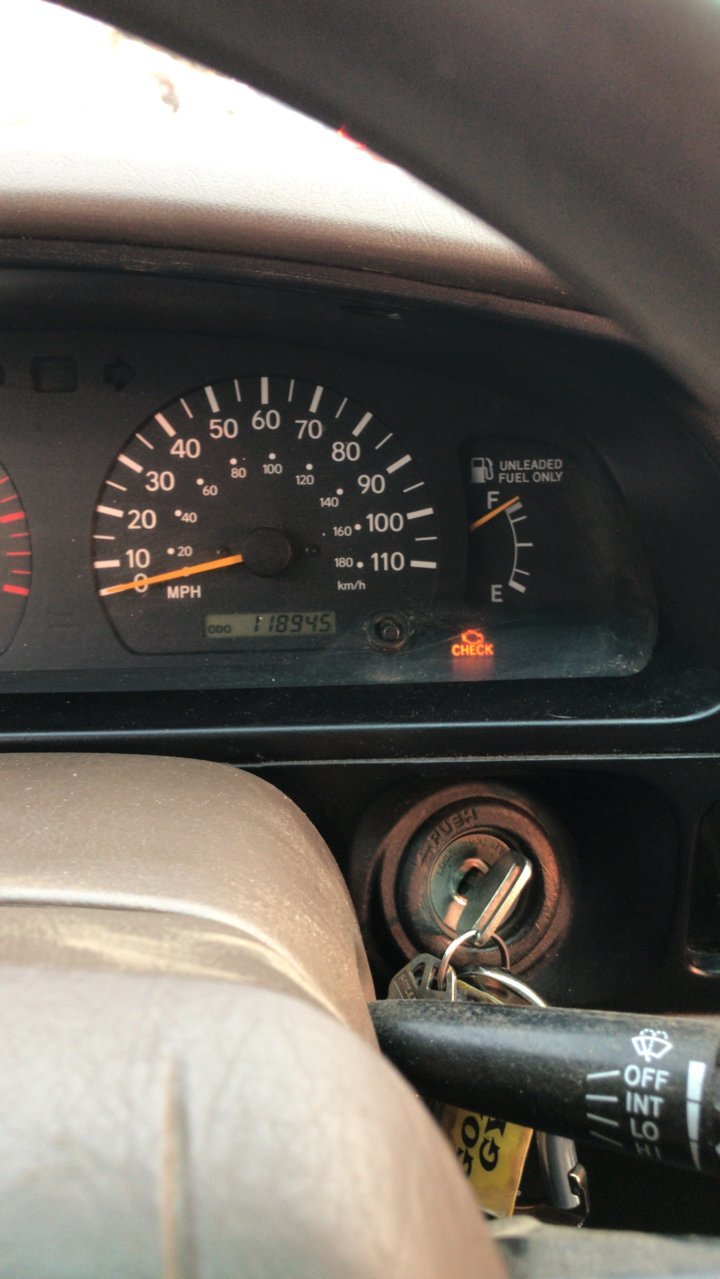

  13. Aug 12, 2018 at 7:59 PM
    #173
    Fuergrissa
    Jan 9, 2013
    #94858
    2,063
    Devin
    San Jose
    2000 T4R Limited
    Found a hose was a little loose, which may have caused a leak, triggering the code. In other news:
    Dorkel done
    jjsul, otis24 and nudavinci64 like this.

  17. Aug 15, 2018 at 9:20 PM
    #177
    Fuergrissa
    Jan 9, 2013
    #94858
    2,063
    Devin
    San Jose
    2000 T4R Limited
    Still chasing the amazing p0171, truck runs great but the code is telling me it’s running lean, so I’m guna remove everything up to the throttle body clean it up, and look for some cracks, or areas air can get in. Also I’ll replace the fuel filter
    otis24 likes this.
  18. Aug 15, 2018 at 9:27 PM
    #178
    Dan8906
    Dan8906 Well-Known Member
    Jul 26, 2016
    #192977
    5,138
    Daniel
    Concord, California
    2004 Tacoma ext cab TRD 4x4
    CBI sliders, ADS extend travel with compression adjuster coil overs, 9” Bilstein 5125 rear shocks, Icon Tubular UCA, Alcan custom leafs, All Pro Apex bumper and skids, NWTI rear diy bumper, 295/70/17 Cooper St Maxxs and nitro 4.88s.
    I had it a while back, and did the same thing you plan on doing and it went away.
  19. Aug 15, 2018 at 9:31 PM
    #179
    Fuergrissa
    Jan 9, 2013
    #94858
    2,063
    Devin
    San Jose
    2000 T4R Limited
    I’m guessing you found an area, where air was getting in after the MAF sensor?
  20. Aug 15, 2018 at 9:32 PM
    #180
    Dan8906
    Jul 26, 2016
    #192977
    5,138
    Daniel
    Concord, California
    Nope. Just cleaned everything and that did the trick.
