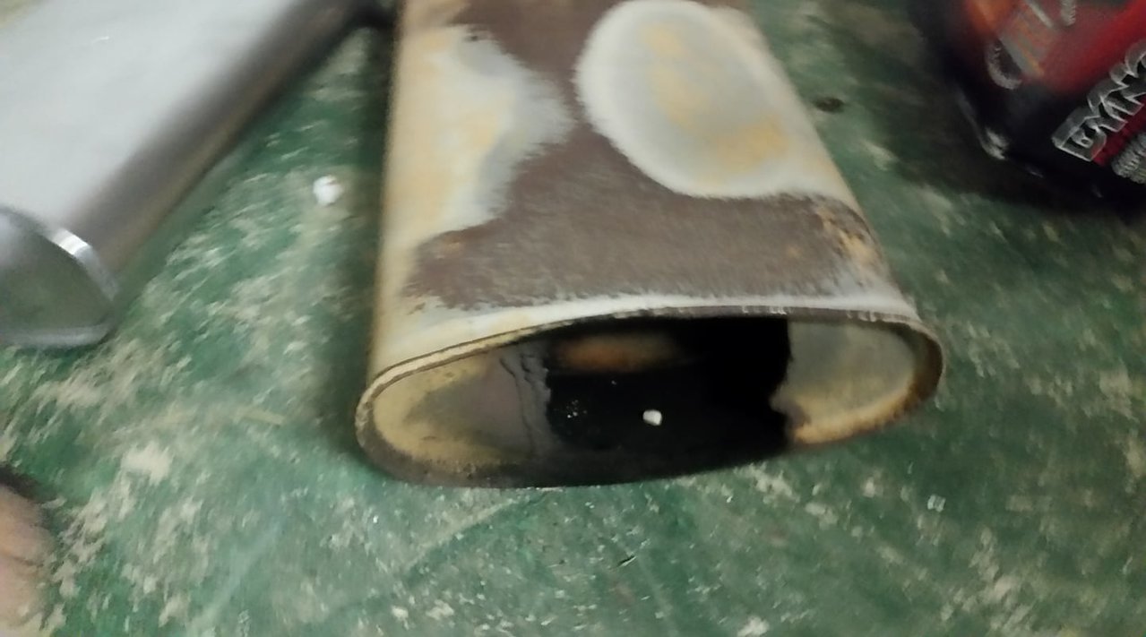

    Need to bust out the welder and install a new muffler this weekend! This is the inlet side, the whole face of it broke.23004416_2019330768350622_1660751412635026991_o.jpg

    :eek: I guess so!
    Haha, I'm a little amazing the OGT's muffler doesn't look like that. I'm pretty sure it doesn't have much packing left in it though. ;)

    The muffler is pretty funny, the face of it broke out, not even where the pipe was welded. It was a cheap muffler shop job though. And thankfully the rest of the exhaust is in good shape. I have a nice Dynomax unit waiting to be welded in.

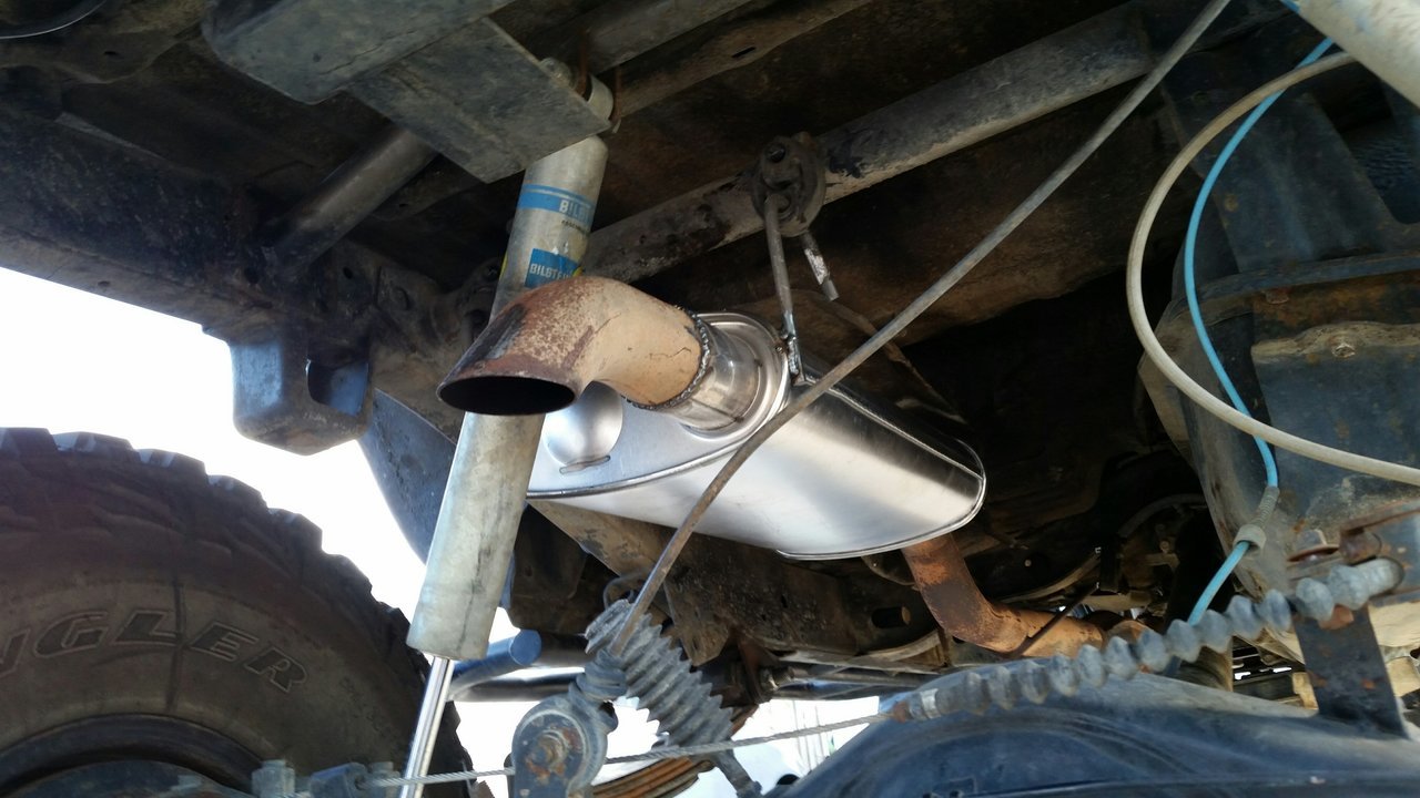

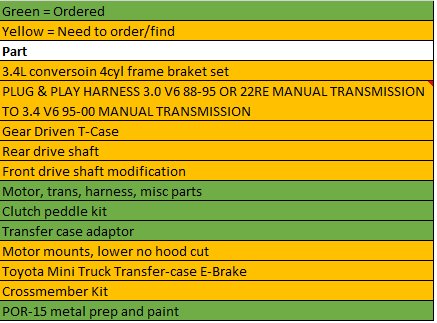

    Here's the list so far. Motor mounts are on there twice, because I haven't decided on which supplier.

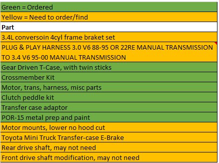

    Ordered the T-case, twin sticks and crossmember. I need to get the motor pulled from the Runner, most of what Toy only swaps (TOS) needs is from the existing vehicle not the donor.
    @allenfab There may be a couple plugs under the dash behind the glove box that I will need. TOS is going to send me some pictures. If they're not in the stuff I have maybe you could mail them over?

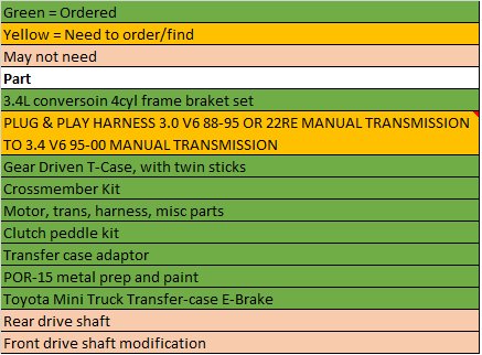

    Now my T-case adaptor from Marlin is backordered. Still have plenty of time, because of how long it takes to get a harness made.
    Ordered my motor mount plates and T-case E-Brake. Last non nickel and dime part is the harness. I should have the dash harness pulled from the Runner and the other 3 plugs from Todd soon. Then I'll get it sent out to TOS.
