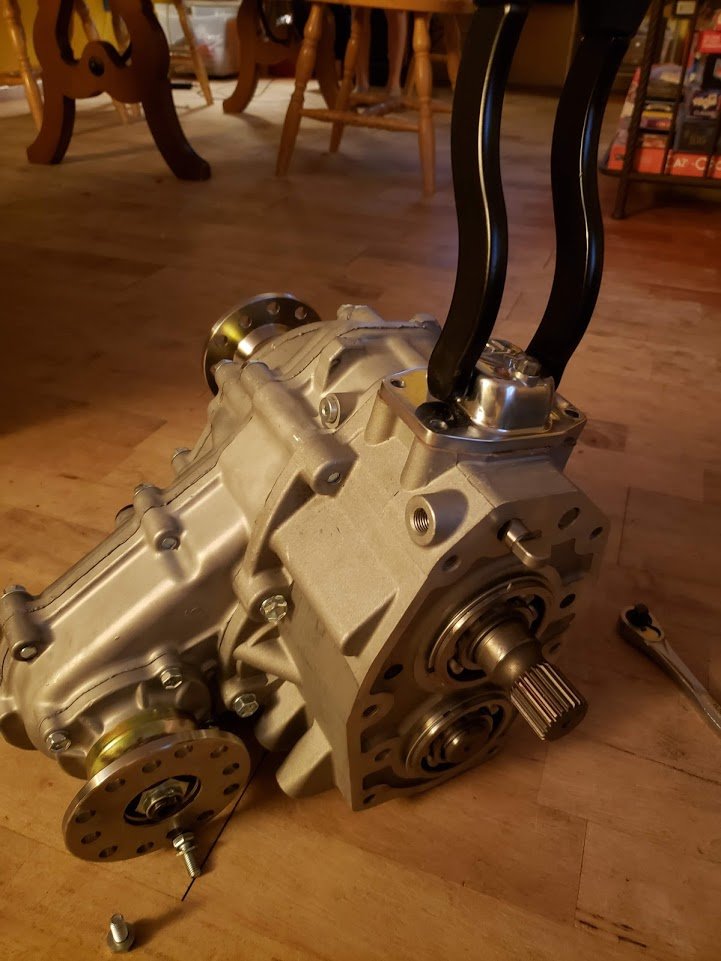

    Truck parts

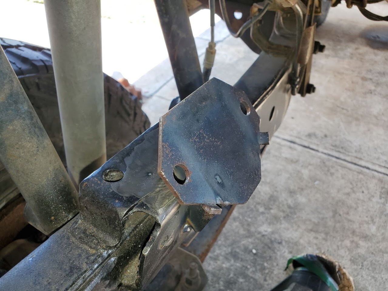

    Got the 22re motor mounts and some other unused brackets cut off and ground smooth today. There were a couple that I left in there when I did the axle swap that having the motor out made possible to finally remove.
    Need to tack the new mounts and test fit the motor next.

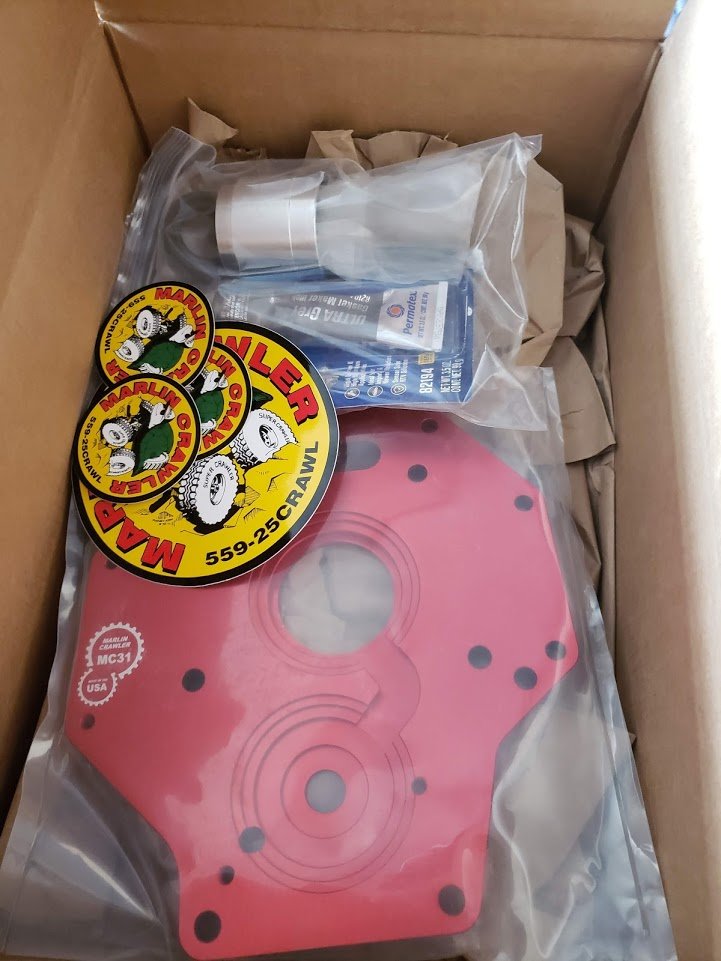

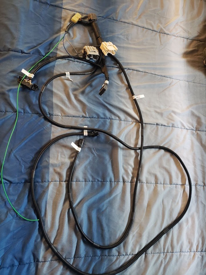

    The harness showed up today from Toy only swaps. It looks great, hopefully it works as good as it looks.
    I have a ton to do to the old runner. I took next week of for spring break with the kids. I need to fit in a boating/fishing day, Mountain biking at Santos in Ocala, working on my runner and hopefully getting a new daily driver. I have everything from the bank set, just need to find the right deal on a gently used 3rd gen Tacoma Off-road 4x4. If anyone sees a 2017 or newer in silver, grey, cement or white under 45000 miles for around 33k let me know.

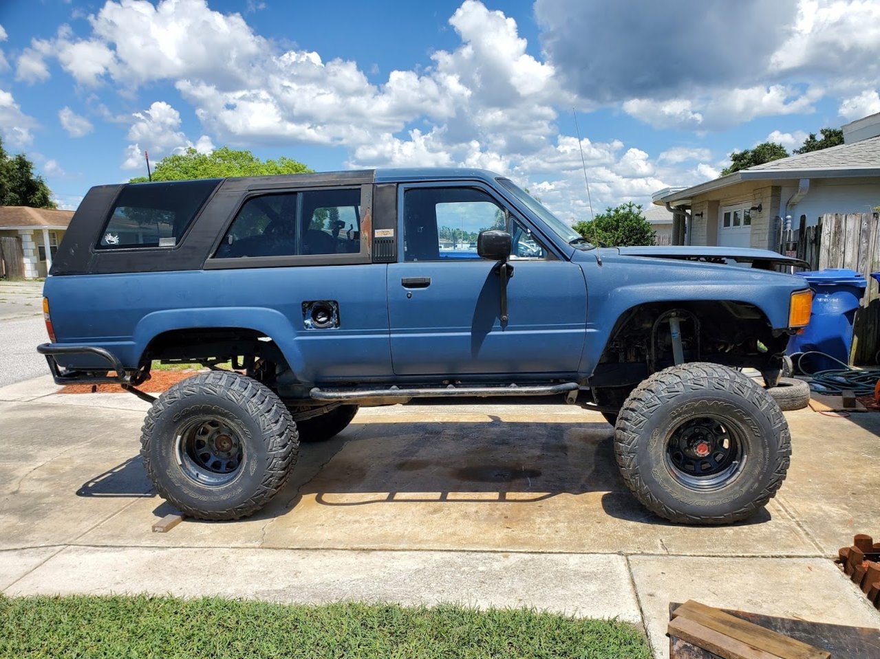

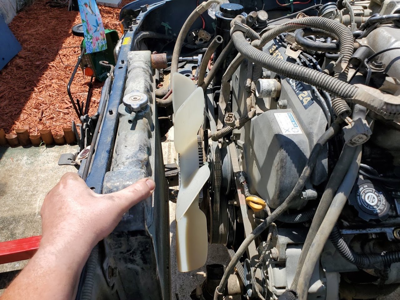

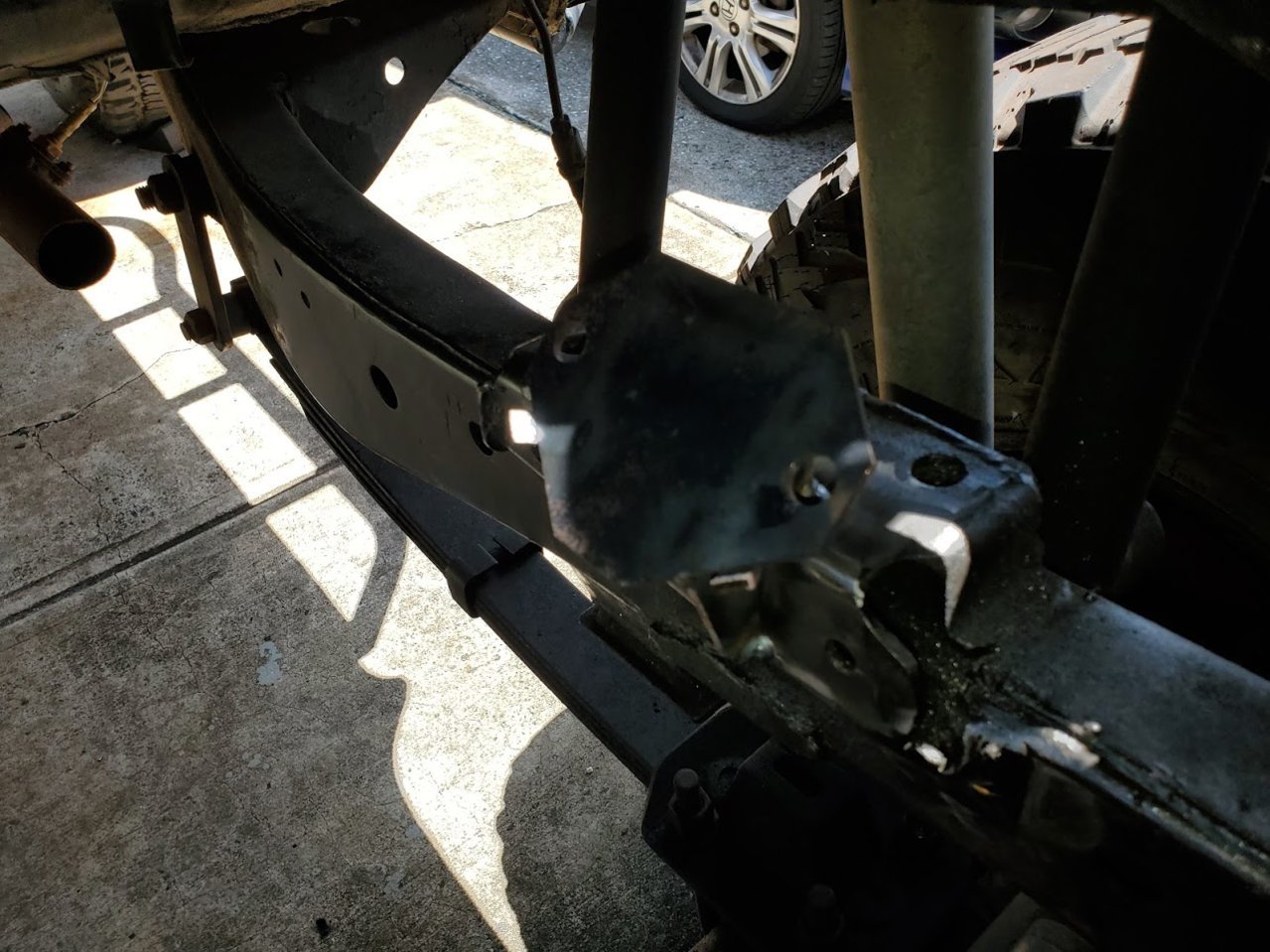

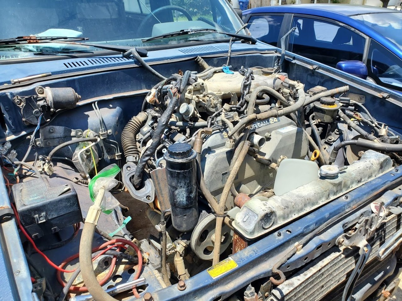

    So I actually worked on this old pile today. Mocked up the motor and put the cross member in (mainly to get it out of the way, one car garage).
    I'll need to move the passenger side mount forward and outboard an 1/8 inch to get the motor square and all the bolt holes to line up.
    The hood will have to be modified to clear the motor, guess it will be getting a scoop.
    The radiator from Todd's truck most likely won't work without moving a bunch of AC lines. I think I'm going to get a nice aluminum replacement. Need to get that and modify the crossover pipe for the exhaust.
    Looks like it sits a little higher than the 22re, but there's no transmission, transfer case or drive shafts in there right now. I think ride height will be about the same, with the V6 being heavier, but the transmission being much lighter.

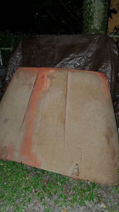

    I totally forgot about the family of Wasp's. I got under the hood to grind the paint away from frame to weld the mounts earlier today when they starting poring out. I got the hell out of there, re-grouped and tracked them to the passenger side frame rail. After an exhaustive search for wasp spray (couldn't find it) the nice little wasp family met a fiery death from a Map gas torch.
    Thankfully I didn't get stung, I'm pretty allergic.

    BTW, I have a brand new in the box Denso radiator for a 3.4L. Dunno if it will fit but I'll cut you a heck of a deal on it. The one in the pics looks like it's seen better days, lol.

    Thanks Lee, but I don't think it will fit. Assuming it's the same deminsions as the one Todd included with my motor.

    It's actually taller. Todd had a 4 cyl radiator in his. Same width, but shorter.

    The width is the problem. Height wise the one he gave me is the same as my RE radiator. I think I'm going to get the on from toy only swaps and pair that with a Spal fan.

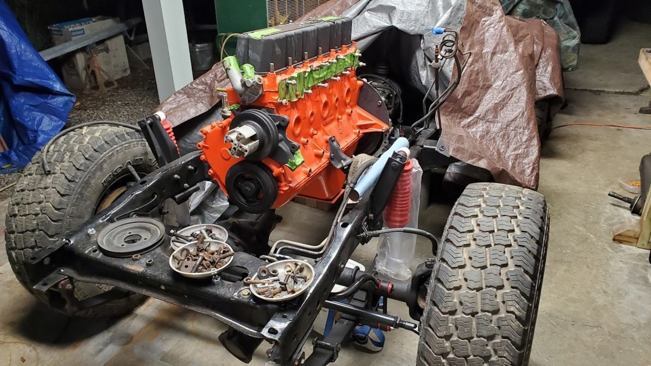

    I did get the motor mounts final welded and painted today. I cleaned and painted part of the engine bay with POR15 too.

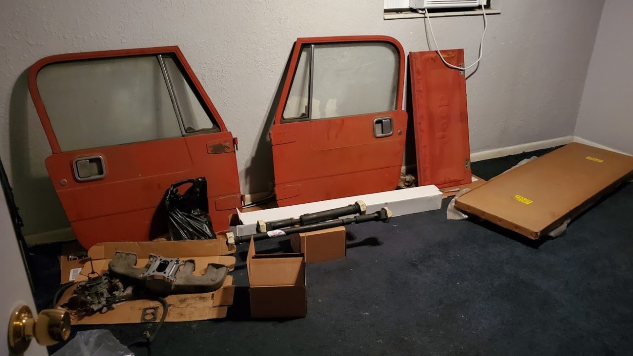

    So tell me...if you were doing a frame off rebuild, would it even cross your mind to try to salvage this pretzel?

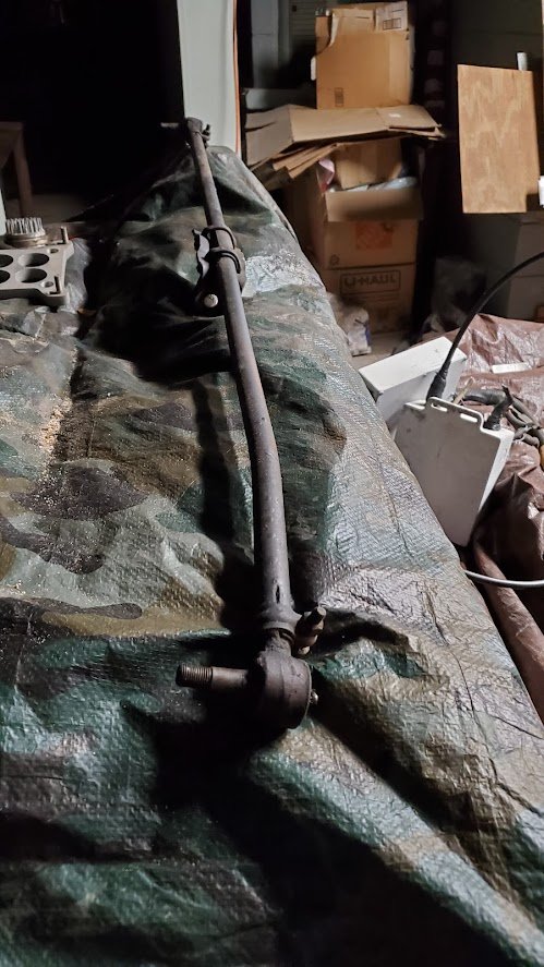

    AA1W8xuN2jDKZ2oAU2sI7NCG7i3u8pT3aPeaSyZ9_6dbab6aeeb77d8483b2f0d7fae317f298a4be6ef.jpg 2rorklNL-0FlrBMxFk4pBBfNOEkcRCpUWAsXk4xu_ddb4d64e2fa57d4f40100692abd29e02e93b69bc.jpg

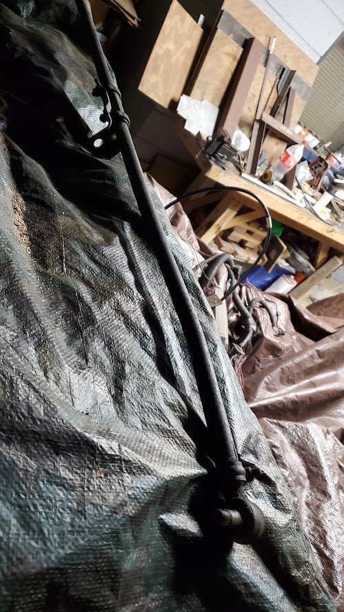

    And then here's the rest of the fun in my yard...
    tUjNaCwNvvkIhe327oKvXQafsvf2mgLC3MdpO-2f_68f42b7b34ef2ec6bb76493dcbefe023f930bf1f.jpg QxQzpObQdHVHX58AiOoUa8y6C_a-GjkcUnAYSi4q_8b26c97e3c8501df1dc767d657e480921c06475e.jpg The hood is leaning against the tent we made with the roll bar for a pile of random parts, lol.
    zTFAagiMubFxbL5OXFm6qbG3yy8jUeElSd84AYSJ_d709b3c41fc8795aad87d8ceea22253ec795e5b1.jpg SKH8b8gJHHRNUrCloJlczO6IWNLgXDVs-pXwPKA9_08286d9ebe8e2eec689591e474b559adff520213.jpg
