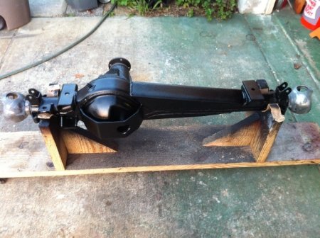

    This is where I stopped, unfortunately I buggered up an inner axle seal trying to drive it into place. Might be a blessing in disguise though, the Marlin seals are way better and on order.

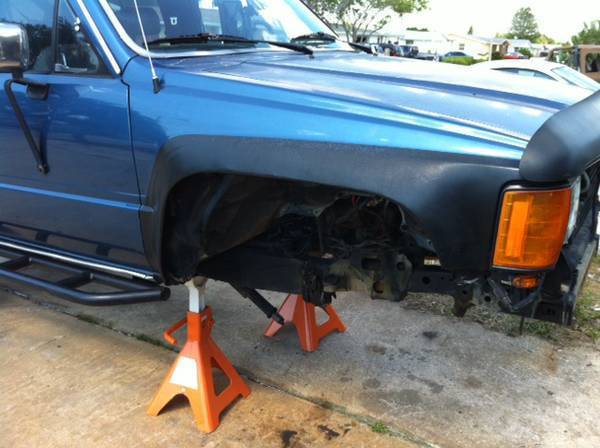

    It's a lot of work to get to this point, I need a nap.

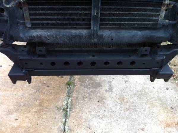

    Got a little more done today. Front spring hanger is tacked in, frame is tubed for the shackles. I have some more grinding to do on the frame rails too.

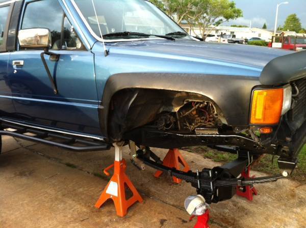

    Finally done grinding, wow it takes a lot of work to get a frame clean. I got one leaf hung too, then the Florida heat won.

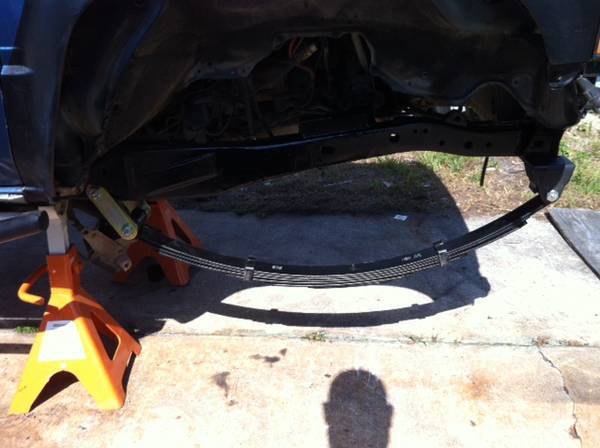

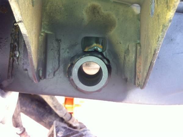

    Got the axle back under the Runner. I'm going to let the springs settle for a couple days and then decide if I should move the hanger back. Right now the shackle angle is near vertical, with a new pack it should kick back 15 to 20 degree's.

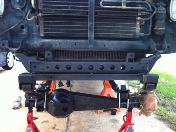

    Getting there, setbacks because of old ass parts that were too out of speck to re-use. Last piece I should need is a wheel hub. Luke at Frontier 4x4 has one on the way to me. I have to drop the locking hub ring and knob off to be powder coated.
    33's are going to look silly though, may be jumping up to 37's sooner than later...

    The shackle angle should be greater than 15-20 degree's at ride height. More along the lines of 40 degree's. Otherwise it'll sit higher and during droop they might fold forward.
    Looks good otherwise!

    I'm going to play around with the front spring hanger, push it back a little to see if i can get a better shackle angle. Hopefully that will get it in line, if not the only other thing I can think of is to cut the tubes out of the frame and move them forward.

    You've been down this road, I've read your SAS thread on this forum and the other on Pirate. I'm really leaning toward cutting the tubes out of the frame, plating it and moving the tubes forward an inch to an inch and a half. You can see in the pic I centered the tube in the body mount as recommended by TG. I just don't think pushing the spring hanger back a half inch is going to get the angle I need.
    Seems like the best way to make it work, what do you think?
