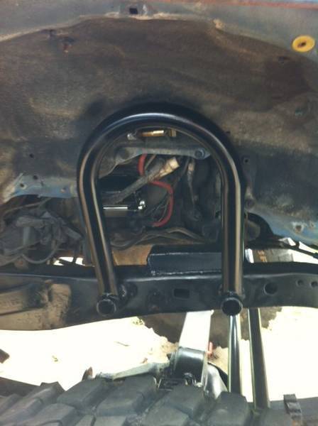

    Got a shock hoop burnt in today. Installed a new starter too, been having issues for a while. This was the easiest time to change it with nothing in the way. Didn't even take 10 minutes.

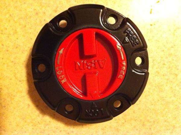

    These are almost ready to go back on. New o-rings will be here on Monday. I ended up using my IFS locking hubs because they are in better shape than the solid axle ones. To make them work I installed a chromo gear with the right spline count from Bobby Long's.
    Oh, I ended up not powder coating them. The cheapest place locally was 50 bucks. If the paint doesn't hold up I'll get a powder coating set up from Harbor Frieght and powder coat them myself.

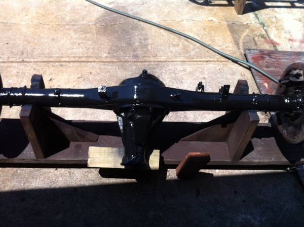

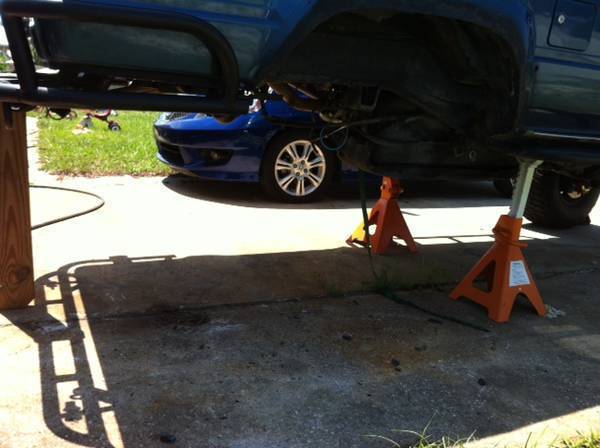

    Rear suspension, we gone.
    Axle mostly prepped and painted. Just have to grind the leaf hangers flush. I have one axle seal leaking, so I'm going to order new Marlin seals.

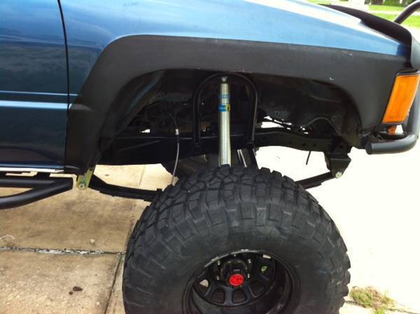

    It was way to hot out for this, but the rear is mostly done.
    Life is good, beer in hand and happy!
    Front shock pic:
