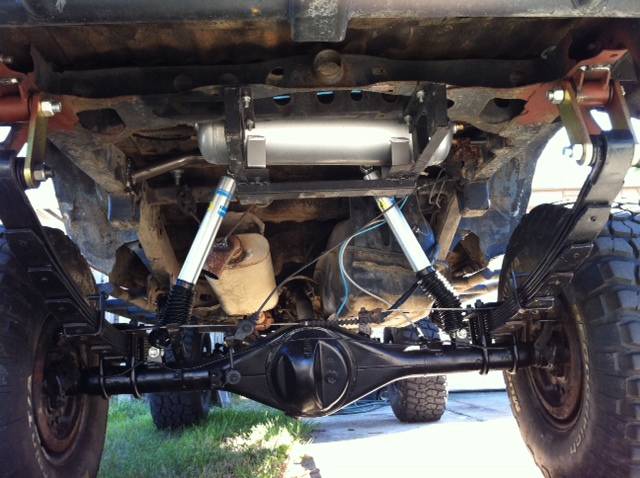

    Got the rear shocks mounted today and I dropped the front shaft off to be welded up.

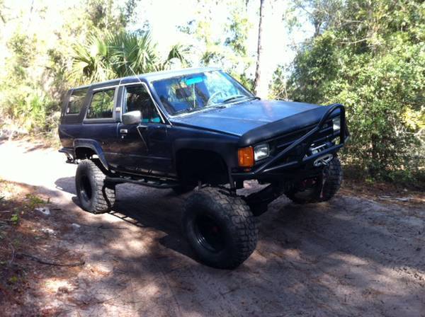

    The results of all the hard work!
    and I know these have been posted in other threads, but you can't deny they're cool shots :D
