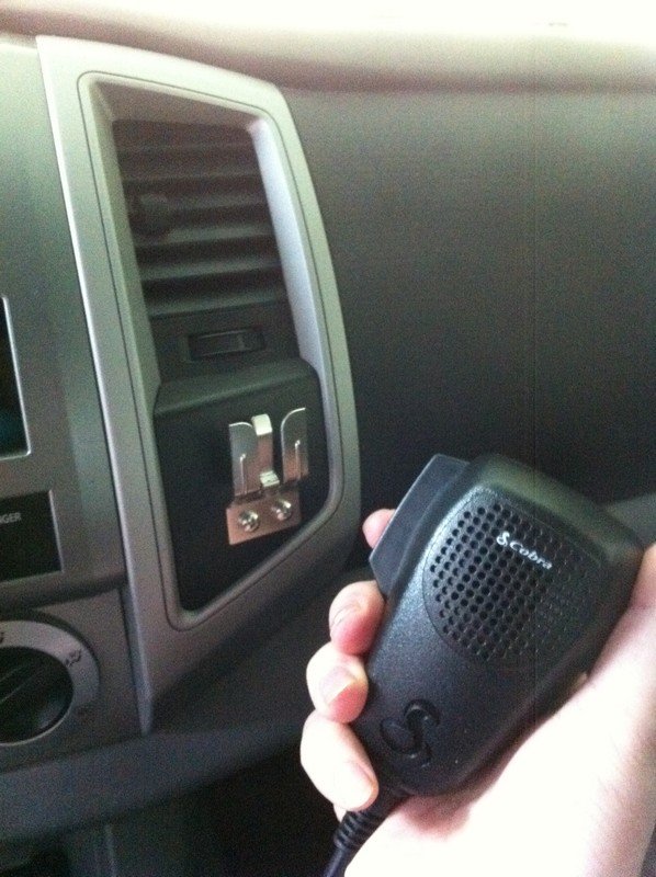

    I should make one mention, I did flip the quick fist that is near the spade. It felt more secure with the opening having to tug downward.

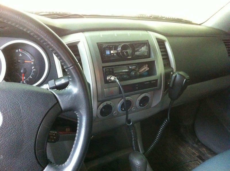

    So my Midland CB gave up about 2 months ago. I decided this time to go with something that mounted in the cubby under the stereo head unit. Choices were either Cobra 19 DX IV , Midland 1001z, or the Uniden 520XL. The Midland didn't seem as good as the other two. Cobra and Uniden seemed pretty evenly matched, so I went with Cobra based on looks :p
    I started the install yesterday night. I'm copying MrGrimm for the install. He's been very helpful with guidance.
    A couple notes so far:
    -To be able to mount the CB here, you need a Scoshe dash kit. I had a Metra kit, and the cubby is much shorter in height.
    -you will need to cut a hole big enough in the cubby so that the CB can recess back into the dash.
    -You need to retain the factory clips so you can transfer them to the studs on the new Scoshe dash kit. Unfortunately, Scoshe didn't make the mounting quite right, so I needed to dremel out some holes for the clips to mount to.
    -the scoshe kit comes in two parts, the overall trim piece as one, and the legs as another. The legs have a flat plate that mounts to the cubby via two screws. Unfortunately, when you cut the hole so you can recess the CB, you cut off one of the screw mounts. MrGrimm says the clips are all that is needed, but I'm going to see what I can do with some glue or something.
    -To wire the unit, I used an add-a-fuse to plug in to the fuse panel behind the coin pouch. For a ground, I used a crimp-on connector with a hoop end and a self-tapping screw. I mounted this on a flat steep plate that was near the pedals.

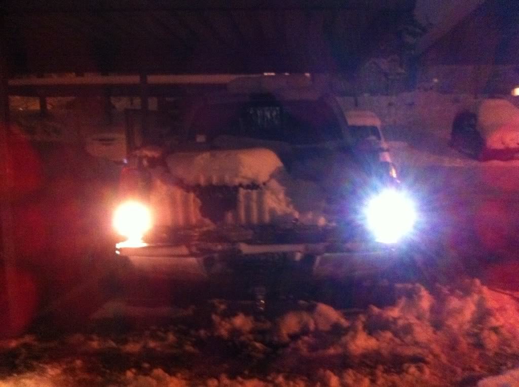

    JLC Lighting CREE LED Reverse Lights
    For under $50, you can't say no. So easy, I installed them in 12" of snow in about 10 minutes.
    I think the difference is great!

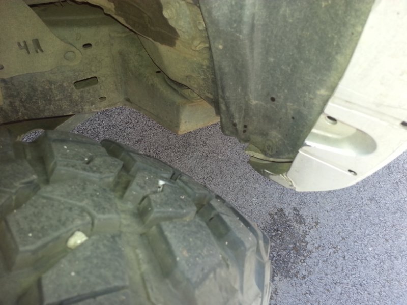

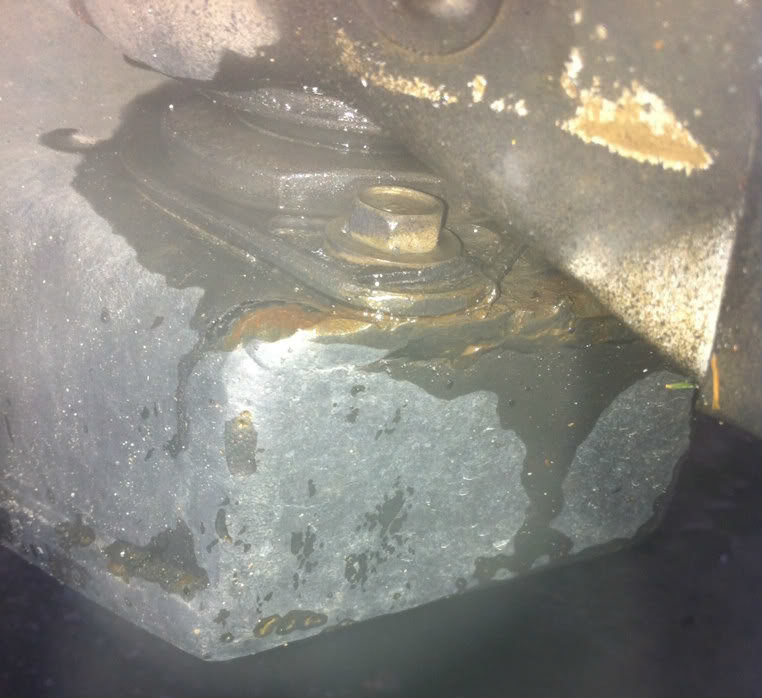

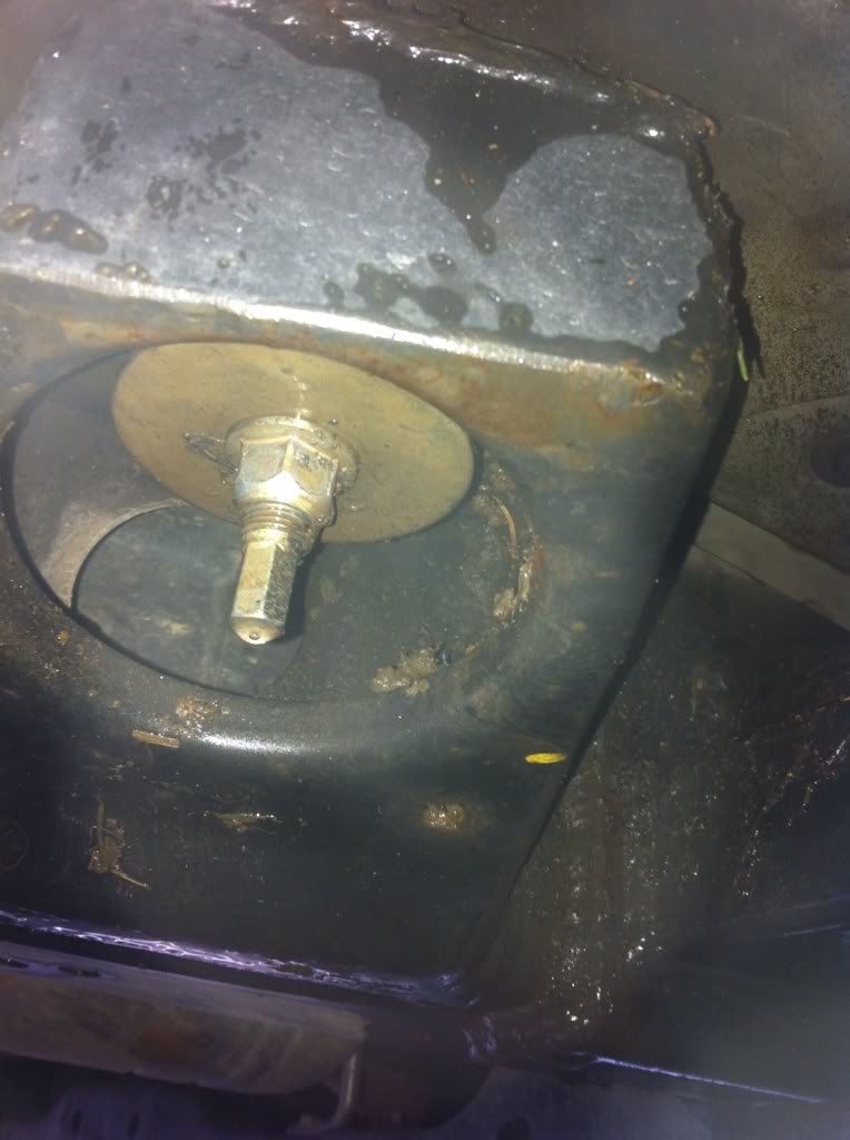

    Body Mount Chop

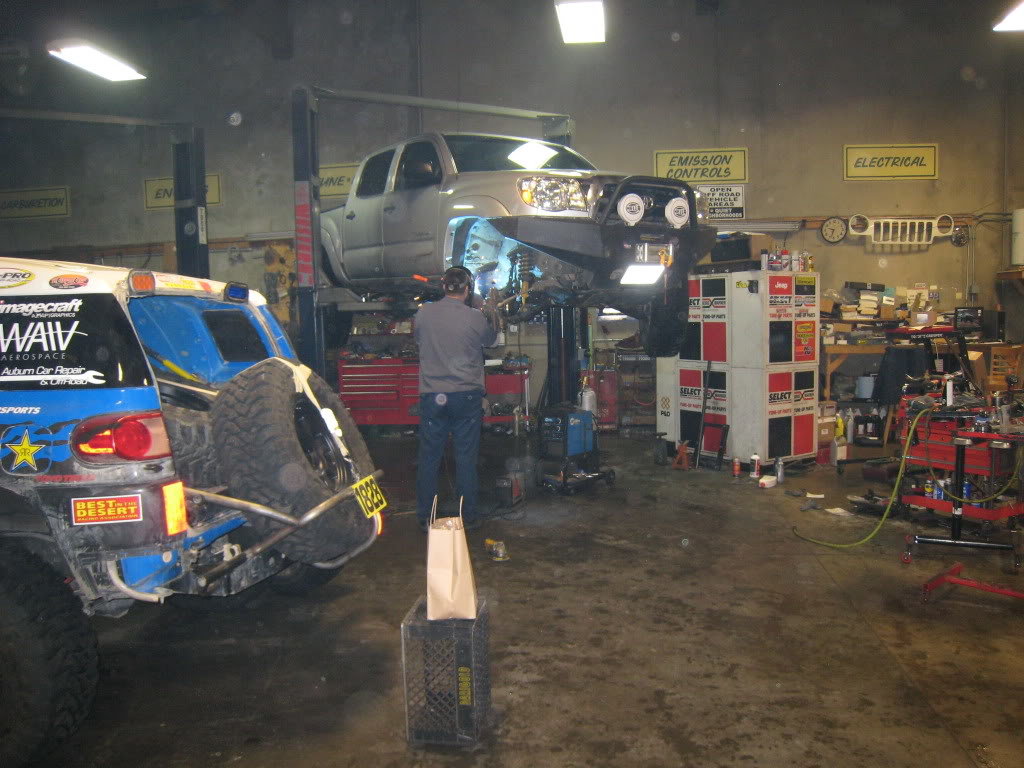

    As we all know, moving up in tire size means that you invariably rub on the front body mounts to some degree. I'm fairly lucky that I only rub when I stuff the tire, but it's still something I've needed to have done.
    John at Auburn Car Repair & Offroad hooked me up with a body mount chop today. I can barely tell the difference between what he did and the factory lines - he's that good.
    Underside (excuse the dirt)
    End result with fender flare cuts (done by me - no science here, just a utility knife)

    That's Off Track Motorsports race rig. John's one of the members. You can find them on facebook.
    I talked to John about it, and I guess they aren't going too whole hog on it because it's a pre-production FJ (6th FJ ever made!) and by federal law, has to get scrapped after a preset number of years. :( Thank your congressman when this fine machine becomes a Pepsi can.

    Updated the body mount chop section with a new detail picture.

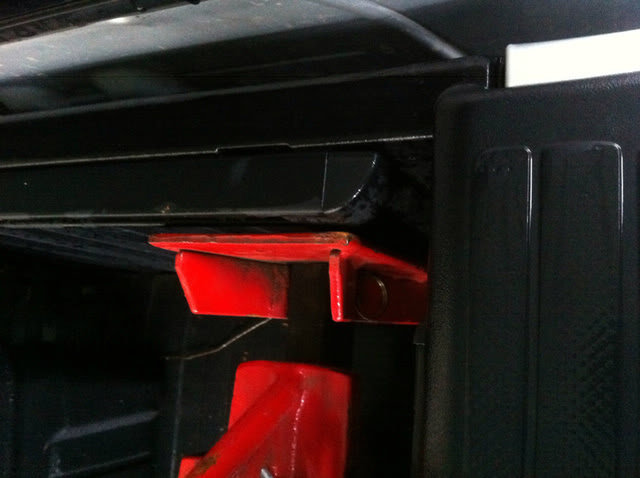

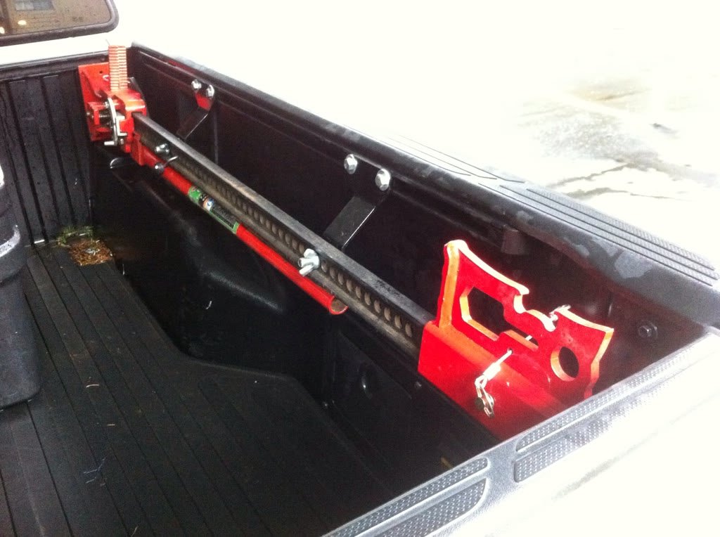

    ATO Hi-Lift Jack Mount
    I realized I wasn't going to get around to figuring out a better way of doing this, so I sucked it up and bought ATO's Hi-Lift mount on a group buy.
    Works nicely, I did a test drive and I can't tell the jack is back there.
    The jack fits in just snug. This is how close it comes to the cab...
    ... and how close it comes to the bed
