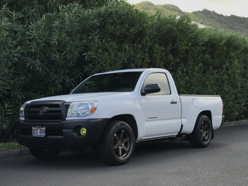

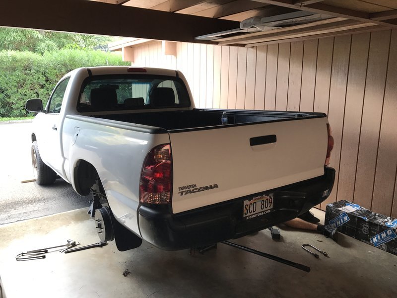

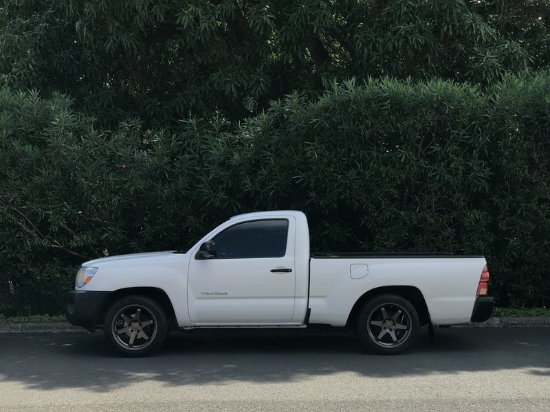

    @LogCabins got some XRunner shocks and springs for the front, and drop blocks and some pretty trick adjustable shocks for the rear.
    He also cleaned it up real well and put some nice wheels and tires. Much better than the stock bicycle tires.
    Came out real nice and rides pretty good too. I miss this little truck :( but I'm happy to see that it's being well taken care of :cheers:
    Front coils are new. Should settle a little.
    Nice truck Robert! :thumbsup:

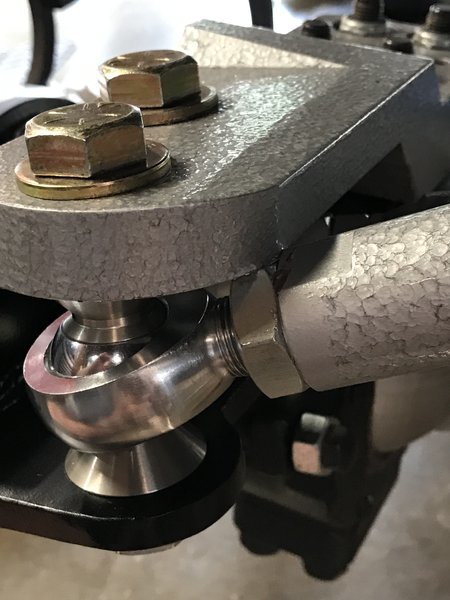

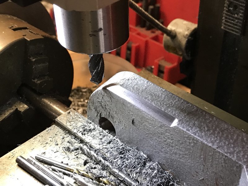

    Forgot to post this from last week. At full droop and turned all the way to passenger, the drag link was making contact with the passenger side steering arm, so I pulled it off the axle and gave it a nice chamfer in the mill. It ended up much bigger than what's in the pic, but I didn't get any other shots.

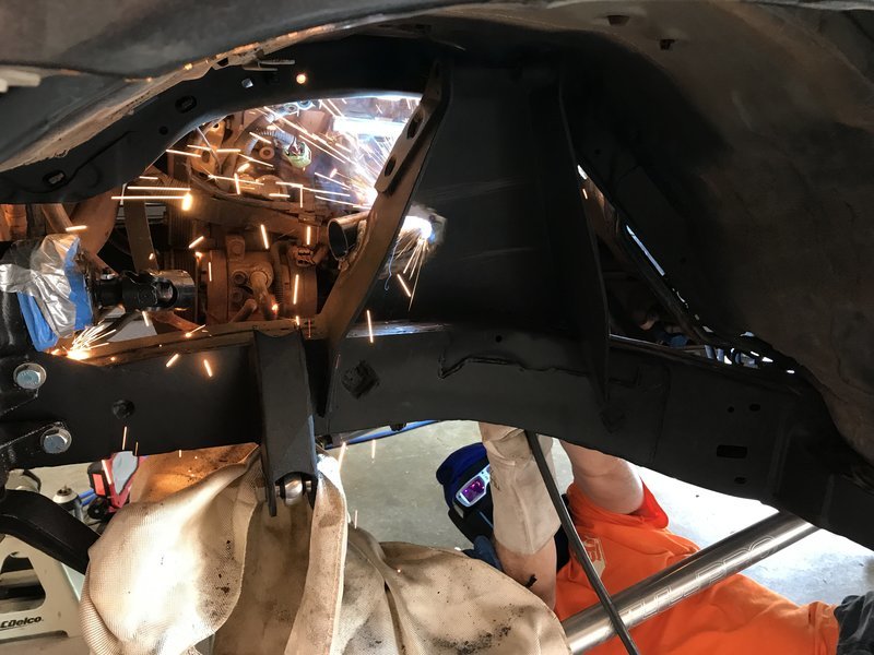

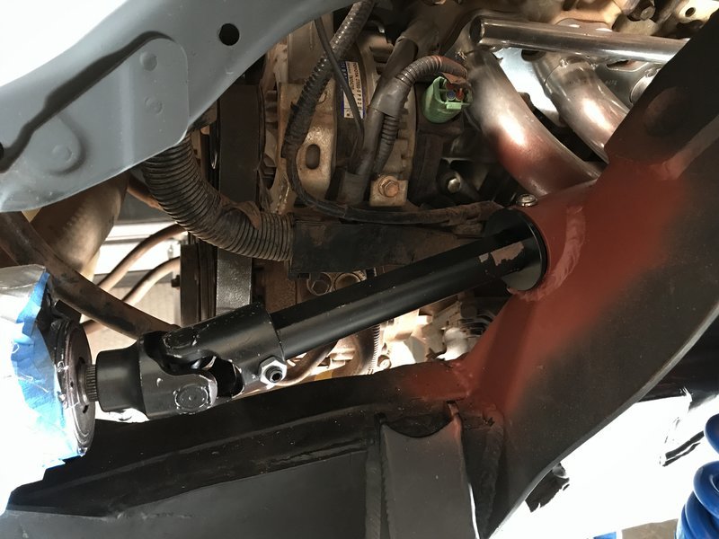

    And then a shot of @1uzrnr catching weld spatter with his neck while welding in the tubing we used to notch the shock tower. The steering shaft runs through the tube, but I still need to support it with a bearing or heim joint.
    I'll get a pic of the steering setup once it's all done.

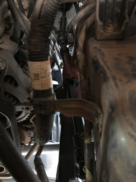

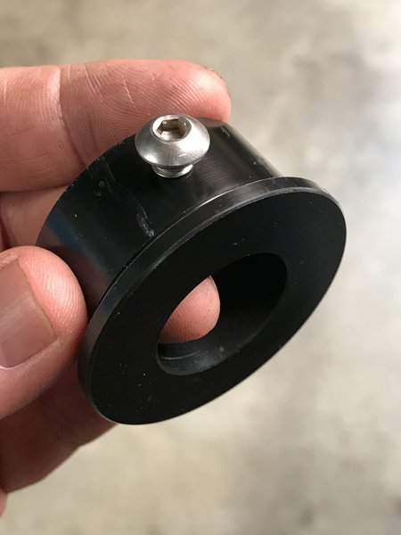

    Some updates. Finally finished the steering, now just needs some touch up paint. The shock tower was notched for the steering shaft, and we though that it's probably a little stronger if we left the whole tube. And then I thought since we are gonna leave the whole tube with the shaft running through it, why not just make bushings instead of welding on heims or pillow blocks! So I made a quick delrin bushing, and it seems to work great. And if it wears out, I can make another in less than 10 minutes :D
    I did eventually trim the corner off of the tubing cause I thought it was too close to the headers, and if I ever had to take off the headers for any reason, there would be no way to get them off.

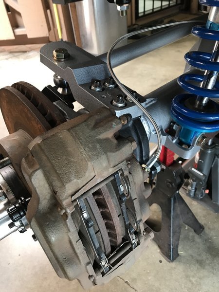

    I also got some custom length S/S braided brake lines in the mail today. I was gonna do hard lines down the top link, and then along the axle out to the calipers, but I would need 6 short flex lines at every joint. So I thought to just try some long ass braided lines instead. If it feels too spongy, I'll do the hard lines. I'm just trying to get this thing drivable so I can get it legal again. All my tags are expired :rolleyes:
    Gonna have to tack on some brake line clamps next.
