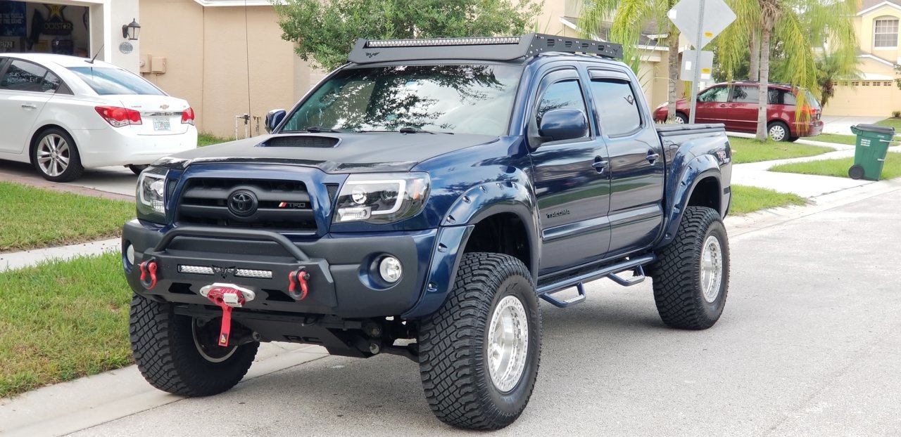

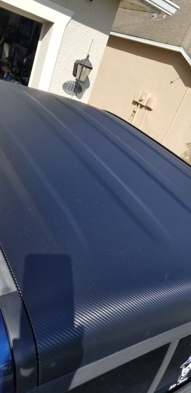

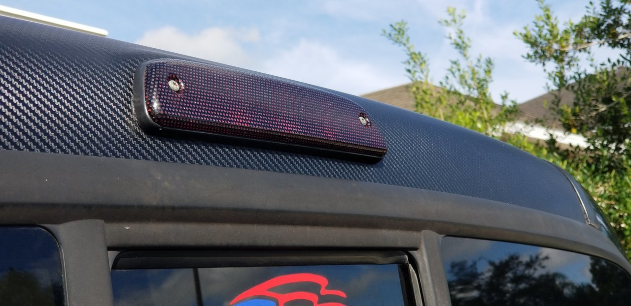

    Clear coat on my roof was just starting to fade so I decided to wrap it in carbon fiber vinyl since I was putting on a roof rack anyways. Spray off the dirt with a water hose and done. No need to worry about waxing or any of that.

    That looks great !
