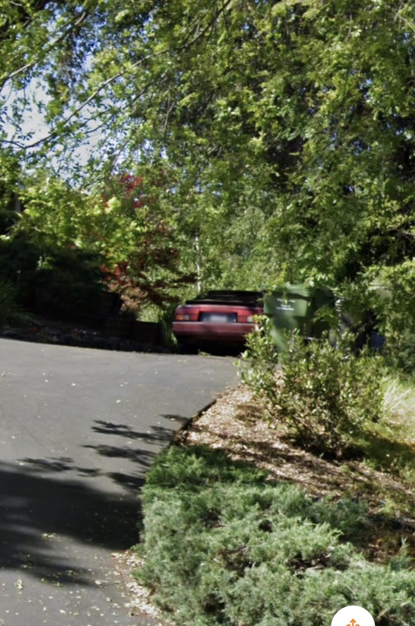

    Because of this, he parked it under a tree and there it sat for 8 years until 2019 where he probably got tired of looking at it, and donated it to Kars 4 Kids. Car in it’s resting spot pictured below.

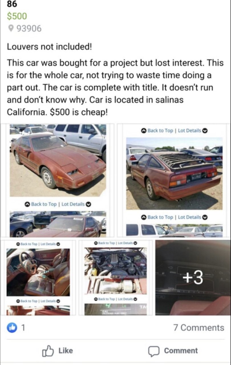

    Along with a link to this listing:
    And so, the next day I came home with a $500 Nissan.

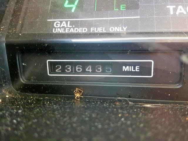

    It was well loved by the original owner at 236,000 miles.

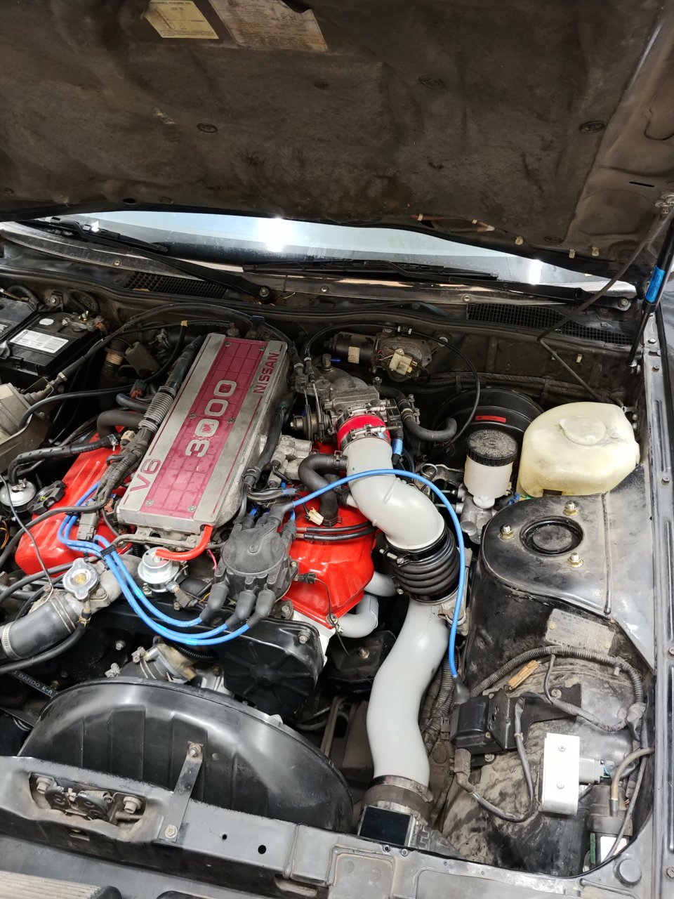

    Will post some updates in the coming weeks, yesterday I liberally applied Simple Green to the engine to try and clean the rat poop and piss to the best of my ability. Also washed the exterior for the first time in probably 10 years.

    I’ve got most of the geese as of now, the engine wasn’t that dirty to begin with oil wise. I just wanted to clean all the rat droppings and piss off the engine before I started working on it. Who knows if there’s Hanta Virus or something in them.
    The skid plate is still completely full of rat droppings. There’s at least a few inches of it.

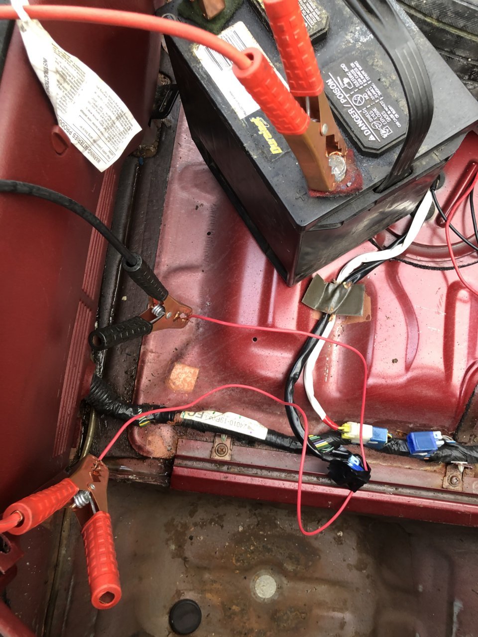

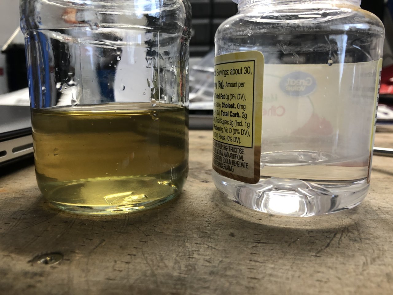

    I worked on draining the 8 year old fuel today, replacing the engine bay fuel lines, and the fuel filter. About ~8 Gallons of fuel was pulled from the car. I took a car battery and jumped the fuel pump connector in the trunk to drain it.
    Here’s what came out. 2011 gas on the left, 2019 gas on the right.
    This is how I jumped the fuel pump:

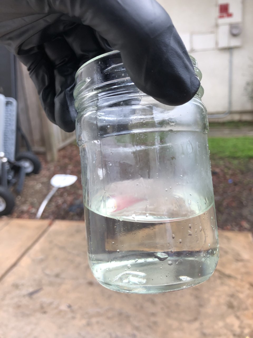

    And this is the clean fuel that came out after getting rid of the old fuel, a hell of a difference.
