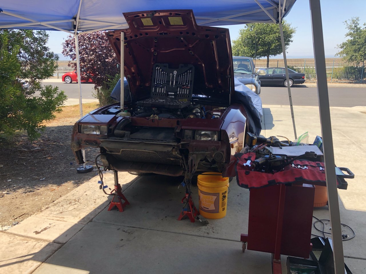

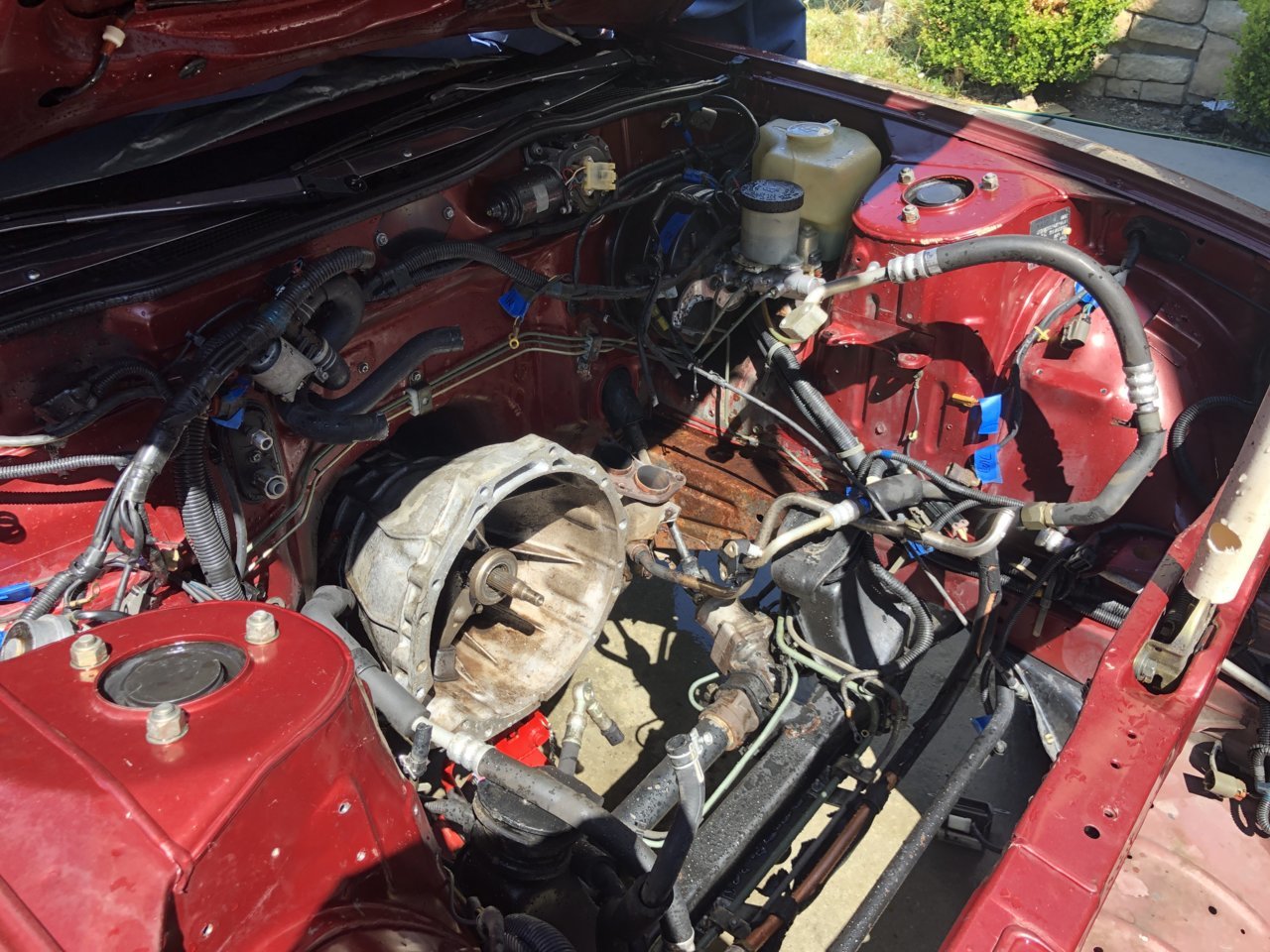

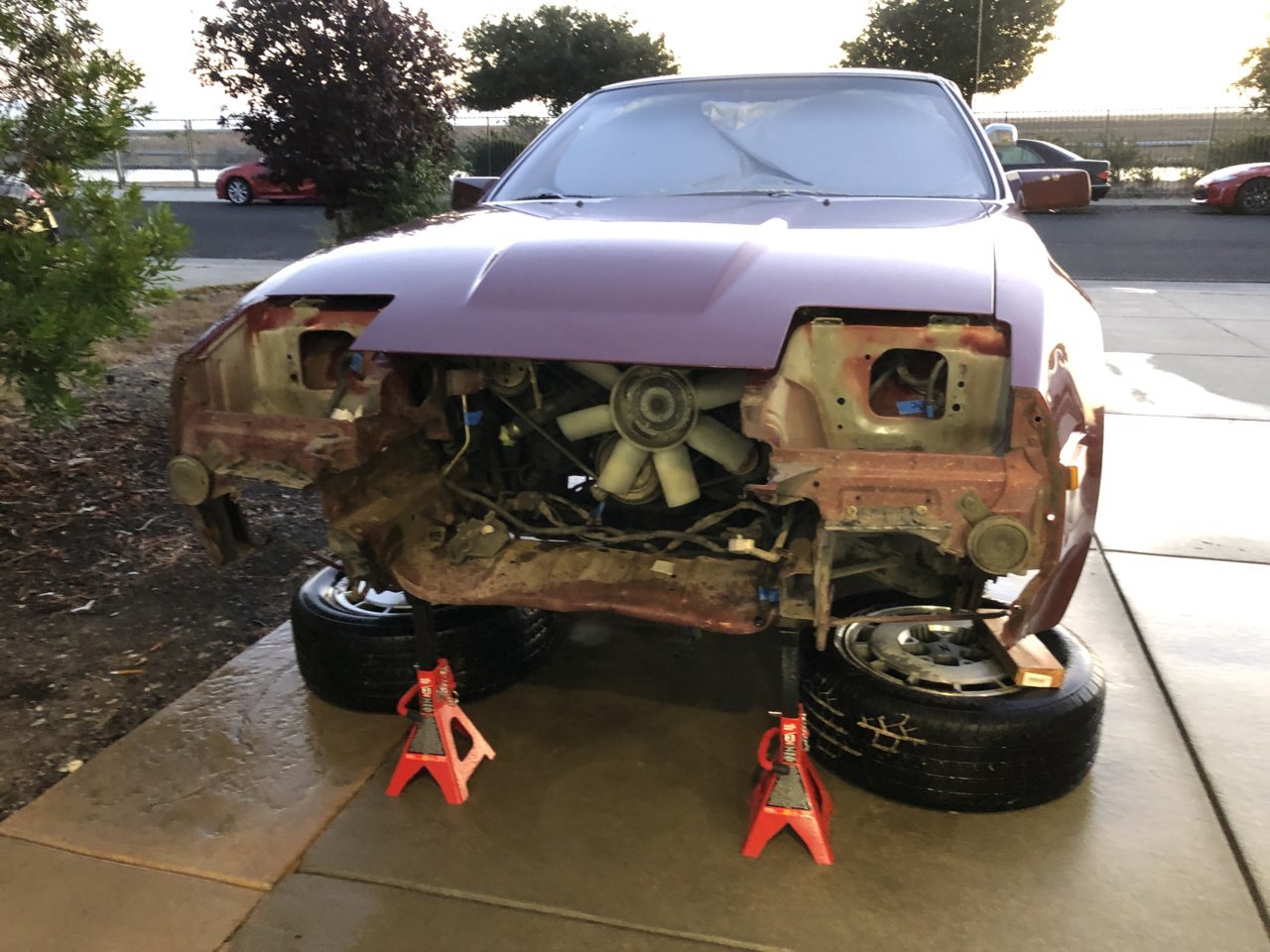

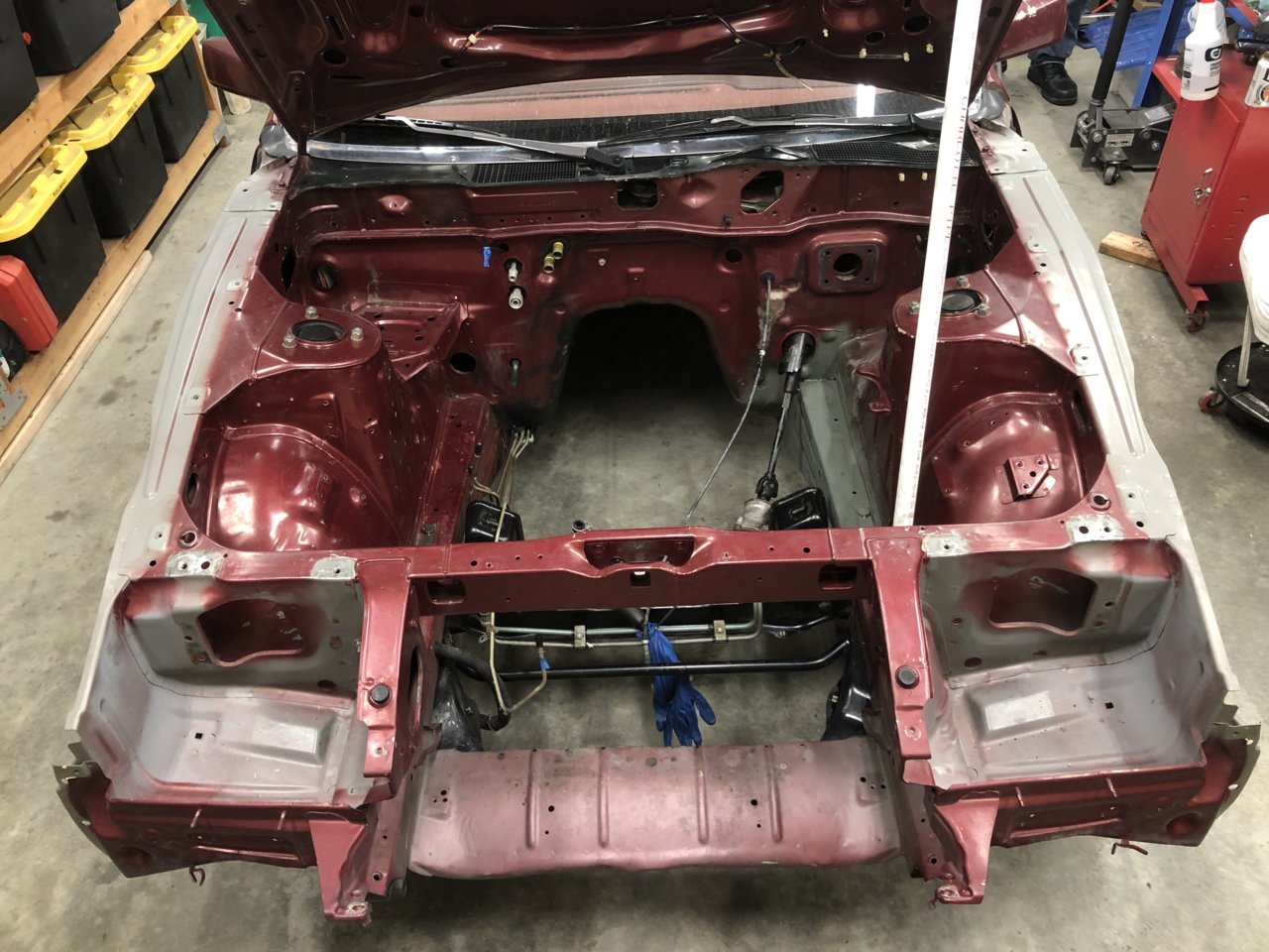

    I did my huge parts order and I started tearing into the car.

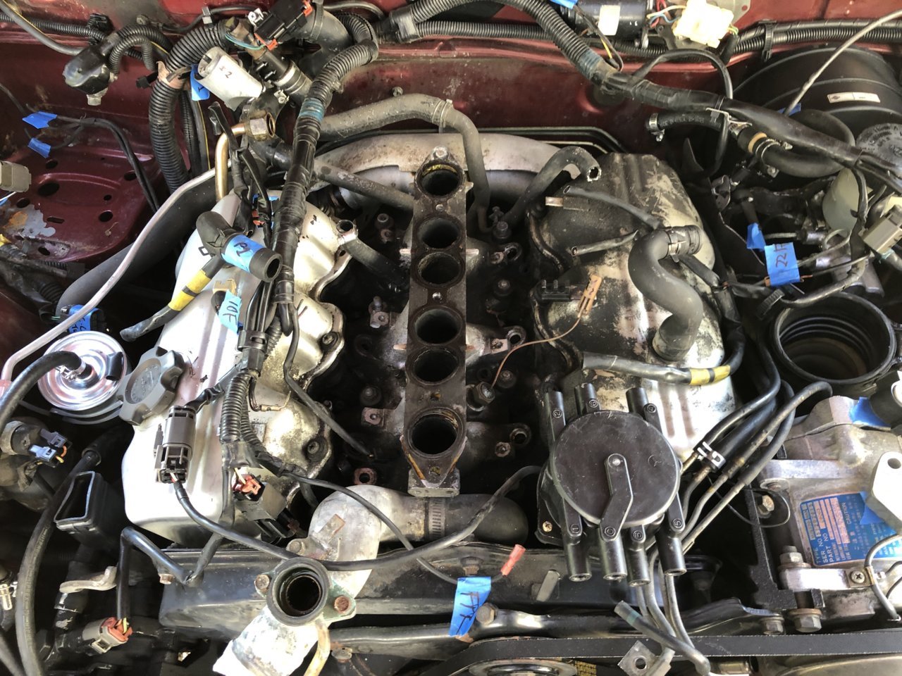

    I removed everything I could topside in preparation to pull the engine. Remember, all the wiring has to go too because of al the rodent damage.
    Here is what it looks like now without the core support, the headlight buckets, radiator and condenser. @Sperrunner was kind enough to recover the R12 into a tank for me.
    This car has a LOT of vacuum lines, and a a LOT of connectors. I tried to label as much as I could based on the factory service manual.

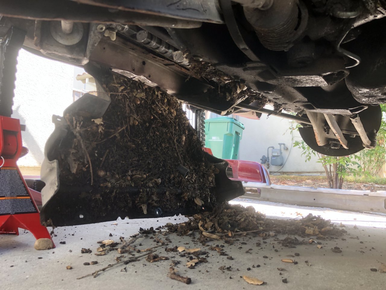

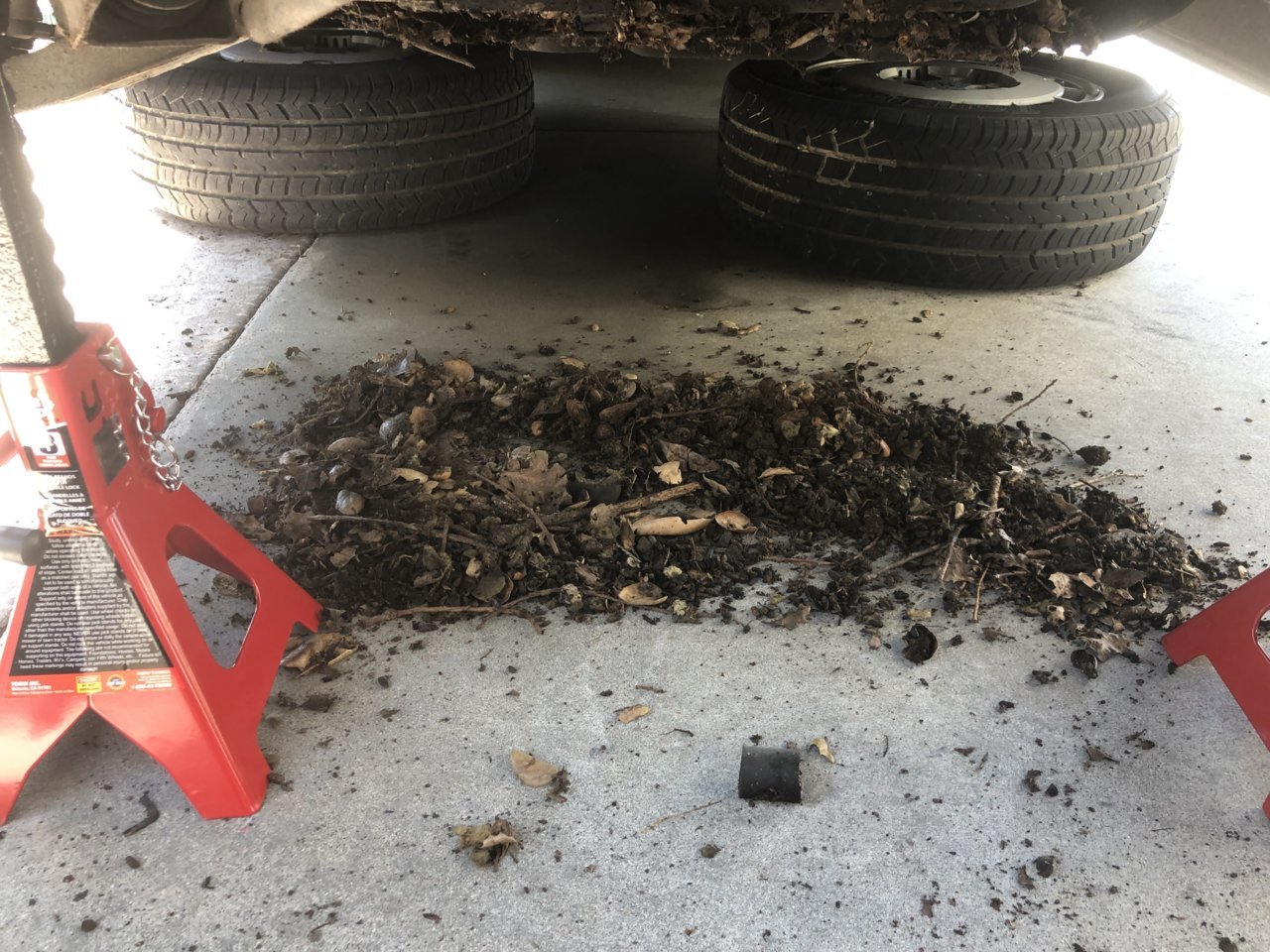

    Remember how I said there was poop... and lots of poop?

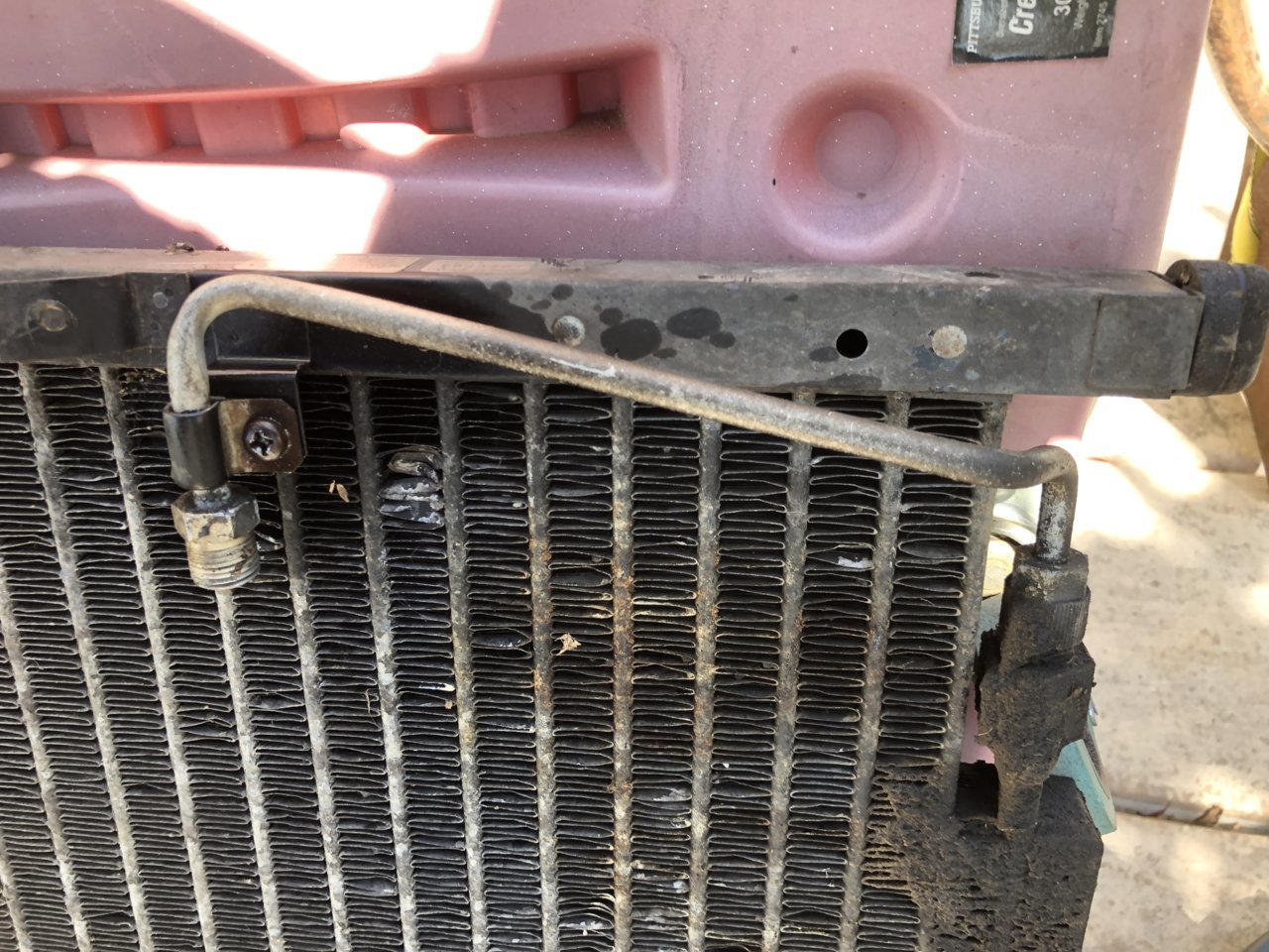

    Yeah on that note I wasn’t kind enough to the AC fittings and bent a line. So I’m gonna have Miguel over here to fix my f-ups.

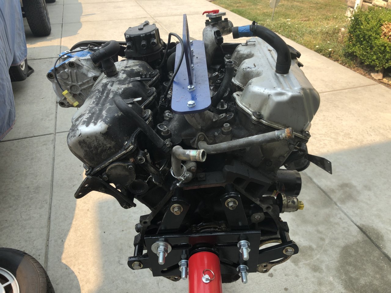

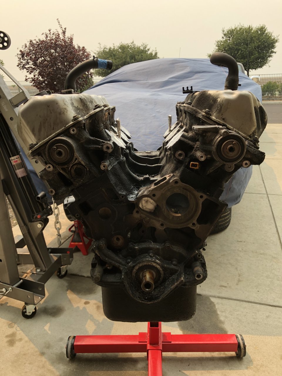

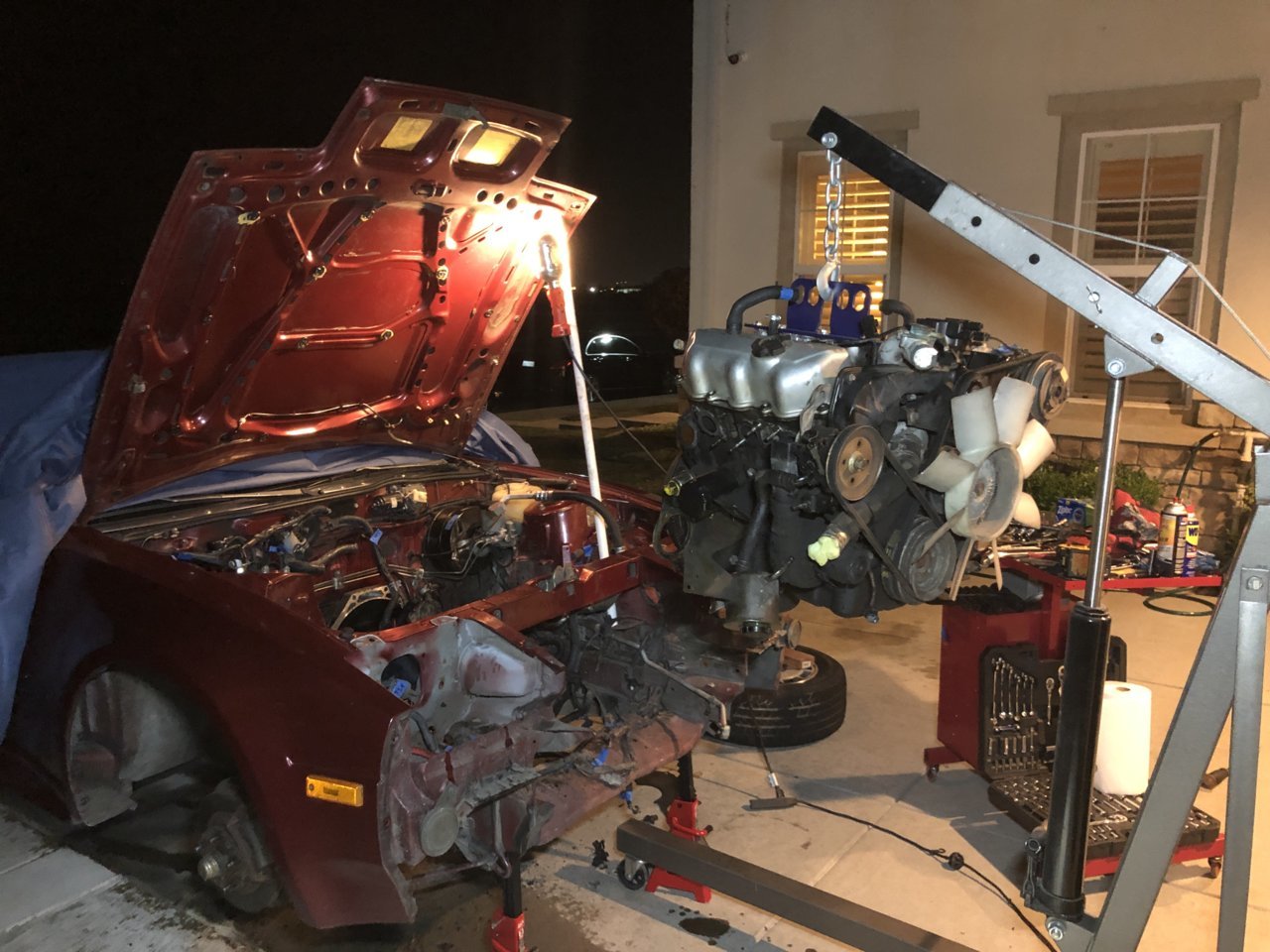

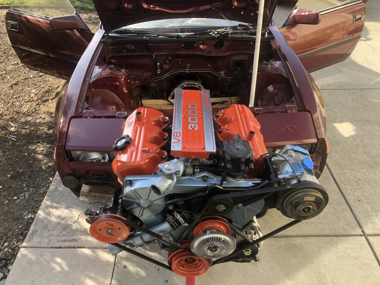

    Engine is out!
    Can you tell where the brake fluid went? Hint: Find the rust that doesn’t belong.

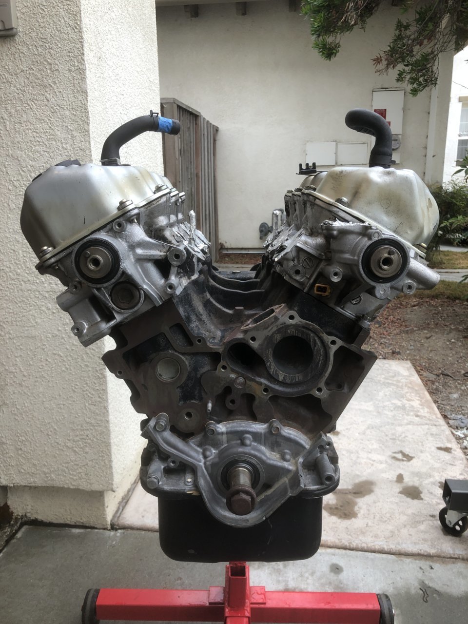

    Here it is up on the stand.

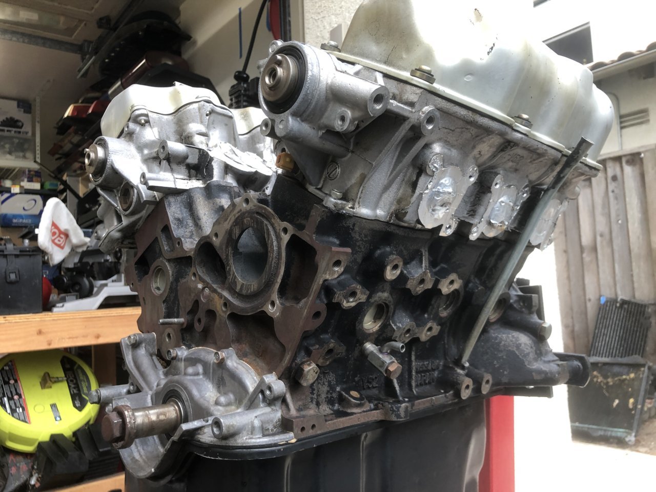

    Been working on removing all the accessories and cleaning them up in the parts washer. Just finished cleaning the block with ZEP Purple degreaser, followed by the pressure washer.
    Before
    After
    The black splotches you see left on the engine block isn’t grease, it’s the pathetic and laughable layer of paint Nissan put on the block back in 1985. I’ll be repainting this in Silver Pearl engine enamel.

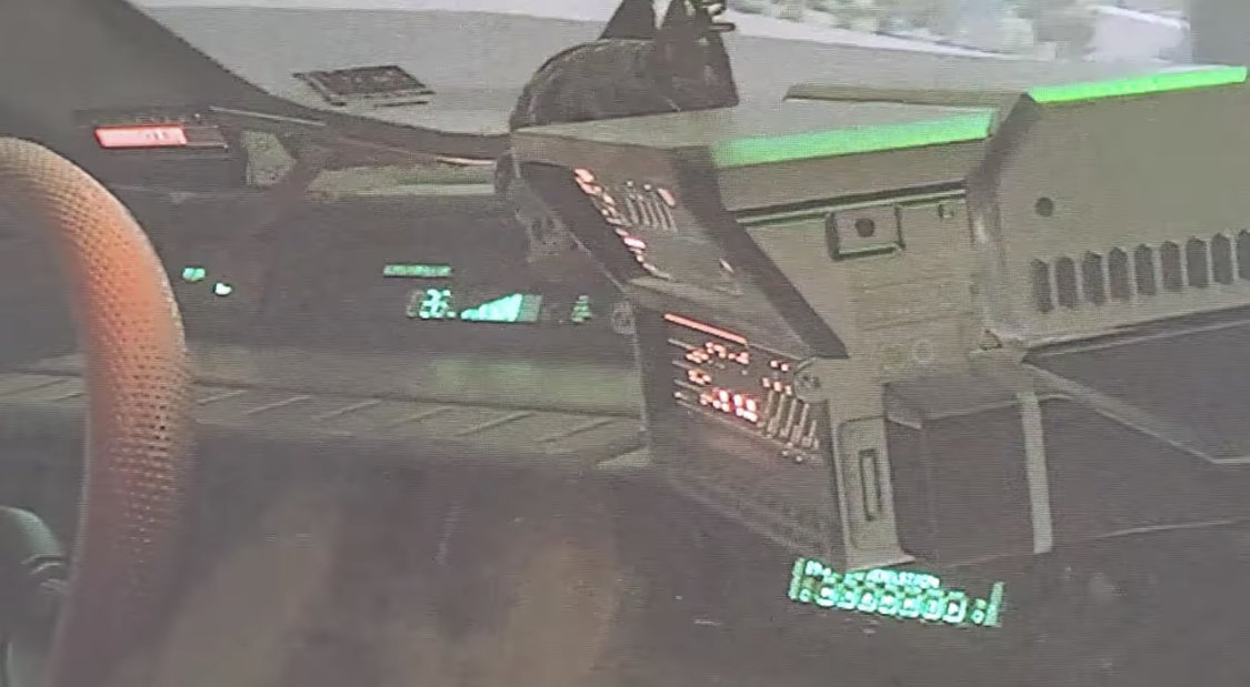

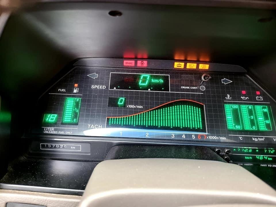

    The cluster in one of the Cyberpunk 2077 cars you drive is based on the cluster in my 300zx.
    71C5FA42-655D-4093-8512-2D7ABC01821D.jpg 00C8C647-A647-4984-87A0-C10242D8E937.jpg

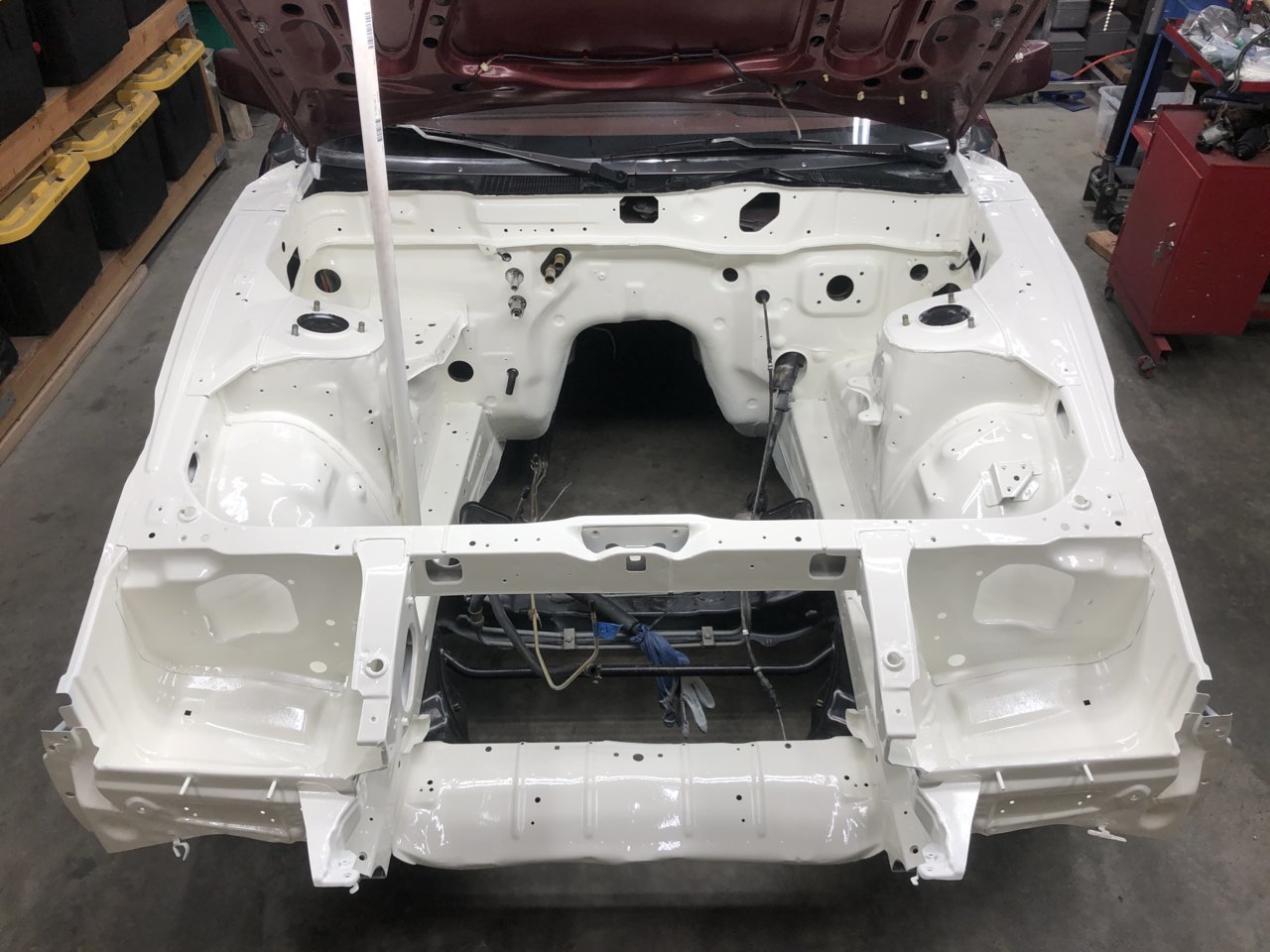

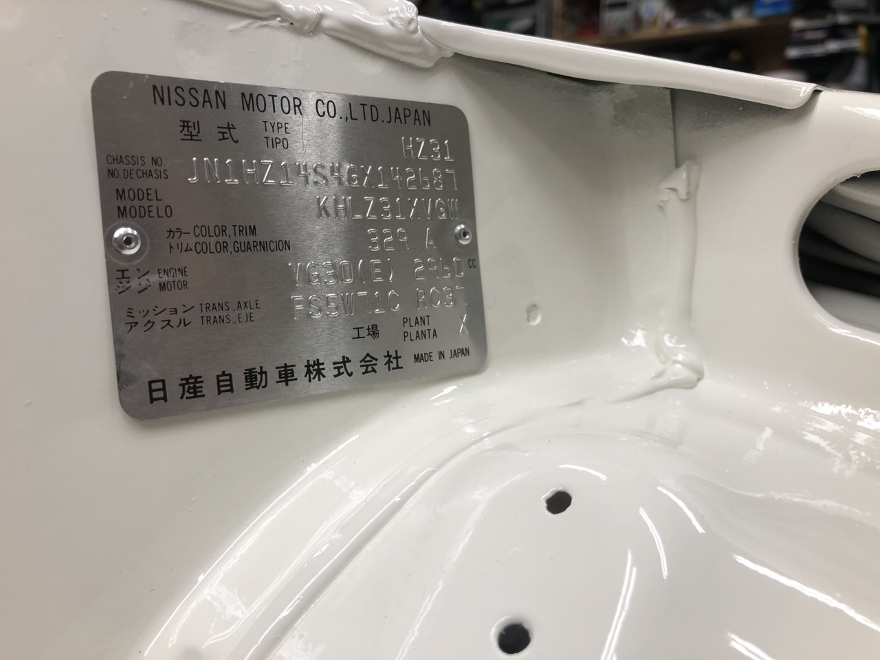

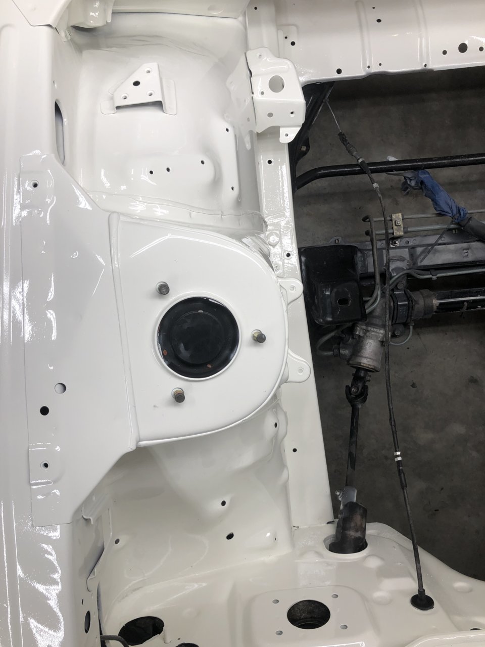

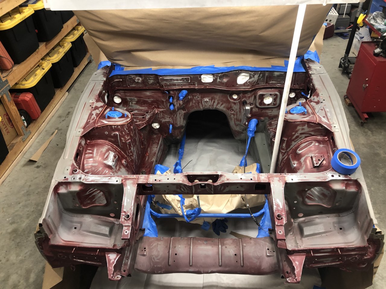

    A lot of progress has been made recently. I finished painting the engine bay in single stage + urethane Gloss White.
    F71C68AF-3217-40EE-843D-06A5FE5E5C64.jpg 9DF1B67C-1411-4CE3-A588-CDDE45133EA6.jpg 0504F18D-C5F5-4BF2-A5EB-C3781013AC26.jpg

    REDO IT. too much orange peel

    It’s an engine bay weirdo, no one is gonna see it when the engine and all the plumbing is in there.
