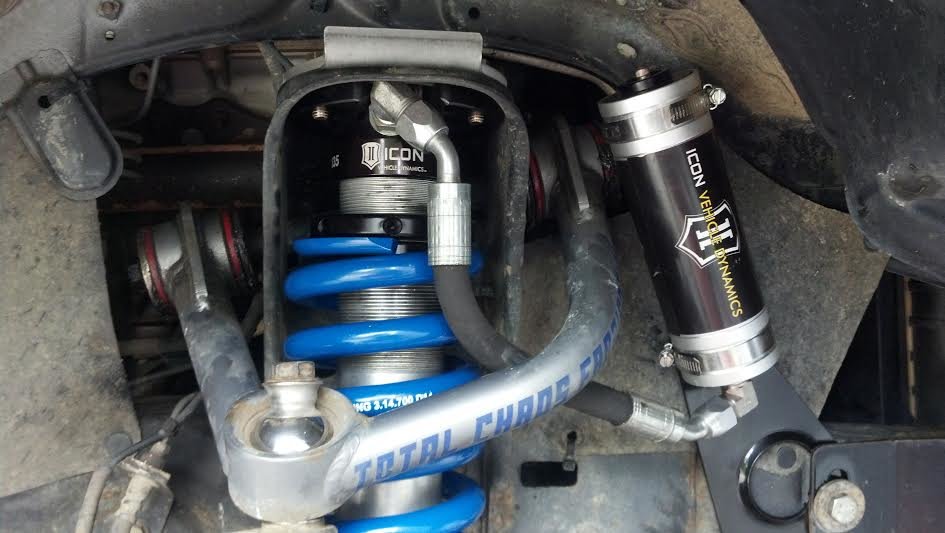

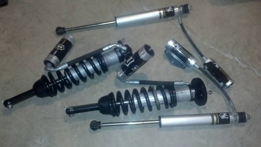

    A few bolts are different.
    Icon extended travel 2.5 fronts. 2.0 rears.
    Couldn't pass up the deal. Just have to get 700# springs to replace the very pre-loaded 650's.

    Nice. :cool: I installed the same ones up front this weekend with 700 lb springs. I love it.

    Cool. Between the different setup's I have read, I believe I'm going to start with 1-3/4" preload on driver and 1-1/4" preload on passenger. That should put this tank close to where I want it, maybe a little high. It is easier to back off of preload when on the truck.
    For reference I like my lift to be about 2-1/4" above stock. This creates a good balance of lift and still plenty of down travel. Also with the angle of the control arms being less steep, this provides for a smooth ride.

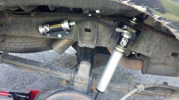

    Rears are on. :woot:
