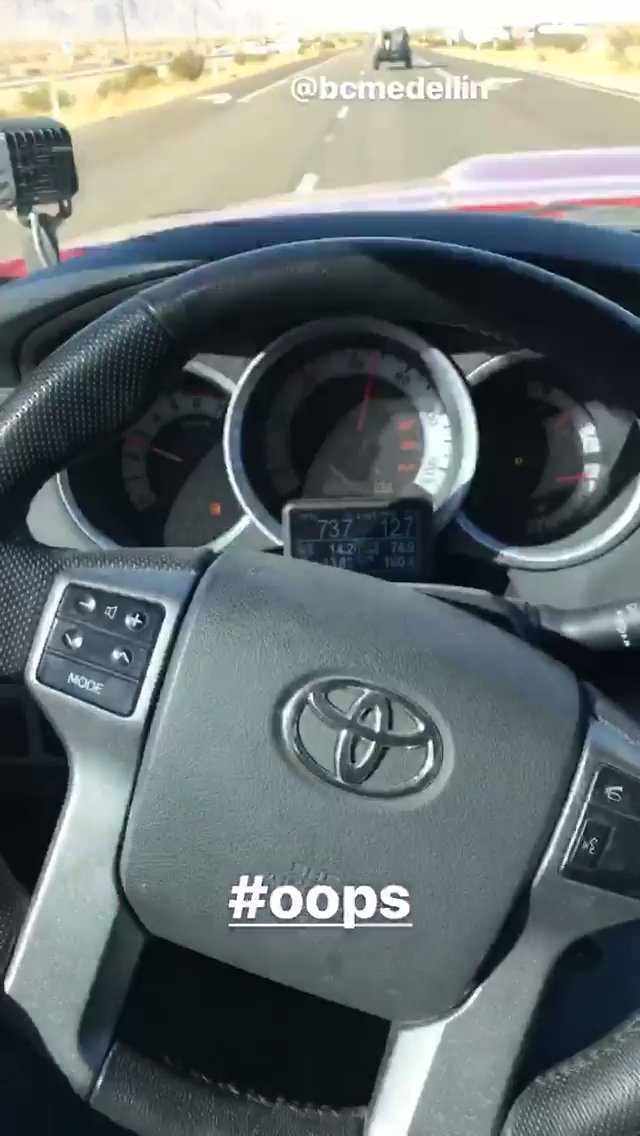

    ...too much shit to list.
    I can check again but I have a gps speedo and a UG that is calibrated.
    Besides, toyotas love being at higher rpms. 3000 is nothing.
    jubei likes this.
  19. Mar 8, 2018 at 7:02 AM
    #219
    jberry813
    Jan 21, 2011
    #49636
    28,484
    Jason
    Lake Tahoe
    2012 DCSB Sport
    Here: 73.7 MPH (calibrated UG) and looks like about 2800 rpm
