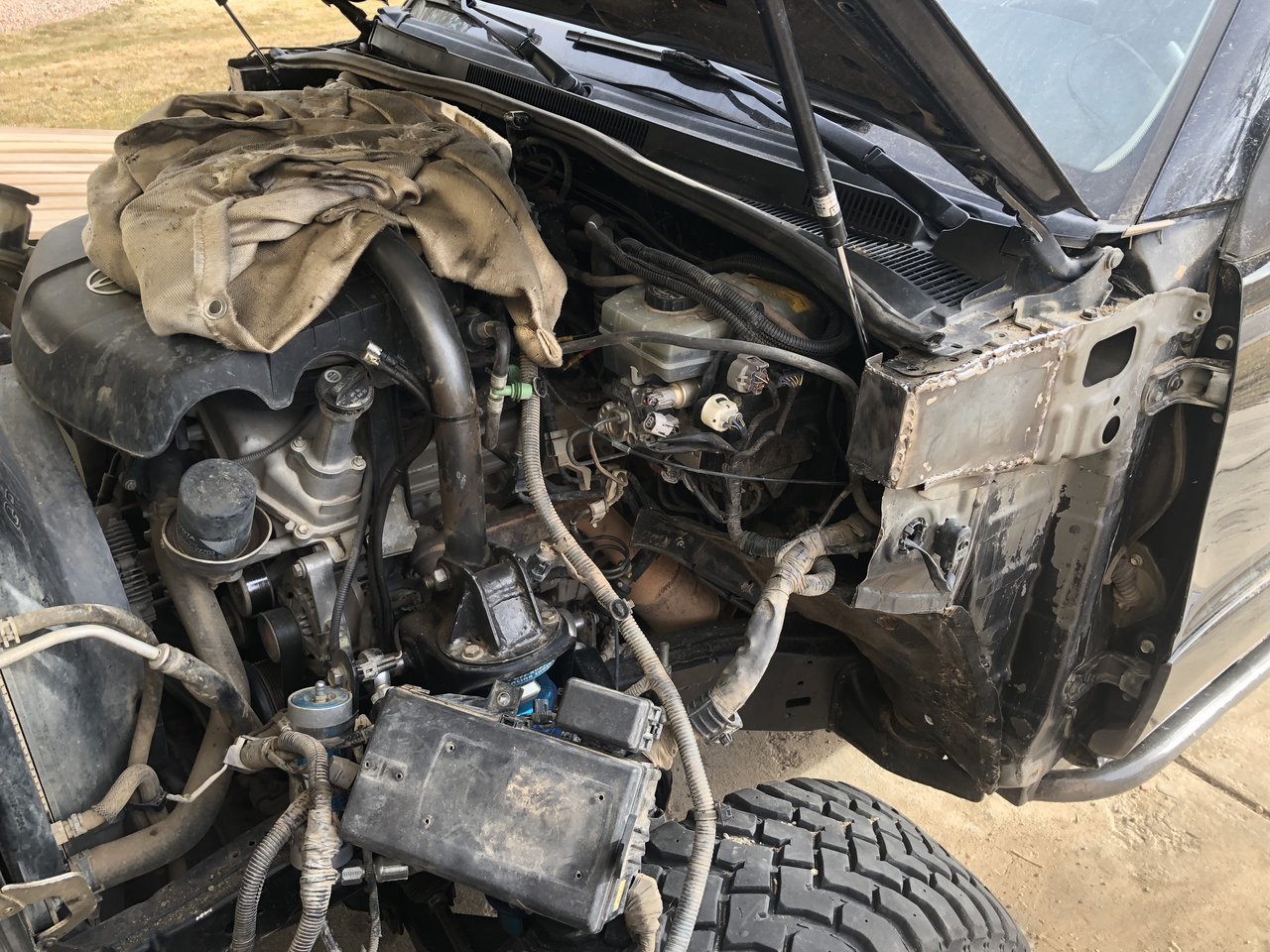

    Sadly I think the only fix is chopping the whole fucking thing out, the cracks just show up in new spots after reinforcing the current weak shit. This took me about 3 weekends to knock out, but should be set for a long time, used 2" 1/8th wall all around.

    Did you just jump right in and start chopping and replacing things? I've been loosely looking for information and tips on how to do it, the whole job seems overwhelming to try to take on all at once though and without the original dimensions before everything starts cracking and falling apart how do you know where everything exactly goes?

    Do you have more photos of the whole project? I'm curious about the whole thing from start to finish.

    Here's what I have in my build, I have a few more that are not on there I will add that you can take a look at.
    https://www.tacomaworld.com/threads/wishbone-runners-build.238998/page-48
    As far as the process, I started just cutting out the whole passenger side and trying to mirror the driver side for the alignment with the hood, radiator and fenders, then moved to cutting out the rad support, then the driver. But, this didn't really help the whole alignment as measuring with a tape didn't really get me the correct alignment that I need, so i eventually cut all the stuff I had tacked in place off and just freehanded all of the alignments. The major ones were getting the rad in the right place to not hit the fan, then the fender/lights/hood alignment which was the hardest part to get lined up, and I would say it came out about 90% right - I have a bit more gap than I started with from the bumper to the fenders, and the fenders aren't 100% level with each other.
    If I were to do it again, I would find a good reference for the hood height and top of the radiator support from the bumper, then chop everything out starting with the rad support and use the hood as the guide for the lights and fenders which can really only mate together one way. It is definitely a seemingly overwhelming task when you have a pile of parts that don't really have a clear method to go back together, but it just takes some time to line stuff up, tack in place, check clearances, adjust, then repeat - just like every other fab project. It seems like you have a pretty good understanding of fabbing stuff, so it is really the same process, just a bit more daunting. You've already got the battery else where, this is where I spent a LOT of time figuring out placement, support etc.
    I started collecting info and pics a few years ago and just decided to jump in, I got some great pics from @Happysmiley which helped a ton and kinda copied his design so that was SUPER helpful. Let me know if you have any more questions.

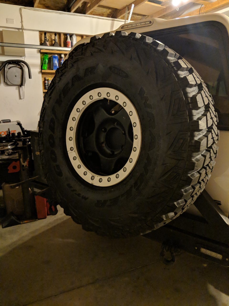

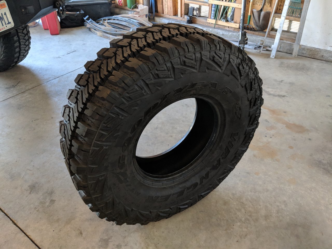

    Taking care of little annoyances....

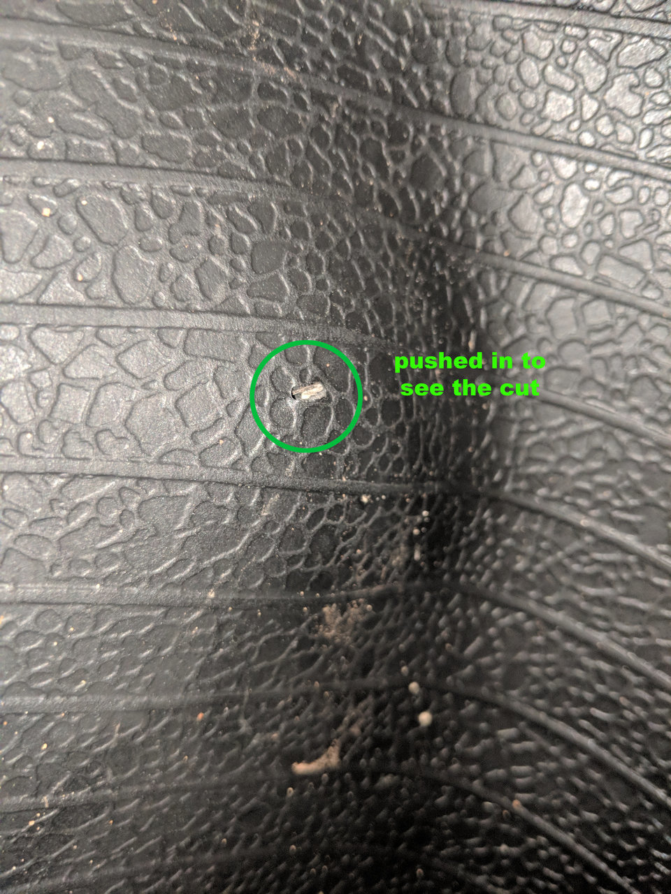

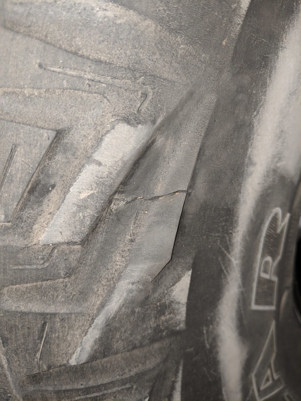

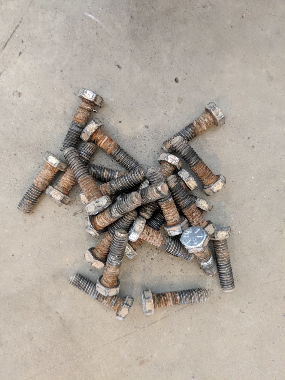

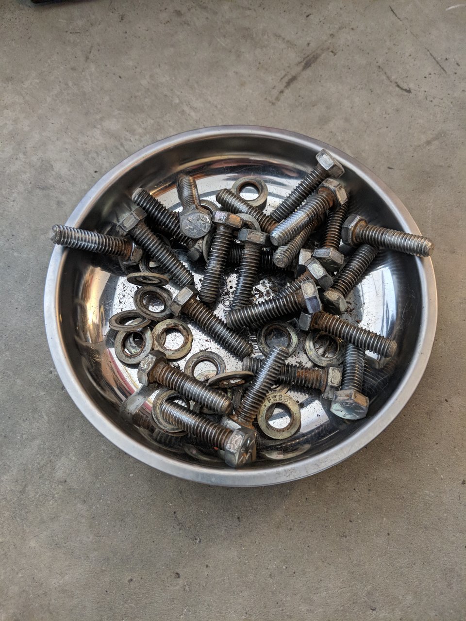

    I thought getting a tire warrantied with beadlocks was going to be a pain in the ass, actually turned out not be a problem at all. I bought them from America's Tire but didn't get the full replacement certificates since I didn't know if I was going to keep the tires their whole life or not. When the guy inspected the tire he didn't even check to see if it was actually leaking, just took the tread depth and ordered up the tire for me. Went back a couple days later and picked up the new tire and turned over the damaged one after personally removing it from the wheel.
    Photo of the outside of the cut, funny thing is it cut through the thickest part of the sidewall rubber
    Photos of the inside of the cut
    The beadlock bolts had been installed for less than a year but were already nasty where the threads weren't in contact with the beadlock side
    Cleaned up with a wire wheel on a bench grinder
    Brand spankin new tire
    Done up and have to get it road force balanced still

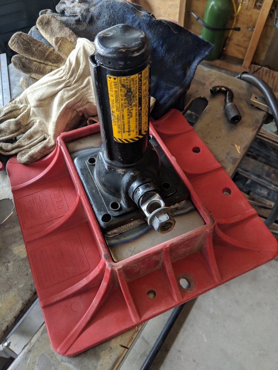

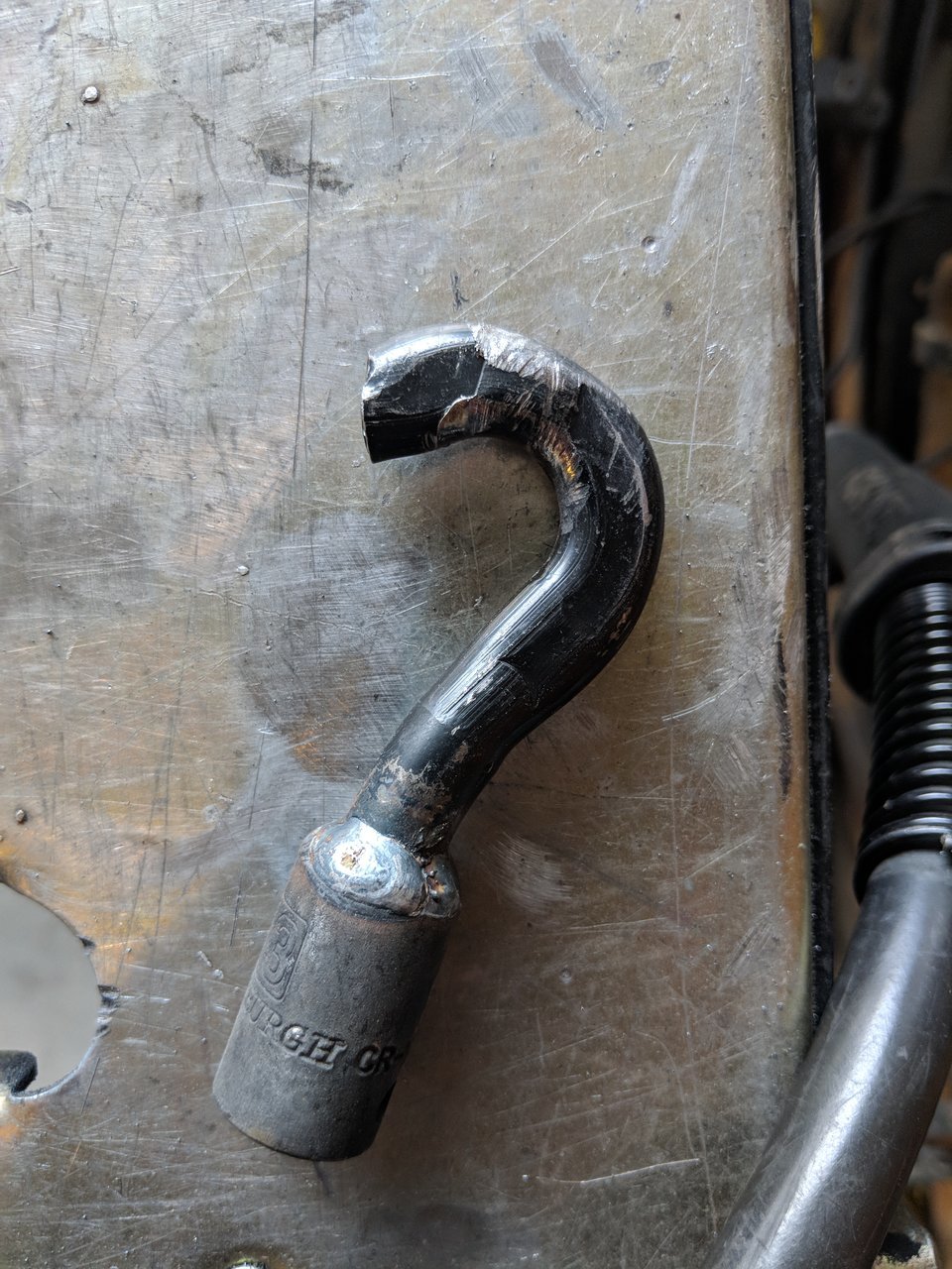

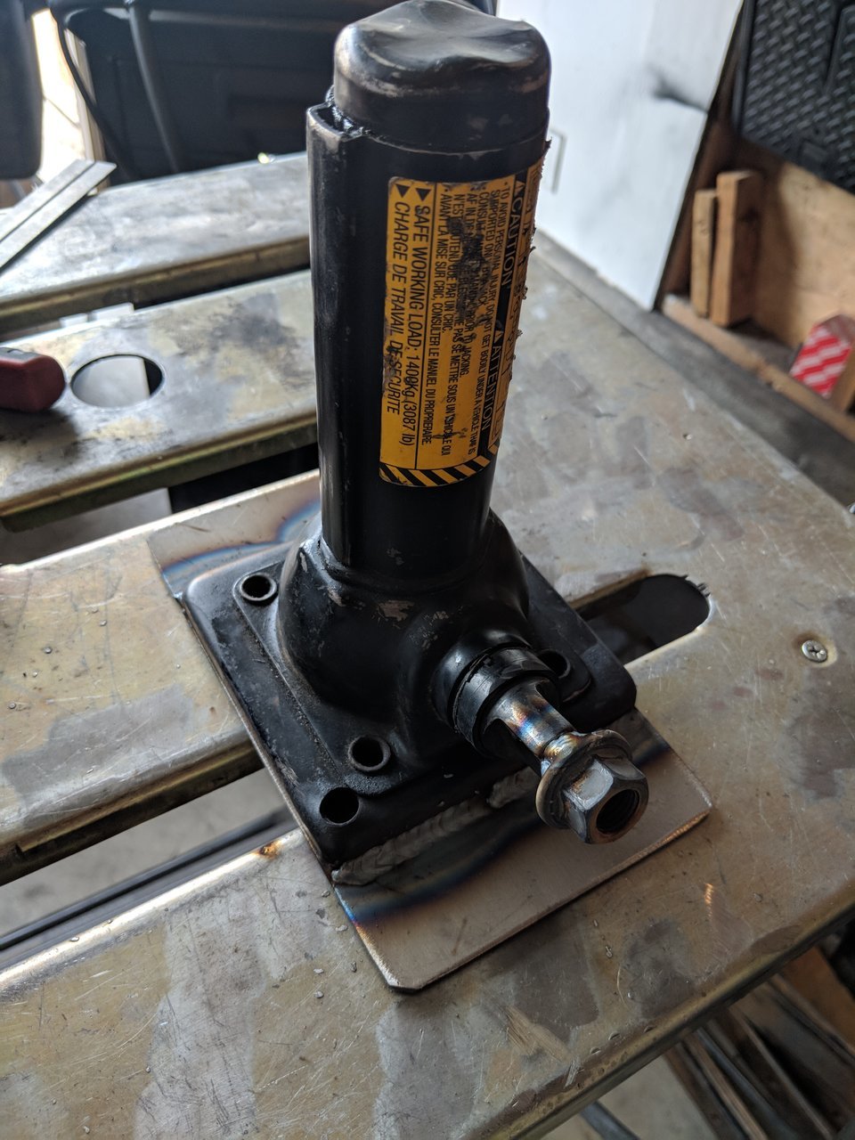

    In the quest to make things safer, lazier, and more efficient I went about making the stock jack more convenient to use.
    Last time I had to swap a bunch of tires around on a trip to the San Juans I did it with a Hilift. I'm not afraid to use one, but those should be a last resort for everything and don't want to use them if I can avoid it, and trying to jack up the rear axle high enough to change a tire is a sketchy shit show if you've got a lot of down travel.
    This last tire that went out I tried to use the stock jack in the Hilift brand base but it didn't fit quite right. I used it anyway but could make some improvements.
    I took the stock jack and ground a 1/16" off the sides so it fit down in the recess properly, Then welded a flat piece of sheet metal to the bottom so it doesn't gouge into the plastic base. Next I welded a nut to the end to make it easier to operate the jack with a impact. Previously I was using the stock "hook" welded into a socket but the hook wasn't up to the abuse of being impacted and was starting to wear a bit after just a couple uses

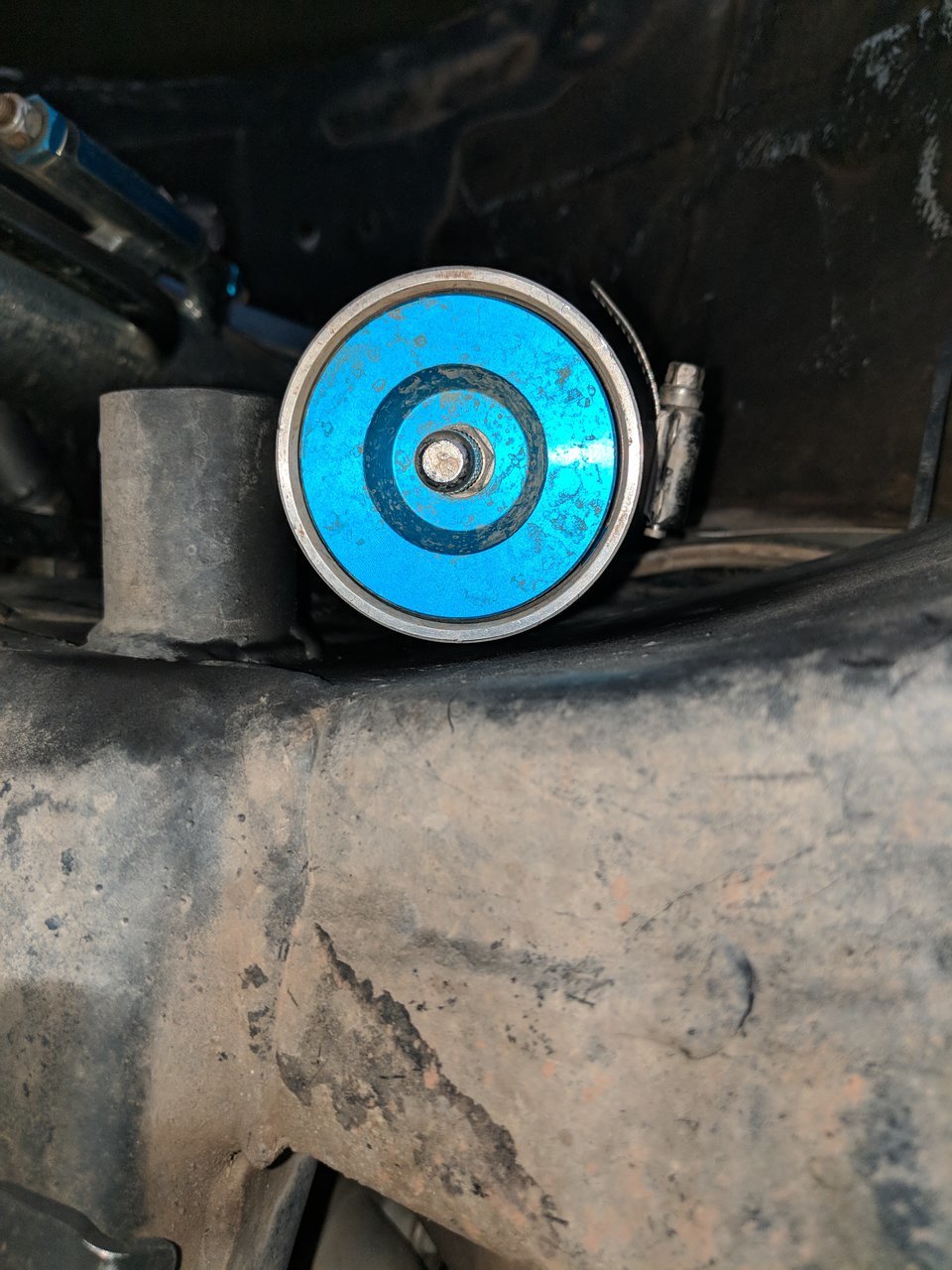

    Also took care of an odd rubbing issue in the front. Seemed like if the front was articulated and steering maxed out the tires would occasionally rub on the reservoirs, doesn't happen often but its annoying when it does happen. I ended up moving them closer to the frame. Previously they were about 1/2"-5/8" away from the frame, but I tucked them closer to about 1/8" or less so hopefully the tire lugs don't hit them anymore.

  15. Mar 13, 2018 at 11:09 AM
    #235
    bullaculla
    bullaculla IKA fabrications
    Oct 14, 2012
    #89002
    8,155
    Da big big island!
    2013 MGM DCSB Tacoma 4X4 TRD Off Road
    All pro 3 link SAS kit, Diamond axle, kings on 37" MTR/K
    Whachutalkinboutwillis?
    3 out of 8 37" MTRs were good! :laughing:
  16. Mar 13, 2018 at 11:25 AM
    #236
    Oreo Cat
    Oreo Cat Worst Member
    Sep 19, 2016
    #197755
    5,369
    Coeur d’Alene, Idaho
    Were you using weights or dynabeads?
  17. Mar 13, 2018 at 11:44 AM
    #237
    bullaculla
    Oct 14, 2012
    #89002
    8,155
    Da big big island!
    At first dynabeads, when that didn't work, traditional weights. But the tires were out of round. No amount of weight will make that ride smooth. Goodyear sent me a whole new set of 4, and one of them is still reading 0.050" runout on the road force balancing machine...
    :annoyed:
    Tire shop said 0.030" is acceptable.
    tetten[OP] and Oreo Cat[QUOTED] like this.
