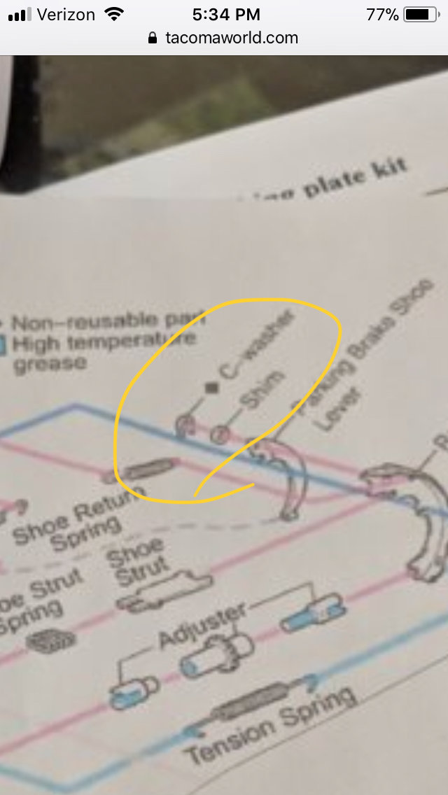

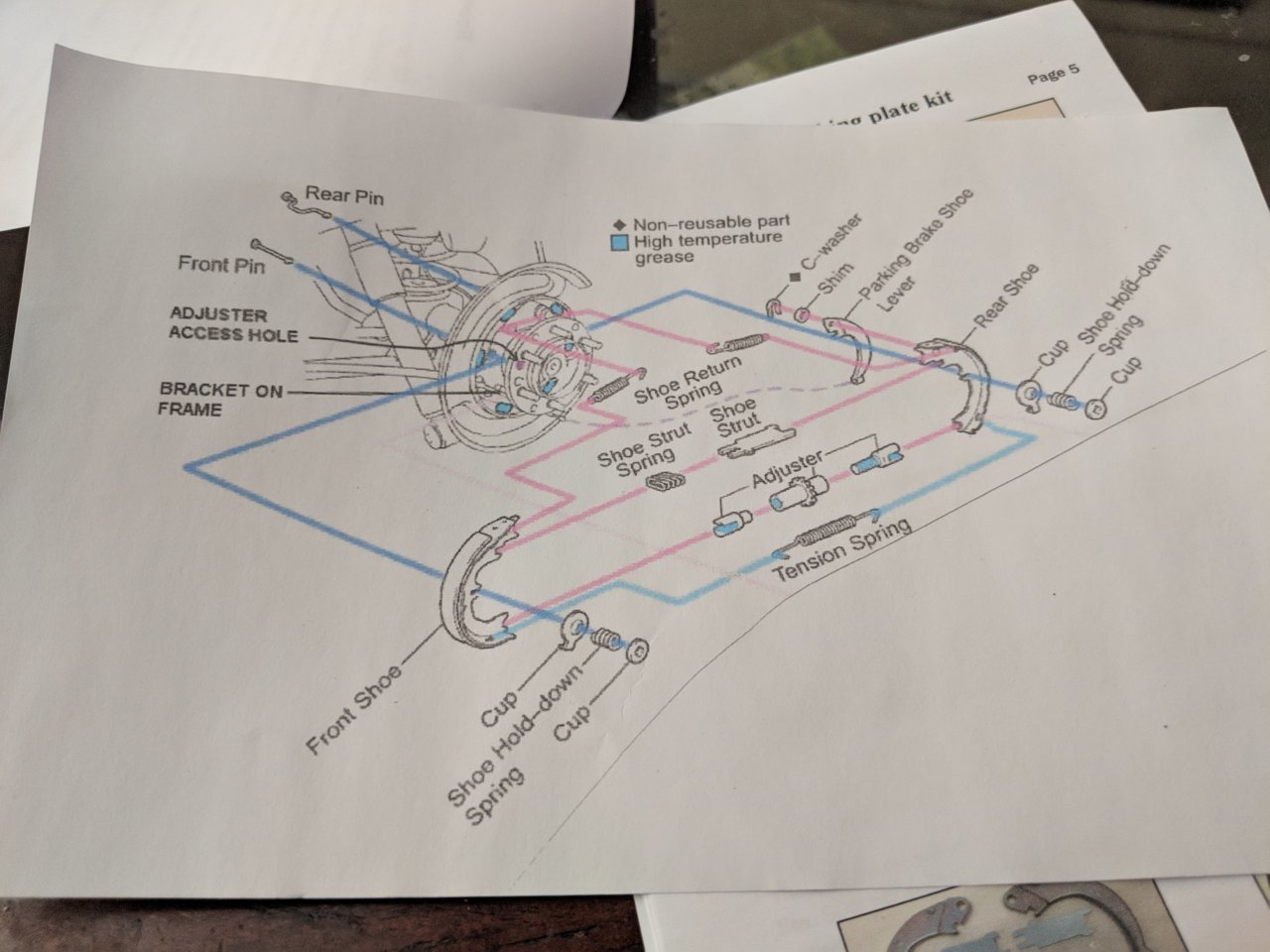

    Blue shims? I don't see anything in my kit that looks like a blue shim. Got a photo or diagram of what you're talking about?
    Edit: our kits are probably slightly different, I may not need them since I don't see anything on my diagram

    The shim goes here. Literally looks like a thin washer. My kit came with a separate bag that had the two blue shims in it. They were inside the assembly instructions. But you are right they are different kits so may be different. You may use the spring shims with your kit.

    Well shit now I'm worried I'm missing something, what's the difference between them? The blue ones don't have a bend? And how did you know to use them instead of the ones in the main bag?

    I don't know if you got the scoop from him or not, but he said the curved washers in the parts bag can cause some unwanted friction. I can use them if I want and they will be good, just not optimal based on their experience. Between when my kit shipped and yours shipped they started including the other washers with the kit.

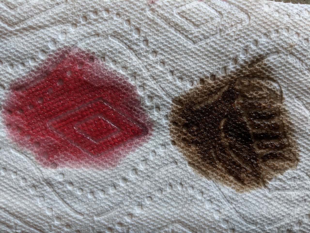

    Swapped out the ATF and dropped pan at 60k miles. Probably should have done it 5k+ ago. All the red tint is gone but still has a sweet scent. Going to need to install a larger cooler too, most of the milage on this ATF was with stock tires or 33"s. Only about 20k was on 35s and didn't start getting heavy with armor until 25k miles.

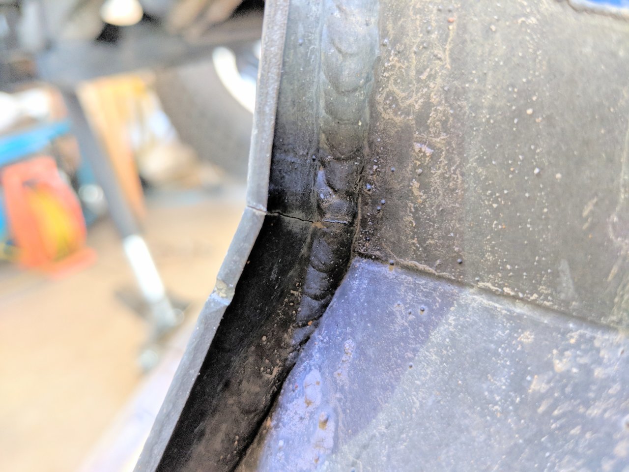

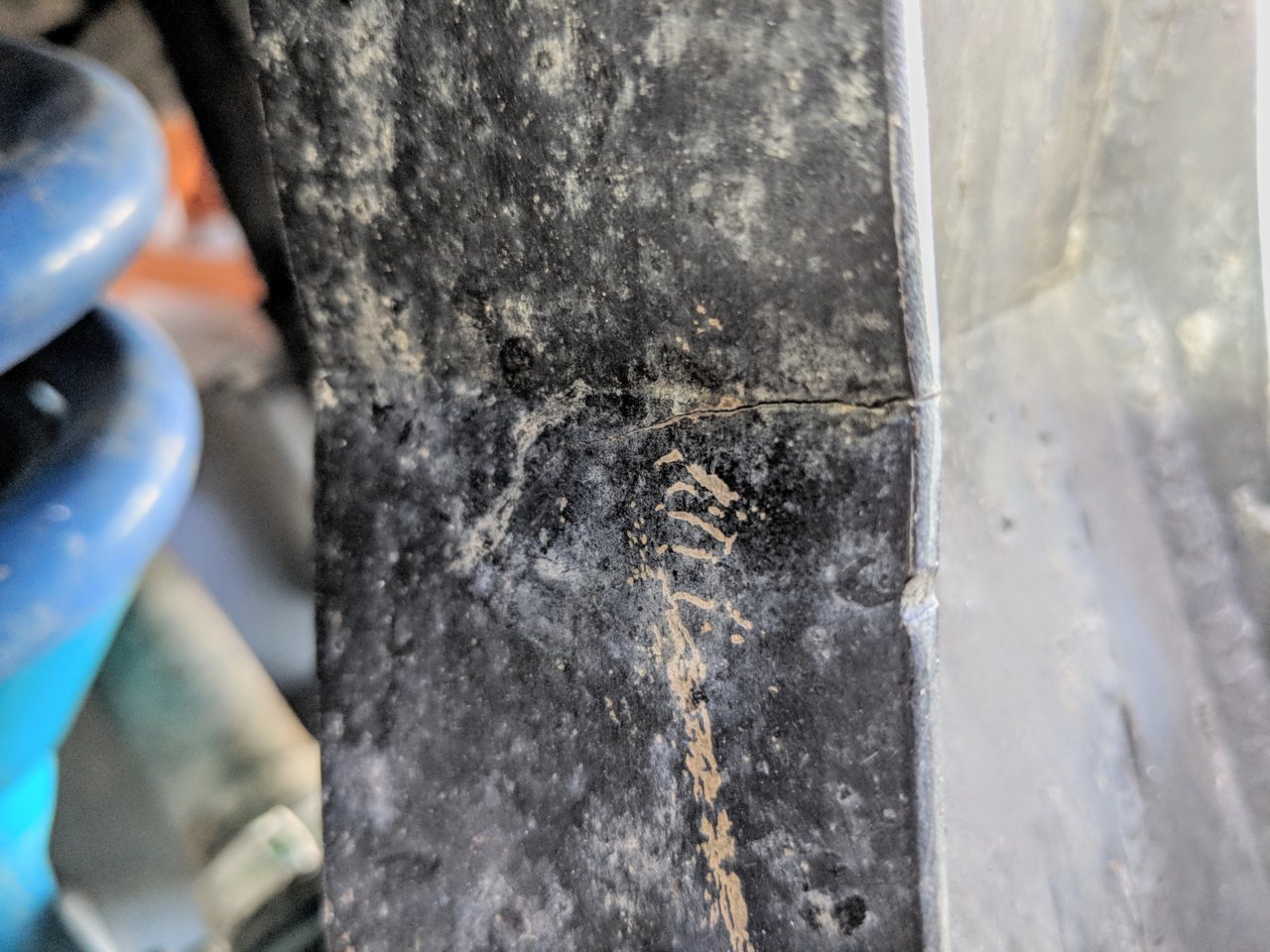

    Noticed this crack on my driver side "The Truck Shop" spindle gusset. Appears to be in a non critical area and don't plan on any retard driving on my next trip, I'll keep a close eye on it to make sure it doesn't get worse and pull the spindle after I get back and repair it.
