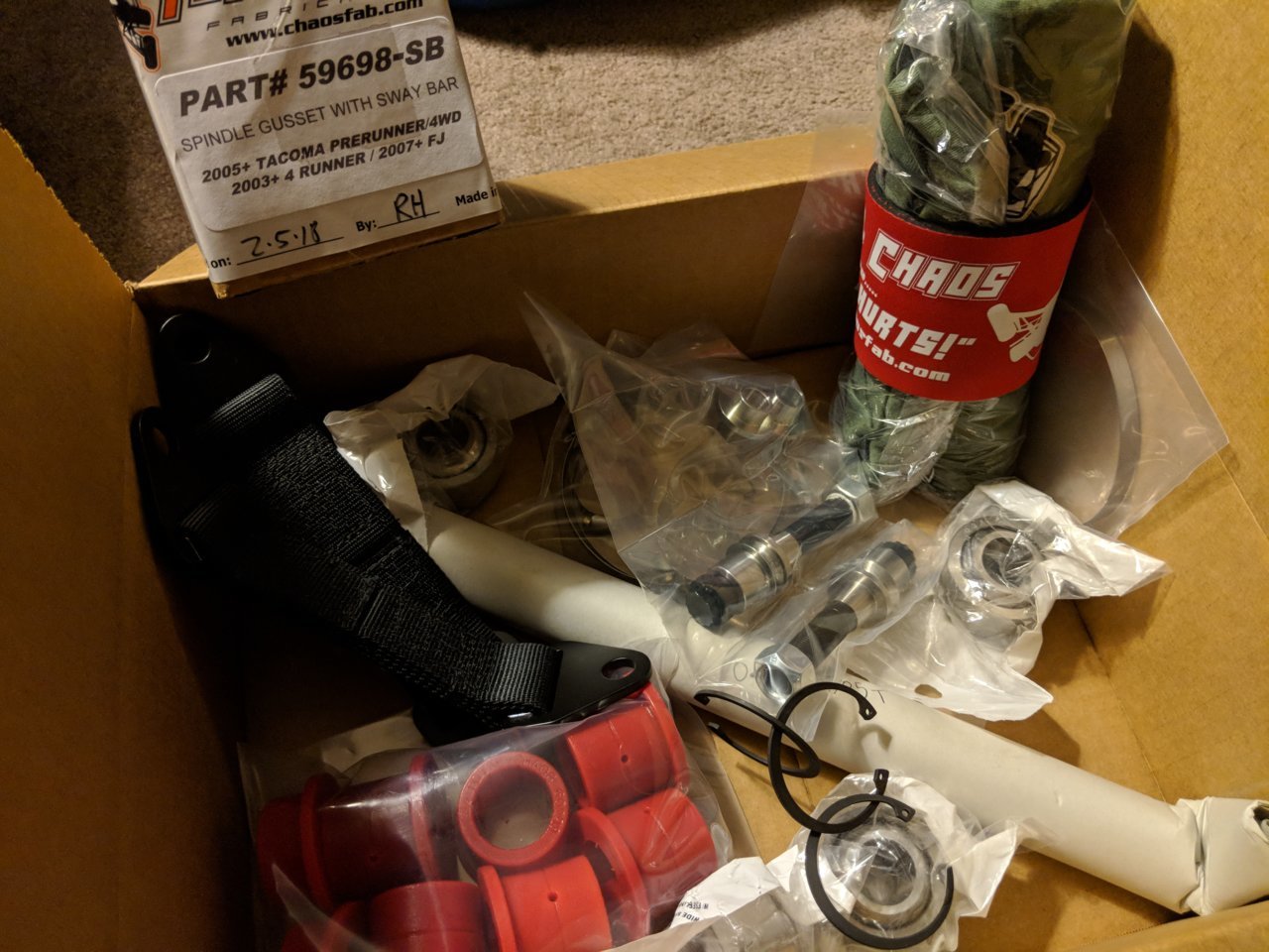

    I used these guys when I rebuilt my UCAs. They have snap rings too. So far no issues. I plan on using them when it comes time to rebuild my LCAs
    https://www.nexgenoffroad.com/product-p/nexgu16.htm
