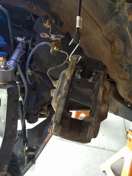

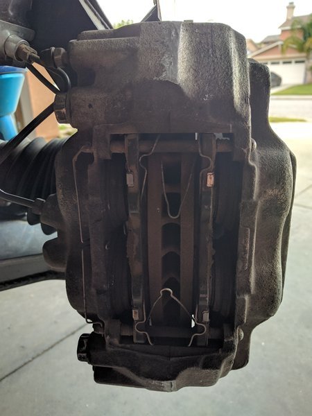

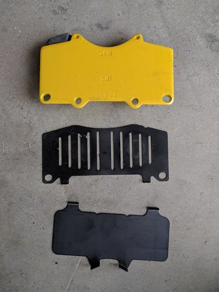

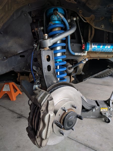

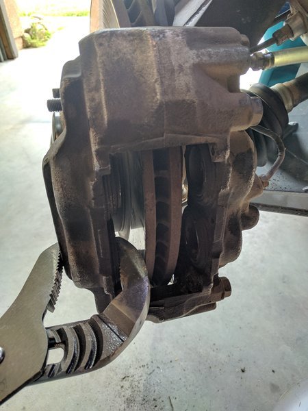

    Finally installed EBC Yellows like @jberry813 recommended to me back in December. I installed Napa rotors as well even though the OEM ones were still good. I haven't finished the break in period but I can definitely feel a small but noticeable boost in the braking power. Their reputation for putting off a lot of dust is definitely deserved, I pulled my wheels off a couple days later, a bunch of dust got knocked off and ended up on the garage floor, I ended up stepping in it and tracked the dust onto some carpet in my house. Photos aren't in order and jump back and forth from side to side.
    I did this job at the same time as the tie rod swap so I could move the spindle around as I wanted, I pivoted them out to make getting to the brakes easier.
    Mandatory pre-work photo to reference if I forget how something went together, or do 1 brake at a time and use the untouched one for reference.

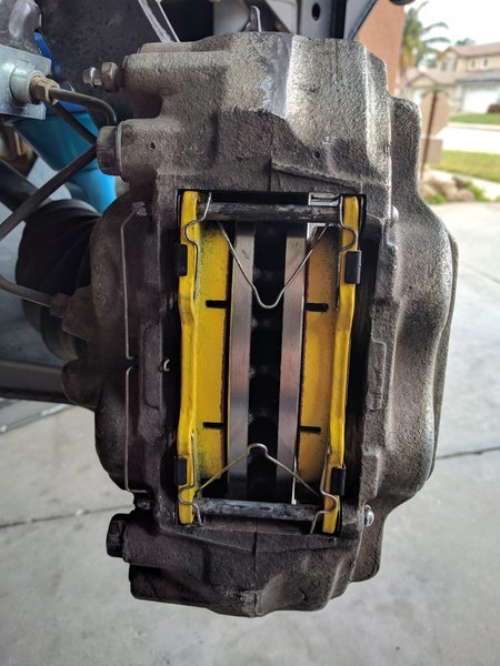

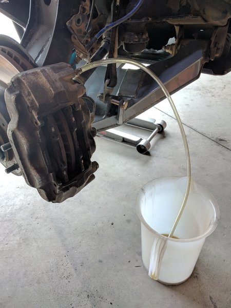

    After pulling out the old hardware and pads had to push the pistons all the way in to make room for the EBC pads, ended up just bleeding the brake fluid off to make room for the pistons in the calipers. I used Channellocks to compress the pistons, could also use a large screw driver prying off the old rotors.
    Pistons pushed all the way in
    Removed the ABS wire guide and suspended the caliper off to the side for inspection and cleaning.
    I've seen a couple people post up their process for these and they got noise reducing sleeves to install in the pistons, for whatever reason, I didn't and just reused the old anti-squeal shims.
    Everything reinstalled.

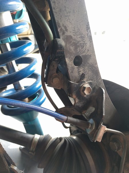

    -installed triple bypasses in the front

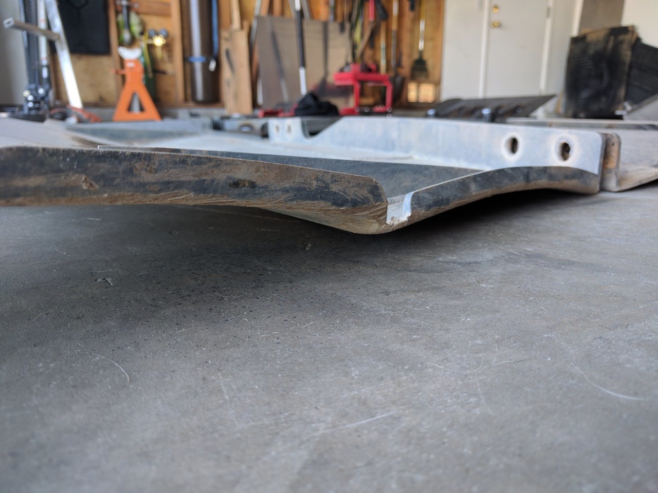

    Gonna try to give this thread some love with some updates.....

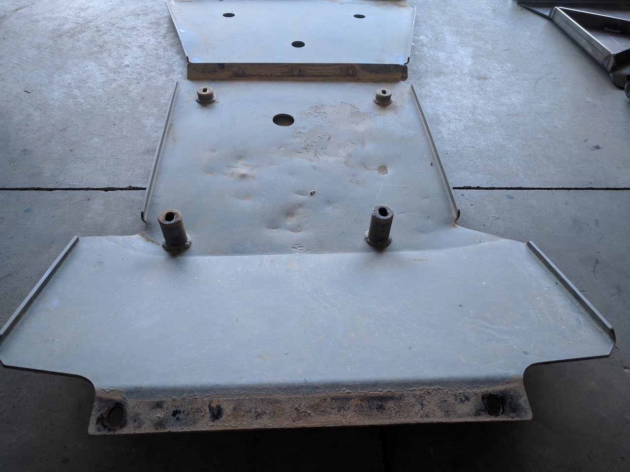

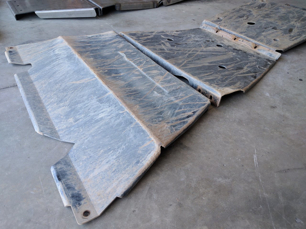

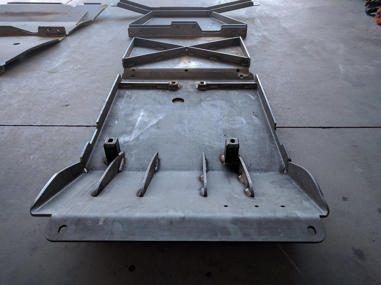

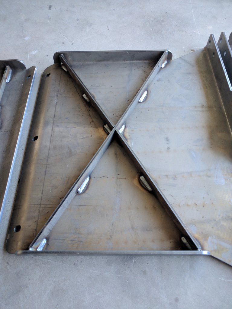

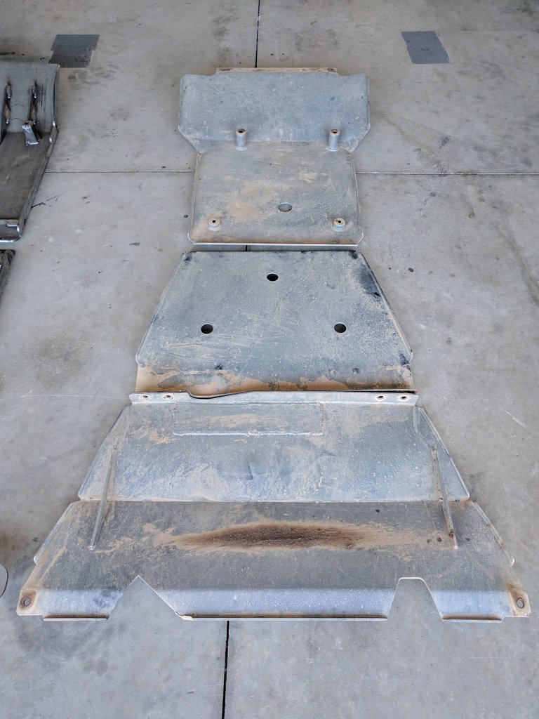

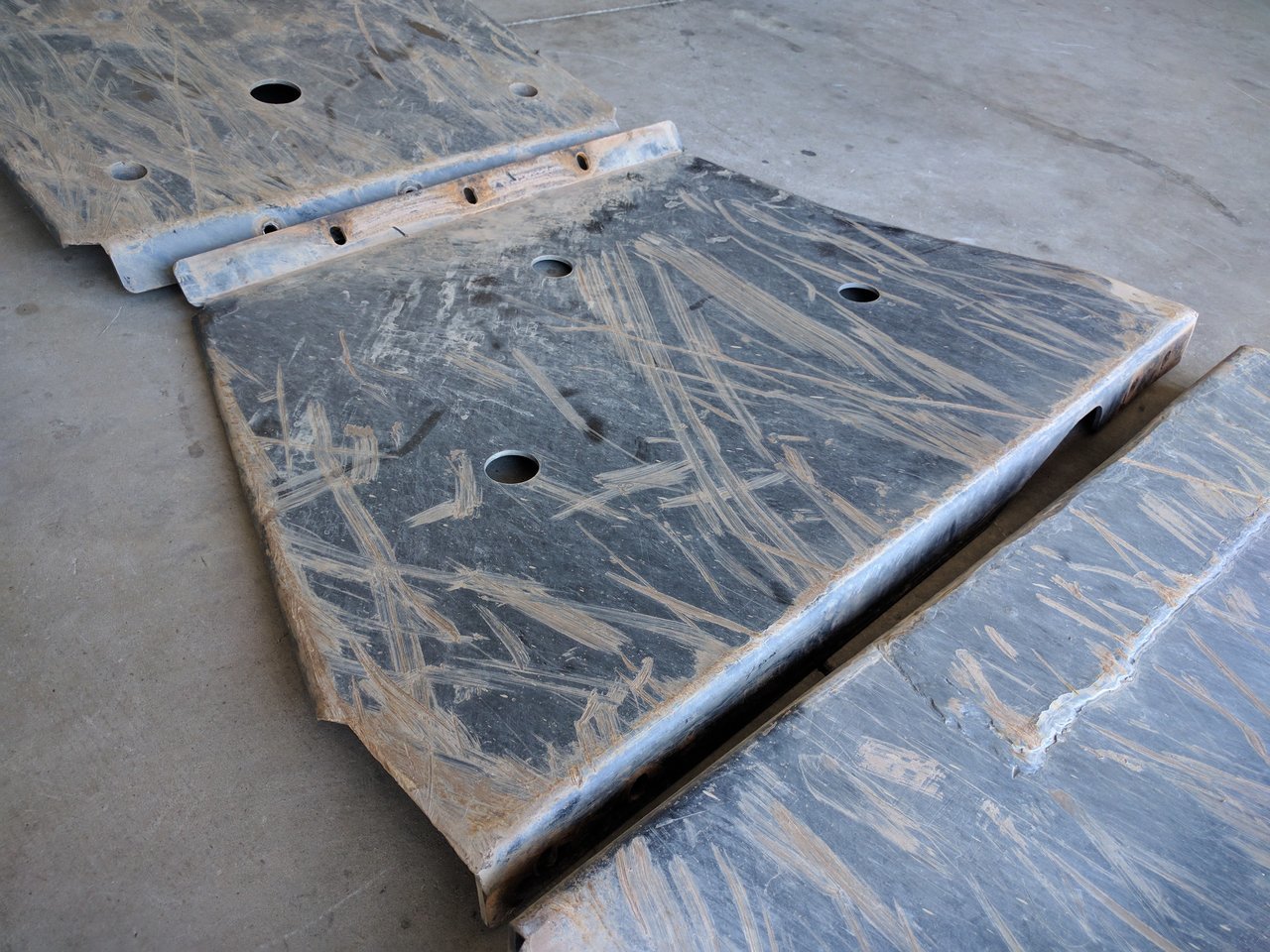

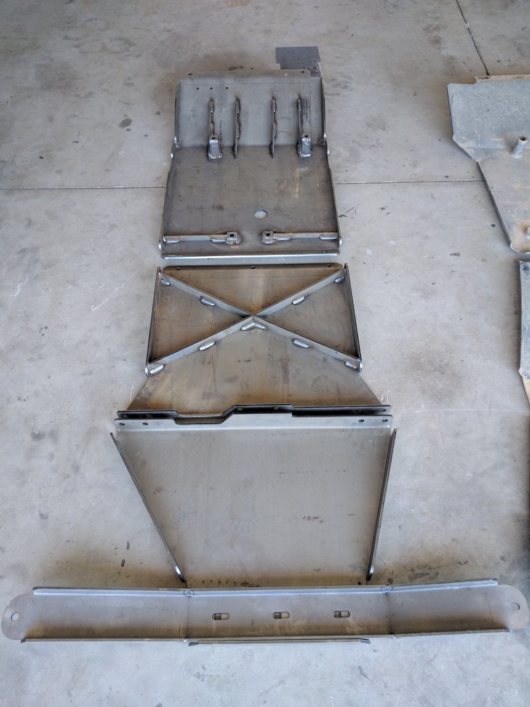

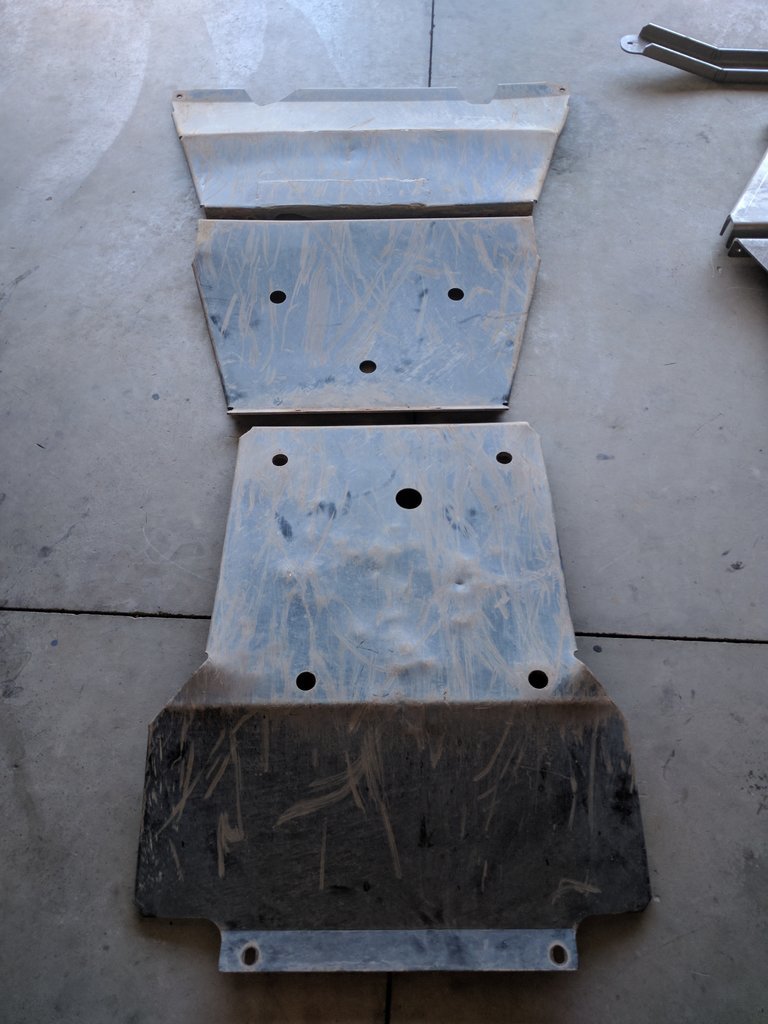

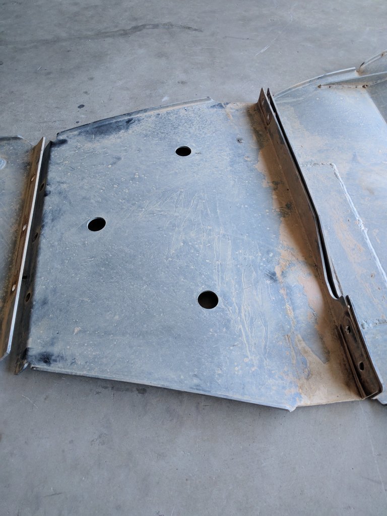

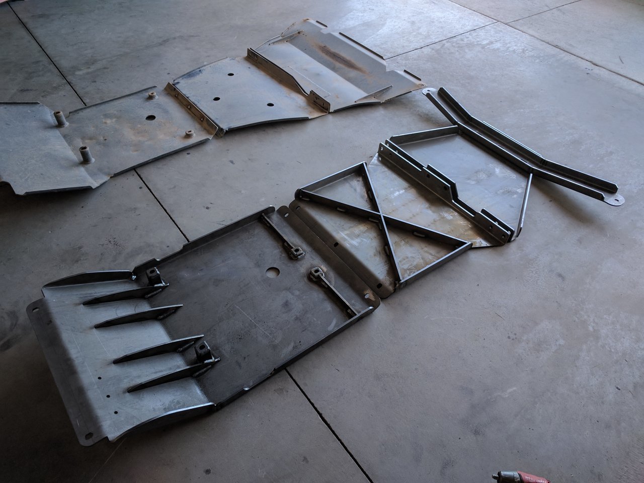

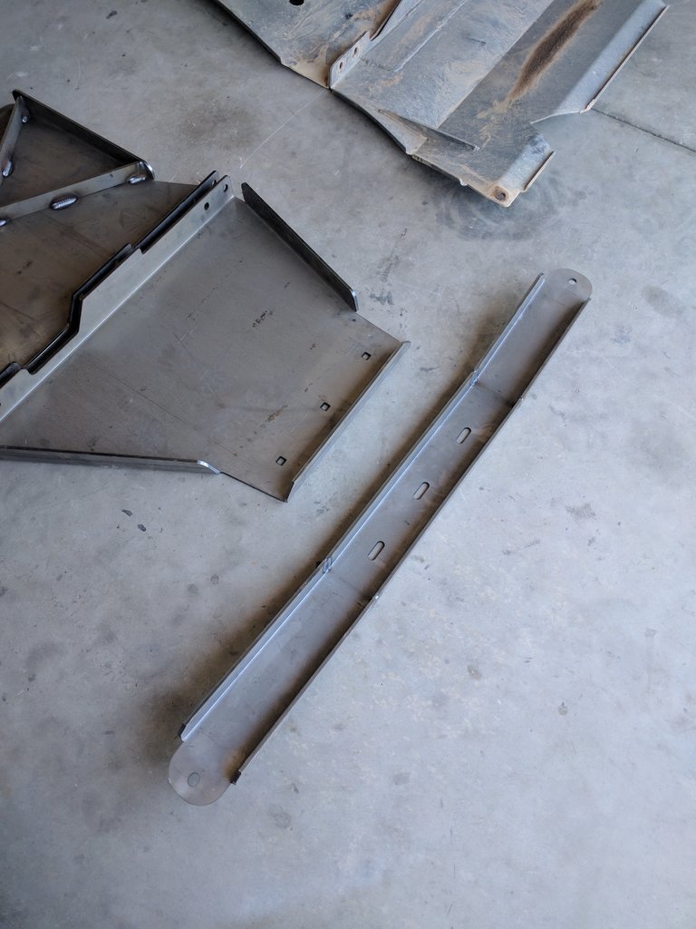

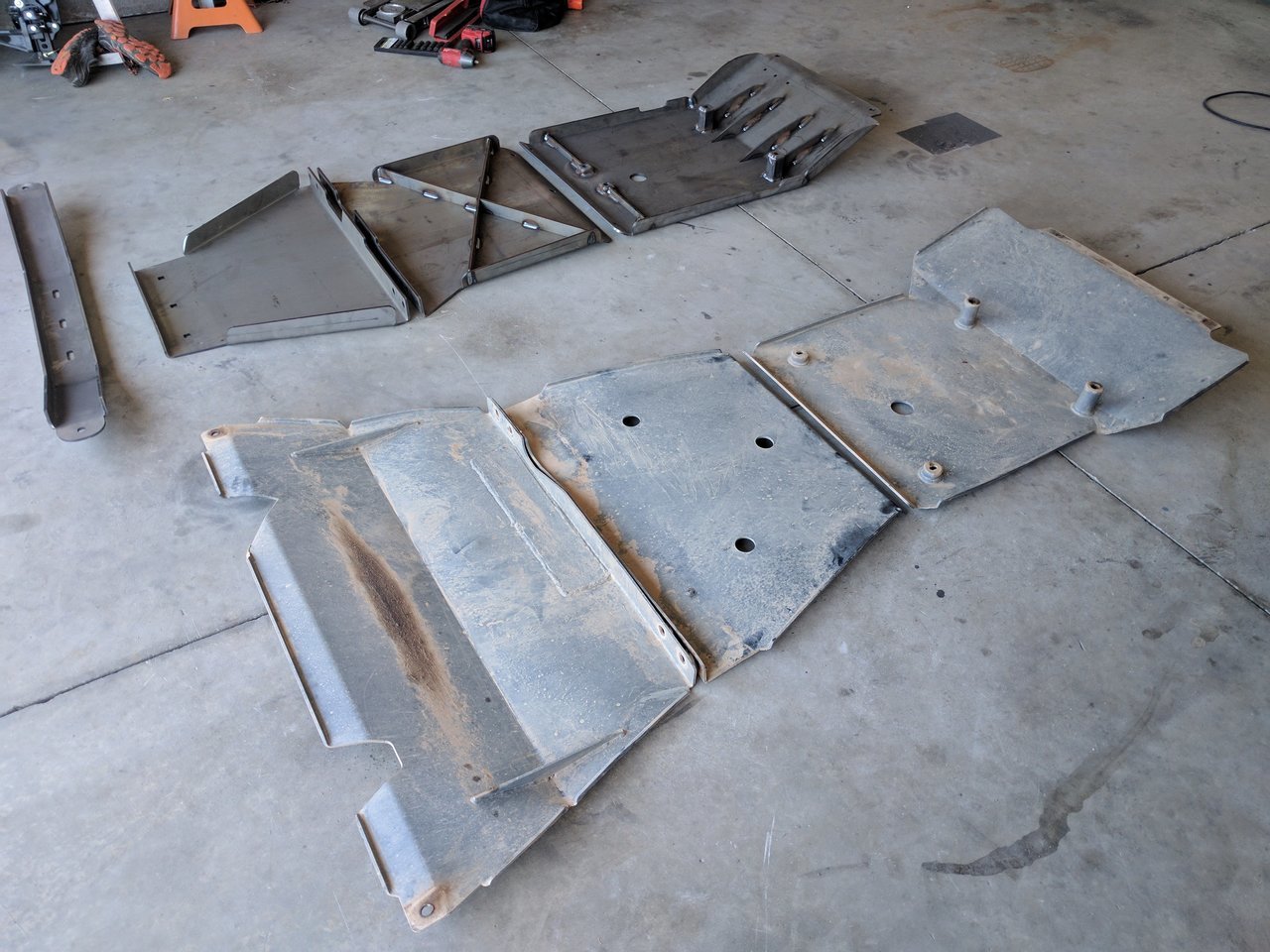

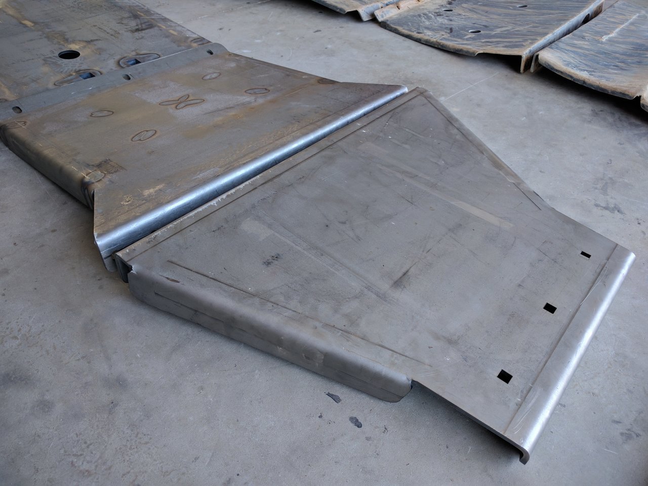

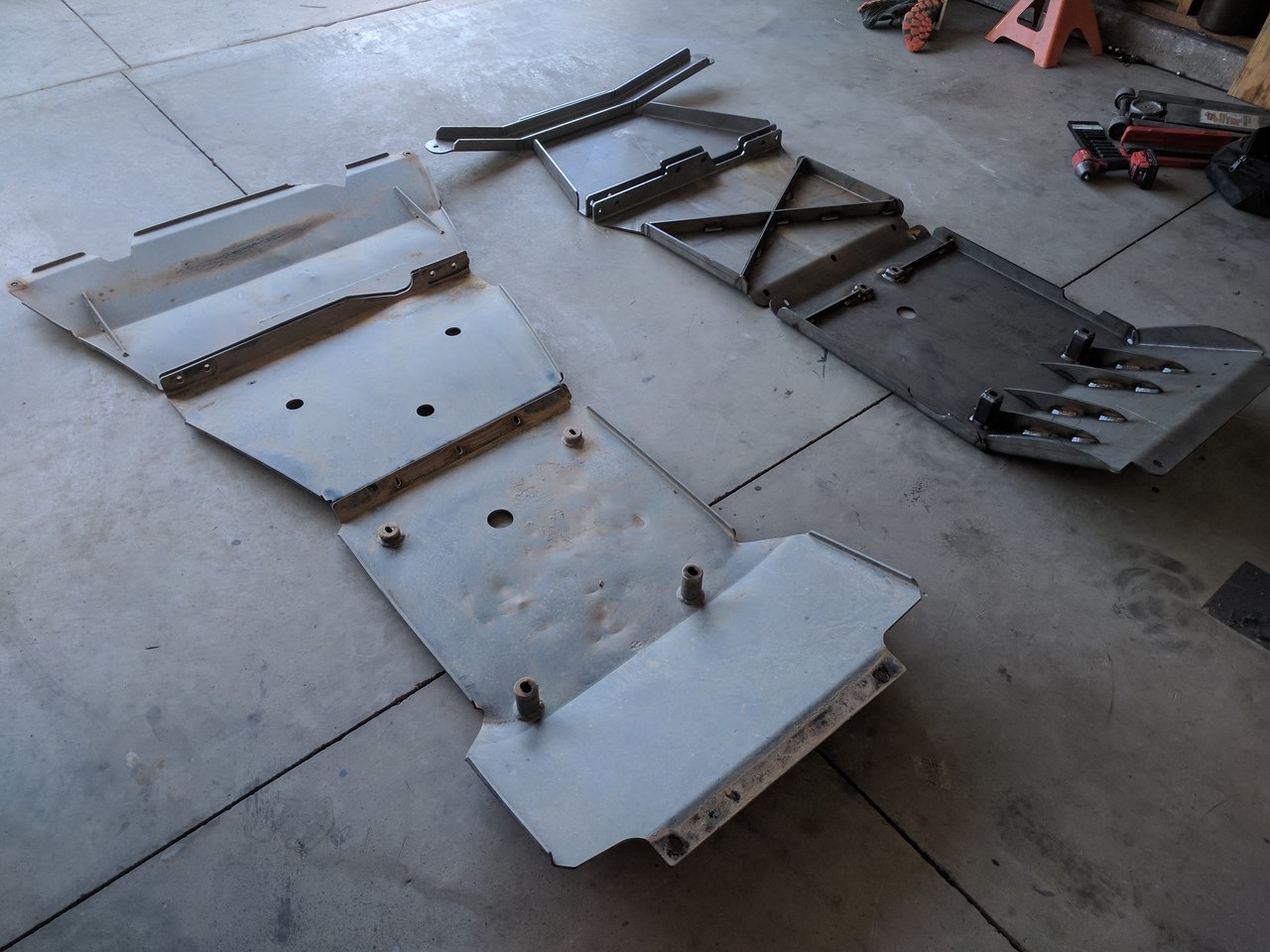

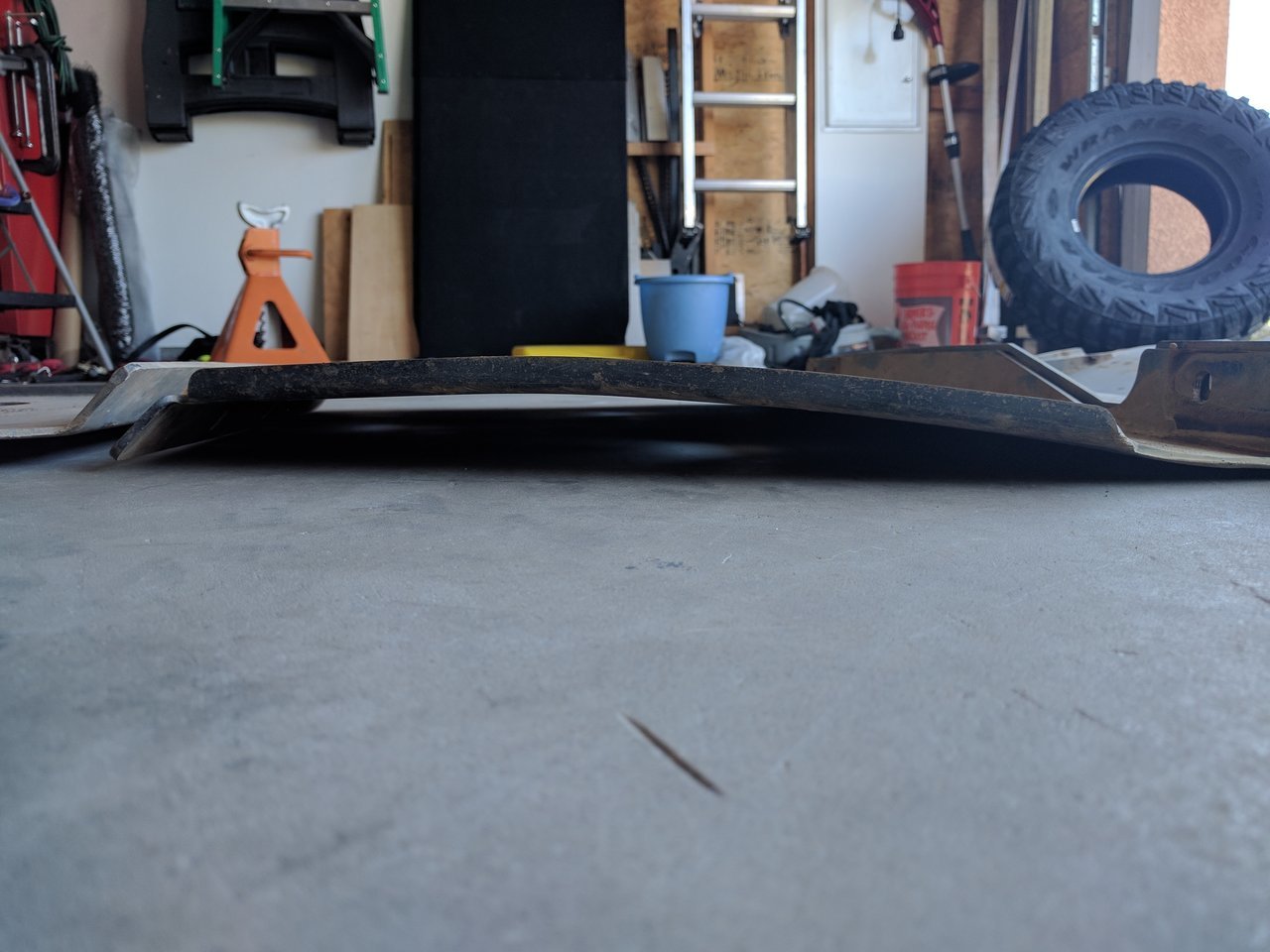

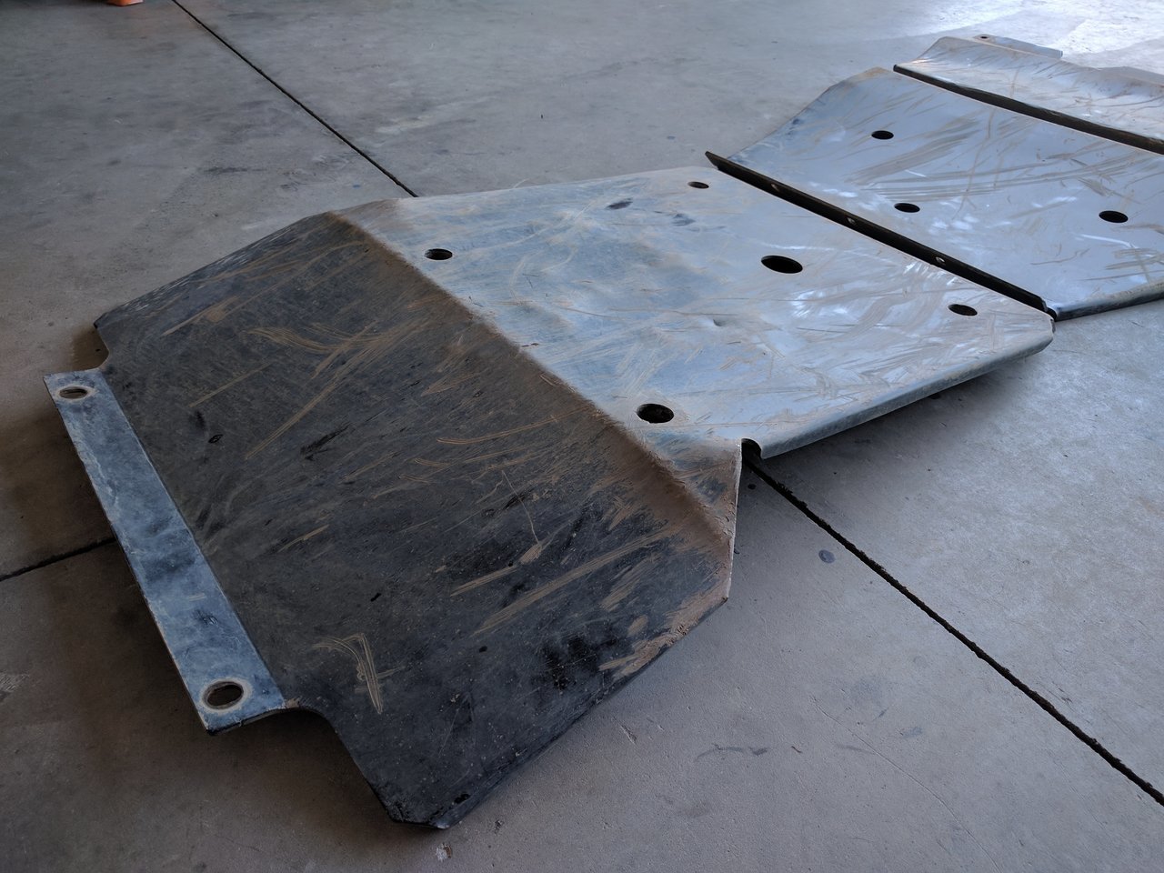

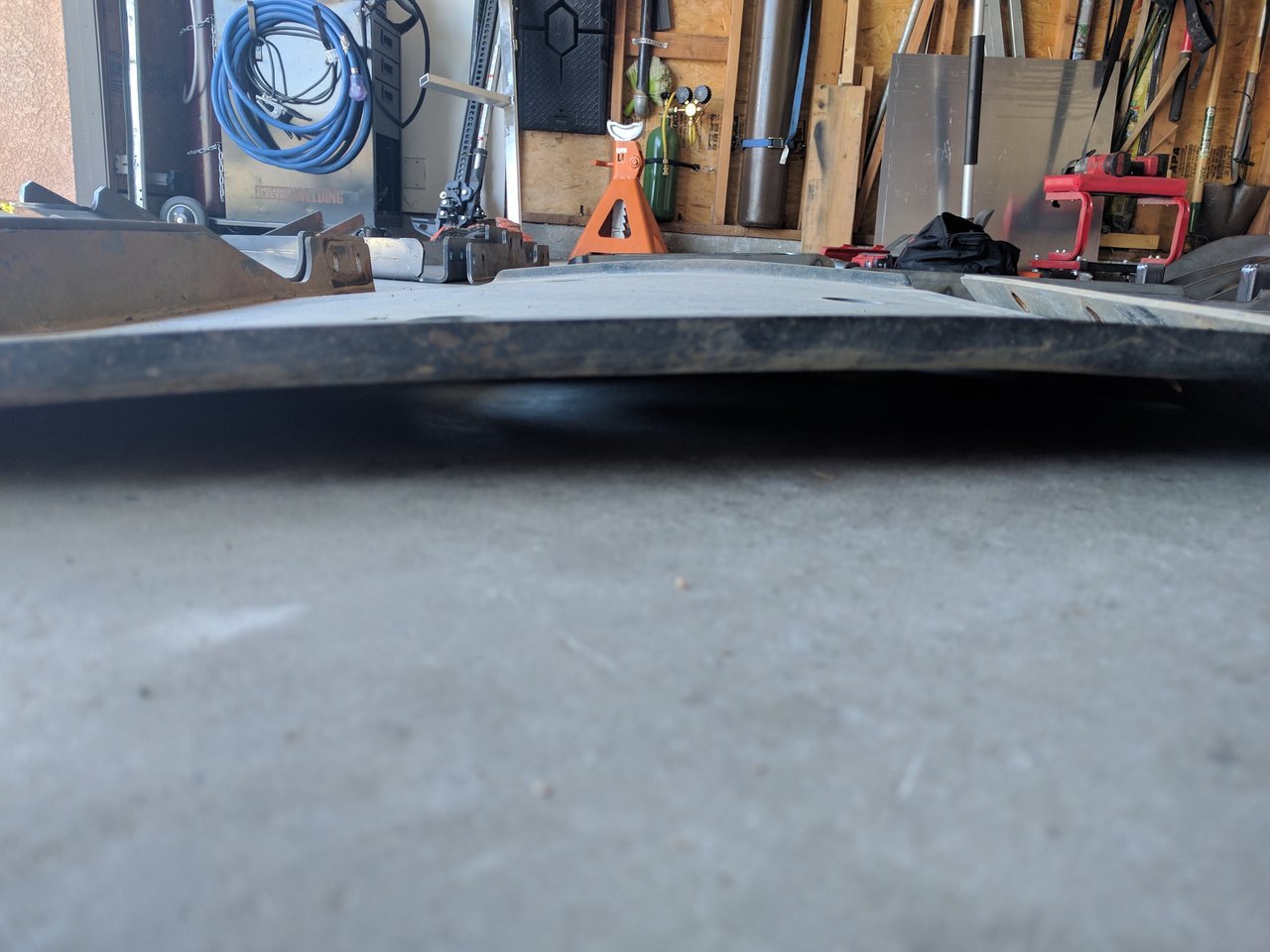

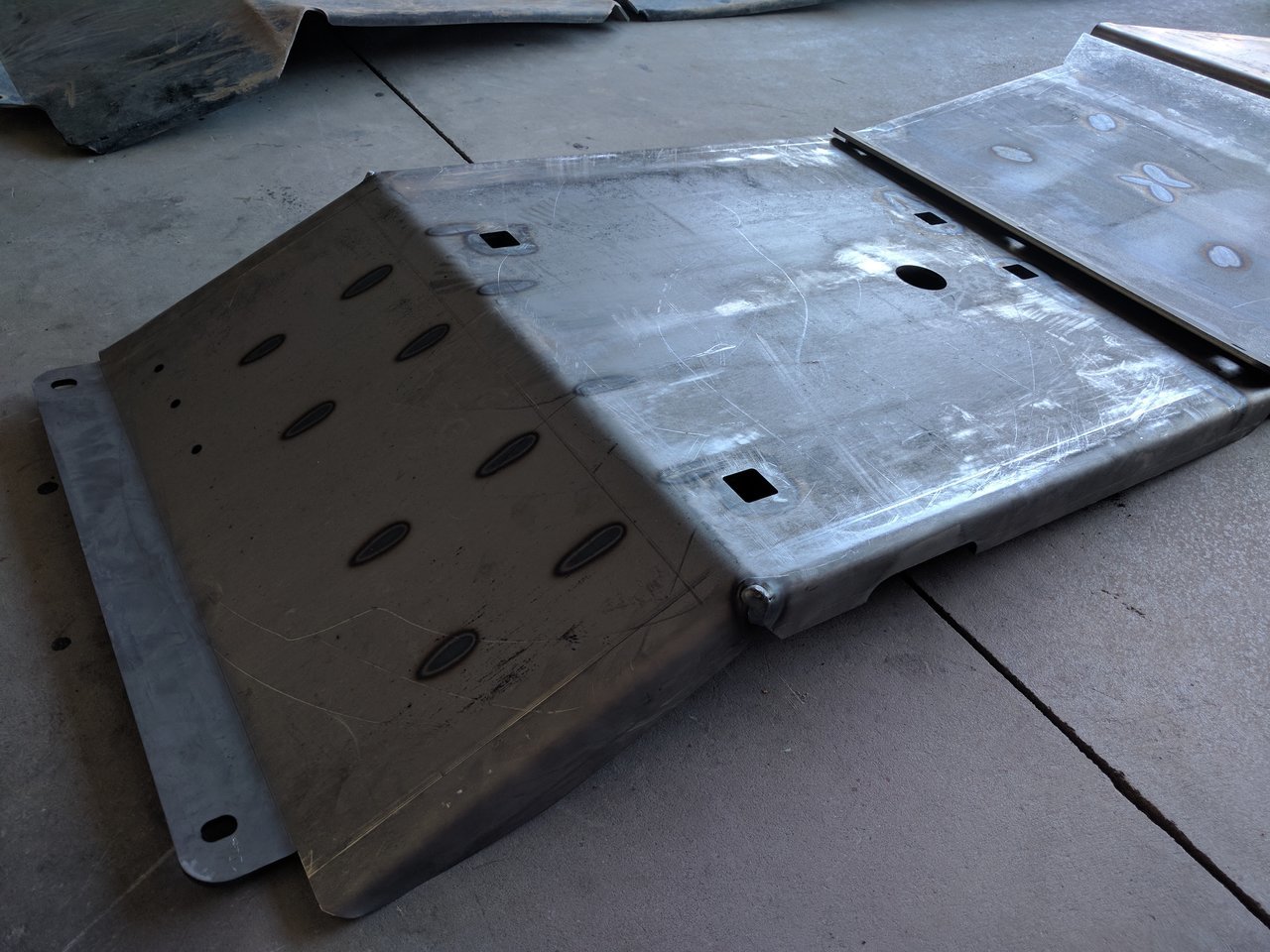

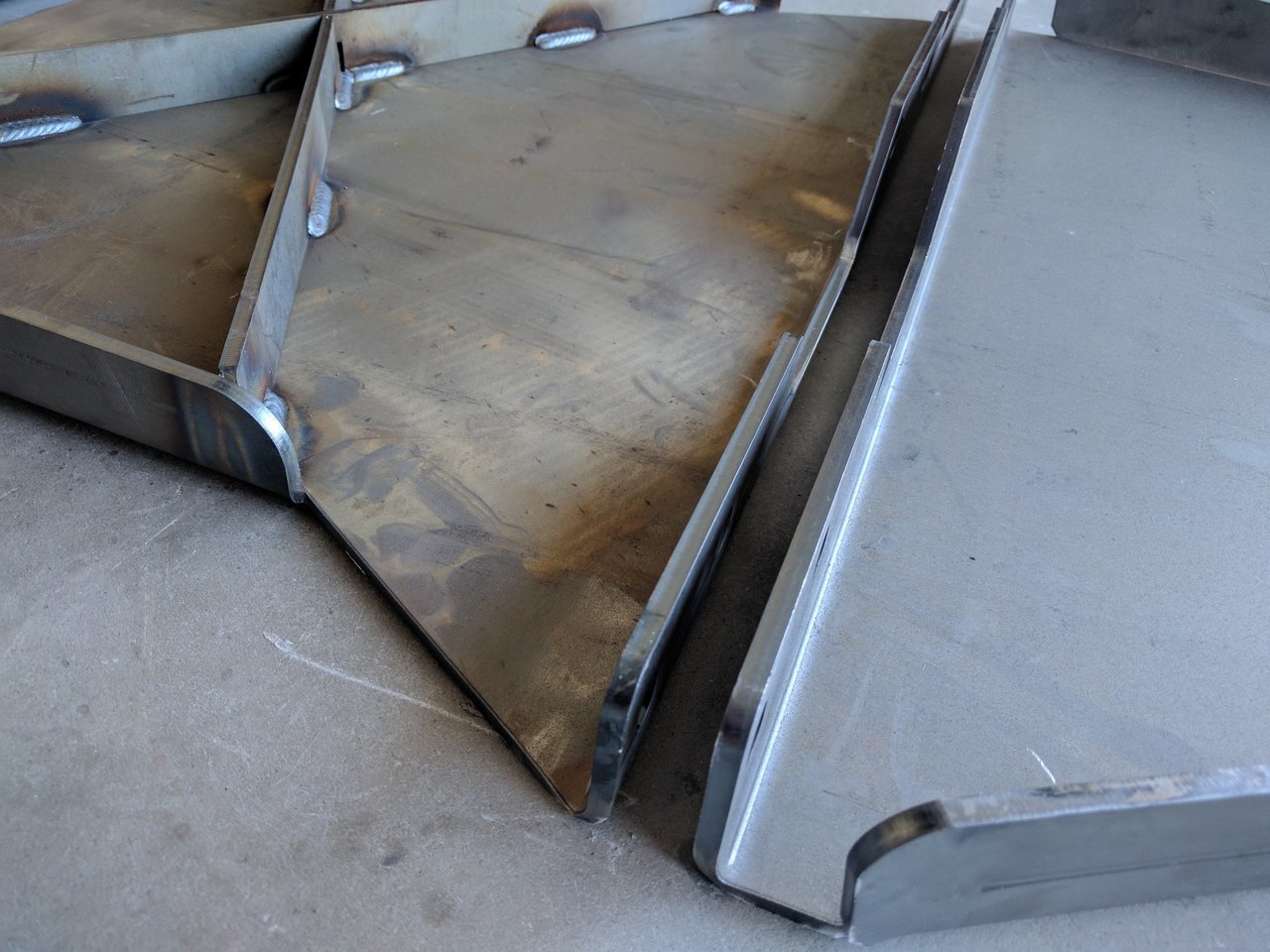

    The 3/16" skids aren't cutting it for rock crawling, they are pretty badly dented and the IFS skid has been smashed uncomfortably close to the front differential on multiple occasions. Decided to upgrade to 1/4" BAMF skids, unfortunately I missed the group buy order a couple months too early, ah well, seems to happen every other thing I buy.
    A couple of pros for each
    3/16"
    Easier to pull off and perform inspections on components hidden beyond the skid
    Less weight, IIRC when I weighed my Pelfreybilt skids the front set came to around 120lbish
    Hard use requires pulling them off and sledge hammering them back into shape
    Hard use knocks them out of shape and can make them difficult to line up the bolt holes during reassembly
    1/4"
    Heavy, BAMF says they weigh around 200lb
    Pain in the ass to remove and reinstall
    The bolts I received for the mid/transfer skid were too long, when I take them off next I'm going to replace the bolts with shorter ones
    The cross member on the mid skid gets in the way of installing the bolts, I'll grind some grooves to make it easier for reassembly
    I would imagine if you really hit these REALLY hard it could transfer the energy to the frame/crossmembers and might damage them
    May be the strongest on the market?
    Completely impractical, but aesthetically the BAMF skids look "sleeker" under the truck
    And the photos.......

    So.. what's going to happen with those old smashed up skids?
  9. Sep 3, 2017 at 5:45 AM
    #89
    tetten
    tetten [OP] Cynical Twat Waffle
    Nov 2, 2014
    #141581
    2,504
    Andy
    Socal
    Give them away when I get around to it

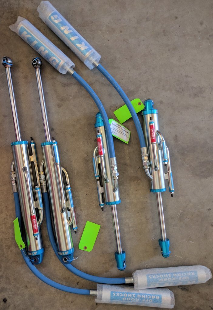

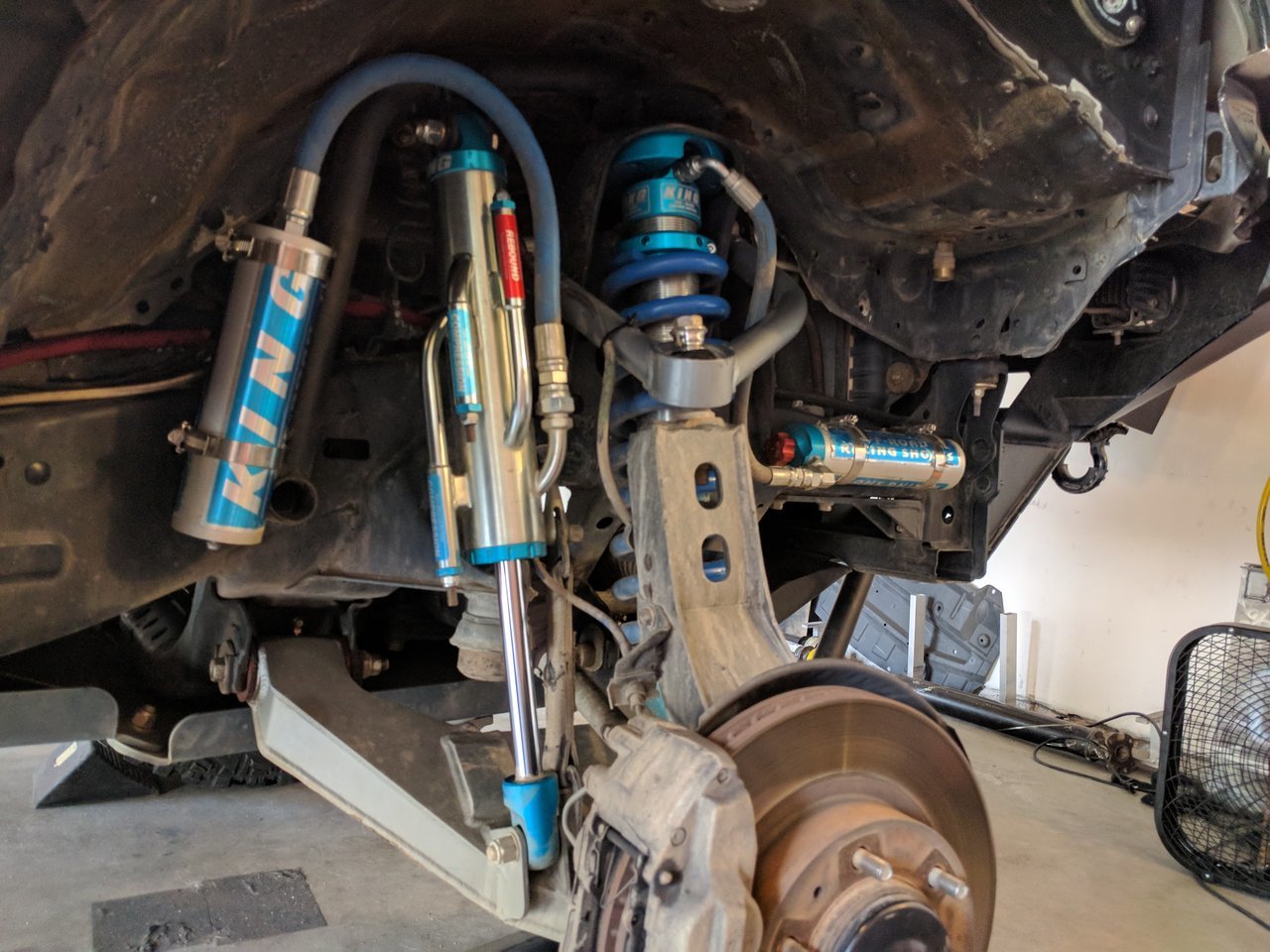

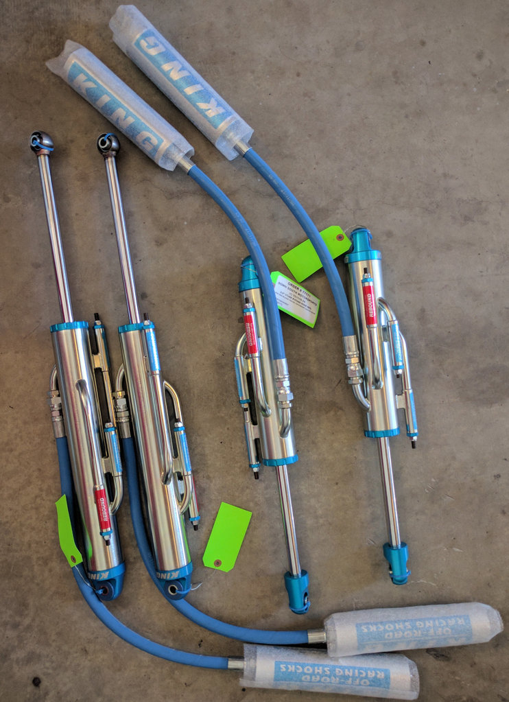

    Put this junk in a couple months ago, made the compression adjusters even more useless.
    Still have these other 2 pieces of junk to go in, hopefully next weekend.
