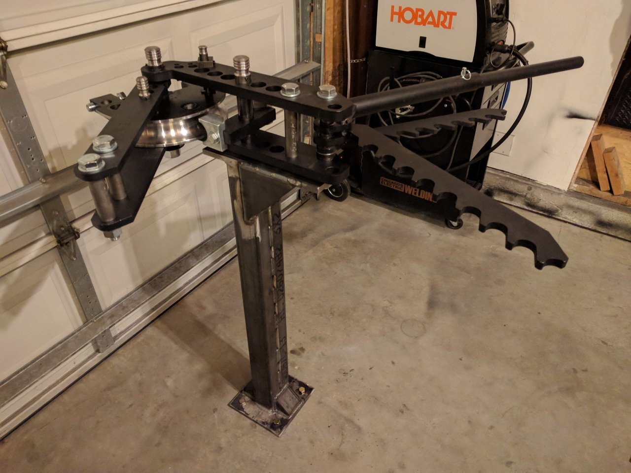

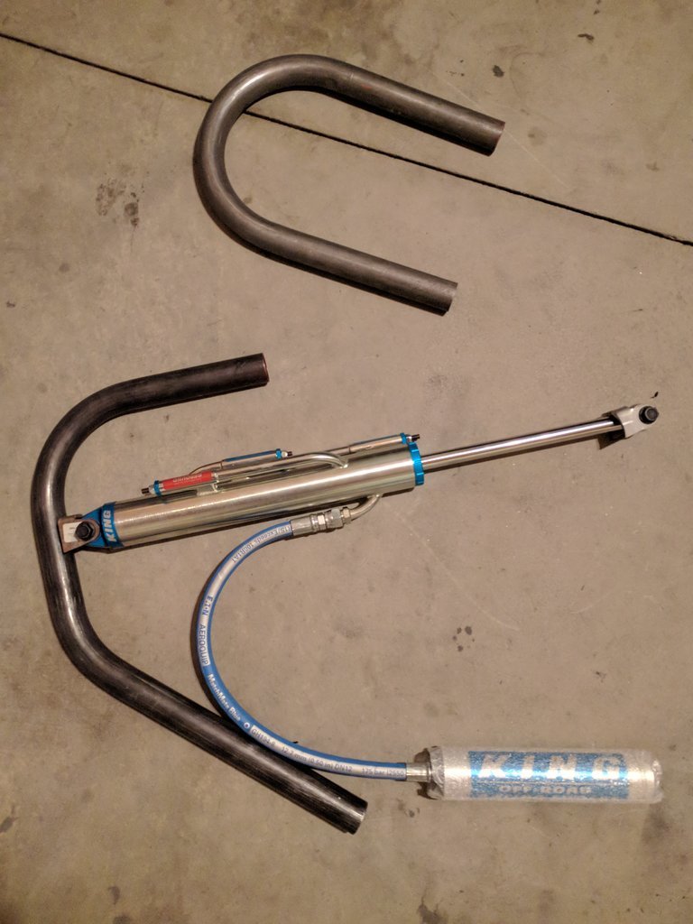

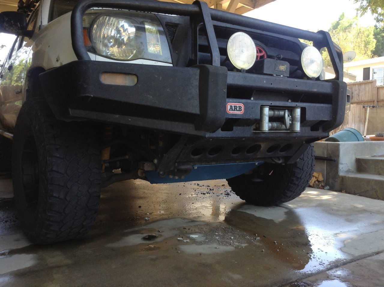

    Buddy I was hoping would be able to help me bend tubing has been too busy and flakey to help me out......so fuck it I'll do it myself. Bought a JD2 Model 32 and finally got everything up and running. Got lucky and picked up some DOM remnants that were the perfect size at IMS and started screwing around.
    I took 1 piece of 1.75" tubing and bent it over 180-ish degrees to try and see if it was possible to fit a true "hoop" style shock mount in there but even angling it in goofy ways it doesn't seem to be possible to get mounted well on the driverside, either the gas tank lines or the bump stop gets in the way. I was thinking about using 1.5" since its smaller and might squeeze in there but I don't think it would fit in that shape either.
    Next I bent up a shape similar to what @jberry813 used on his, it doesn't have the right angle welded like his, but I think I can make it work with different/less frame plating.

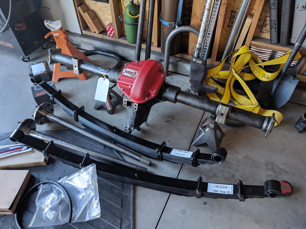

    Now just waiting on Deaver to finish my springs.......was quoted 4-5 weeks and it's going on 9 weeks....:angrygirl:

    Is that just bolted into the ground? How did you do that?

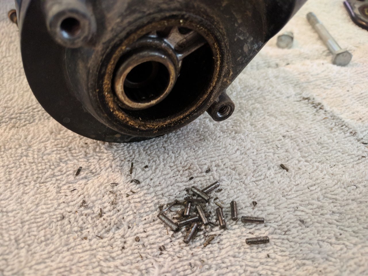

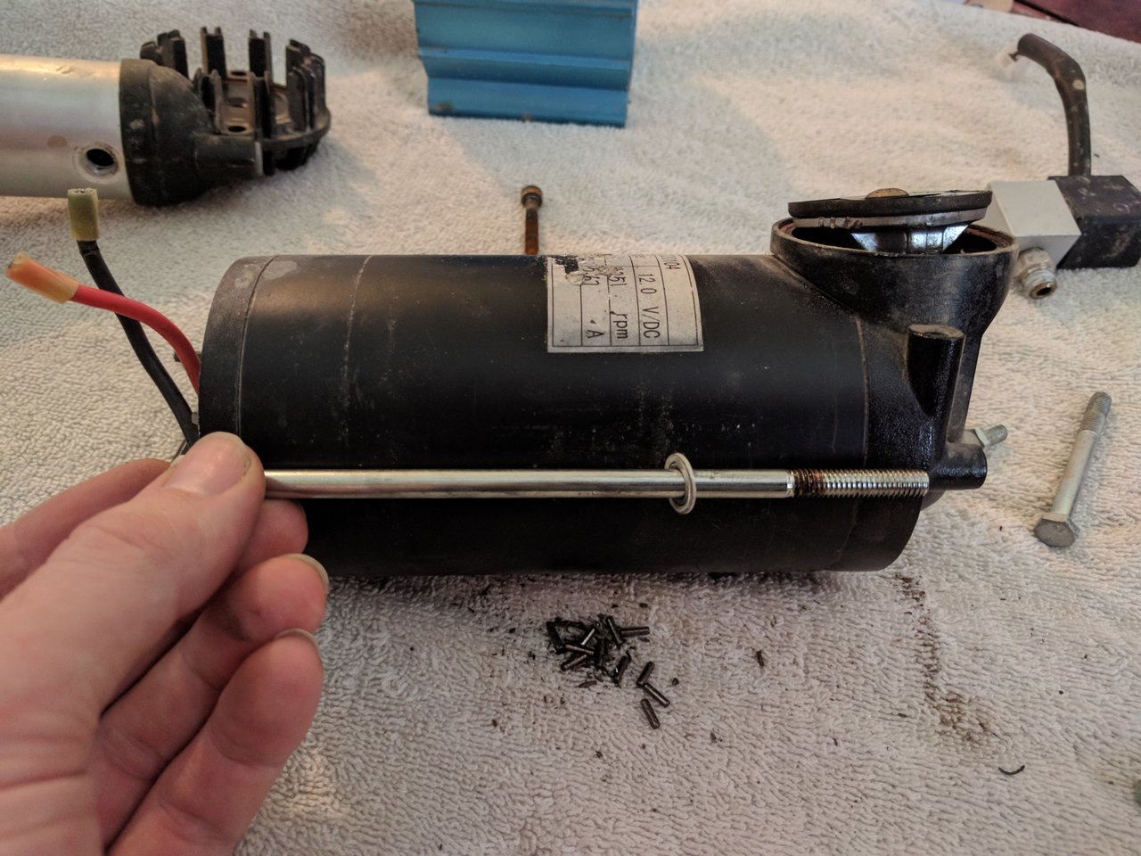

    My CKMA12 finally shit out on me.

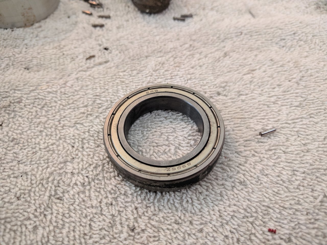

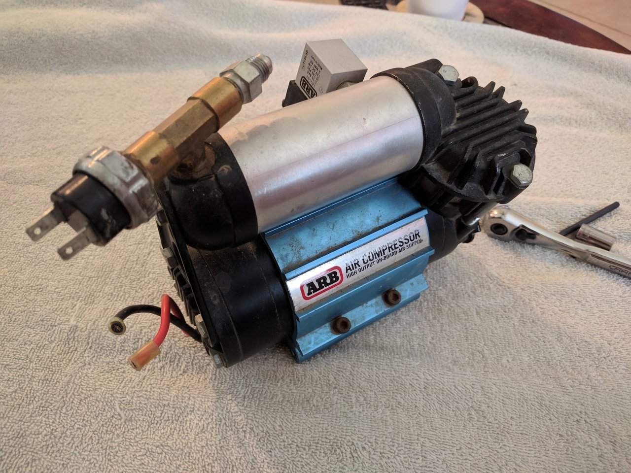

    A month or 2 ago, shortly after I installed my dual stage ARB the single stage finally shit itself. I stopped using it after it started making weird noises and have been thinking for the last 2 months that when I turned on the front locker that it was actually turning on, figured out in Calico that since the air locker is wired to the single stage compressor it wasn't actually turning on for the last 2 months, so I had to turn on the single stage to activate the locker on a couple obstacles, it still sounded like shit.

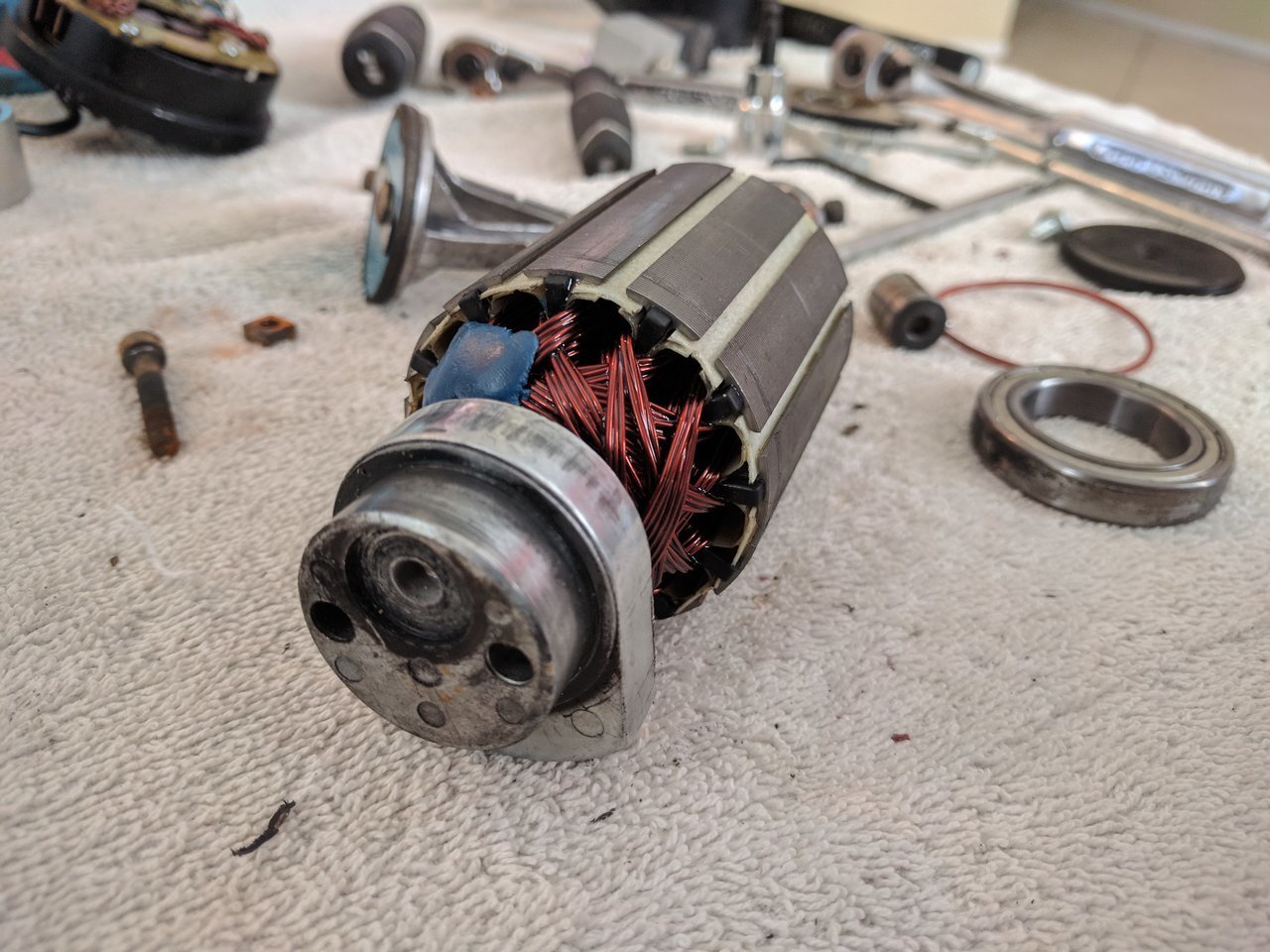

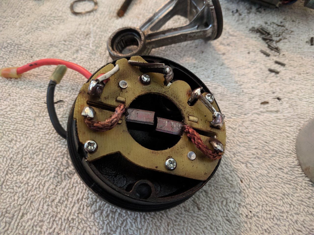

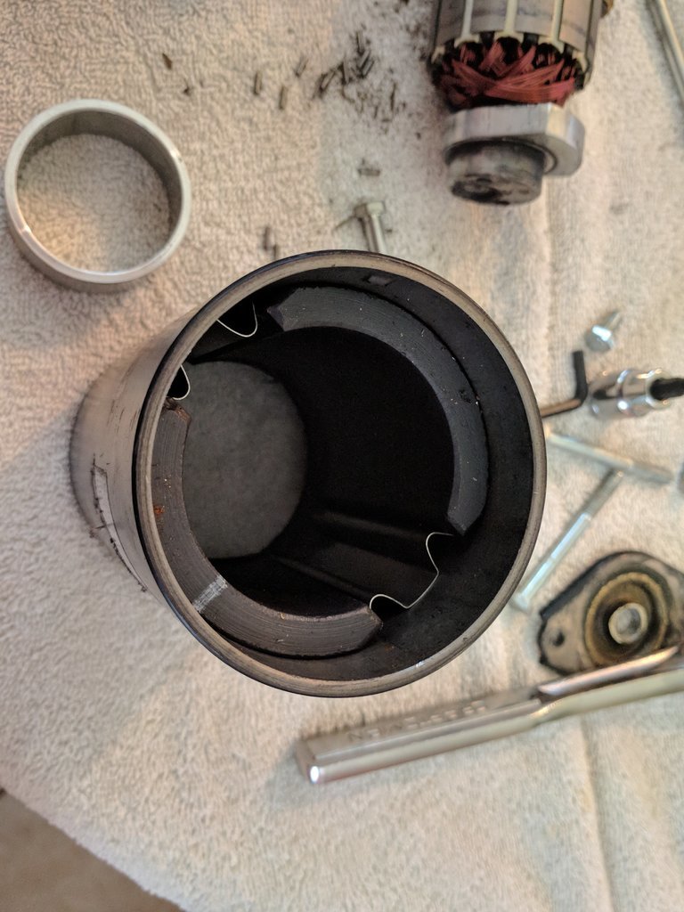

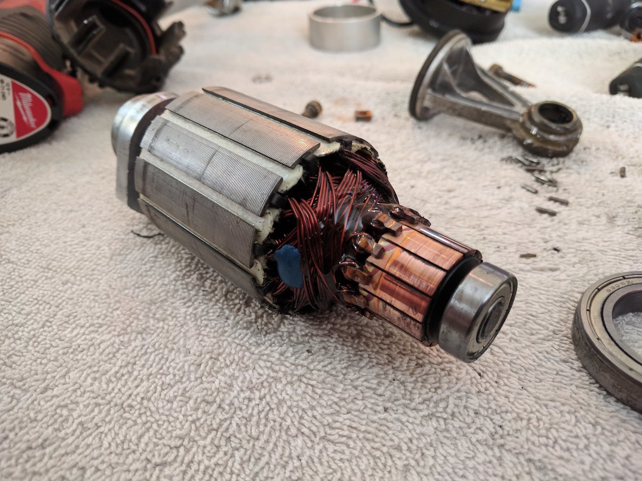

    Taking everything apart is pretty easy, only think I'm uncertain of during the reassembly is how I'm going to get the rotor back in between the brushes, looks like that's going to be a pain in the ass.
    A couple photos of the endeavor......
    Turned out the piston bearing failed and was letting the piston slap around a little which is where the noise was coming from.
    About 3-4 months ago the power plug melted out and blew the fuse, I wonder if that's when the bearing locked up and finally failed.

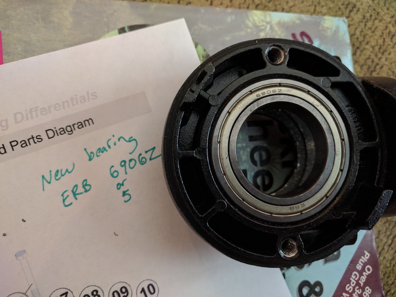

    The 6906Z bearing is also going out, it hasn't completely locked up but its grinding like a champ now.
    Finding replacement parts is a fucking shit show. No company seems to have all the parts needed, most seem to be missing at least 1 part I need. I probably should have just called up ARB and tried to order the stuff through them but I have had bad experiences with customer service and try to avoid calling if possible. I think I can get it up and running again for less than $100.

    Most likely a jberry813 style, I tried to squeeze a true "hoop" in there any way I could but it doesn't look like it's going to fit with the bolt-on hydro bump mount and gas tank fill/vent lines. I think I'll be able to use a 90 degree bend instead of a welded 90 joint though. After I cut off the shock mounts I'll see if I can squeeze a hoop in there again but not expecting to make something work.
    Going to keep the SOA to help with the heavy rear end. Also I tend to be pretty reckless when crawling or going over rocks, don't want anything more than I need hanging off the bottom of the axle.

    Never heard of them, springs and
    I've already ordered deavers, going to pick them up tomorrow and the axle. Too late to turn back :)

    So much win in this picture. I don't think you'll bend this axle.
