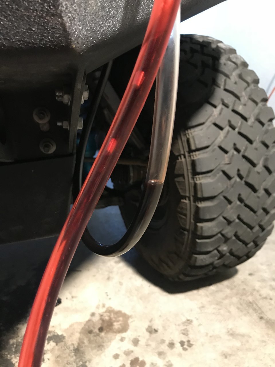

    How many miles and how did your fluid look?

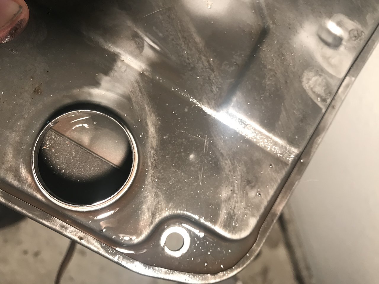

    194k LOL and the fluid was black
    1CDFCB53-BAA2-46EF-8C94-968A763D674B.jpg 51F9F33D-ABD7-48D9-A8EF-249EF7EE81B1.jpg

    Think the previous owner ever did a change on it? Or was that the first?

    He said he did but I really don’t think so! We did my buddies at around 100k and his wasn’t too bad.
    Took 14 or so quarts until the fluid coming out was fresh lol

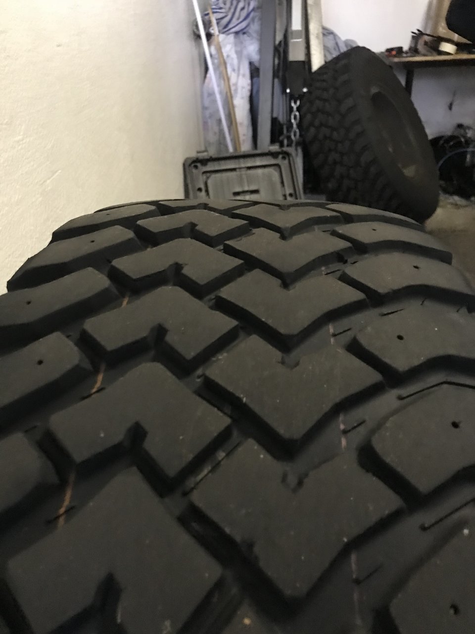

    Any chucking out of the lugs?

    Not bad at all.94A135A5-7E14-487D-B776-02E480DE1806.jpg28A54B9B-B3C9-44DE-ADCA-F5D3D5D8744B.jpg

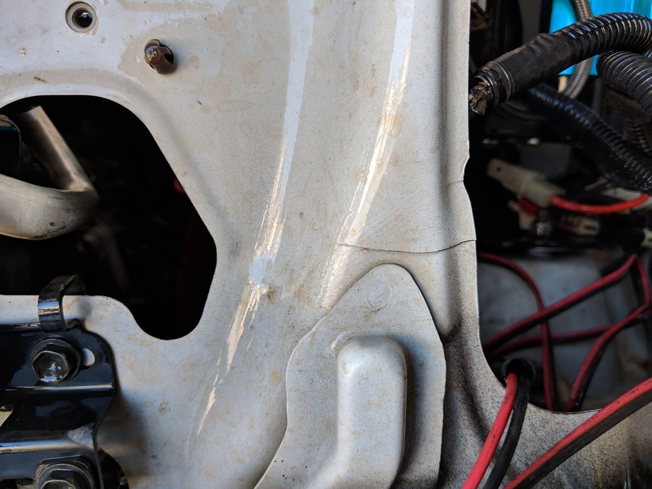

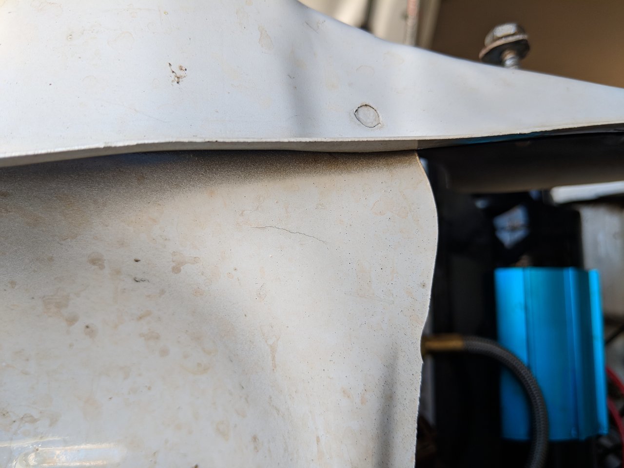

  16. Feb 8, 2018 at 2:41 PM
    #176
    tetten
    tetten [OP] Cynical Twat Waffle
    Nov 2, 2014
    #141581
    2,504
    Andy
    Socal

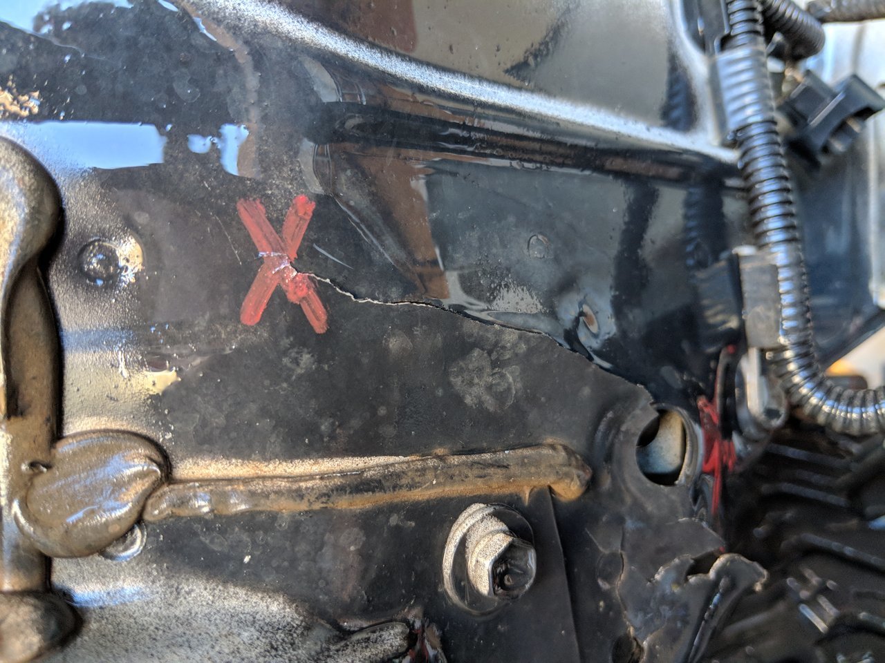

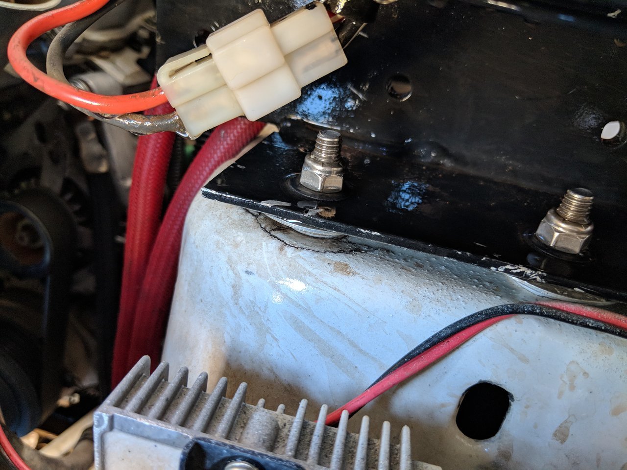

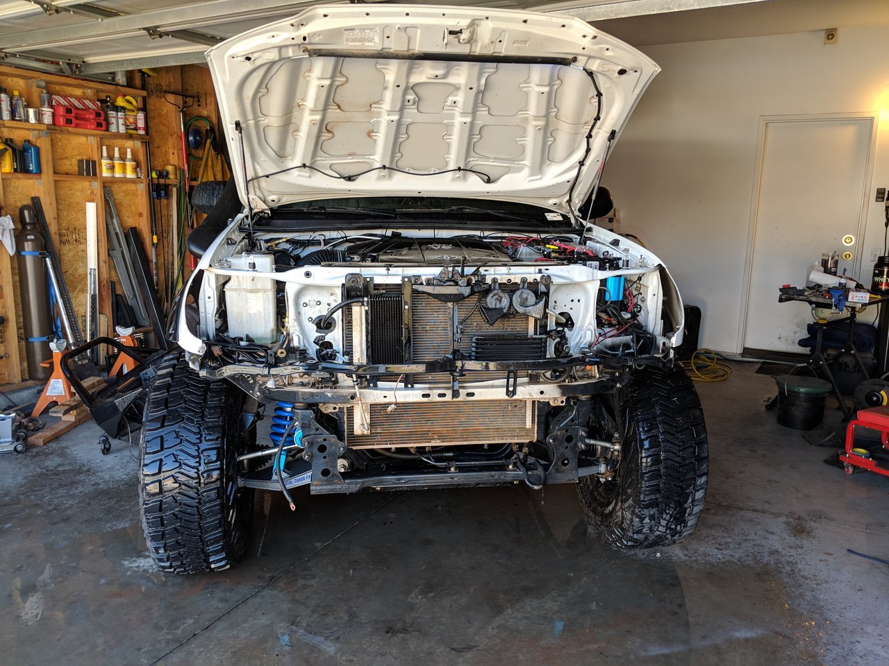

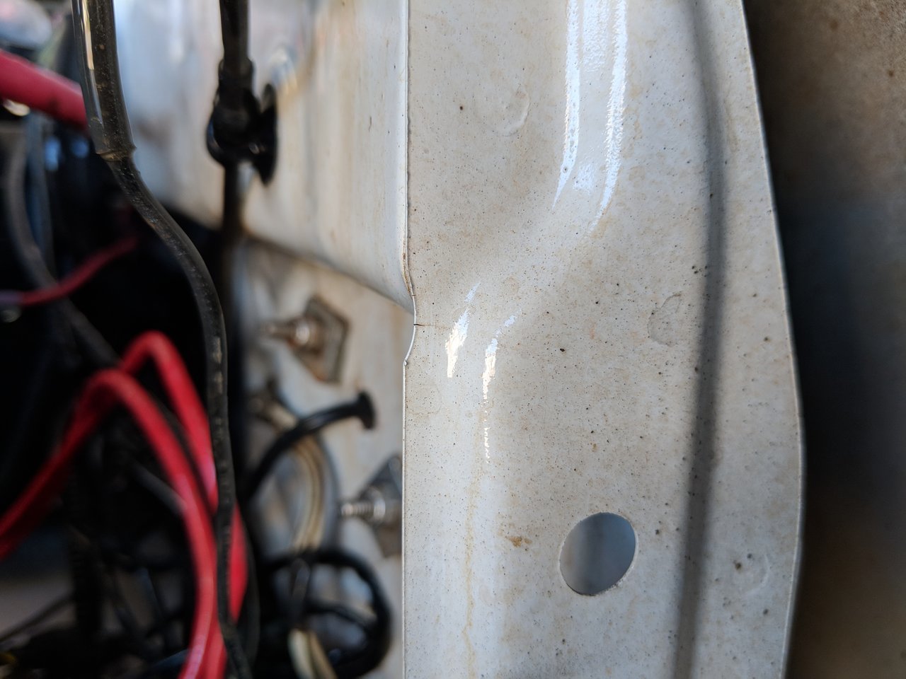

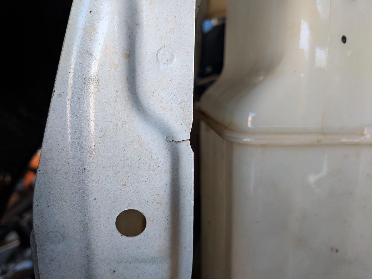

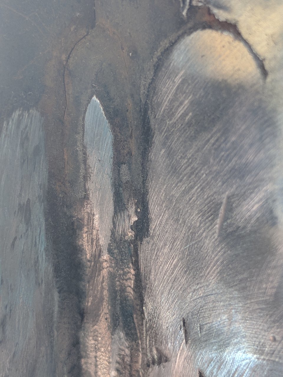

    Took the front off to check the bumper mounts. They looked like the welds on the frame were starting to crack. If they are they haven't cracked all the way through the sheet metal, so that's good news. Found several cracks starting to develop on the sheet metal in other areas. Some of them are tiny and barely noticeable.
    Main cracks continue to grow. 1 of them grew about an inch. Another jumped and started to rip at the spot welds and another looks like it's going to go from 1 to three cracks. All from a single trip to Utah.
    Also apparently I need to rethink my ARB dual compressor mounting because the damn thing is sinking into what was the battery support.
    Couple more cracks....
    SonnyBones and ChadsPride like this.

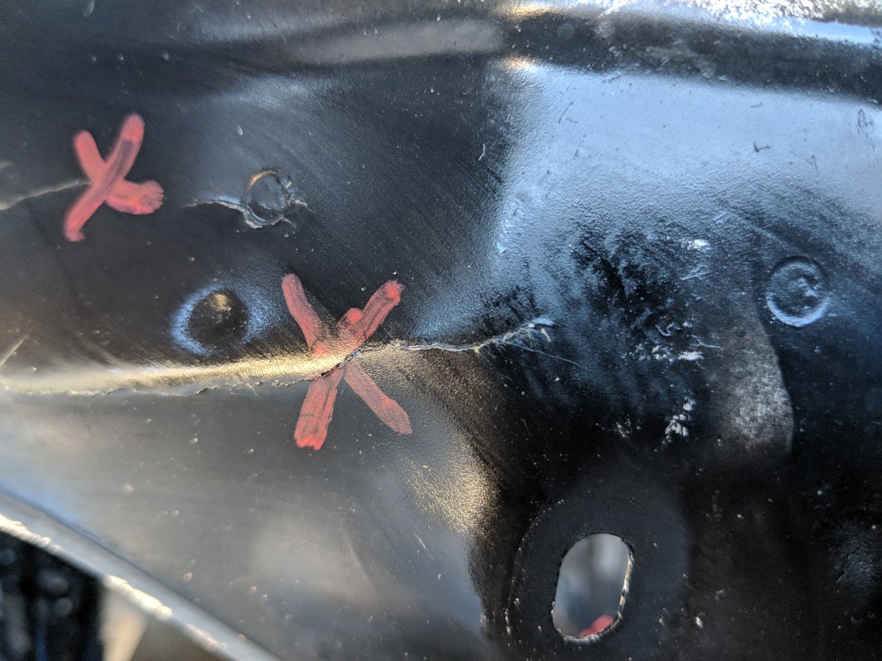

  17. Feb 8, 2018 at 3:44 PM
    #177
    Tacoma1192
    Tacoma1192 GD MOTORSPORTS
    Dec 27, 2013
    #119290
    1,457
    Kyle
    Boise, ID
    2015 DCSB Sport
    39's, LT, 4 Link, Spidertrax 9"
    Looks just like what I did to the front of my truck on Tuesday after I got back. Some of your cracks grew a TON from that trip. Are you going to create new bumper mounts to the frame before you put the bumper back on?
  18. Feb 8, 2018 at 3:46 PM
    #178
    tetten
    Nov 2, 2014
    #141581
    2,504
    Andy
    Socal
    Yeah, I might as well since it's all disassembled. I'll put some 1/4 plate in for the bumper mounts and tie it back along the frame similar to how @MonkeyProof did his.

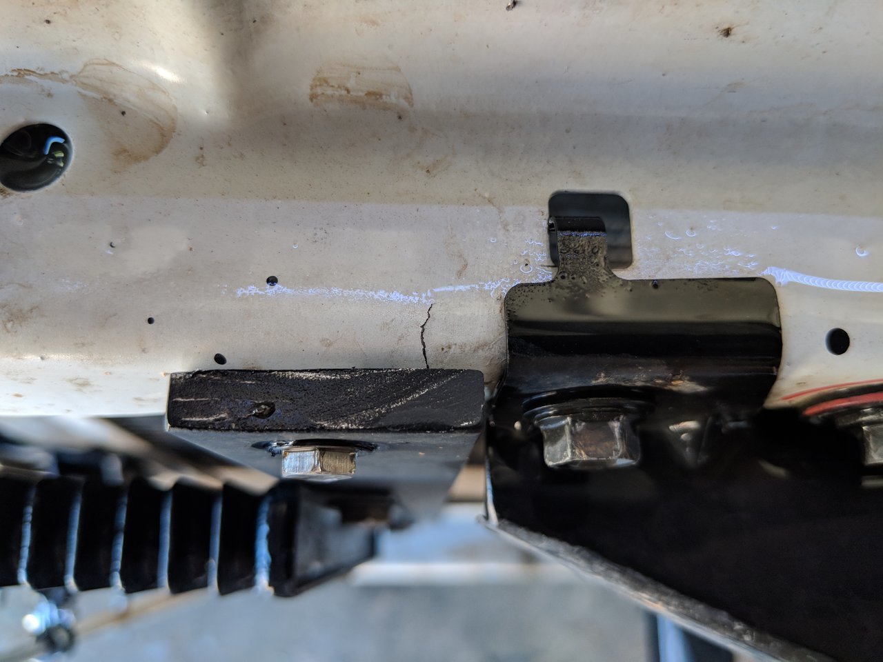

  19. Feb 9, 2018 at 12:01 PM
    #179
    tetten
    Nov 2, 2014
    #141581
    2,504
    Andy
    Socal

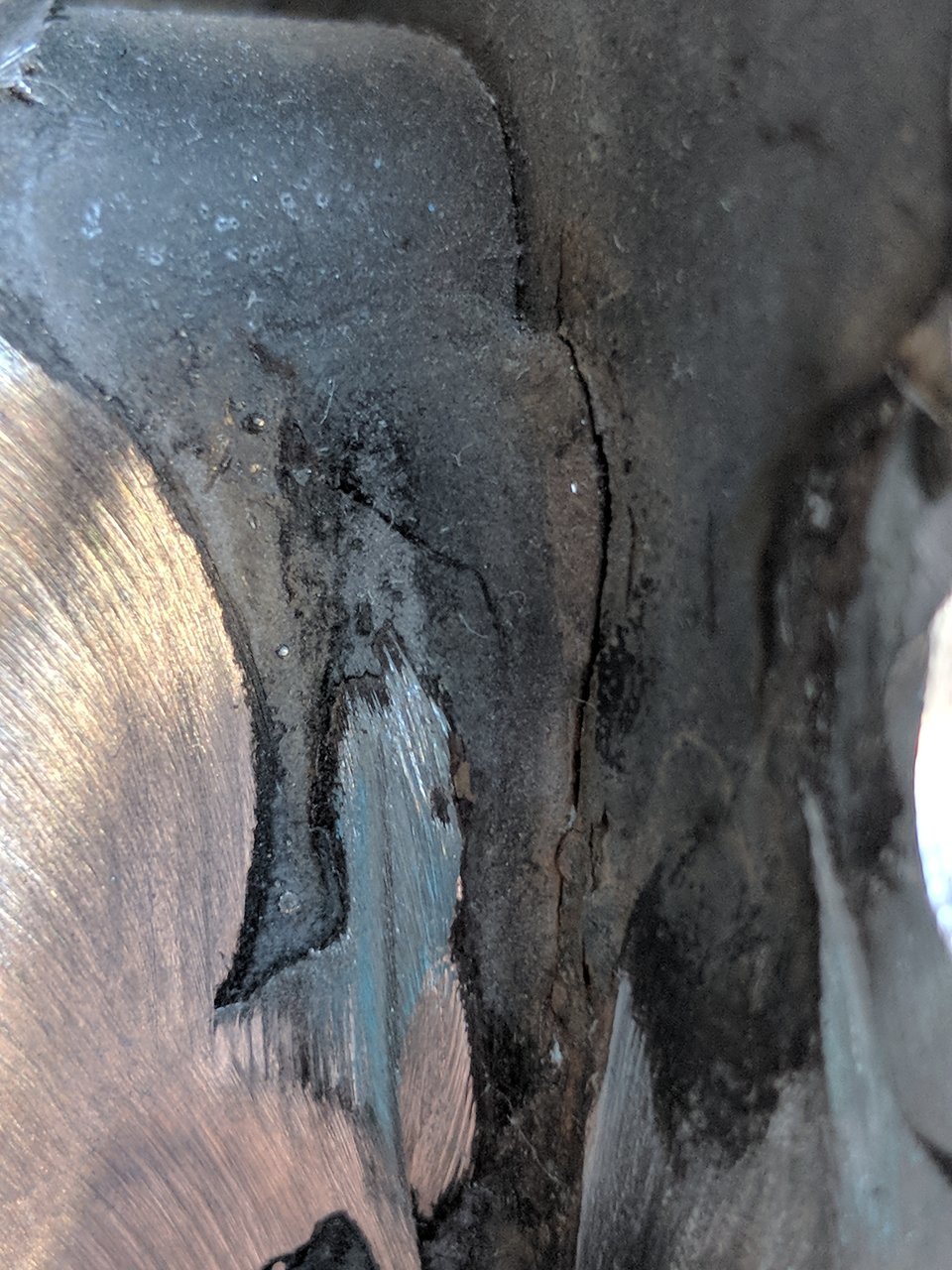

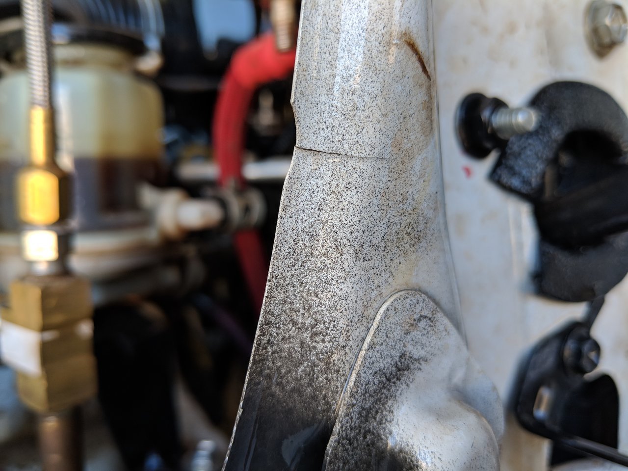

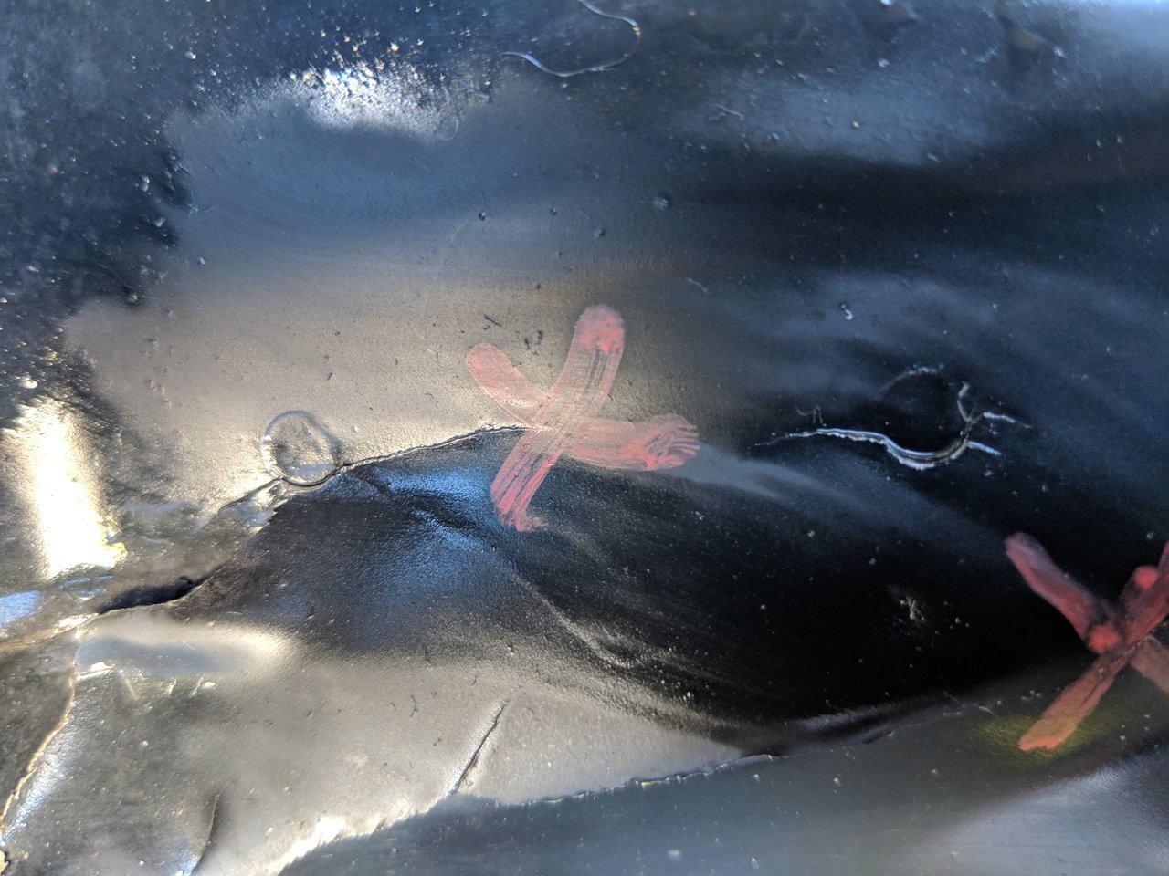

    Turns out I was right about the bumper mounts cracking. They are cracked, I just caught it before they got really bad.
    Tacoma1192 and ChadsPride like this.
  20. Feb 9, 2018 at 12:02 PM
    #180
    Crom
    Crom Super-Deluxe Member
    Jun 22, 2009
    #18782
    9,619
    Nick
    San Diego, CA
    2009 4x4 DCSB Camp Supreme
    Millions
    Too bad about the core support. :( All too common problem on our trucks.
