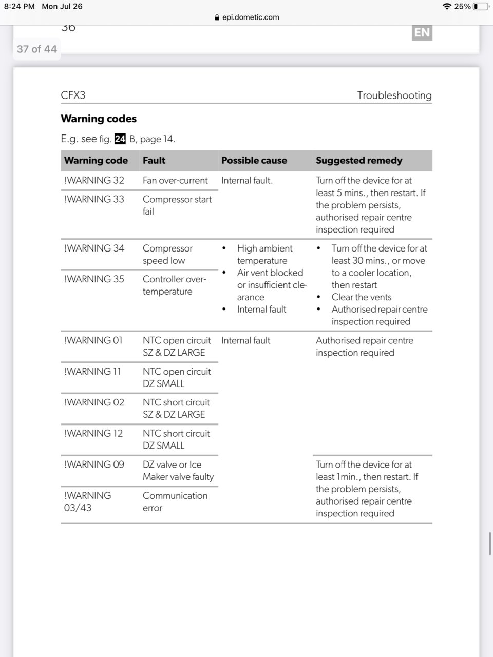

    had the CFX3 55IM running for about an hour now off my DC cig blue sea panel and already got !WARNING 32 Does anyone know what this code is?
    Thanks in advance.

    @Dometic is Error code !WARNING 32 something i might be doing wrong, is it a faulty board in the unit, any insight as to why I would get this error out of a brand new unit is greatly appreciated. Thanks so much

  18. Jul 27, 2021 at 12:52 PM

    Hi - do you have plenty of space around your cooler? If the fan is having a hard time flowing air it will be working too hard and can go into this error condition. Even if it doesn't you still want a buffer around your cooler so it can flow air as well as heat away from the cooler.

    Thank you so very much for the reply! I had about 3" around the fridge. It seems to blow the hot air out to the right if you are looking at the control screen on the fridge. I had it on the right hand side of my truck bed, roughly 3" away from the bedside. Ive moved it to the Left side about the same distance away from the bedside and it hasnt given me the code again, been running it off AC to test it out for the next few days. Cheers and thank you again for the quick response! appreciate it
