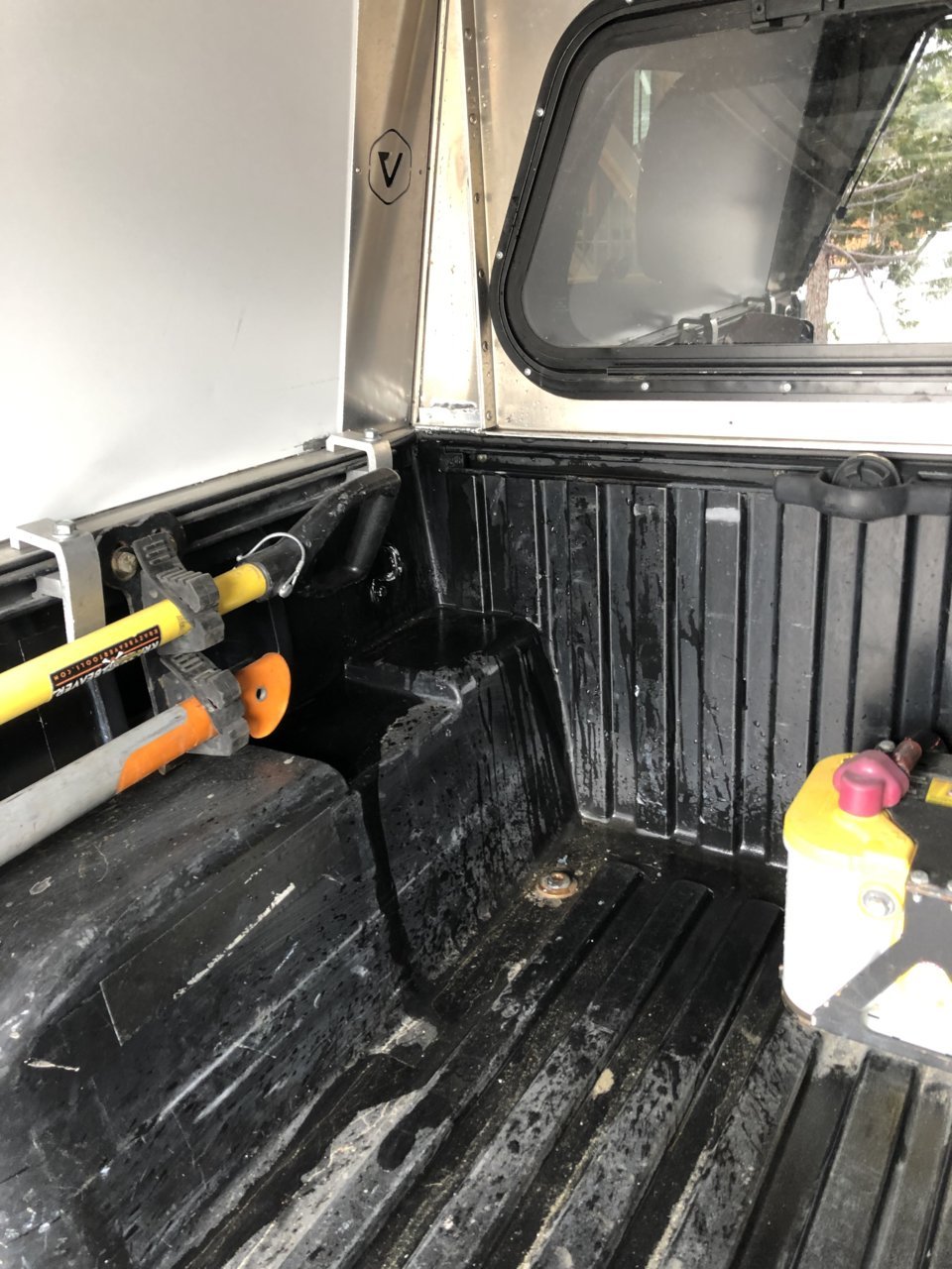

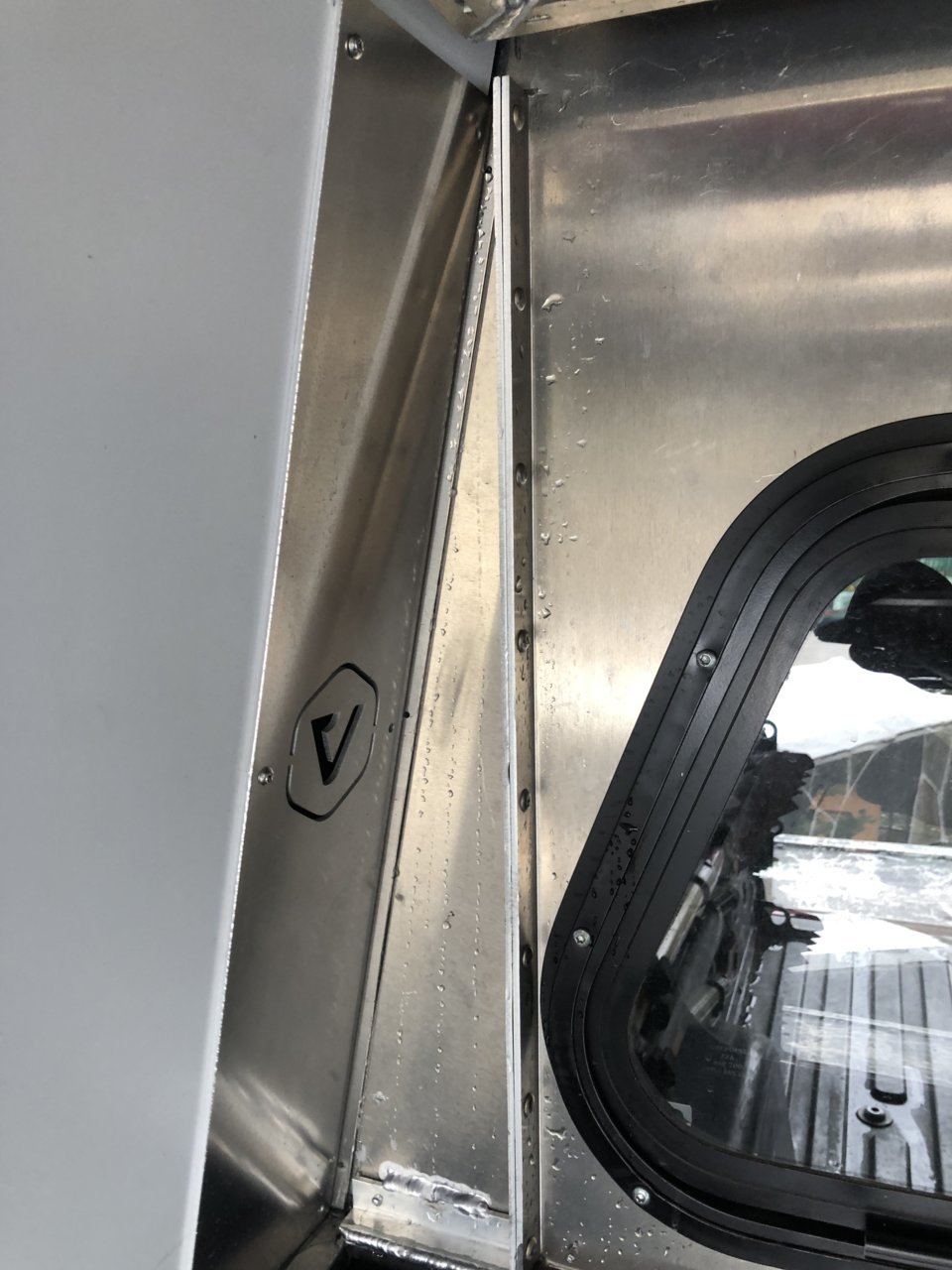

    We had a fucking monsoon hit this morning. I dunno what happened to Zero, but it’s leaking from somewhere up top. Bedding is soaked on the driver’s side and leaked all down into the bed. Anyone else have this problem or do you think it was from the rollover?

    Zero has “zero” adhesive/ sealant. We just used foam camper tape so we can take it apart... for science.
    Every production unit has copious amounts of polyurethane sealant.
    That’s what we get for relying on mechanical methods of sealing...
    Another issue could be the prototype tent. Without going into too much detail, it has changed since that original tent.
    And the method I used, to personally installed the bulb seal for the lid, was not the best. It was solo while the tent/ roof was already installed. Aside from Zero, we always install bulb seal before the lid goes on the camper.
    Basically, every potential point of failure is a possibility with Zero. But others (@danneskjold , @Tacodust have braved torrential east coast downpours in Zero without issue.
    Lastly, this could be the issue....
    Post rollover pics:

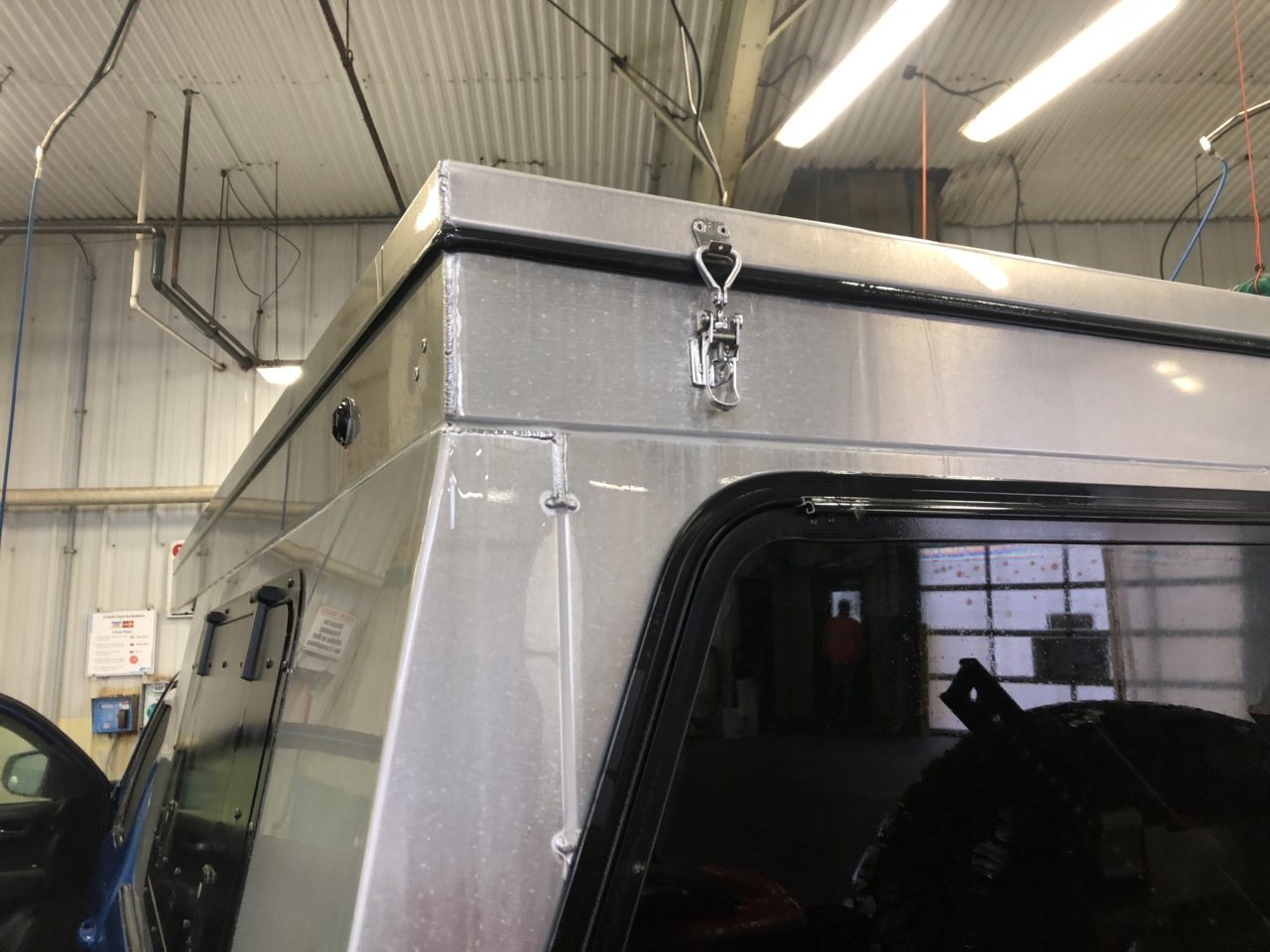

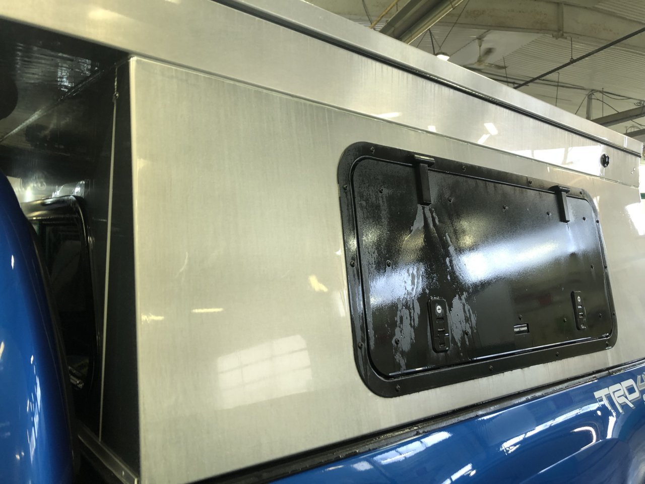

    Not sure if anyone remembers how badly tarnished my drifter was being up here in Canada and the lovely salty winters.
    I used star brite aluminum cleaner and their application brush and I am shocked at how well it cleaned the alum with one application. I’ll probably do this another 2-3 times and put a bit more elbow grease i to removing the tarnish, but i am Pleasantly surprised!
    I’m polishing it here later to help protect it from tarnishing further. Sadly by hand couldnt bring myself to buy a polisher, i’ll see if I can find thr attachements for a grinder. I’ll update with pics from phase 1 of restoring the shine to the drifter. One or two more cleanings with the alum cleaner should bring it back to perfect.
    Now to find a place with bulk potable water to dewinterize my water tank and start reworking the electrical wiring. Going to be a busy cplof weekends. Prepping for two permanently mounted 100w solar panels, and a 100amp lithim battery. Was going to have it charge off the truck but screw that, I am tired of messing with electrical systems and sorting out bugs. I figure 2 100w renogy solar panels with a third collapsible one I can plugin should be more then sufficient to keep the battery charged even if I am Away for work!

    I hope that before my drifter is finished Vagabond offers a clear coat. Otherwise Im going to have to pay a local shop to spray it. They wouldn't be able to spray the parts above the roof and behind the cab without removing it though.
    What are you going to treat it with after the polish to keep it from tarnishing again?

    Using star brites alum Polisher right now. Fyi get a electric buffing wheel. This is not like normal wax, extremely difficult to buff/remove the haze. It looks okay, not as brilliant as it was without the polish on. I mainly just wanted it on so it wouldn’t start to oxidize immediately. It still looks a million times better then it did.
    My plan is to clean it once again with the cleaner, then hit it up with the polish/buff using an electric polisher. I may go as far as to sand it and keep working my way down finer grits. That will end up mirror polished though, shich I am Not sure about doing. Then I’ll seal it with clear coat or soemthing. If i go that route I’ll be taking the drifter completely off and having a shop do it and either paint it or clear coat maybe a wrap.
    Anyone getting one of these get the powder coating its pretty much a must in northern climates.
