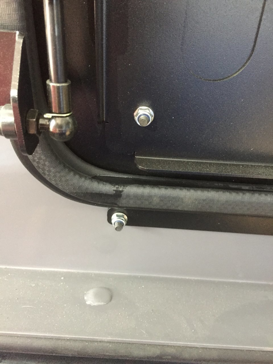

    I am wounding if anyone else has been having this problem... my drifter front runner hatch is leaking and the window near the cab :(
    I am not leaking were the drifter meats the bed rails

    There is a lot more form this last storm....did not think the front runner would leak :(

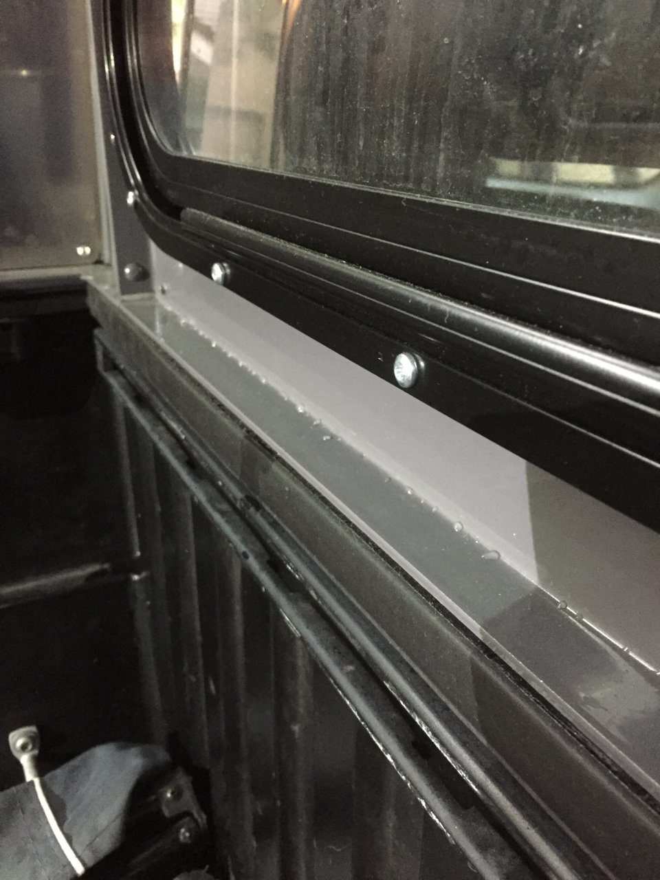

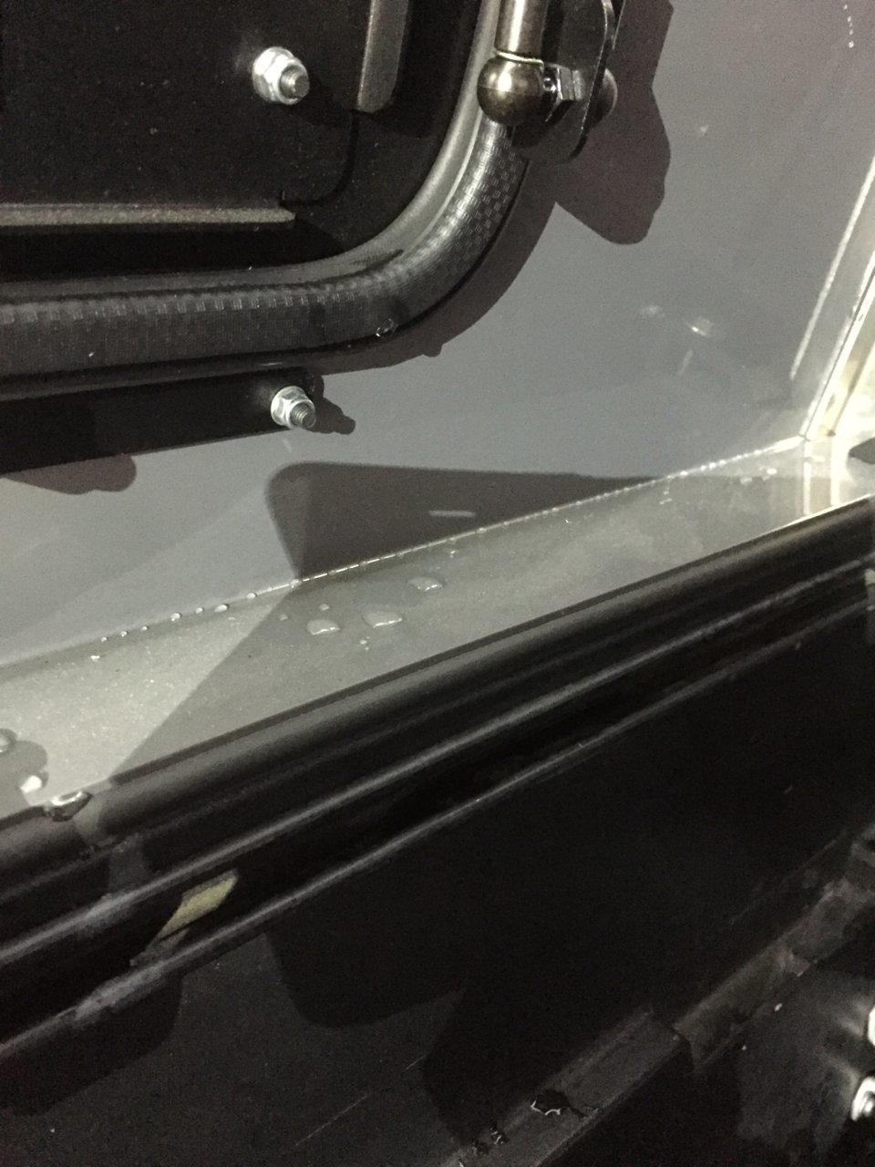

    Here’s a couple more pics

    I've had the front slider leak, but only ever noticed it after a long highway drive through a snow storm, so my theory is that snow and ice were accumulating in the cavity of the sliding section and then slowly leaking in through the small gaps in the weatherstripping at the corners of the slider.
    I haven't noticed any beyond that (except for back at the top corners of the tailgate where there's obvious gaps), but I also don't go looking for them...

    Is the seam on the weatherstripping centered on the upside of the flange or on the downside of the flange?

    I also had some issues with the front drop down window. I was parked so the wind perfectly aligned with the gap between the cab and Drifter. Said wind was fairly stiff too. I ripped out the weatherstripping that was there and installed slightly thicker bulb seal. Haven’t had any issues since.
    I haven’t had a lick of problems with the side (solid, non frontrunner) windoors. They seal snug.
