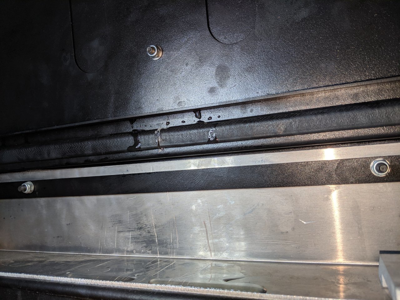

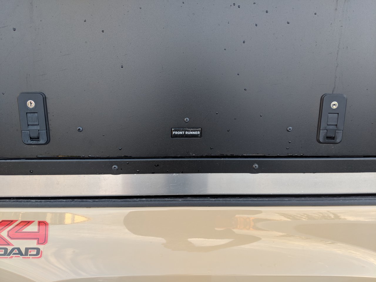

    I figured out where and why my frontrunner door leaks, and it's stupid. FR chopped a hole in the outer door material to mount their logo flush. But water intrudes where the sticker is, gets between the 2 sheets of metal, then leaks out on the inside of the bulb seal. I sat in a hail and rainstorm this weekend and finally figured it out. Been driving me nuts for months. I think some people don't have this issue because their FR logo sticker sits in that hole better or something. Nothing a little silicone sealant can't handle though. You can see the cut-out for the logo sticker in the first pic with the screw directly above it. The leak on the inside then drips down from both edges of the sticker, pools on top of the bulb seal on the inside, then eventually drips into the camper. Ugh.
