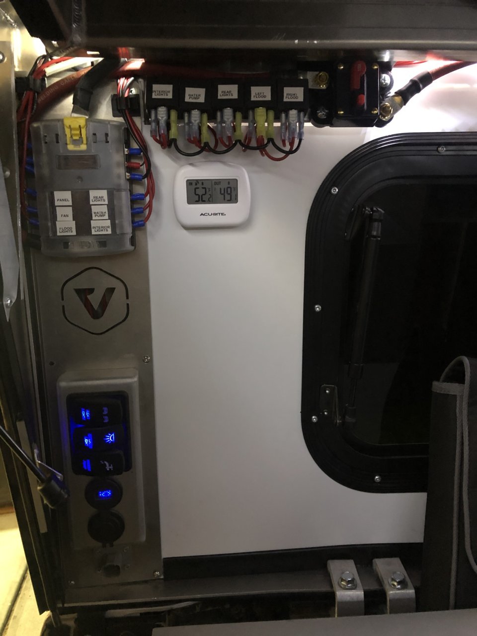

    So where is the power typically tapped from for the fan, lights, and the following option: 12v Power Port & Double USB? I plan to run a solar charger to provide power to the accessories or charge the aux battery during the day. That's why I wanted a nice thick wire back to the battery and paid extra for it.

    Depends on build. My batteries are in the bed and I ran a 10 gauge from my batteries to the Drifter power pod. Solar I did completely separate wires since the wires didn’t really cross paths nor did I want them to so it would be easier to troubleshoot any issues.

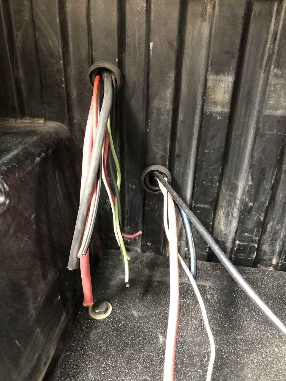

    My batteries are in the hood. I run a 0AWG from the aux battery to the bed through a firewall boot on the bed wall (along with the other wires to/from the truck)
    They go through to one of my cabinets where they all have quick disconnects
    Then it goes up that corner panel of the Drifter, along the electrical track on the driver side, and to the back driver side where I’ve mounted a Blue Sea aux fuse panel

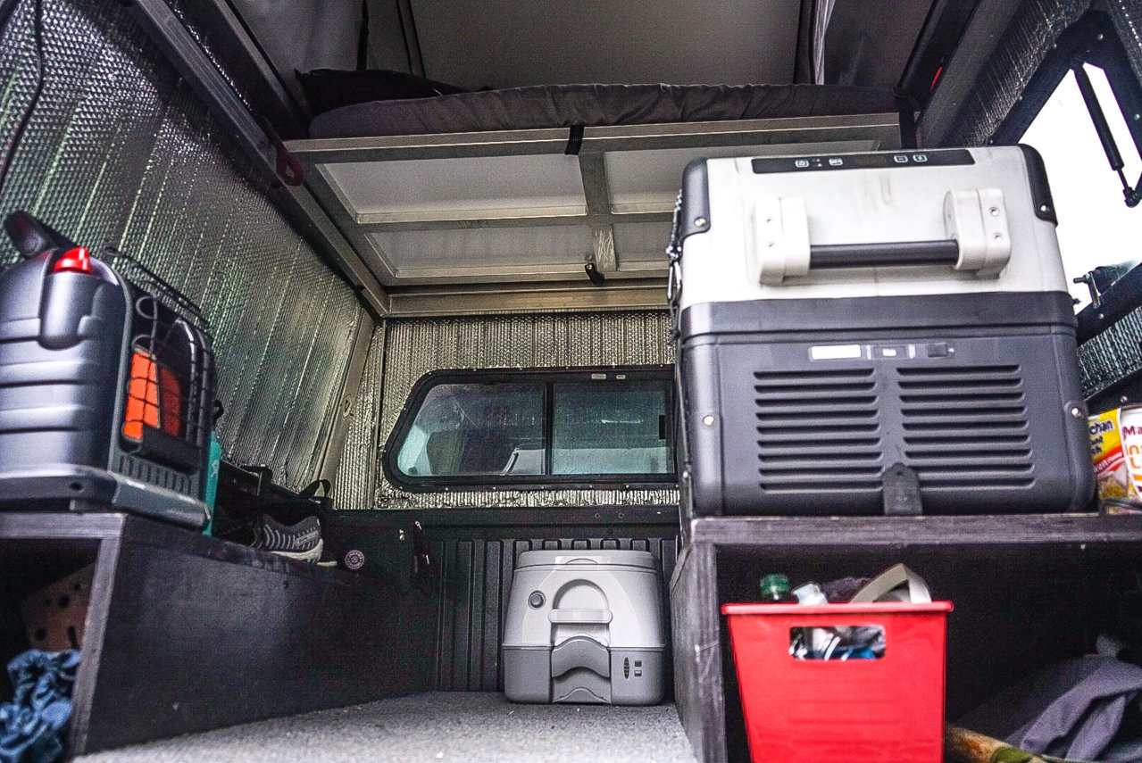

    Quick shot of my interior from a couple weekends back on a big sur weekend trip..super simple, one tote (sp?), usually have the truck ready minus the fridge and toilet. Used the buddy heater in the evening when the back was open, but overnight just used sleeping bags. This is the setup that fits me best and the less my sig other takes makes it even more easy/enjoyable.

    Odd question, but how are you liking that dometic toilet? There are a lot of reviews on youtube but they all seem to be more of a how it works, rather than how much they like or dislike it after using it for a time. Do you use it in the camper? How's the smell? Is it easy to keep clean? How many days of use before having to empty? I've got a Luggable Loo for now and setting up one less thing is always nice.

    Yea I have a thetford, but they all work the same. Mine doesnt have the cool level indicator on it, but I can usually tell when it starts to get full.
    I think they’re great. Aint nothing like waking up in the middle of the night, using the toilet so seamlessly that I’m able to fall back asleep because I’m not full awake from climbing down a ladder and using the bathroom outside in the cold. Call me a bougie. Fight me :D
    Just make sure you sit-test before you buy one. Some people may find them to be too small for their badunkadunk

    Same thing a game changer..the smell will depend on what chemicals you use before poops..if you're enjoying brews around camp inevitably you'll need it in the middle of the night. The smells haven't been an issue in the camper, it seals up good. I'm a big dude so there is a little bit of a balancing act but worth it. They're pretty cheap in my opinion..around 100.00. It give the drifter another reason for feeling like a small home. Only thing you need to watch for is the change of pressure in elevation.

    Yeah just like @MJonaGS32 said, it's a total game changer. Sitting on it takes some getting used to like @Asphaltcowboychip said. There's plenty of room do your business, but not as much real estate as a normal toilet. This is probably the main complaint I hear, but the alternative is either using wag bags, that if you pee in make things messy or a deep squat in the woods, neither which are closer to at home toilet experience.
    A few tips like what was pointed out.
    • Relieve pressure with the lid closed before using.
    • Make sure you use the right decomposing chemicals. I've switched to the little liquid bottles because I can add more during the trip vs the tide looking packs.
    • It works for #1 as well, but I try and pee outside as much as possible, otherwise the tank get's full quick.
    • Dumping it take some practice, but if you let it sit for a few days with chemicals it makes dumping so much better.
    • Avoid baby wipes unless you want some splashing when dumping. They don't dissolve as well as RV toilet paper.
