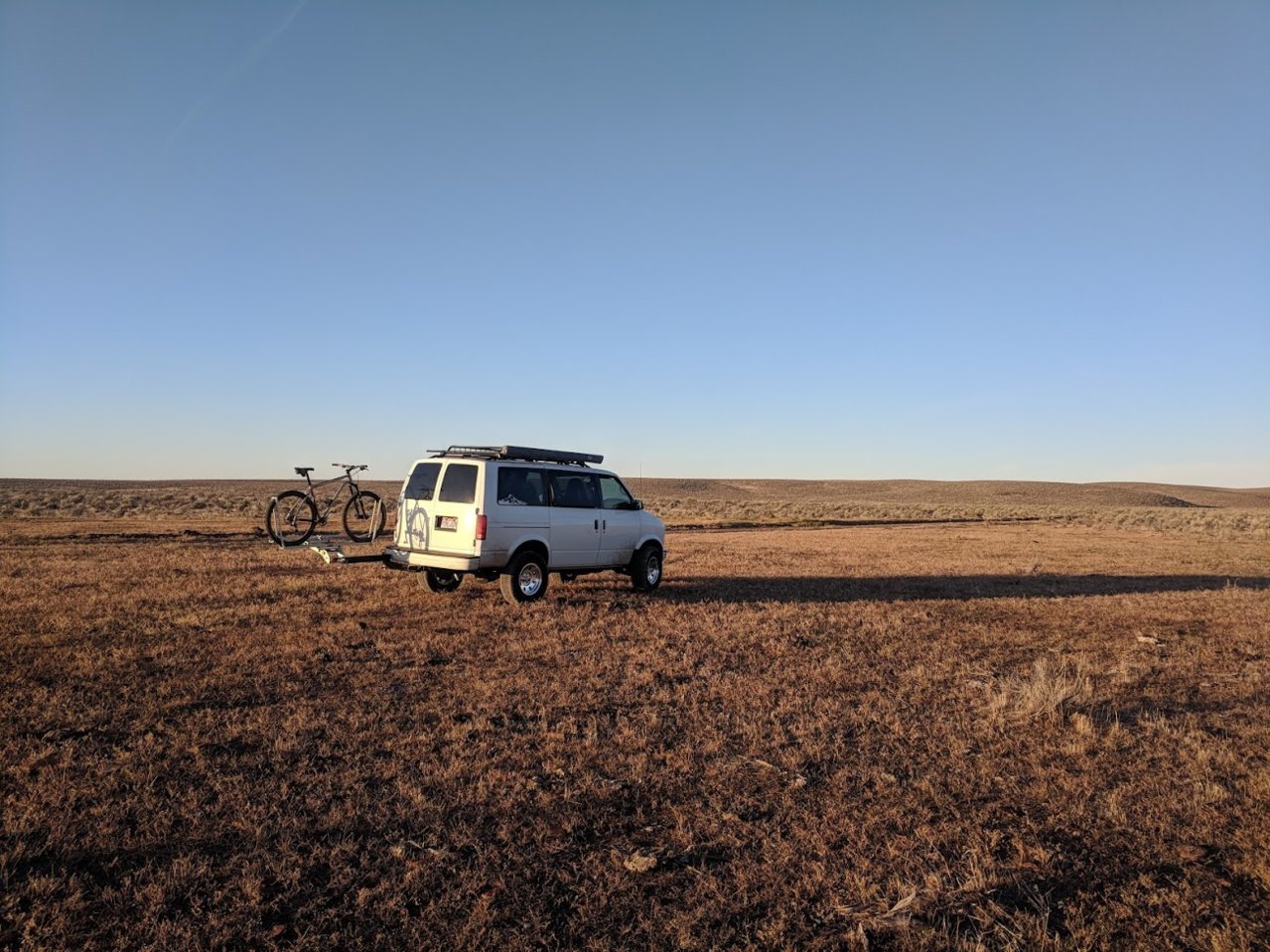

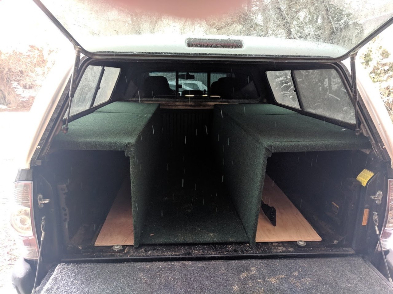

    You could probably get away with a tailgate pad. It's by far the best method for bike carrying with an open bed, but when I've tried that with a regular shell on it was definitely annoying. My personal recommendation is to get a hitch rack, and if you can afford it, a 1up rack with swing out hitch is an awesome setup. 0NkXP_Pu1QaP4XteHcmyqbG9BV0BWyh7Z6t8JuXR_78d0f6794abe656bf1bef71a92f466a0da3ac930.jpg
    There's a good discussion on hitch racks starting on page 503 of this GFC forum (https://www.tacomaworld.com/threads/hondo-garages-new-thing.516490/page-503).
    For secure transporting, I have an initial interior build designed to fit two bikes on a slide-out platform with fork mounts. It worked well in my truck with a regular shell, so I expect it'll be fine with the drifter's bigger opening. Sorry I don't have any shots of the bikes actually in there...-eiLqVICqxqqzOkAhlpK3UraBLufWVbl3EYI_qp__f9810cd2c6f32f00fd013824805a88810250c3e5.jpg

    What I ended up doing for bikes is I got a Yakima Backswing. What's nice about this or other similar products, is I can leave it installed all the time without the bike rack and it doesn't interfere with the camper. It sticks out a bit and makes the truck longer but when the tailgate is down, there is no issue. Then, when I want to carry bikes, I can just install any regular hitch mount bike rack and It'll swing away for easy access. I like this approach as I don't like to leave the bike rack installed all the time but hitch swinging racks can be cumbersone to install/uninstall. This way, the swing portion stays installed and out of the way.

    I too ran a Yakima swing out bike rack before I had a swig our bumper and it worked great. There are a few different companies now that make hutch mounted swing out receivers that would allow you to use any bike rack.
