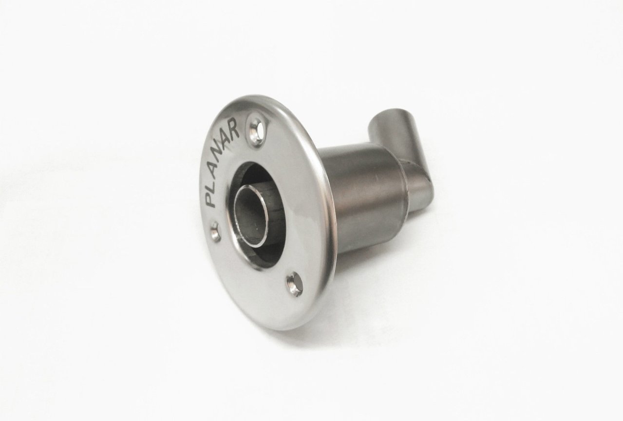

    Something like this could easily be mounted to the bed or side of the Nomad.
    Not sure what truck you have, but most full-size trucks I’ve seen have holes (with plastic plugs) that could easily accommodate a 24mm exhaust hose. Lots of options!

    Pretty much what I had in mind. I have a Ram 2500 now, needed the towing and payload capacity. I’ll have to check in the morning and see what it has for drain plugs in the bed, didn’t think of that.

    With a forced heater exhaust, at least with a propex, you have to have the exhaust tube continually traveling down. This is because condensation builds up in the tube and any “valleys” need to have a hole drilled to help drain.
    So inside the cab you don’t want to drill any holes in your exhaust so the best is to run it down through the floor like Phil said.
