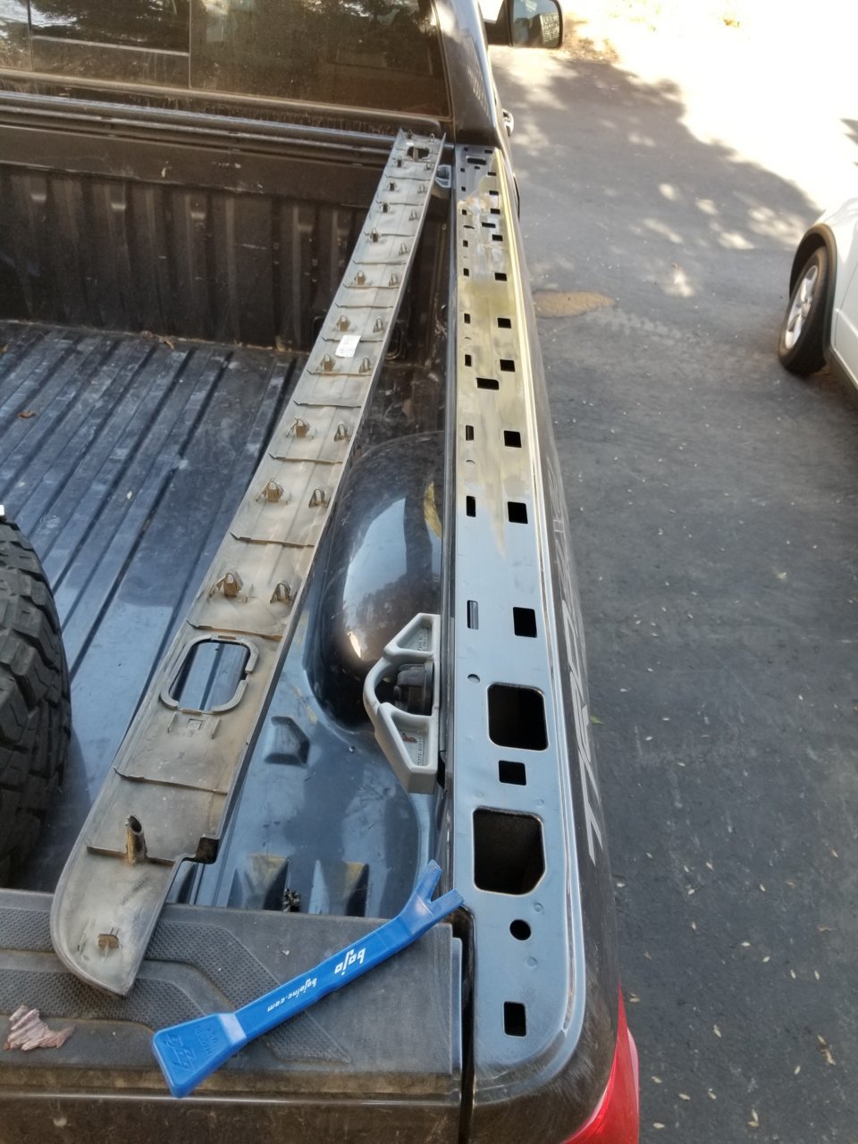

    I'd like to seal/caulk the perimeter of the plastic bedrail caps on my 2018 Tundra in preparation for the Nomad. I've popped them off (only broke one or two clips) and my god, there are holes everywhere, just like in the Tacoma.
    Is there a preferred compound for sealing around the perimeter of the bedrail cap? Does the paint need to be roughed up a bit for adhesion? I am hoping that the stock low-profile plastic bedrail cap doesn't compress/crush from the weight of the Nomad.
    EDIT: I have to admit, I'm also considering just tossing the plastic bedrails entirely, taping over the holes, and having the Nomad sit directly on it.

    On my tacoma I taped the whole thing and then applied silicone all the way through and around the holes. Then reinstalled the plastic caps letting the silicone cure.

    That would be a good way to crack your bedsides. Please don't do that.

    Like others we used aluminum duct tape to cover the many holes we had and silicone with the voodoo tail caps. It has worked well.

    Just add the Relentless caps that Vagabond exclusively sells and never look back

    We don't have them for 3rd gens, the bed caps. But with 3rd gens the plastic caps are not as much of an issue as the 2nds because of how thing they are, but they do need to be sealed.

    Is there an aftermarket bedrail cap available for that year Tundra? I don’t know personally because I don’t own one. But I can assume there is one. And that would be your best bet.

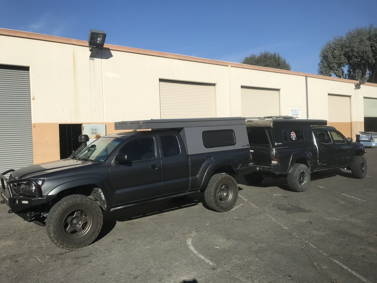

    Been trying to figure this out myself for awhile, but hey I got the time while I wait...ha ha. Below are pics I collected of a silver 2nd Gen w/ black & another random color truck w/ the what I think is the standard grey color. You might be able to have the guys on the Photoshop thread (they are awesome!) work a little magic for you to see how things look. I think the 3rd gen silver is a little different tone than the 2nd gen though but either way it may help. I know there is definitely the option of getting a color match powder coat color as well based on what I have seen, but not sure if that involves an up charge or not.
