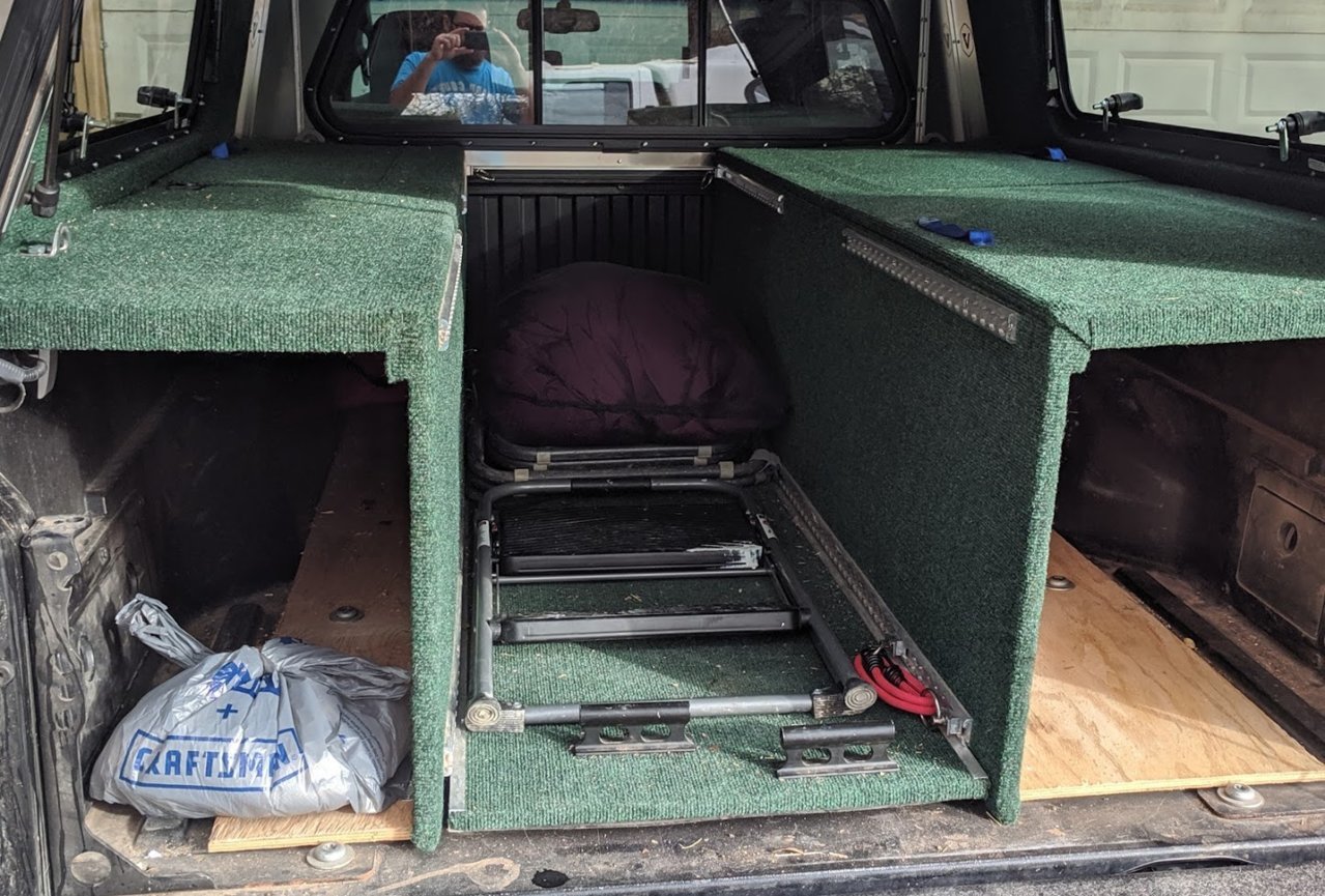

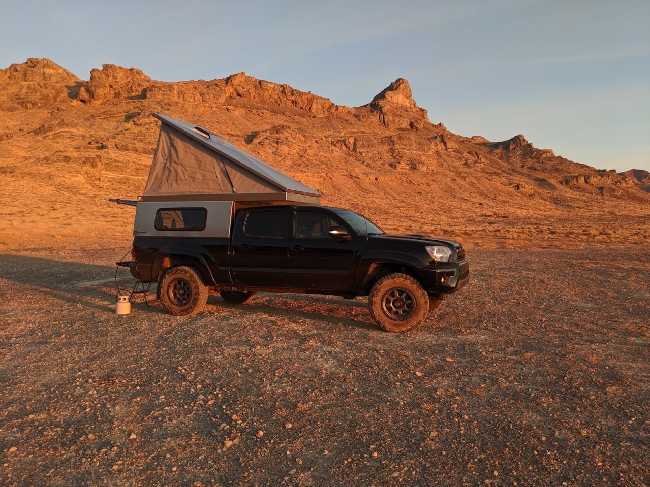

    A swing out is great, but also, a lot more weight and expense and makes tailgate access more difficult while in transit (we use the tailgate as a changing table at lots of gas stations/rest stops these days :crapstorm:).
    Here are some swing-out free solutions to the issues you bring up that I'm implementing...
    Trasharoo can go on the tailgate. It's a bit less convenient since it's difficult to access with they tailgate is open, but doable. Usually I move ours somewhere else in camp when we arrive.
    You can just add a hose to your water jugs and run that out the end of the tailgate. As long as the end of the hose is below your jerry, the water will flow. If you add a hose attachment, you can also refill them directly from your spigot at home and then you never have to move them out of the truck. A pump is great too obviously. https://www.youtube.com/watch?v=qvYeDePC47Q
    I have a 5lb tank with a 6ft hose from the local propane shop. It gets strapped to some L-track in the bed for travel (see red elastic band in the bottom of first image) and placed on the ground when we arrive at camp. The long hose allows me to still run the line in to the truck for heating or cooking when its cold.
    nyf9D7aJl7v8vjQx9FgivEXkV01hNelg6UogDbh-_1bb6ed79cb3c00b024bc42339ee53cf1c673f87e.jpg
    QWh06_0DdXk5vnnYcJQ3_DdhjBvj0Tj5U9VYV6Oo_f0c4bff869dc69acb8259a11319adc0436a09ff6.jpg
    This is one I'm still wrestling with, but some version of what @alldownhill implemented seems like a great plan. It kinda moves the kitchen box off the tailgate, providing extra tailgate space for prepping but also making it easier to allow camper access. I also like this idea because you can still move your kitchen box to a central camp table if you're with a big group. See https://www.tacomaworld.com/threads...ildout-and-mods.540940/page-126#post-22151560
